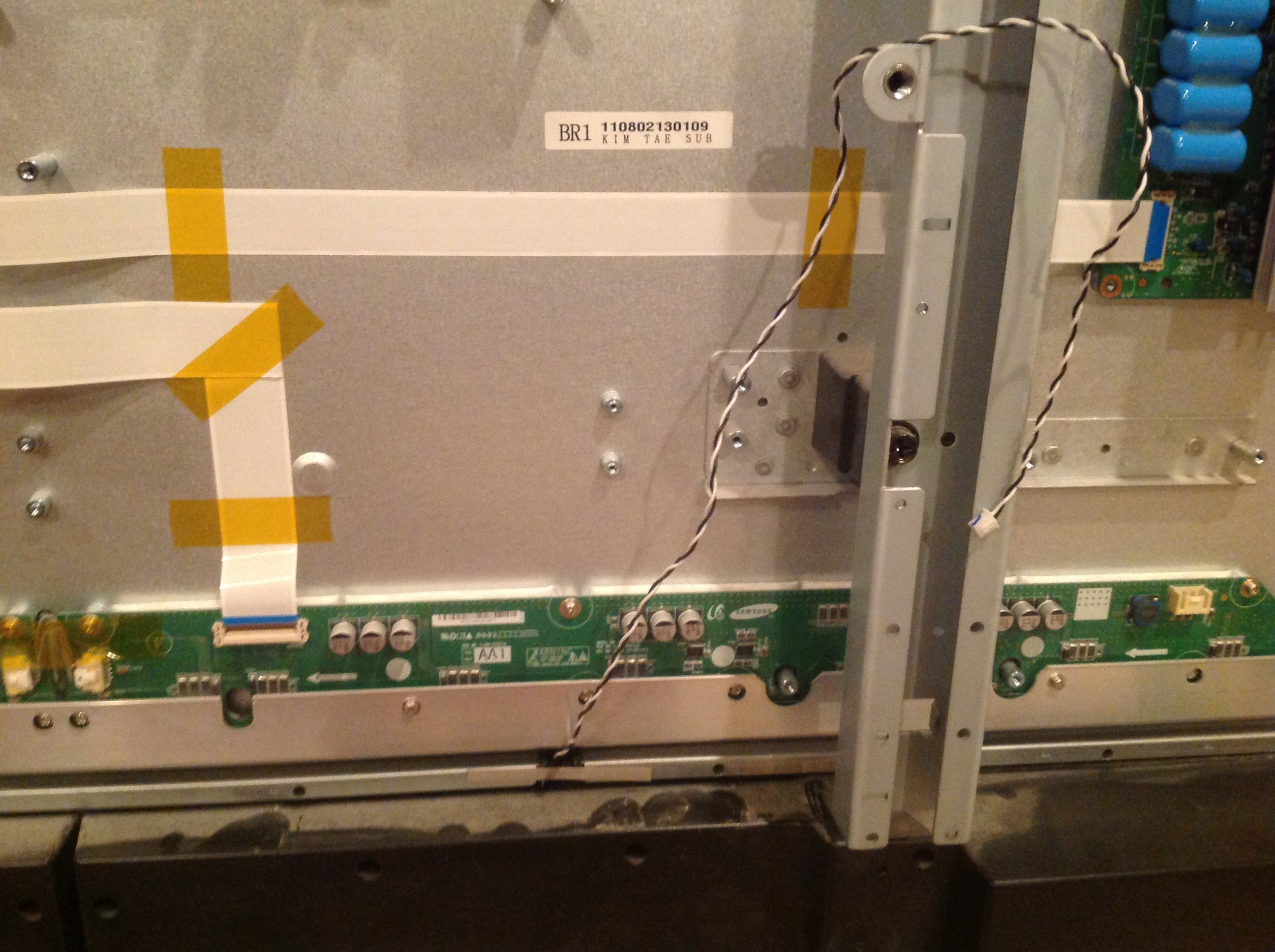

          Ok here are some pics.

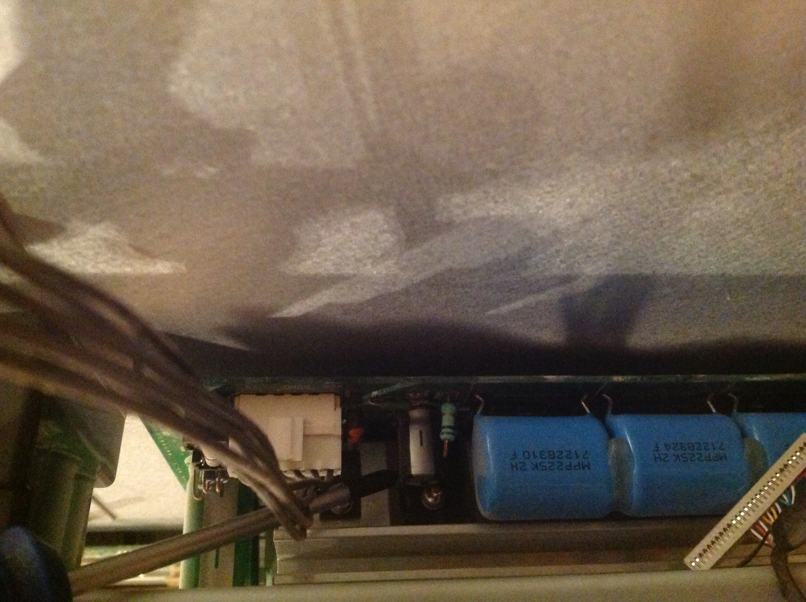

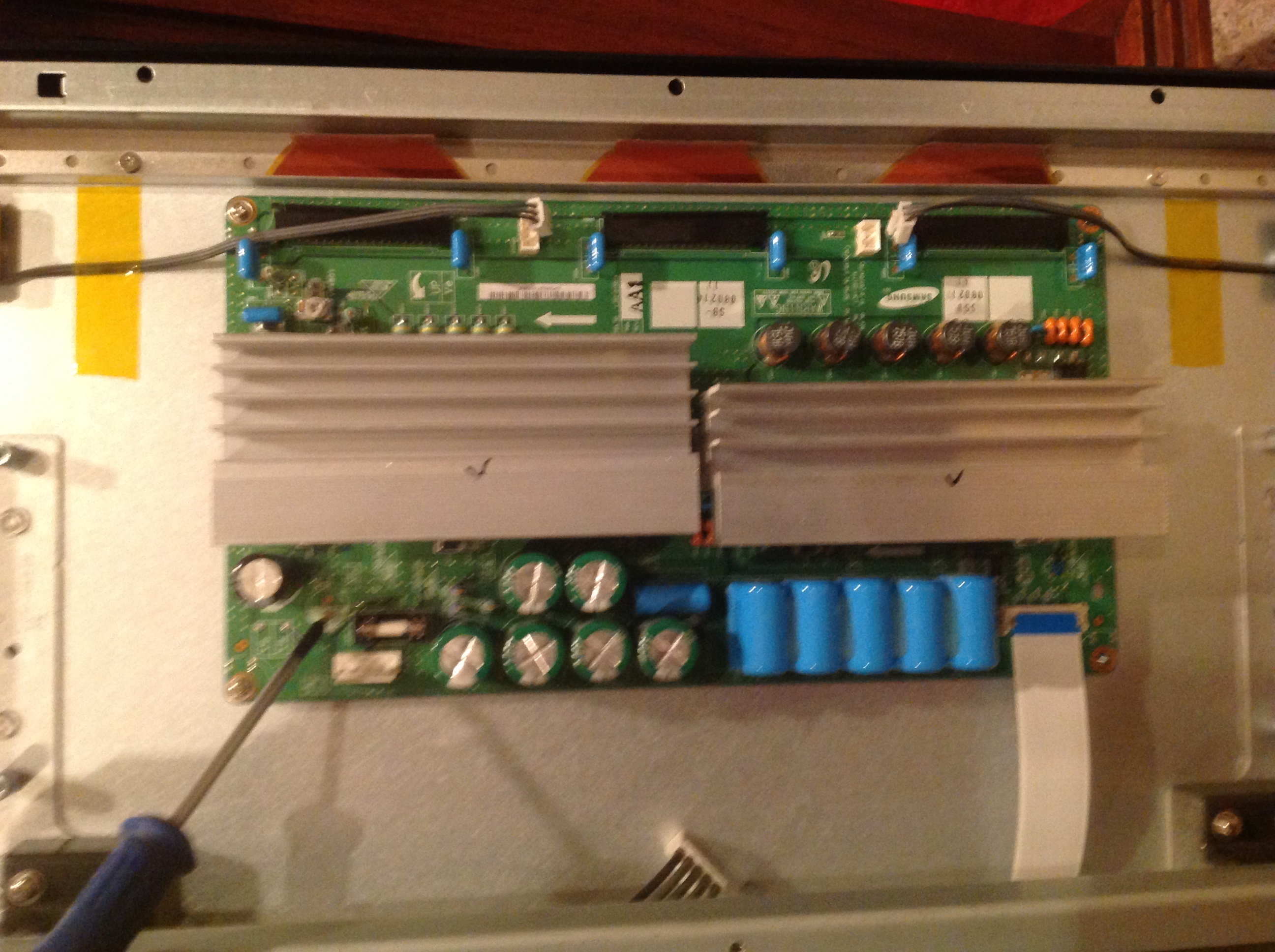

            This is one of the boards with a bad cap note the screw driver it is a 680uf 25v already removed also the post won't let me attach more than one pic at a time. Sorry for all the added post.

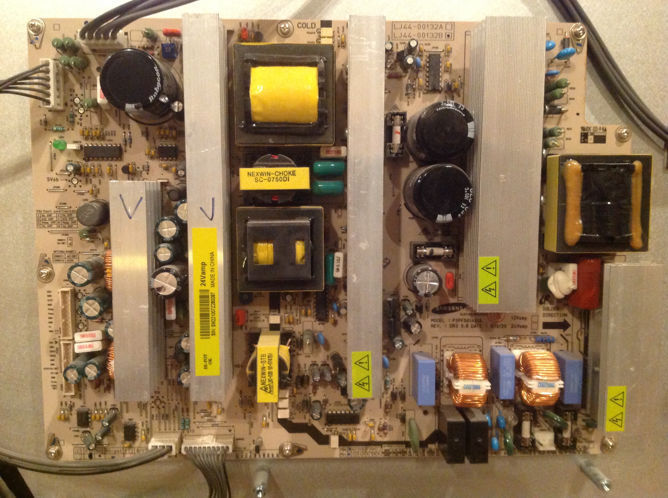

              Power board

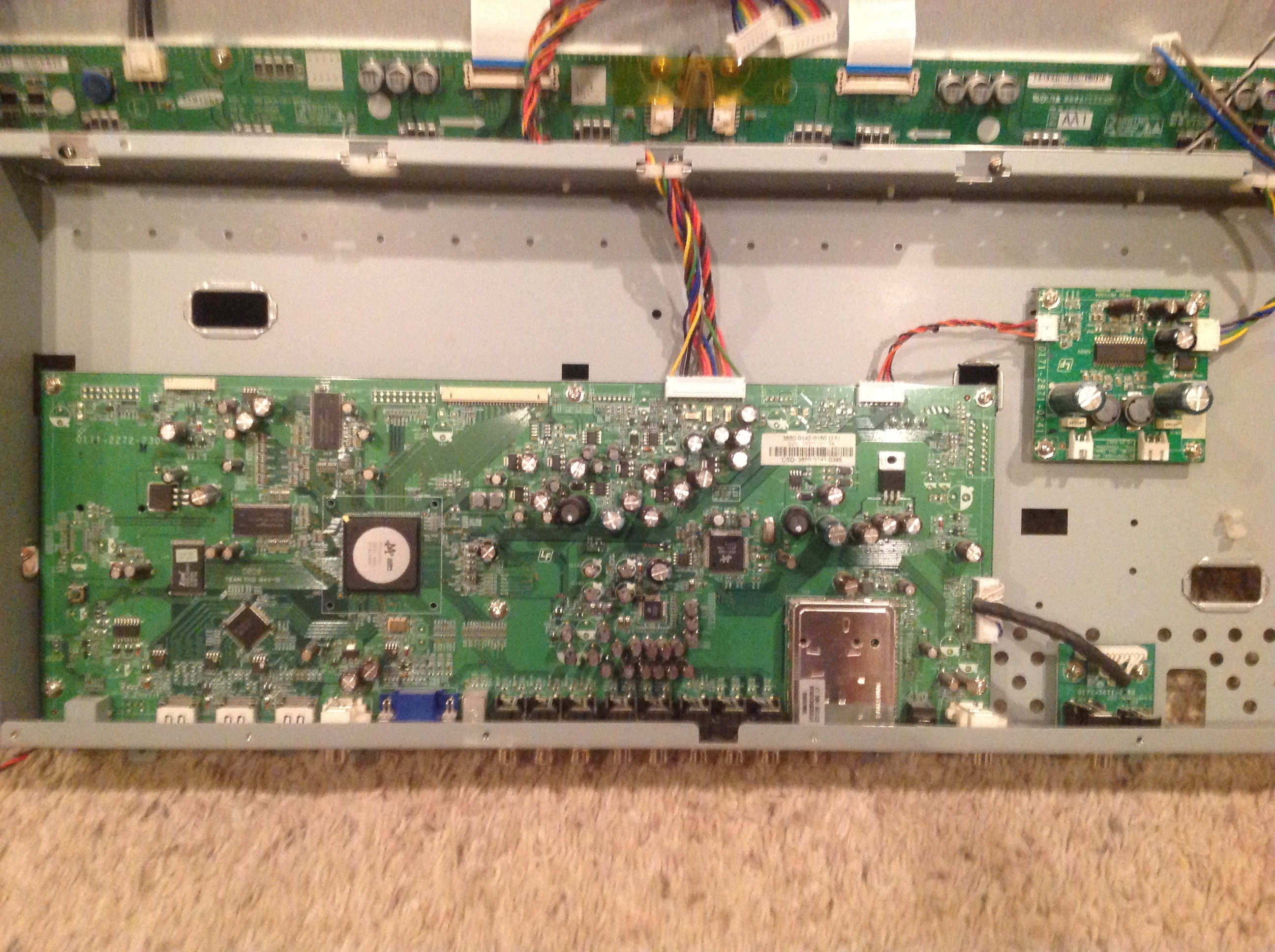

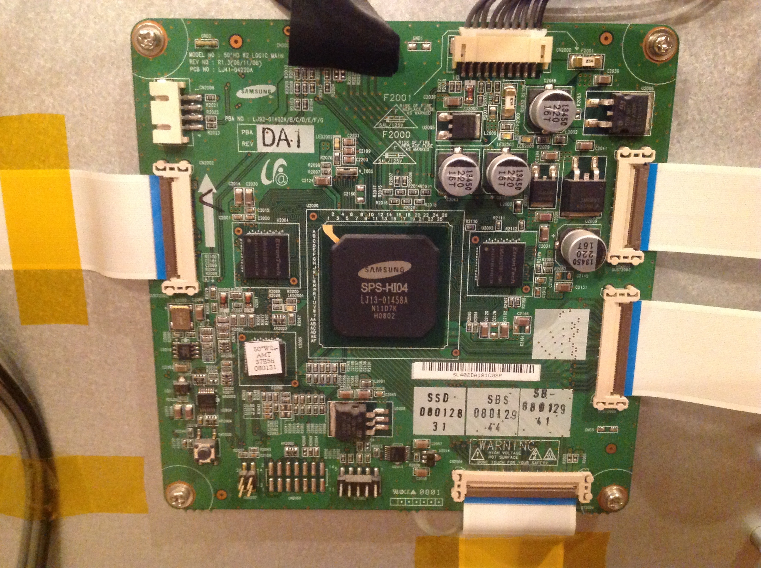

                Logic main

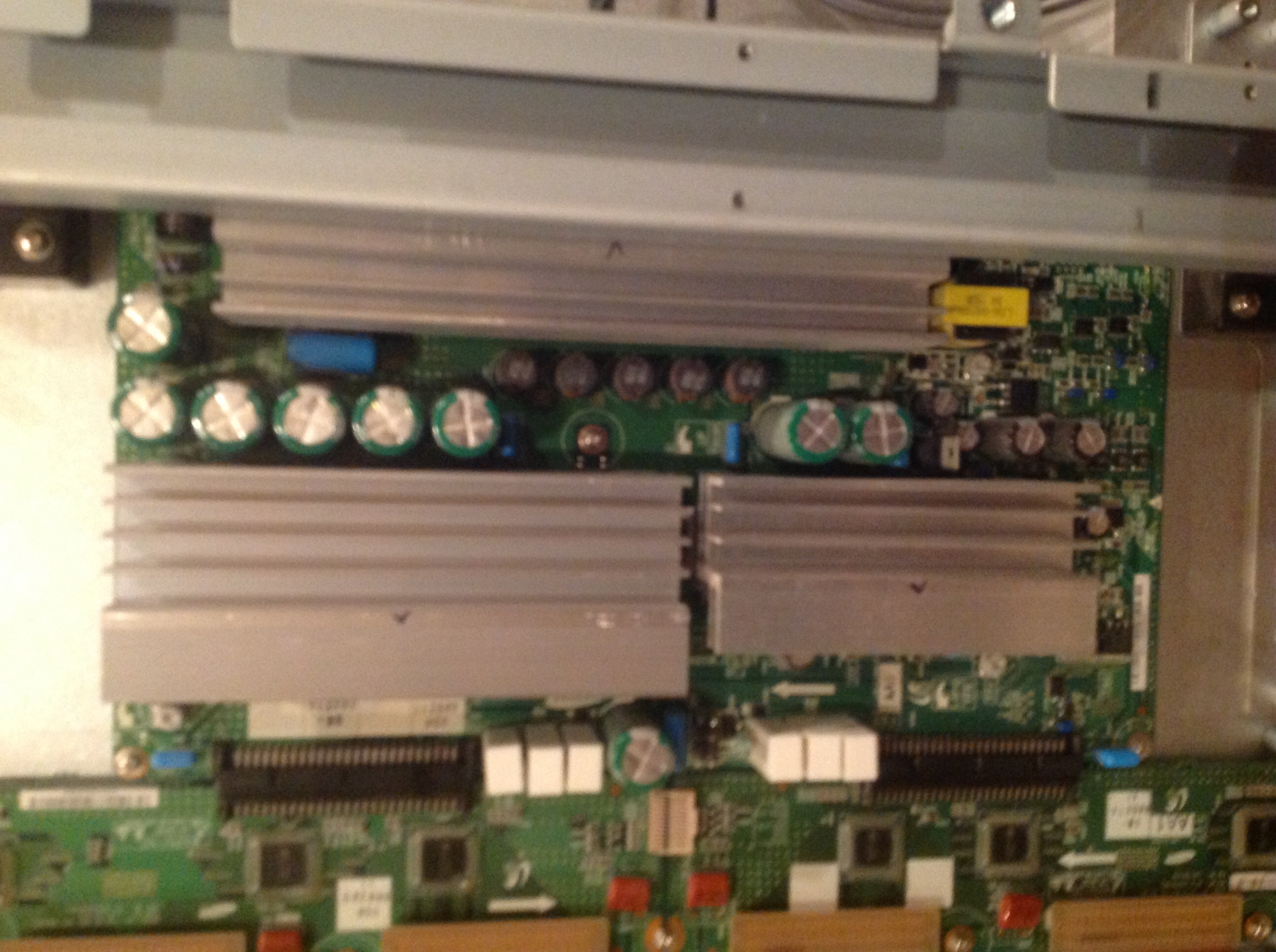

                  Y-main
                  • Swright
                    • Apr 2013
                    • 29
                    Re: Vizio vp50 hdtv20a no pic just sound

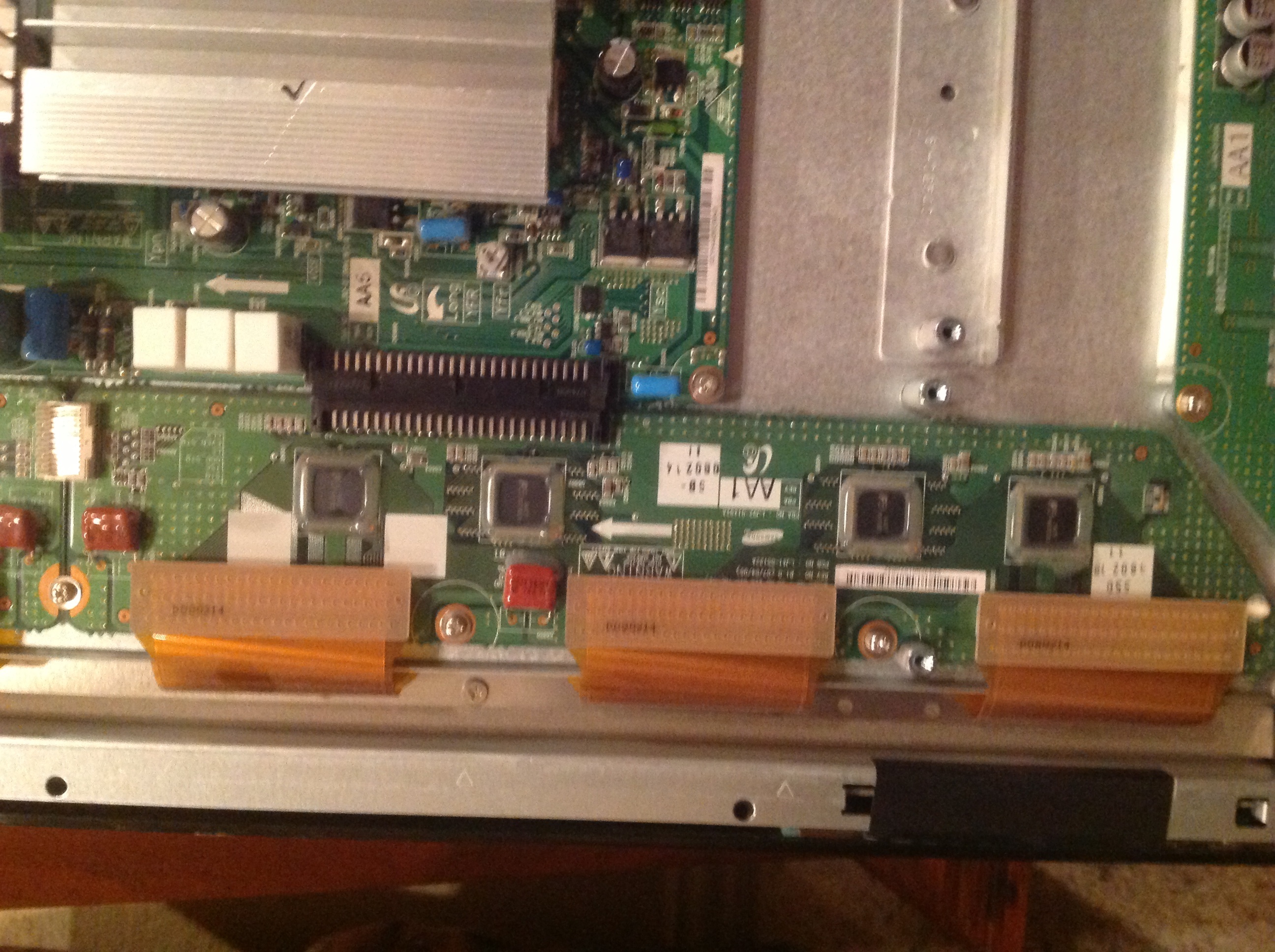

                    Y-main, I just found another blown cap, it's the same size as the other one on the x-main
                    • Swright
                      • Apr 2013
                      • 29

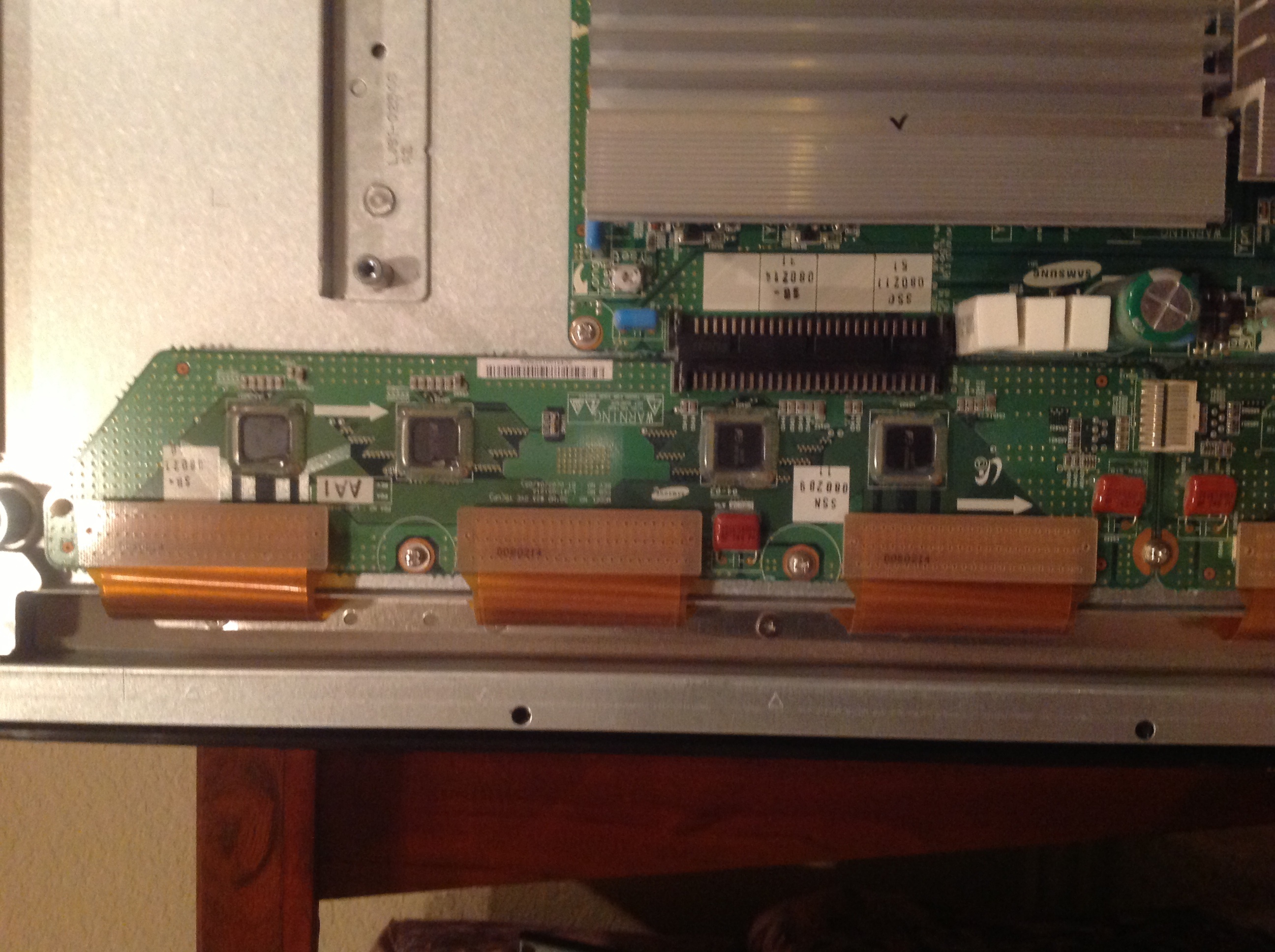

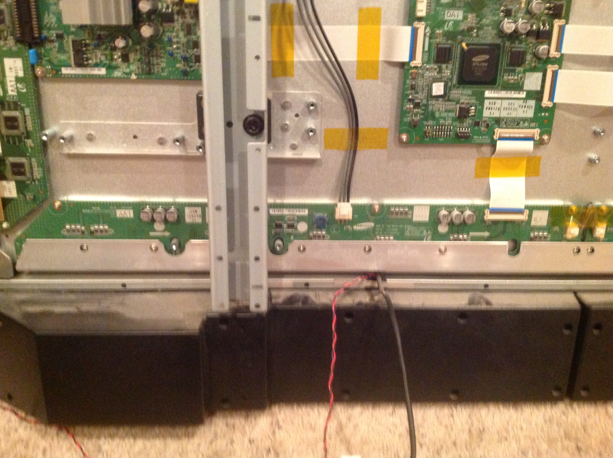

                      Yb-upper
                      • Swright
                        • Apr 2013
                        • 29

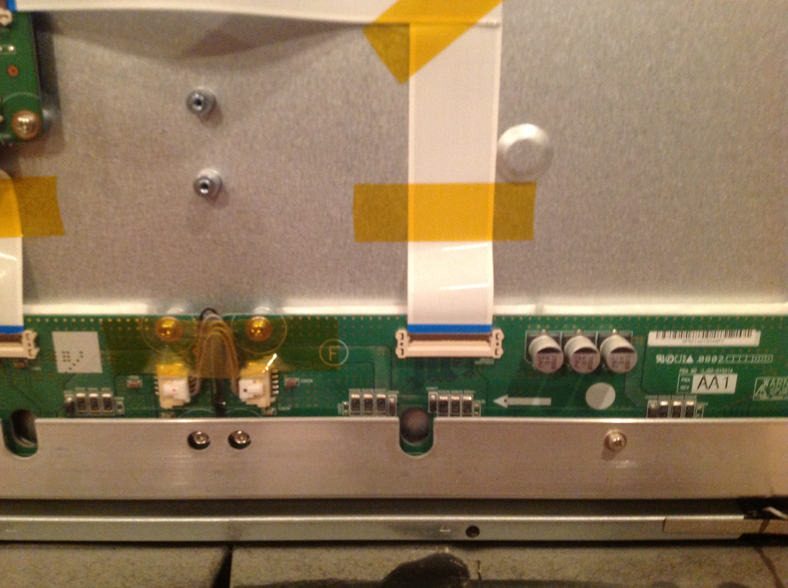

                        Yb-lower

                          Ok, I thought your vp50 was the version that has LG components, but it's got Samsung components instead. So, there are no IPMs - that's a good thing. How do your buffer chips look? Any burns or holes? You'll have to examine them closely, as the holes could be the size of a pin.

                                        Ok. The next thing I'd do is check the voltage outputs on the power supply to make sure they're within spec. Specifically, since everything is working but the pic in your case, I'd check the VS and VA output. You'll need to disconnect the Y-main and X-main from the power supply to (1) avoid doing further damage to them and (2) to isolate the power supply.
                                        VS and VA voltage reqs. should be listed on the panel.
