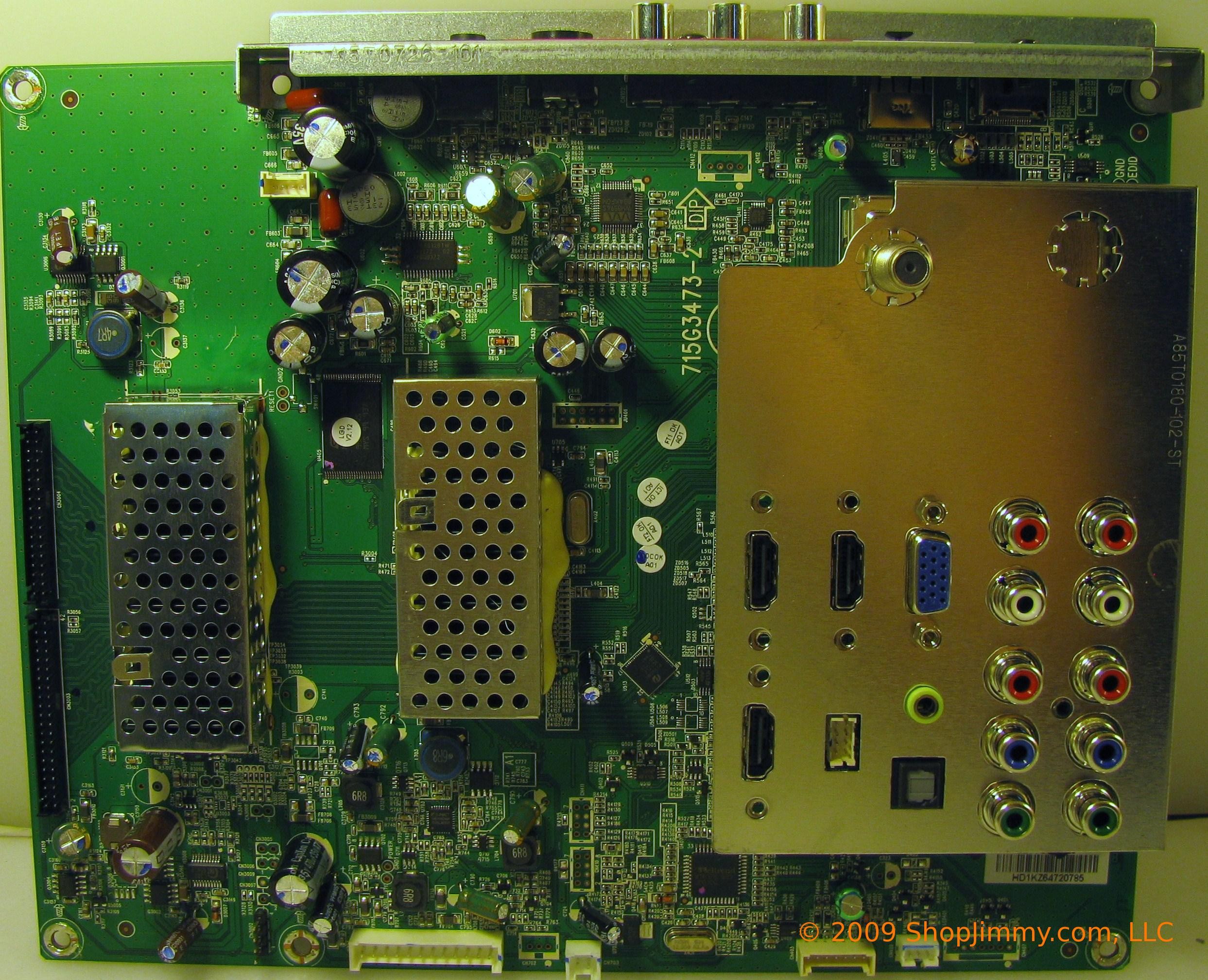

    Vizio Vizio VT420M Good Backlight no sound no picture
    Ok, I have spent a few days reading posts about this TV.
    It seems as if they are junk..
    Long story short here is the prob.
    Turn power on at the switch (no remote) The "Vizio" logo on the frame turns a faint amber color and fades out. The backlight come on and then off for a sec and back on and stays on. There isn't any display at all.
    Not sure what the board is called that sends signals to the screen was swapped out with no change.
    I have checked the power supply everything seems to check out. Voltages going in and out of it (all caps look good) etc..
    I did check voltages at the reg (U702) Counted pins with the tab up and counted left to right.
    Pin 1 0.00 volts
    Pin 2 3.297
    Pin 3 5.12
    Are these correct voltages?
    Before I spend any cash on this tv I would like to know how to check to see if the screen is ok before I replace boards etc etc etc..
    Kenneth
    Re: Vizio Vizio VT420M Good Backlight no sound no picture
    That is correct, it is 3.3V regulator. I expect the board to have more than one regulator.
    Do you get either 5 or 12v at the T-CON fuse?
      Yes, I do have 12V at the T-CON fuse.
      The power will also drop to 0.0 and back to 12 with the on/off thing the backlight does...
      There is one other reg that I found on the board (u701)it is missing pin#2 on it.
      Pin#1 11.28
      Pin#2 Stub 0.00
      Pin#3 9.07
      Only 2 regs that I see on that board.
      If it matters this board is different than any of the other ones I have seen on any site so far.
      I was thinking it might be the board. However, I read somewhere where someone said to disconnect the cables from the T-con board and watch the screen for changes. Tried and the screen doesn't change at all.
        That may be 9V regulator. Do you have the number as printed on it. At this point you will need the new main board.
        • a_eclipse_guy
          • Apr 2013
          • 8
          It has 17809 printed on it.
            OK, that is the same as LM7809, positive 9V regulator.
                      I did find one more reg on the back of the board.
                      Pin1 .008
                      Pin2 Stub 5.00
                      Pin3 9.03
                      I guess it is working correctly.
