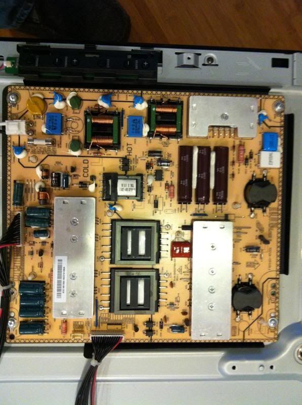

    I have a Philips LED TV that stopped working after I installed a software update. I took it to a repair shop because the warranty needed an estimated repair cost and they said I need a new mother board. I found a replacement mother board online. I'm wondering if replacing the mother board is as easy as taking the old one out and putting in the new one. Are there any other steps I need to take after replacing?
    I have hobbyist level electronics experience. I think troubleshooting the mother board would be too much for me since it's SMD.
    Any help is appreciated. Thanks!

            Re: 40" Philips 40pfl4706/f7 Mother board replacement
            Here are some pics
            [/URL]
            [/URL]
            I can take some more detailed pics if needed.
              Can you read off the legend next to the connector (going to the main board) on the right of this image?
                Is this the legend you need?
                Here is the legend:
                  Check pin STB5-3V for 5.3V standby: Red probe touching metal around appropriate pin, black probe on the chassis.
                    I'm getting 5.226V on that pin.
                      That's good, then. Next step, check the P-ON pin and the P-ON12V pins.
                        Thanks! I'm not getting any volts on P-ON or the P-ON12V pins in standby mode.
                        With the power on I'm getting 3.296v on P-ON and 12.23 on each of the P-ON12v pins.
                          This confirms that portion of the power supply is operating correctly; most likely the rest of the PSU is too. Can you next check BL-ON, NT_Dim, Ext_Dim and the +24Vb line, on either connector, just to verify the operation of the PSU and other parts.
                          If the voltages are good, but the BL-ON is missing, then I would diagnose a main board fault. However, if the 24V is missing or the BL-ON is present (with good 24V) then I would diagnose a power supply or backlight driver fault.
                            Thanks again! I'm getting .005V on the BL-ON, .019V on NT_Dim, .005V on Ext_Dim and 24.94V on all the +24Vb pins.
                            The screen actually turned on for a moment when measuring these pins. I think it was on the blue philips screen.
                              The main board is not turning on the backlight, so the main board is likely at fault. You may find connecting BL-ON directly to 12V using a 2.2k ohm resistor will fix your problem; the screen might flicker a little during boot up but if the TV is displaying video, it should be usable.
                                I just placed the order for a new mother board. I don't trust myself to do a solid enough job of wiring the BL-ON to 12V.
                                Thanks for walking me through the trouble shooting! I learned a lot.
                                  Update - I received the new mother board today. Hooked it up and the TV works great! $70 for the new mother board. Not bad. The repair shop was asking for over $300 for the part and labor. Thanks again Tom!
