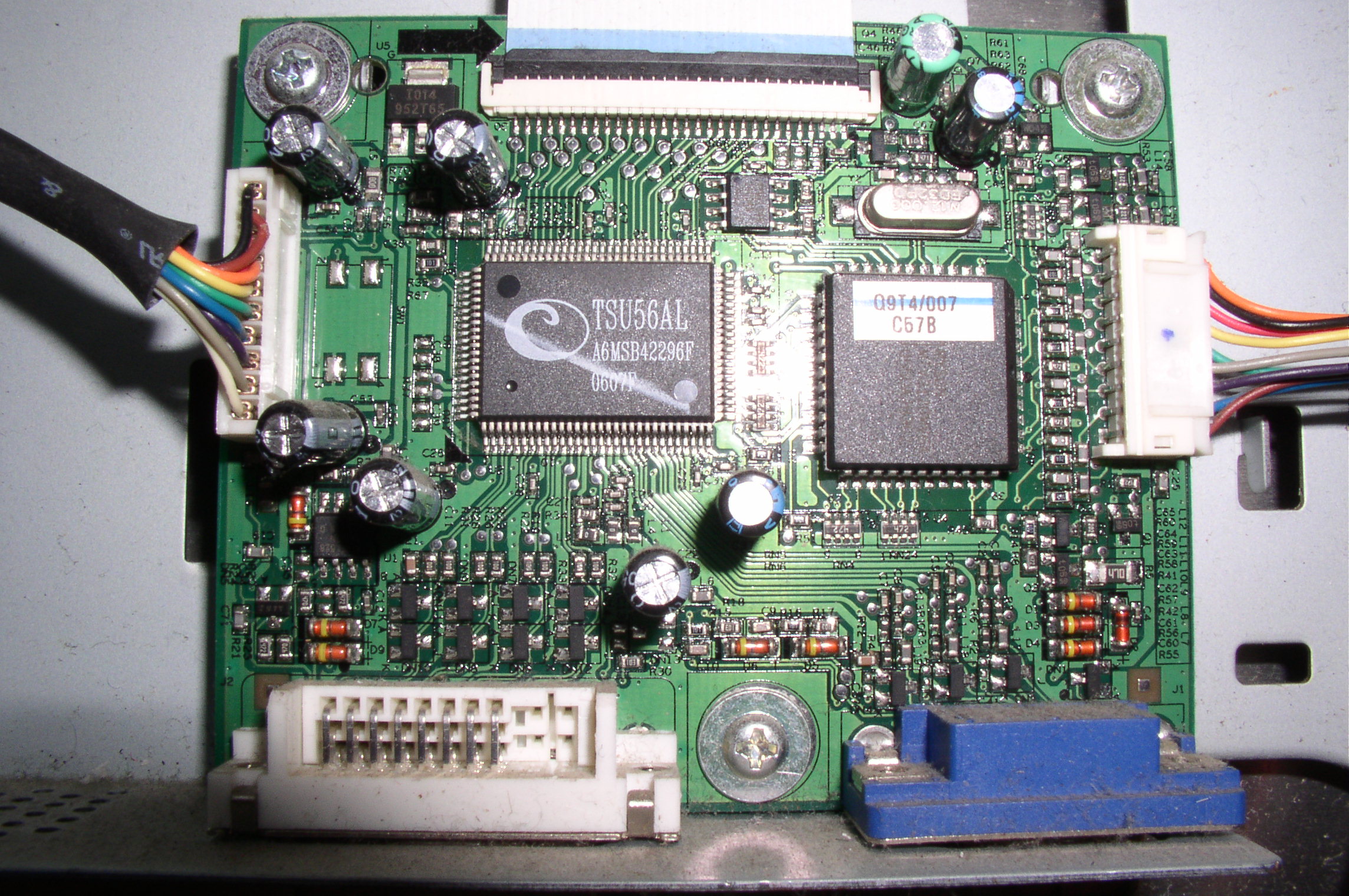

    beng fp91g+ (q9t4) monitor. Mostly wont turn on. Once in awhile it does and works fine. However, that's very seldom. The on off switch hot side is 3.3vdc. The switch grounds that when its pressed and my dvm then reads 0vdc. Every time. Ive traced it to the display circuit board plug, gray wire. So, it goes from 3.3vdc to 0vdc when the switch is pressed - Every time. Over and over I can do this and every once in awhile, the unit powers up and it works fine. however, the next time, it wont power up.
    Any ideas what could be wrong? All the caps look fine. Ive also inspected all solder joints.

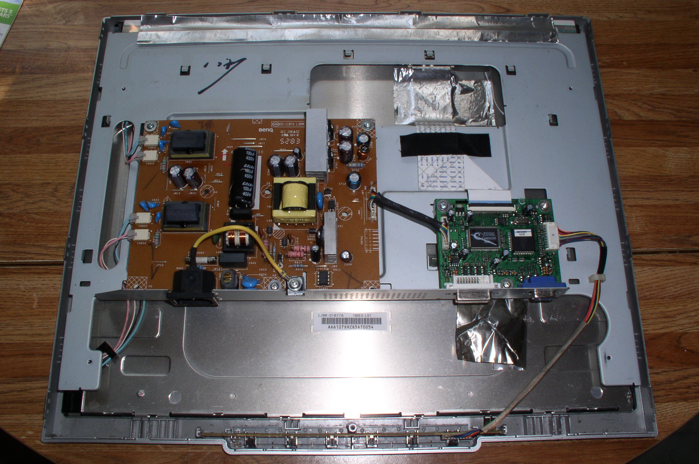

    We can help a lot more if you please post good clear pictures of the whole chassis, and then pictures of each board, front and back (in the same orientation) and close up of connectors, (max resolution 2000x2000 and 2MB) using the manage attachments button, which is found by clicking "go advanced" under quick reply.

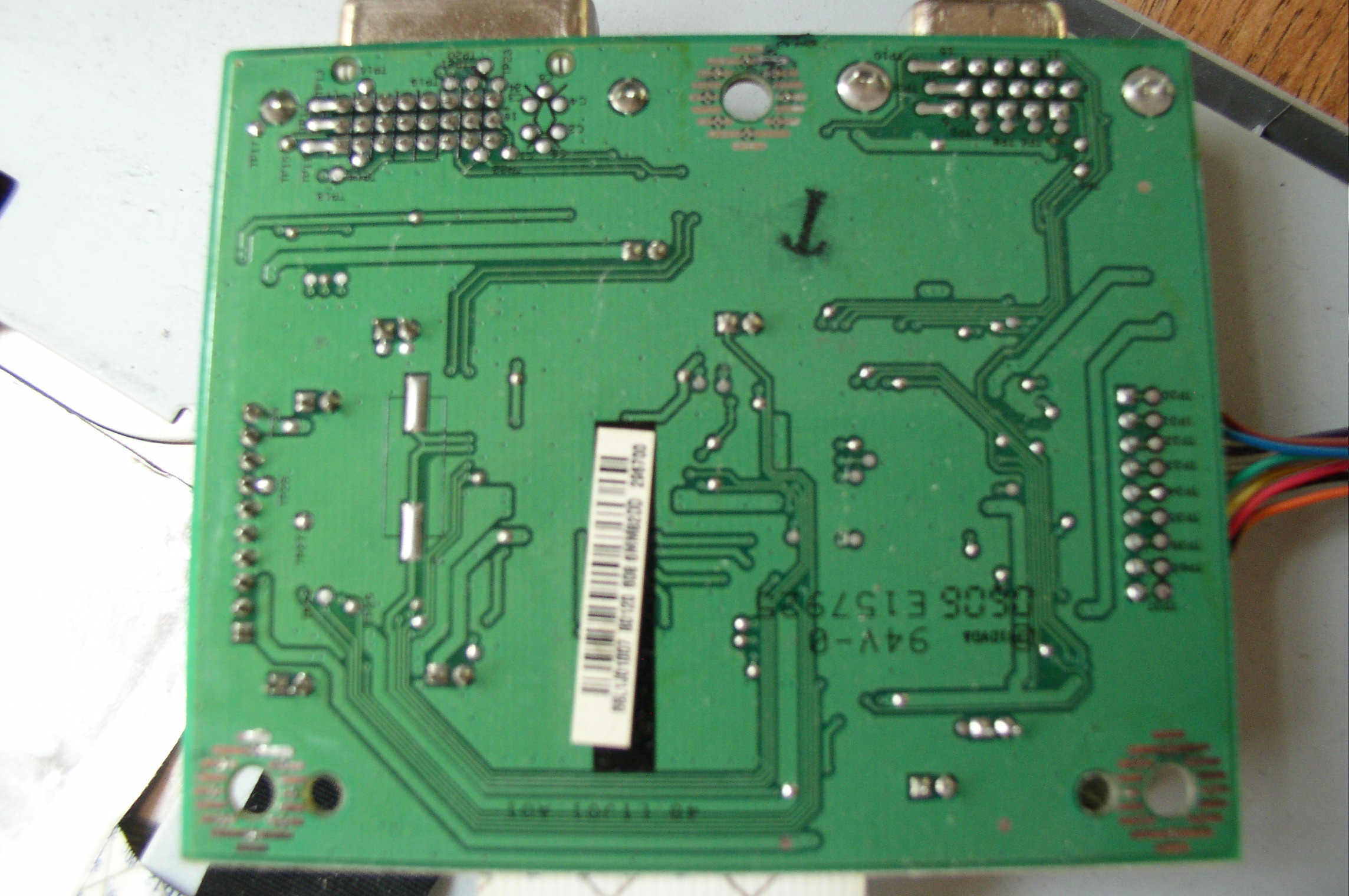

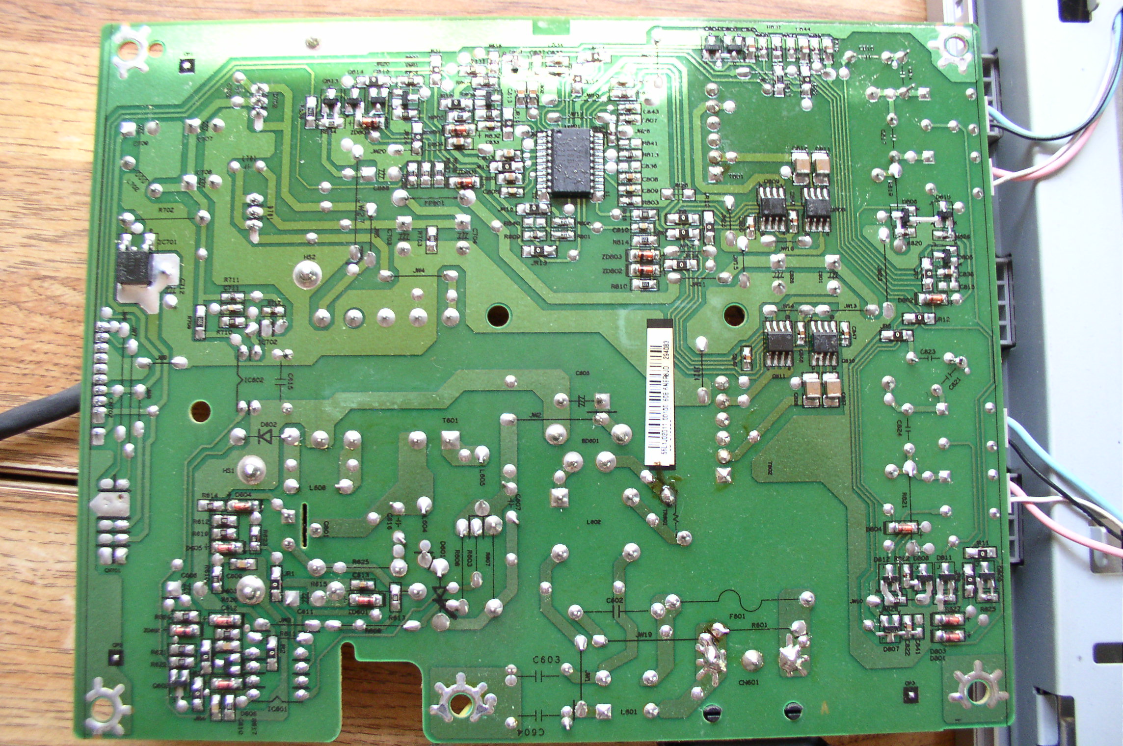

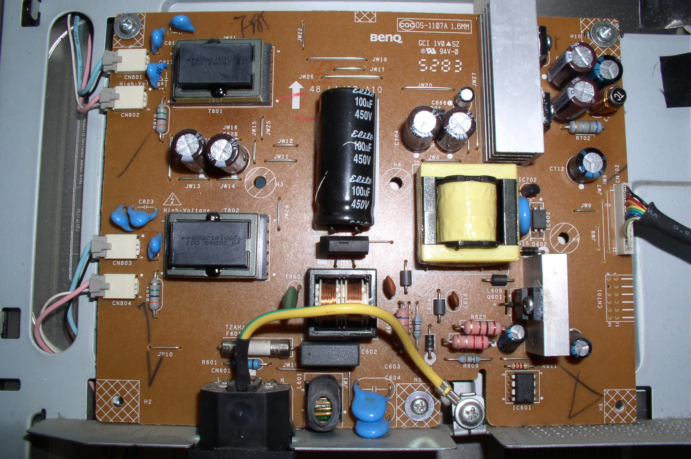

      Pictures attached.

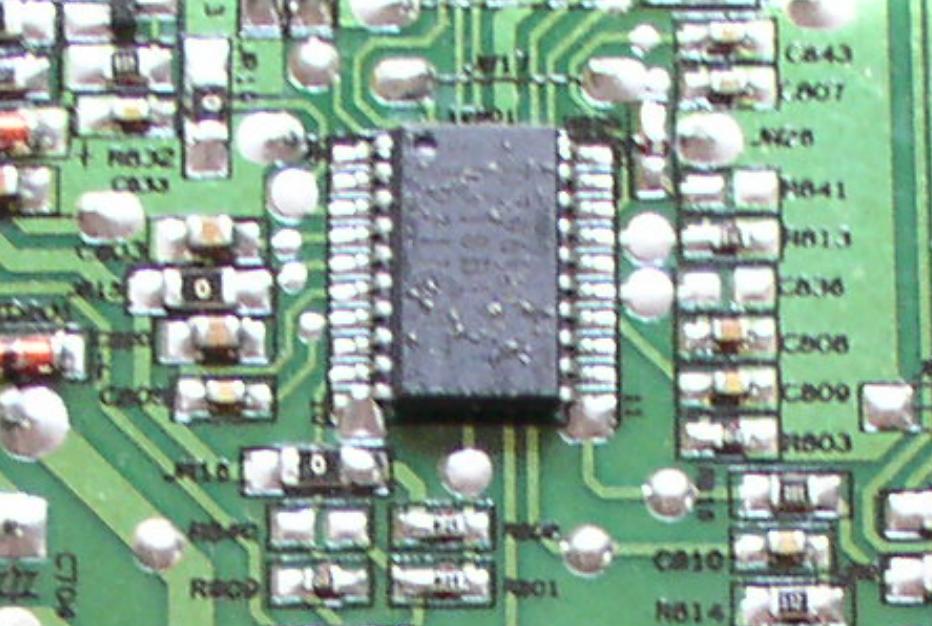

        Yes it is usually solder joints with benq boards - whilst the top of the board pic is good the back could do with being a bit sharper. What is the white deposit on the 16/20? legged device.

          I took 4 pics back of each board, 2 w/flash, 2 w/o and posted the best. I could try again. White stuff? 16/20 legs? On front of pwr board white adhesive holding 100 ufd 450v cap to board. On other board white line on top of IC. Dont know why. cant feel it or wipe it off.

                This what I meant - perhaps I got wrong board -may be just dust
                  Re: Benq monitor rarely turns on
                  oh that. Several of the ICs on bottom side PCB look like that. I think they were made that way. Rough surface.
                    Hmm they are usually quite smooth

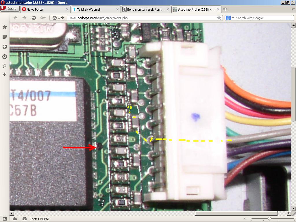

                      What happens if instead of using the on button you ground the grey pin on the
                      connector. Can you trace from that pin - looks like it is going to go via a resistor? to the
                      biggish square chip? Also what is that black mark about halfway down that chip, almost opposite pin 4?

                        "Can you trace from that pin - looks like it is going to go via a resistor? to the
                        biggish square chip?" I looked both sides of PCB, and I cant tell where it goes.
                        I see no black mark.
                              I will add apic in a few mins

                                yellow and red lines? yes that the R it goes to. I cant trace where it goes after that. this is a multi layer board, maybe.

                                  The red arrow points to the black spot?
                                    I see it now. A little almost perfectly round black dot. I dont know what/why its there. Ill try the hair dryer thing shortly, if that is still relevant.
