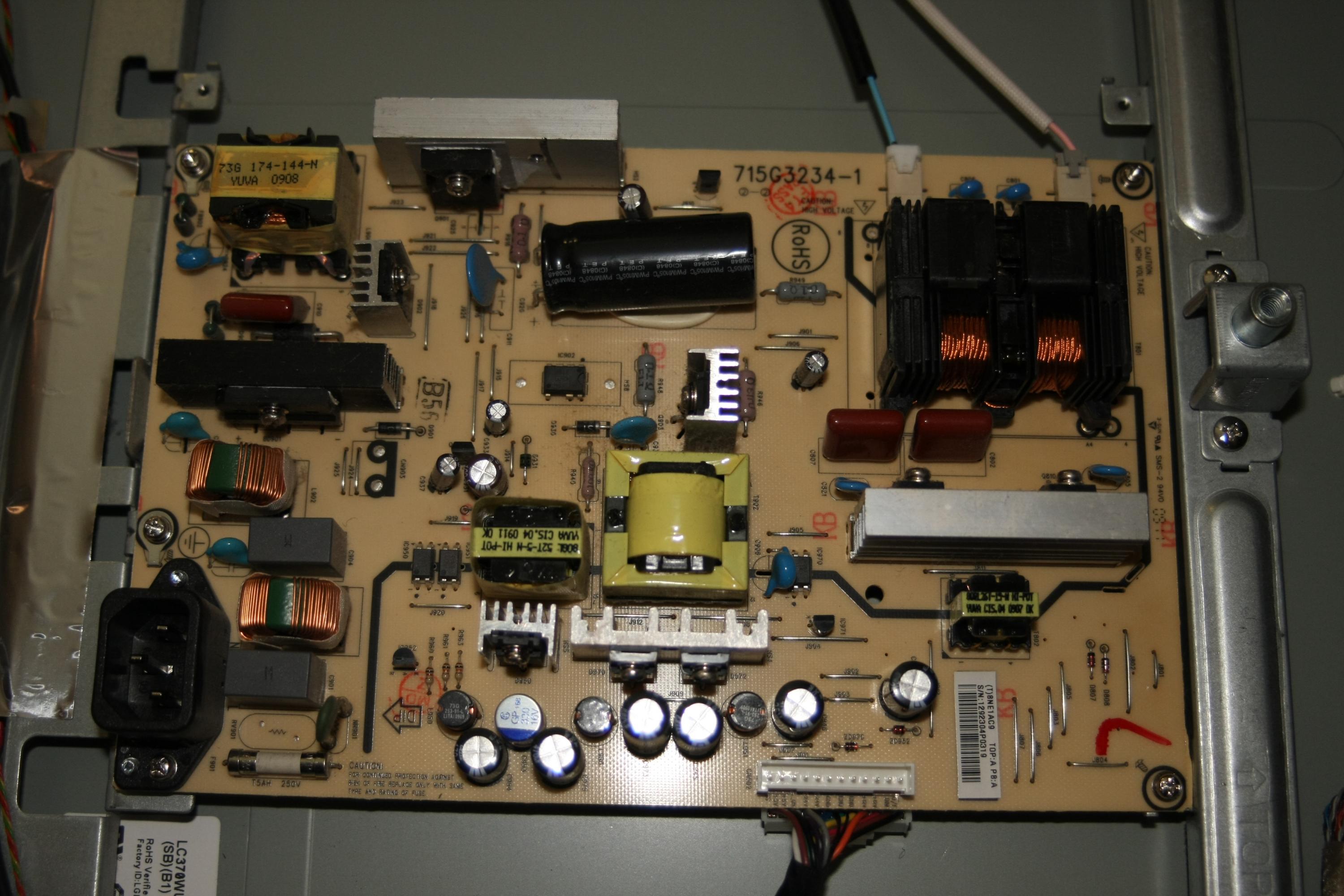

    I agreed to work on this one today and upon first inspection, there's no response from the power button on the side of the TV.
    I assume the front panel (where the power LED and, I assume, IR sensor are located) should have a standby LED (probably red?) but it does not.

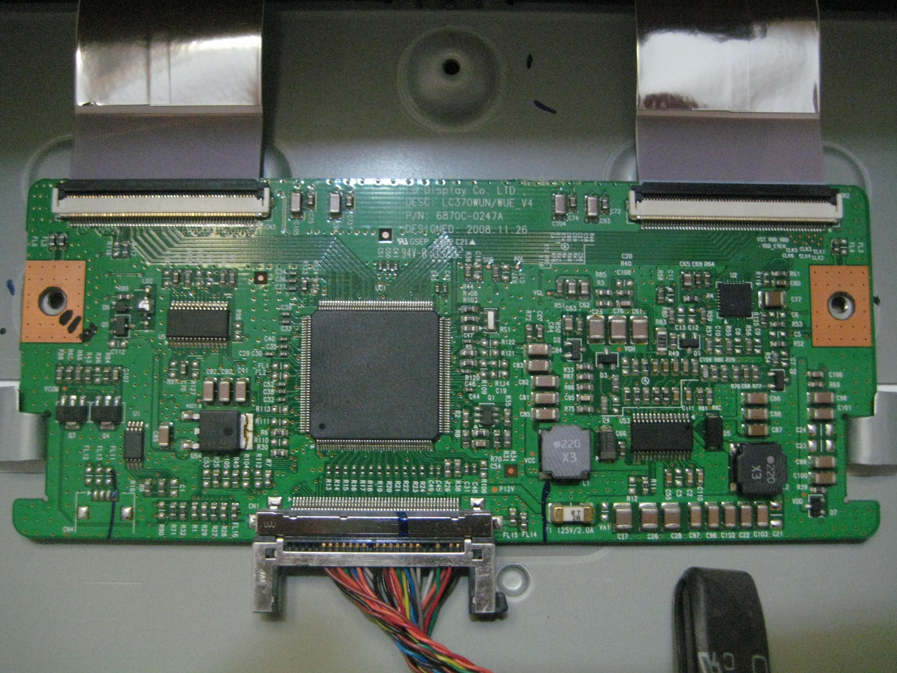

    There is a blue LED that lights up on the TCON board, though (never seen one there in other models... then again I haven't had my hands on very many). After plugging in the power cord, this light comes on for maybe... ~8-10 seconds, then shuts off.
    All caps "look" fine. I'm headed across town to pick up my multimeter to check fuses but I assume since power is finding its way to the TCON that the main fuse is fine and probably the SM fuse (on the TCON) is fine as well.
    Any closer/macro picture requests are very welcome.

    I tested the following:
    5v from psu (I assume standby voltage on this model) - OK
    power switch - functions fine via multimeter
    main fuse - good
    SM fuse on TCON - good
    Don't seem to be getting the (3.3v?) from the mainboard to the IR/Power LED board (obviously, it's not lighting up. )

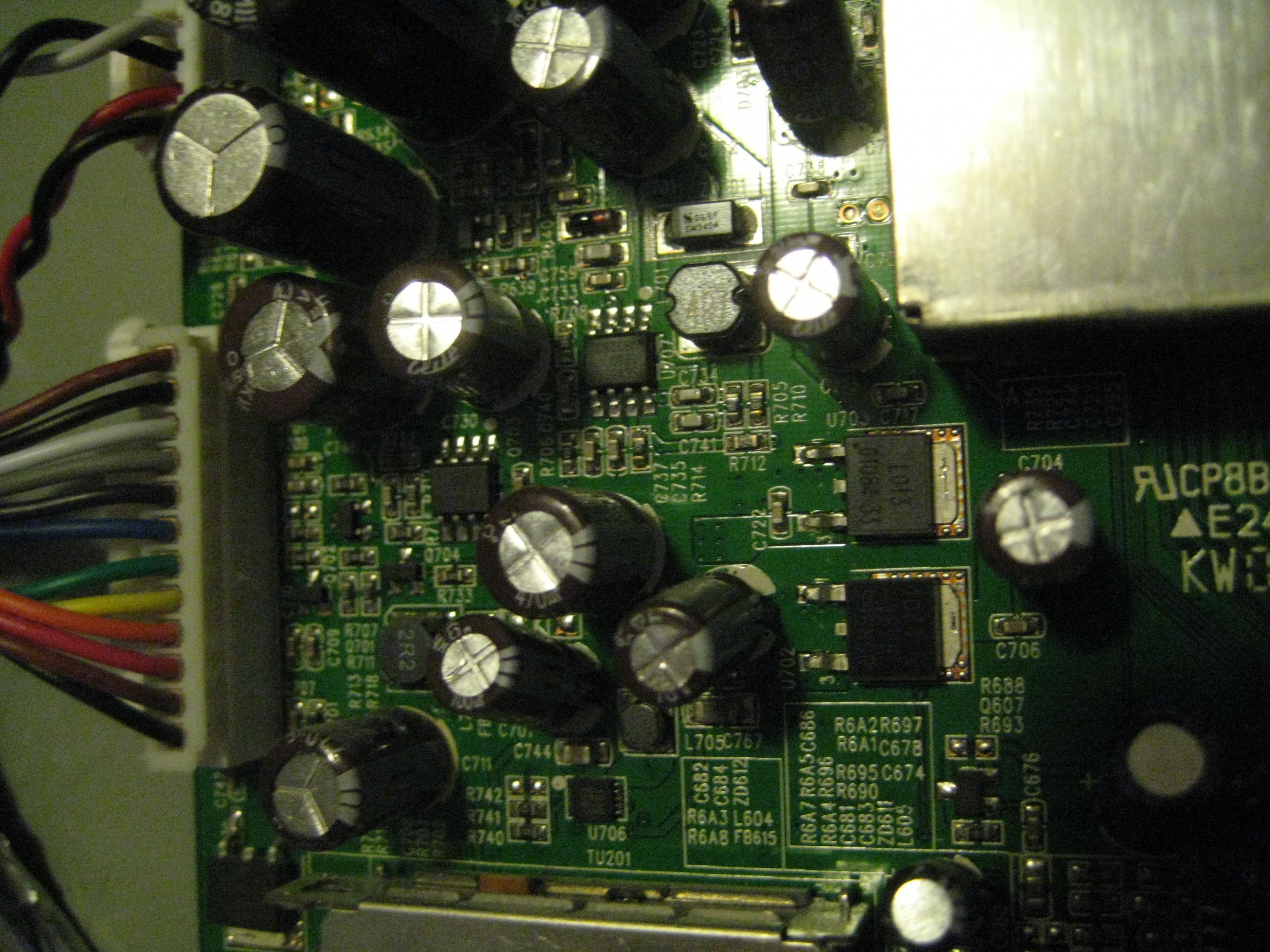

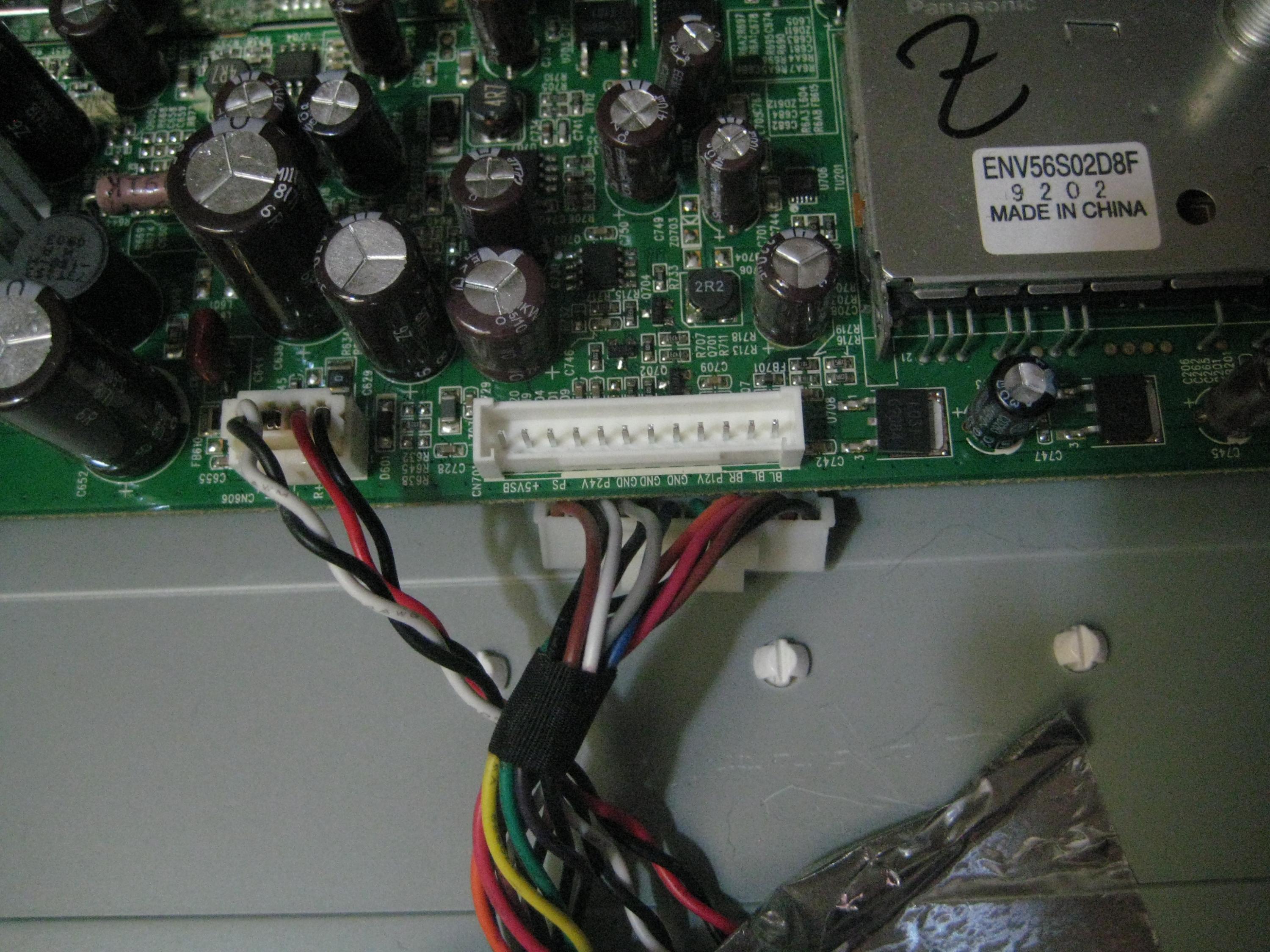

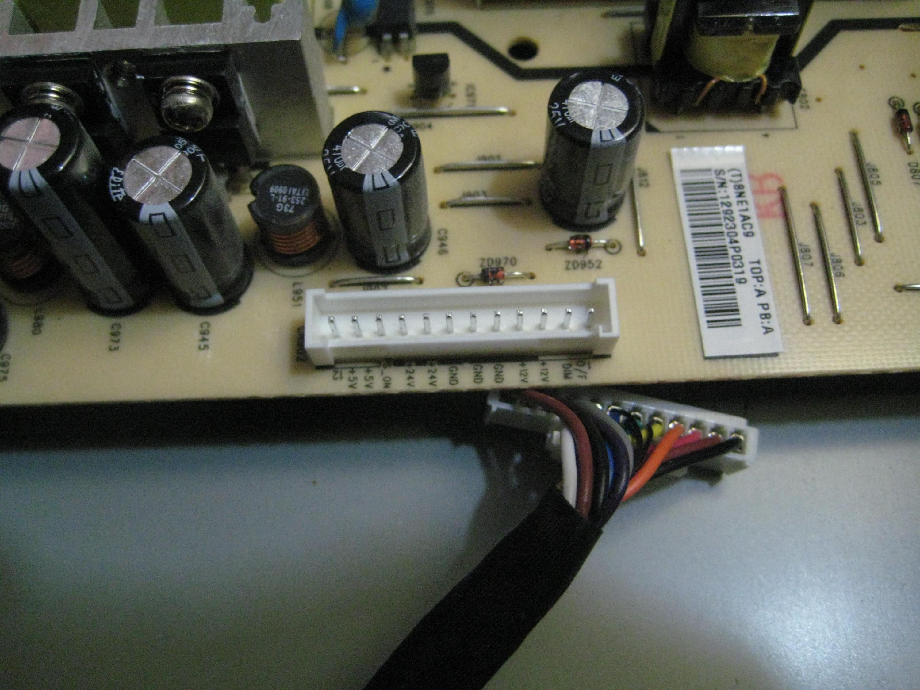

        Re: Insignia NS-L37Q-10A - No power (no standby light?)
        I assume I won't be getting the 12v or 24v (on the PSU->Mainboard connection) until the unit is "powered-on", and only the standby voltage (5v?) will show anything. Right? So -until- the Mainboard gives the "OK" to the PSU to fully power on, these will read nothing?
        The heatsink in the very center of the PSU gets fairly warm, and the one below it (center, bottom, two components on one heatsink) gets very slightly warm.
        the 5v pins seem to show a steady 5v (5.0xx volts from my multimeter).
        I think my problem is, right now, that the mainboard is not responding to the power button -at all- so it never even attempts to power-on (no relays clicking, nothing).
        My apologies for the poor pictures, hopefully these new ones will help.
        I'm afraid with the poor light in my current apartment I cannot get a clearer wide shot of the boards.
        The plug on the mainboard (green) that I left plugged-in is just the speakers.
          Scratch that, the 5v (standby) line is ~5.17v. Should be within reason right?
          I tested the 3.3v lines (from the mainboard to the IR/LED/front buttons) and read about 0.4v on both spots. (top+left plug on the second picture, first post)
          So the PSU is giving the mainboard the proper voltage for standby, but the mainboard isn't using that voltage somewhere in the line?
            (I know in most forums double, even triple-posting is bad... but I see no other way to add info to this thread and I apologize for this)
            I shorted PS_ON with the 5V line and then tested the 24v and 12v lines, which put out a steady 25.1v and 12.02v, respectively. It appears the PSU is functioning correctly... however the backlight did not fire-up - should it, or is there another switching function I should apply?
              There is a BLON line which needs connecting -- safest to use a 100 ohm resistor between 5Vstby and BLON as it is sometimes 3V logic, the resistor will limit the diode clamp current to safe limits.

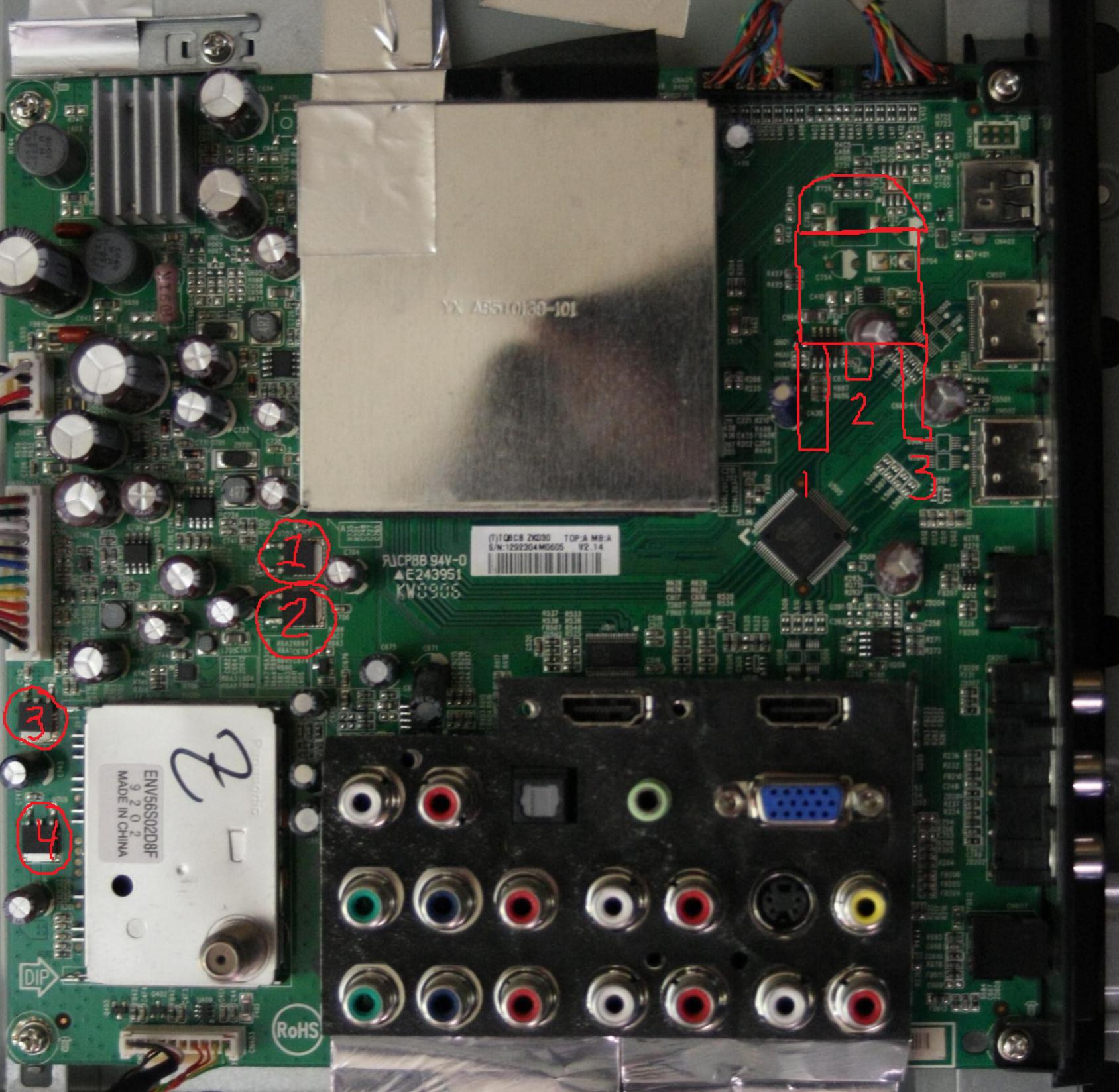

                        I'm still dissecting this information, but I figured I'd post it now while I try to understand it all.
                        Attached picture has components numbered and a diagram for how I counted the pins (basic left->right as described in the link above).
                        1
                        L013
                        G1084-33
                        http://www.datasheetarchive.com/G1084-33-datasheet.html
                        -1. 0.2mv (0?)
                        -2. 0.732v
                        -3. 0.980v
                        2
                        1804-18PE
                        995H8R
                        -1. 0.2mv (0?)
                        -2. 82.3mv
                        -3. 0.450v
                        3
                        L031 (not to be confused with "L103" above, for #1 - I'm sure of this).
                        G9084
                        -1. 6.92v
                        -2. 8.16v - within spec (6.92v+1.25v=8.17v)
                        -3. 12.0v
                        4
                        AZ1117D
                        902K77
                        -1. 0.4mv (0?)
                        -2. 4.96v
                        -3. 8.16v
                        Thoughts:
                        #1, if following the link posted just previously, appears to be a 3.3v reg and is obviously not putting out anything near that.
                        #2, also does not match up with anything respectable. Definitely not correct if following this thread https://www.badcaps.net/forum/showthread.php?t=16780 (same model, same components, different problem, see post 5 for #1/#2, and 8 for #3/#4).
                        #3, looks good!
                        #4, at least matches the thread mentioned in #2...?
                        SHORT ANSWER - components #1 and #2 (labeled per my attachment) are way, way off - not even hitting 1v on any pins.
                        Should I replace these or be looking for something else that could be possibly causing the low numbers earlier in the circuit?
                        Hope this helps. I'm having quite a bit of fun working on this one. Love a challenge!
                        Thanks in advance.
                        • retiredcaps
                          • Apr 2010
                          • 9271
                          Originally posted by alecjahn
                          4
                          AZ1117D
                          902K77
                          -1. 0.4mv (0?)
                          -2. 4.96v
                          -3. 8.16v
                          4 looks bad. Double check your readings for 4.

                          • pedro
                            • 199
                            • AUSTRALIA
                            1
                            L013
                            G1084-33
                            -1. 0.2mv (0?)
                            -2. 0.732v
                            -3. 0.980v
                            2
                            1804-18PE
                            995H8R
                            -1. 0.2mv (0?)
                            -2. 82.3mv
                            -3. 0.450v
                            Thoughts:
                            Those two regs are not getting source voltage so they can't put out their spec, and are *probably* fine. You need to look "upstream" from them to find out where their supply is and what is wrong with it.
                              Double checked and that's exactly what I'm getting today, too.
                              I was figuring this was probably the case. Guess I need to poke around. I'm not sure how well I'm going to be able to follow the circuit but I'll do my best. I've got plenty of time this morning.
                              As a little bonus info, I hear a faint buzz/hum coming from the main board, though it seems like it's coming from the RF/Cable box, which I could see being nothing notable.

                              • alecjahn
                                Dumb enthusiast
                                • Feb 2012
                                • 77
                                I measured the impedance between each pin on reg #2 and it is shorted in every direction. (p1-p2=0, p1-p3=0, p2-p3=0). (this also concludes that all pins, 1,2,3, are shorted to ground)
                                • pedro
                                  • 199
                                  • AUSTRALIA
                                  That is not consistent with the voltages you reported, unless it has died since then ....
                                  Friends don't let friends buy Samsung ....
                                  • alecjahn
                                    Dumb enthusiast
                                    • Feb 2012
                                    • 77
                                    You're totally right.
                                    1-2=0.9ohms
                                    2-3=1.3ohms
                                    1-3=0.9ohms.
                                    Looks like I had my multimeter still on the diode check function, whoops.
                                    • alecjahn
                                      Dumb enthusiast
                                      • Feb 2012
                                      • 77
                                      Overdue update:
                                      I broke down and just ordered a new motherboard off of eBay. It fixed it right up. Bummed I couldn't manage to repair the original, but the TV is back in action in its new home.
                                      Thanks for everyone's help.
