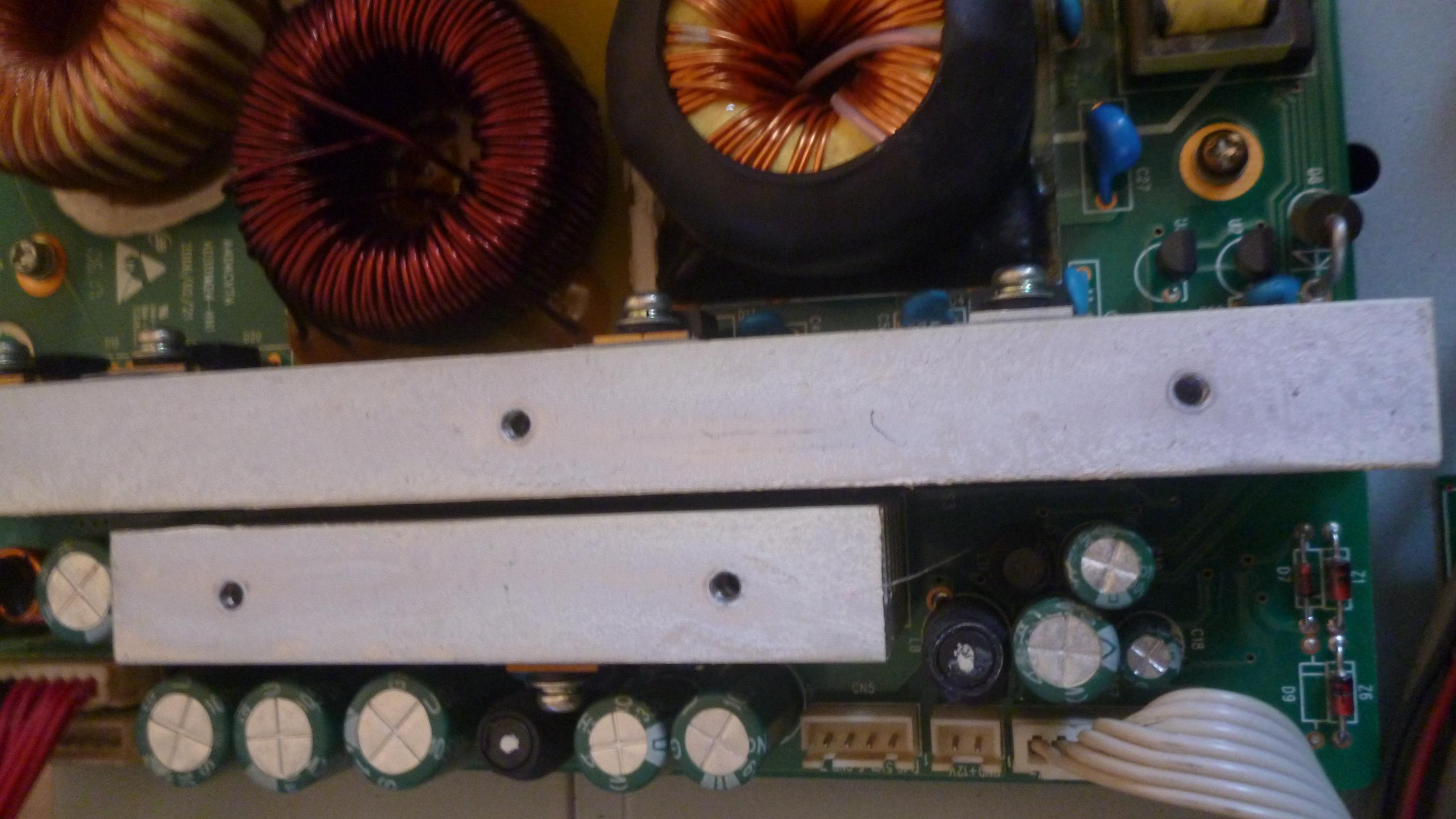

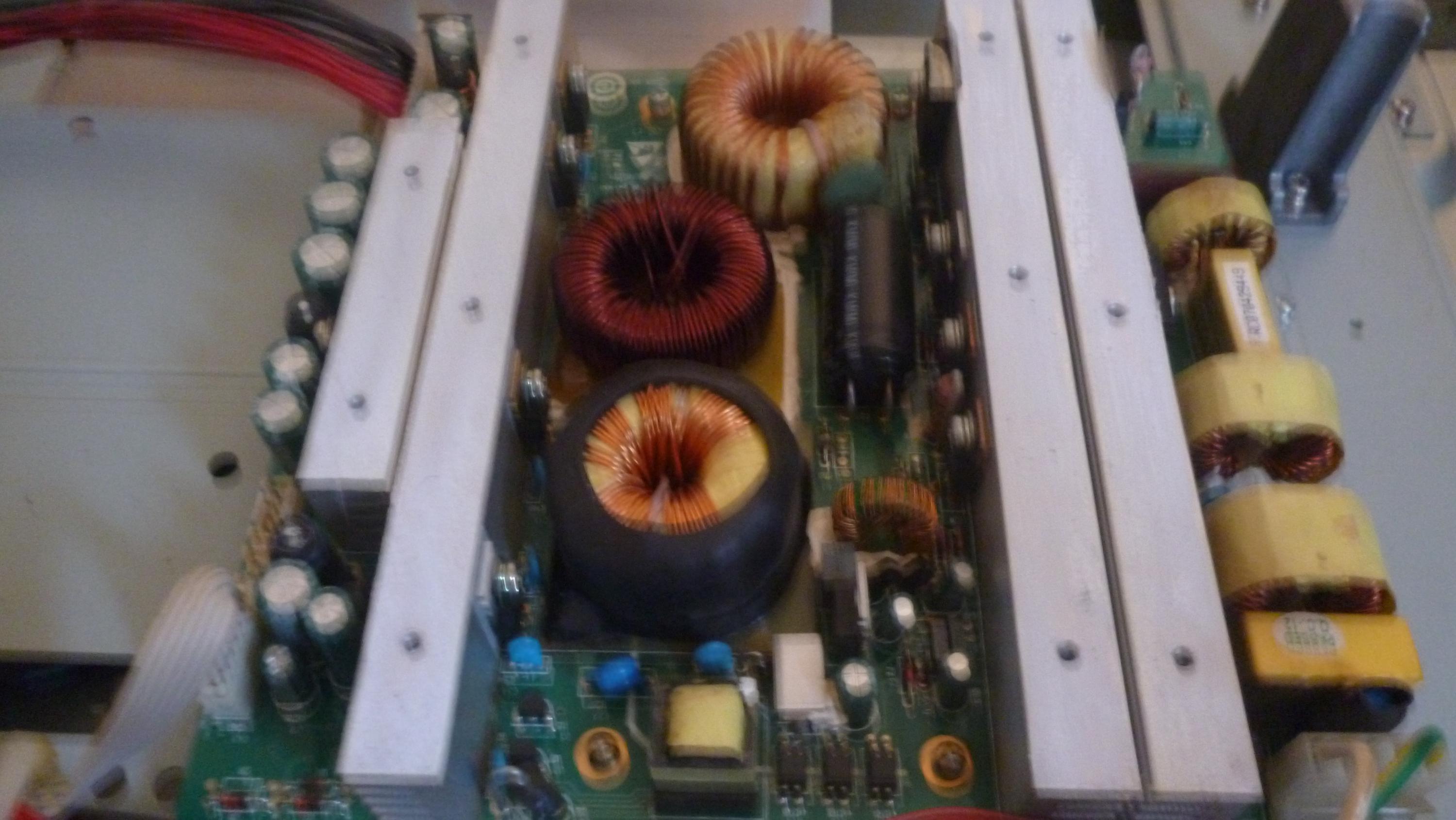

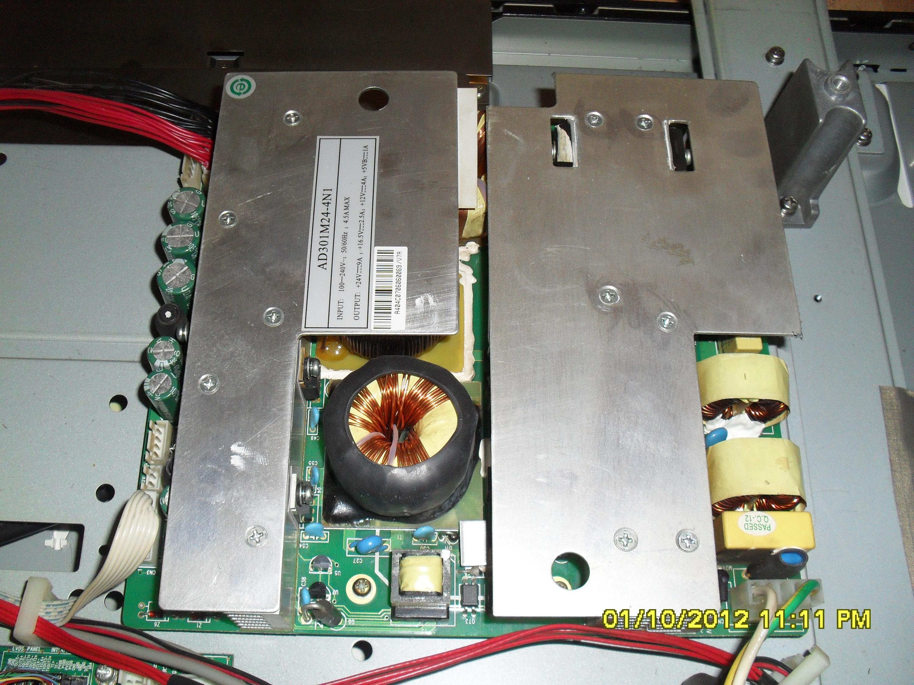

          Re: Issues with Bauer XT37

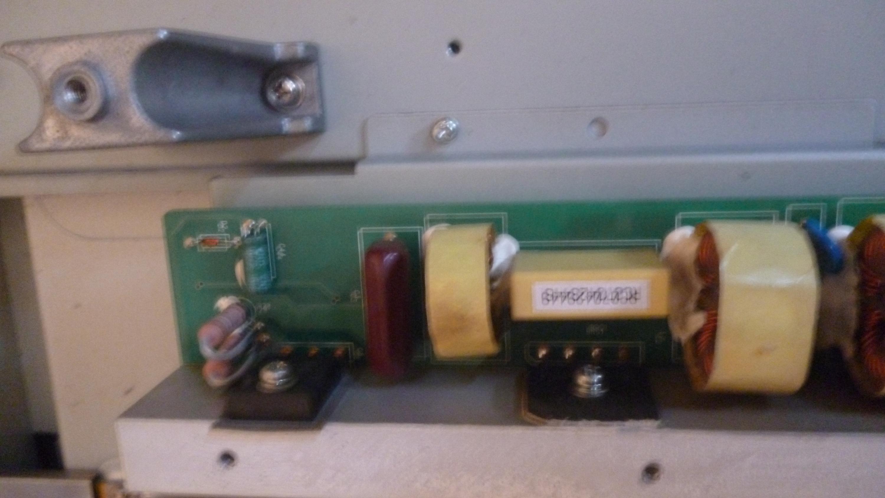

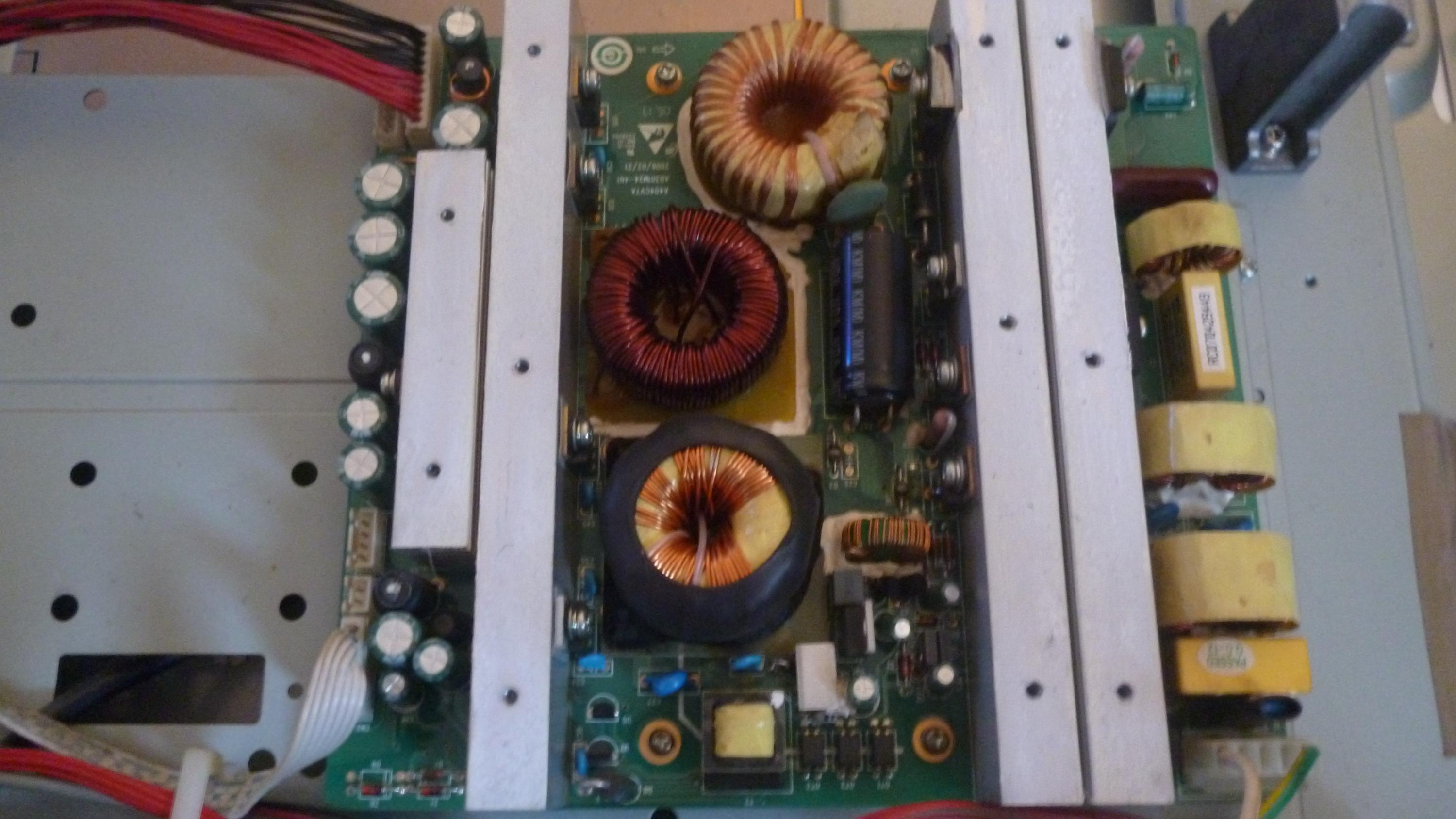

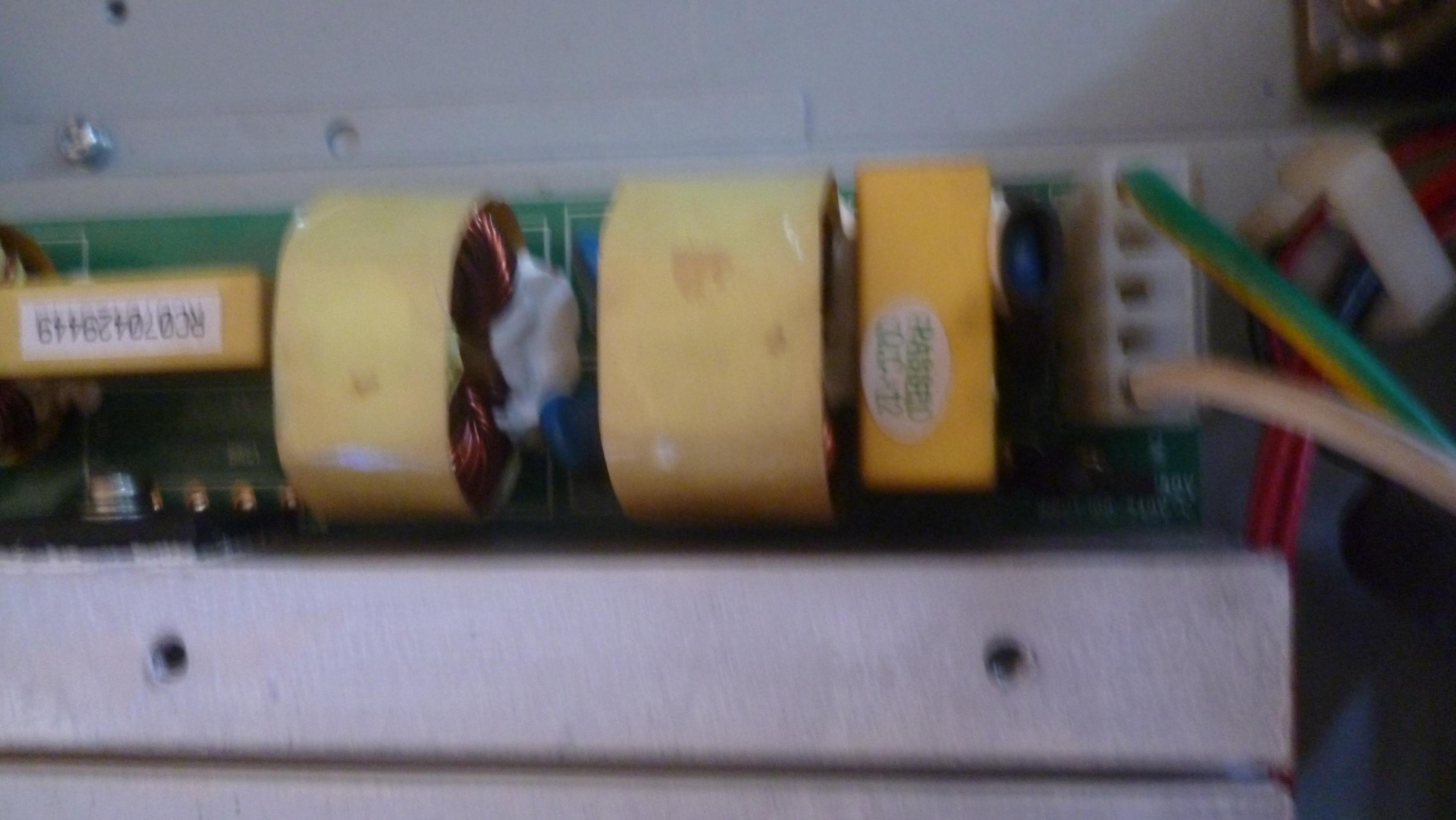

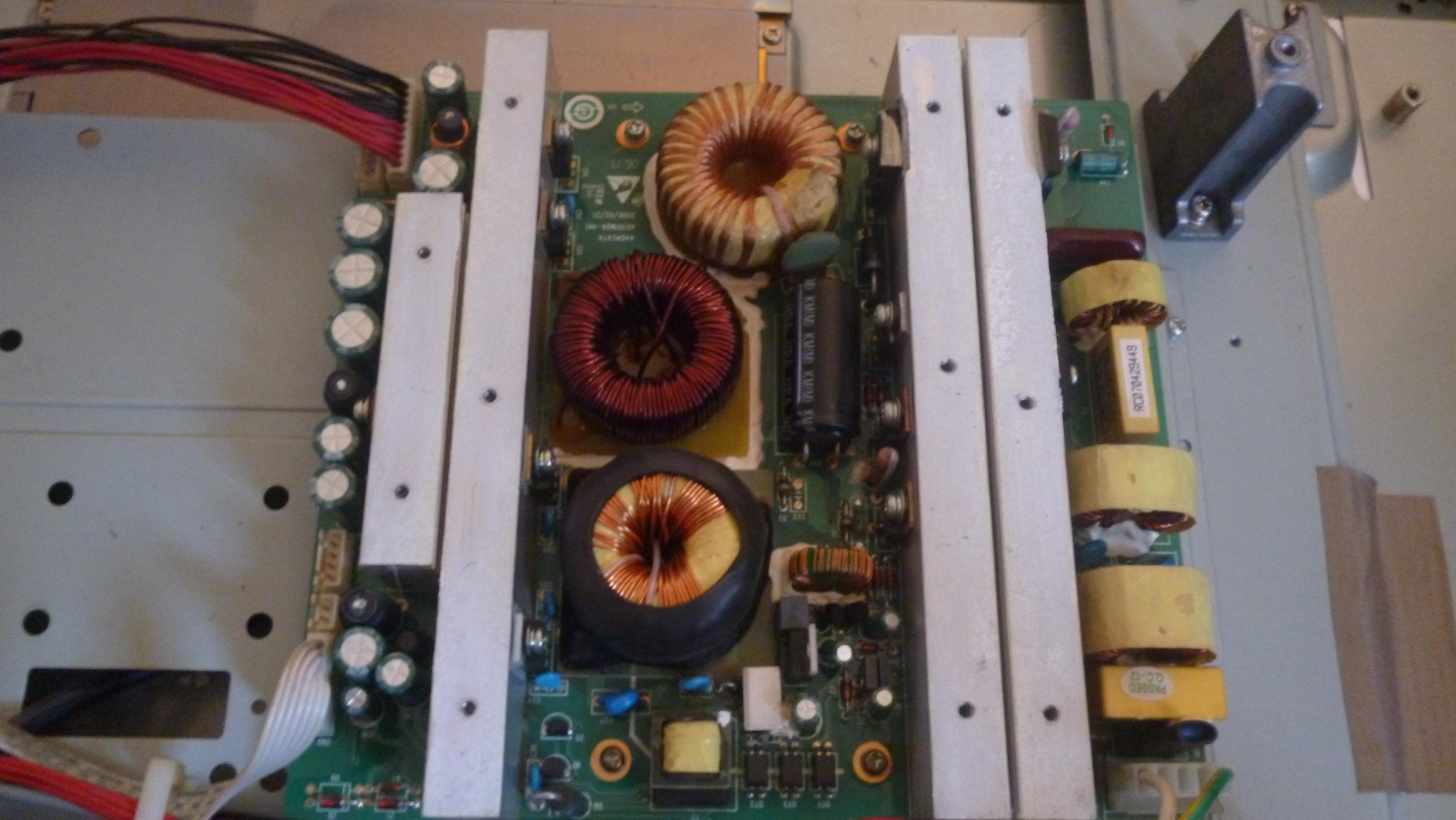

          some pictures of the power board. will i test all the pins ?
                  I have no idea but bearing in mind you have no back light you are going to want to look at the inverter board in any case.
                  If you want us to look at it take a CLEAR picture half of those above are out of focus
                  -do you look at them fullscreen before you post them?

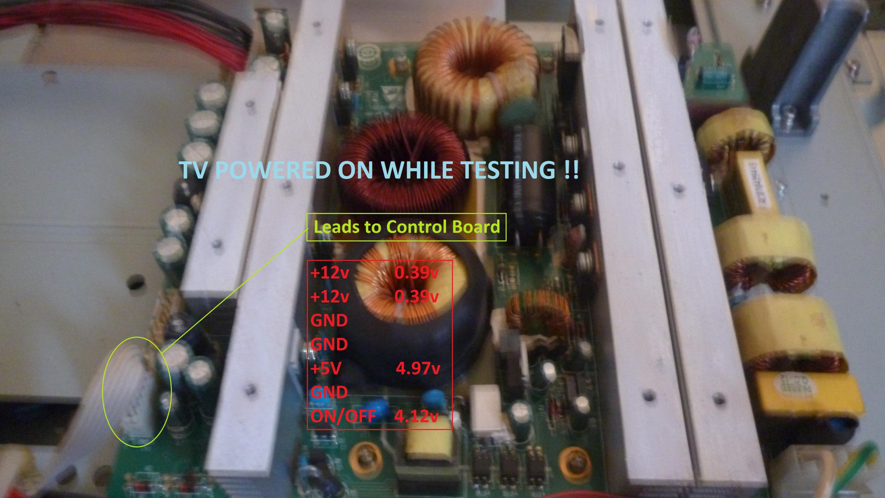

                    yeah mate i check them out fullscreen. i have posted a picture of the results. had tv powered on and WAS NOT in standby

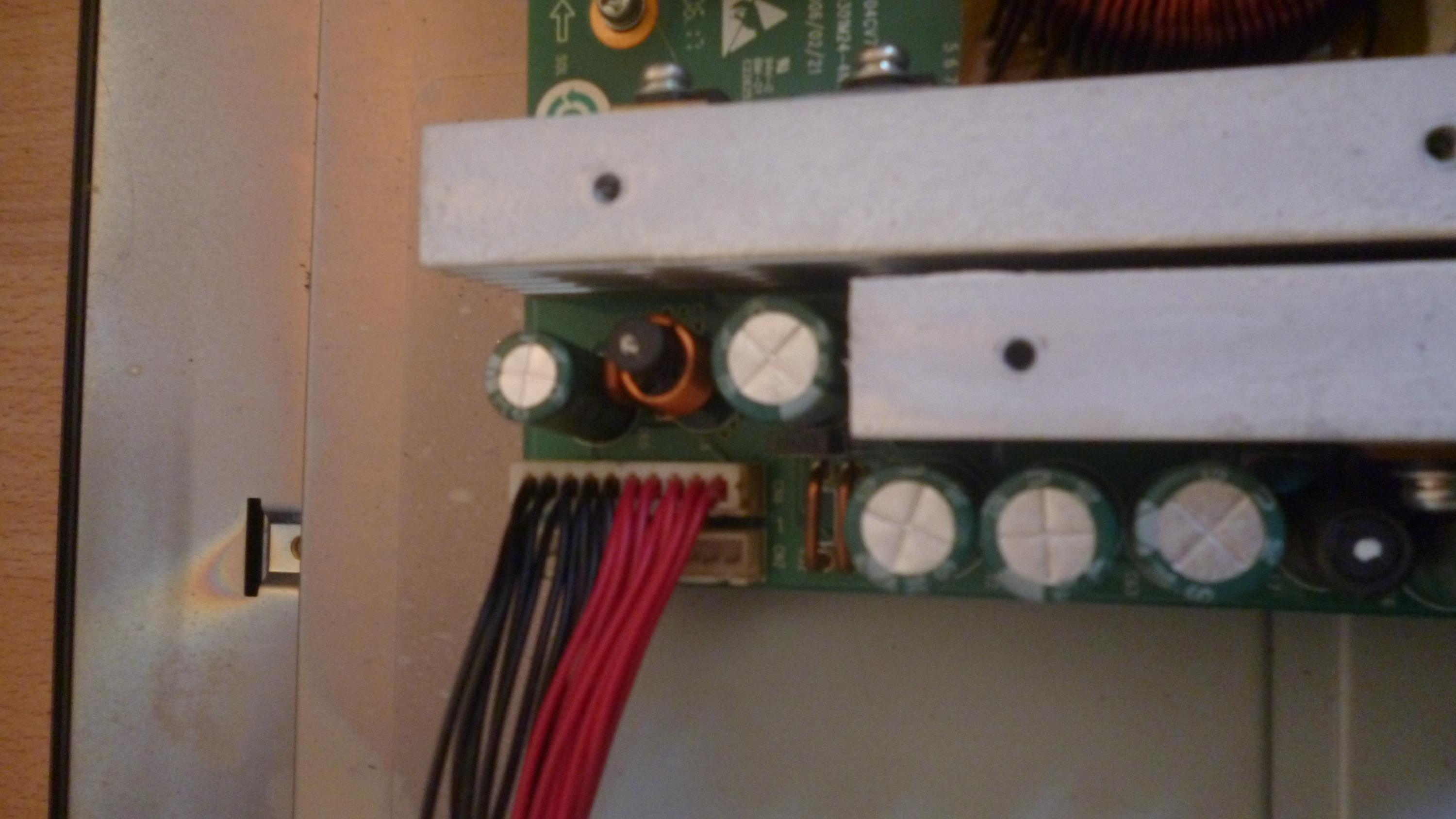

                      The colour of the wires is a good clue, red positive/black negative going to inverter, you need no more information given "every" inverter is 24V rated.
                      Seems like you are missing all except standby. Check those voltages (a post with text is all that is necessary) with both TV in standby (immediately plugged in) and after pressing the power button.
                        So are you getting 380vdc on that large 450v black cap? If not, the PFC is not working, not 100% sure since picture is not clear but it does look like it has the PFC.

                          You better get to specsavers - it seems neither bud nor I think they are clear
                            Or myself. Invest in a decent camera and consider taking pictures in sunlight or under a bright light to shorten the exposure time.

                                getting 333v from the 450v cap when tv is switched on ? the one that was there looked to be bulged so i replaced it with a new one

                                  put black probe on chassis and red on pins as normal and all red ones returned 0V
                                    That voltage should kick up to around 380~390VDC if the PFC booster is working, right now it is not working.
                                      We still do not know if PSON is coming on though as he has not indicated the voltages in both states on the main board connector.
