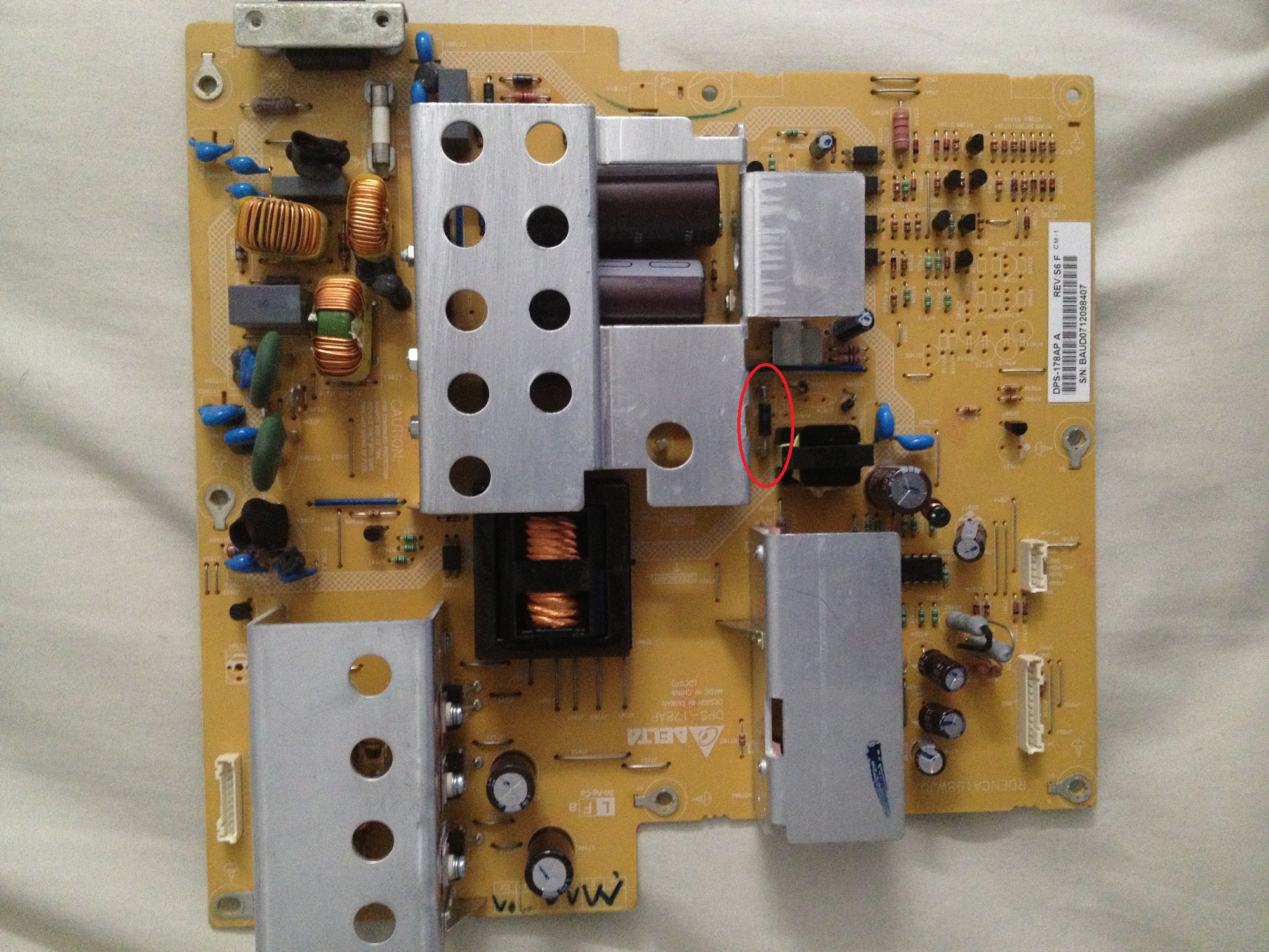

    Found this on 'net:-
    Dead - no standby:
    Replace zener diode D7907. Diode is in the standby 5V primary side of the power supply. Zener is 150 volt 5 watt.

      Re: LC-37D43U Sharp LCD, No power No standby lights
      Ok, its rated 47uf at 50v. Doesn't seem to look bulged. Luckily using my new ESR meter I'm getting a measurement of 47.84uf and ESR = 0.18 ohms.
        See above. That cap is probably not the cause.

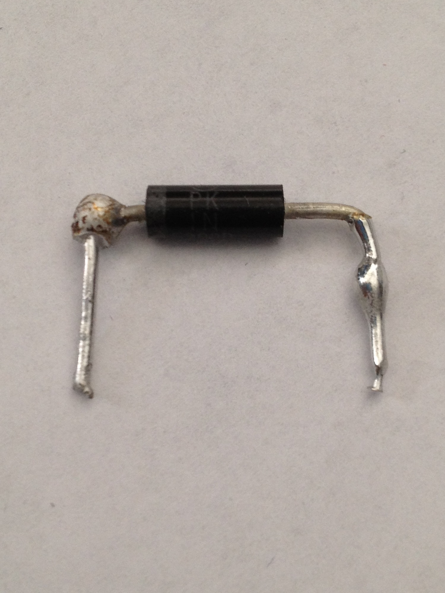

          Found it! D7907 I pulled it out of the circuit and took its measurement.
          Its labeled:
          PK
          IN
          5383B
          0652
          Using the Diode setting, I'm getting 72 ohms in both directions.
            That is the Snubber Diode to protect the 5V STBY SMPS IC, hopefully the IC is not damaged. You should take the resistance reading of that 7-pin SMPS IC between pirmary ground and all the pins.
            Sharp uses a lot of this power supply setup.
                Nice photos budm! Were you able to repair it by replacing the diode?
                I took some measurements of the 7 pin IC (with the bad diode still removed out of the circuit). Using black probe on the negative pin of the large capacitor as primary ground (from photo in post #2) and red probe on each of the pins.
                I'm getting 0.04 ohms on the circled pins, and the other pins I'm getting a "1" i think out of range for my meter on the highest setting of 2M.
                I just made the order for the diode. I'll let you guys know how it goes when I replace it. Thanks!
                  You can see those pins are connected by copper so they should appear shorted.
                  Test that island (isolated) pin to one of the ones you have highlighted.
                      Bottom left on this image -- it's isolated from the rest.
                      https://www.badcaps.net/forum/attach...6&d=1364837410

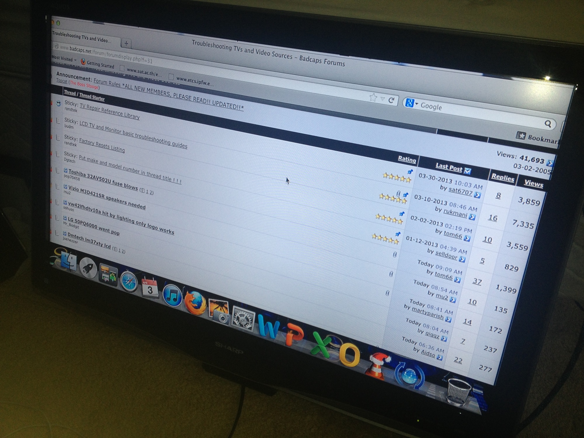

                                    Just replaced the diode today, and the TV is back to life!
                                    Thanks for all the help guys!
