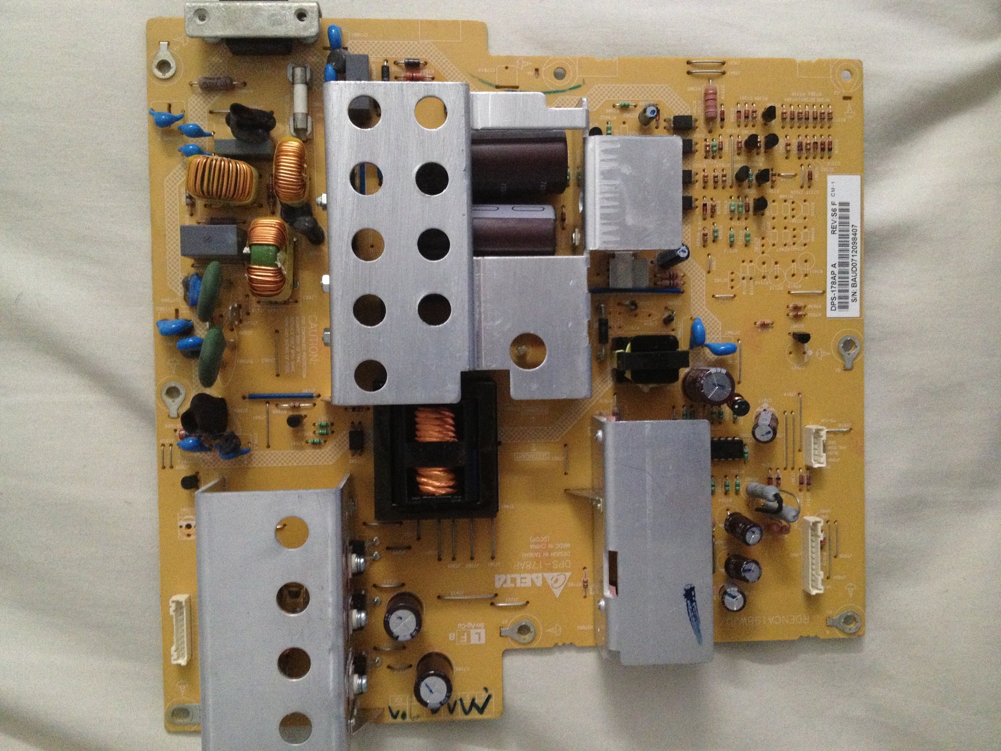

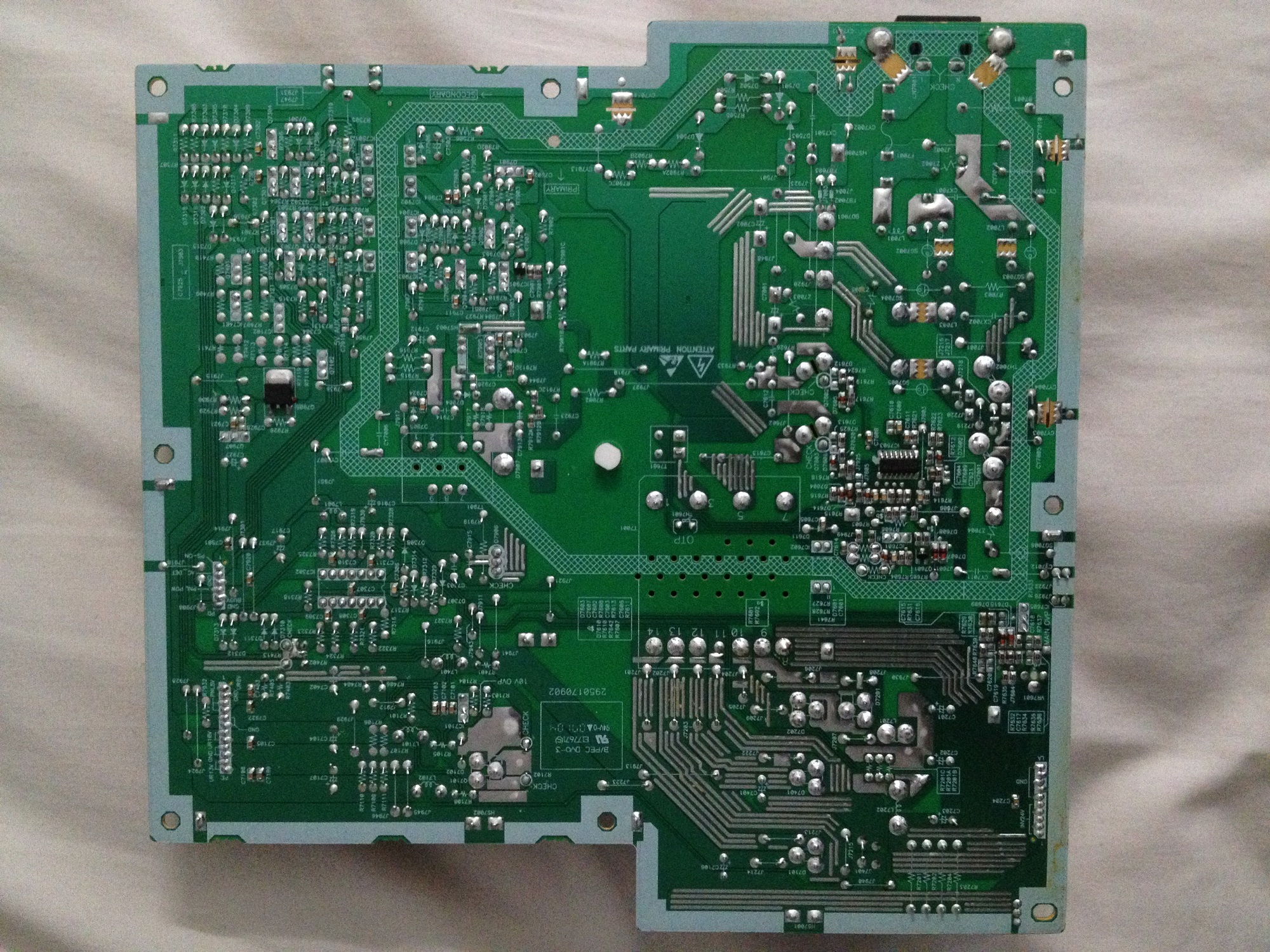

    Hey I need a little help with this Sharp 37" LCD TV. I opened up the TV, there are no bad caps that I see anywhere. I checked the 5V output and there isn't any. I tried probing around the board and I can't seem to find any voltages anywhere, on the secondary (If i did it right, black probe on ground and red probe on the board)
    There are two large caps on the power supply and I checked the AC voltage on both and they measure about 169V, so I think the 120VAC is going into the board fine.
    What am I missing?
    and thanks for the help.
    Re: LC-37D43U Sharp LCD, No power No standby lights

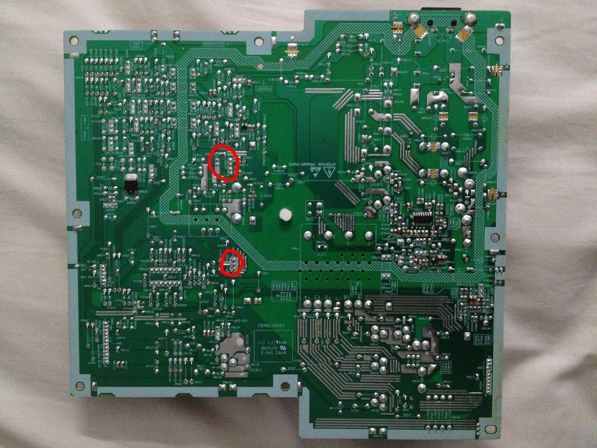

    I've highlighted some resistors.
    The two smaller ones: Check the resistance and see that it is under 100 ohms.
    The larger one: Check the resistance, and also with the power supply powered (mains connected) check the voltage on both ends, red probe on each end, black probe on primary ground.
      Thanks for the fast reply. on the first post I made an error, the voltage on those two biggest caps is actually oscillating between 162.0V-162.8V (not 169V)
      I measured the two smaller resistors (in circuit) and they both measure 0.4 ohms.
      The larger resistor measures 2.5 ohms. Measuring the voltage on both ends of the resistor I get about 162.0V-162.8V DC on both sides.

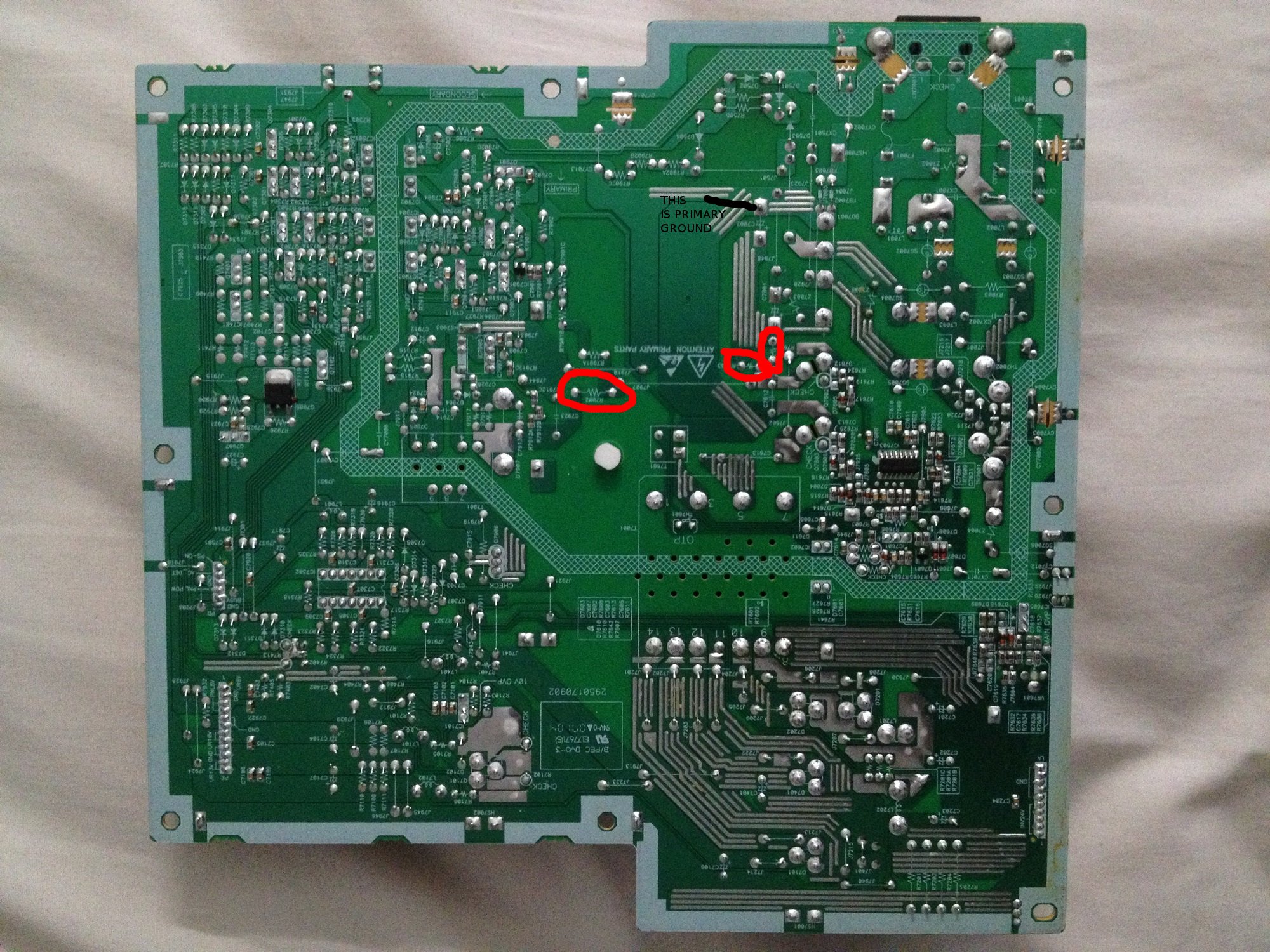

        162V is still fine.
        Those resistors are fine too.
        See image:-
        3 pin device = Should be a diode. Check for shorts between pins 1, 2, and 3. (1->2, 2->3, 1->3) and read off device code.
        7 pin device = Read off device code.

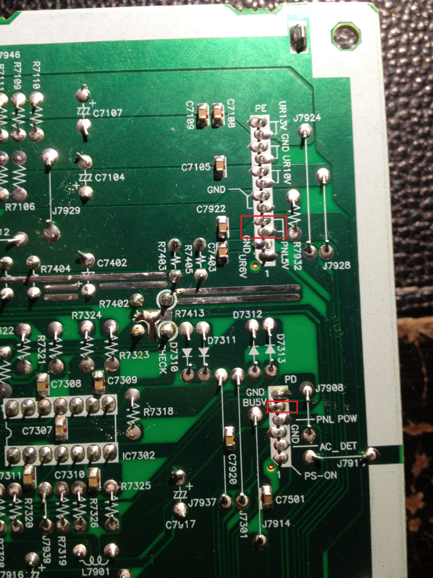

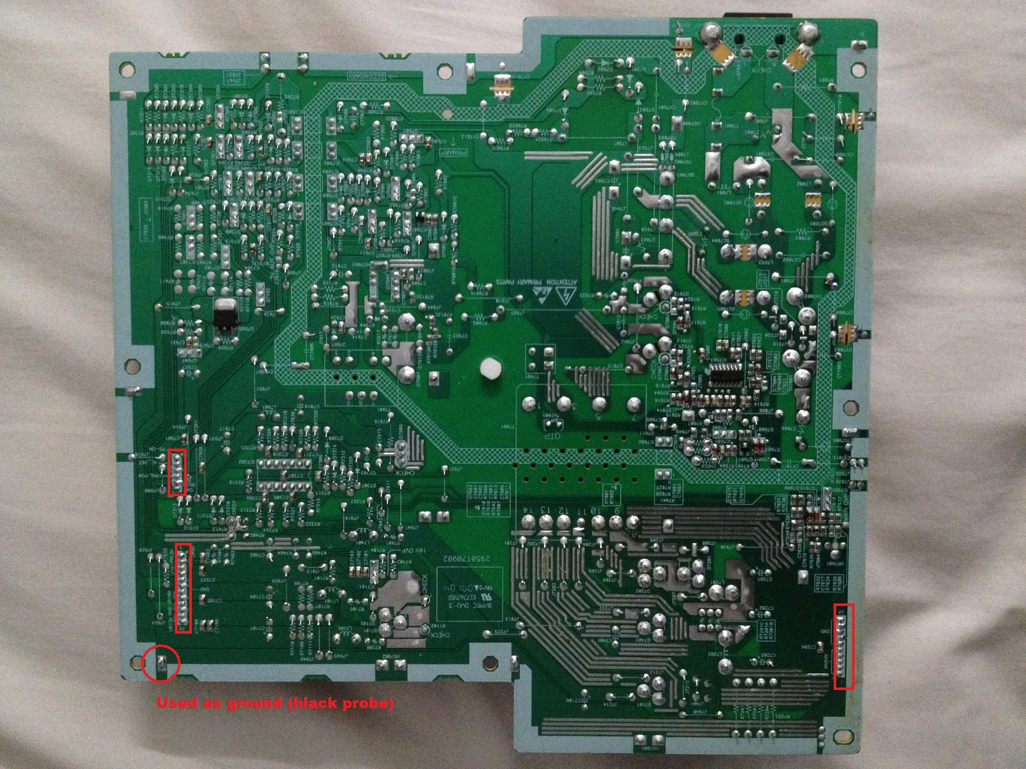

              Is it these pins? Whats the best way to measure these pins? I have the board out of the chassis right now, does everything have to be plugged in to order to get the readings?
                Probably not...
                Just check along the connectors going to the main board from the PSU. Each pin. If you find 5V, the PSU is giving a standby output.
                • Glitcher
                  • Mar 2013
                  • 673
                  • USa

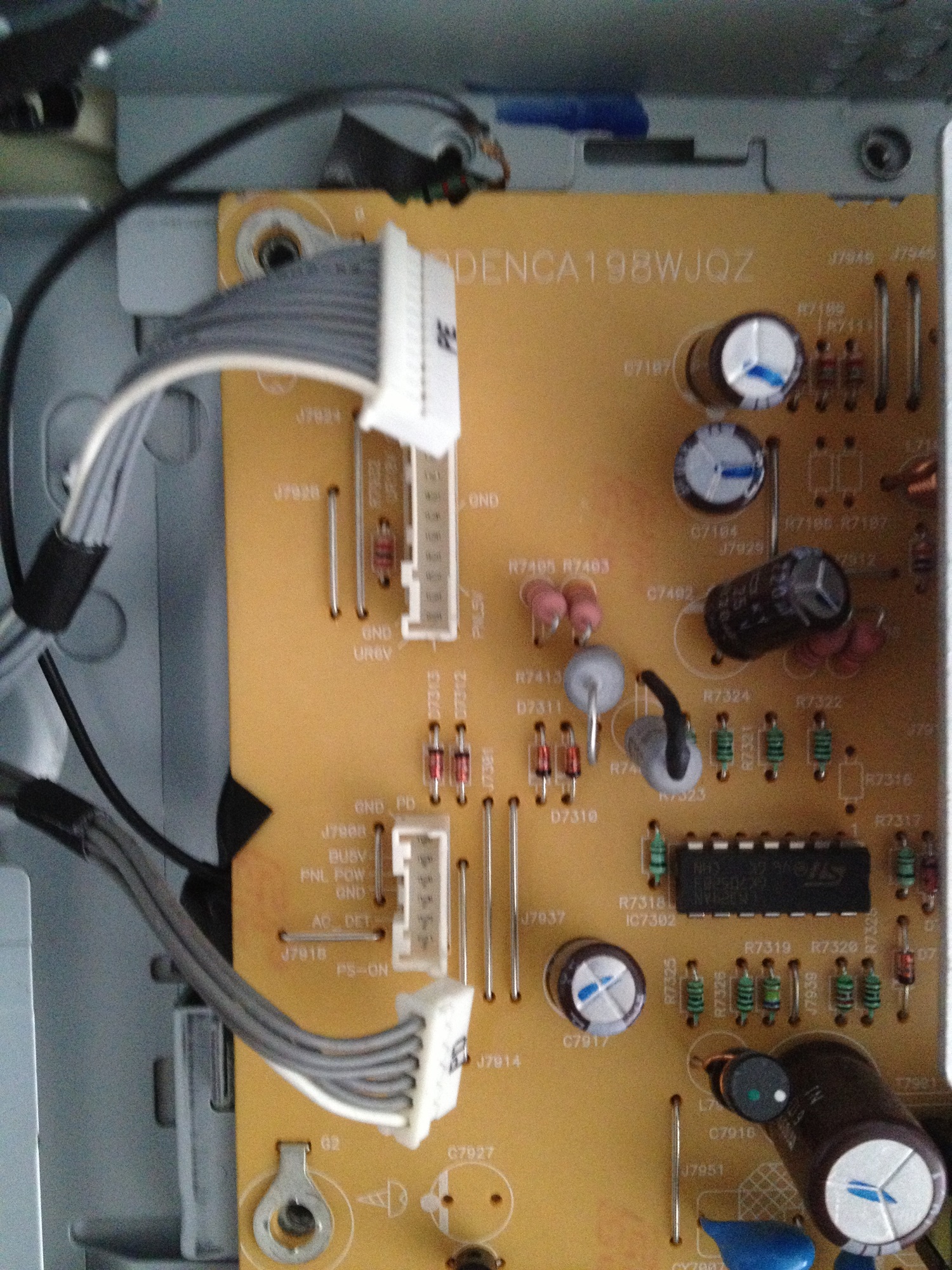

                  Ok so, I have the PSU board out and with only the main AC plugged into it. I'm measuring all the pins showed, with black probe on the metal piece where the screw hole is.
                  It all reads 0V except for the pin labeled BU5V, which measures oscillating between 0.29V to 0.33V
                    Ah, the low oscillating voltage tells me one of three things

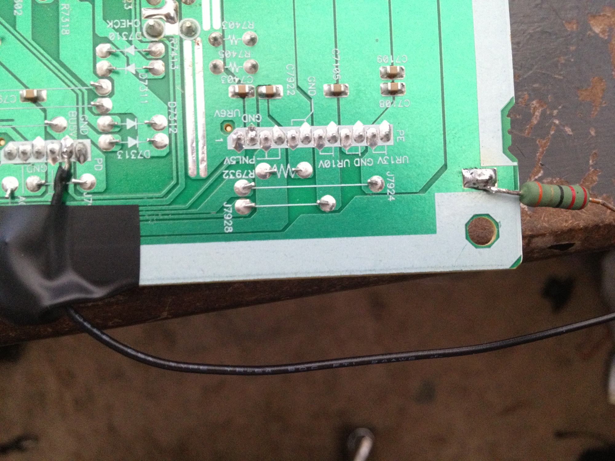

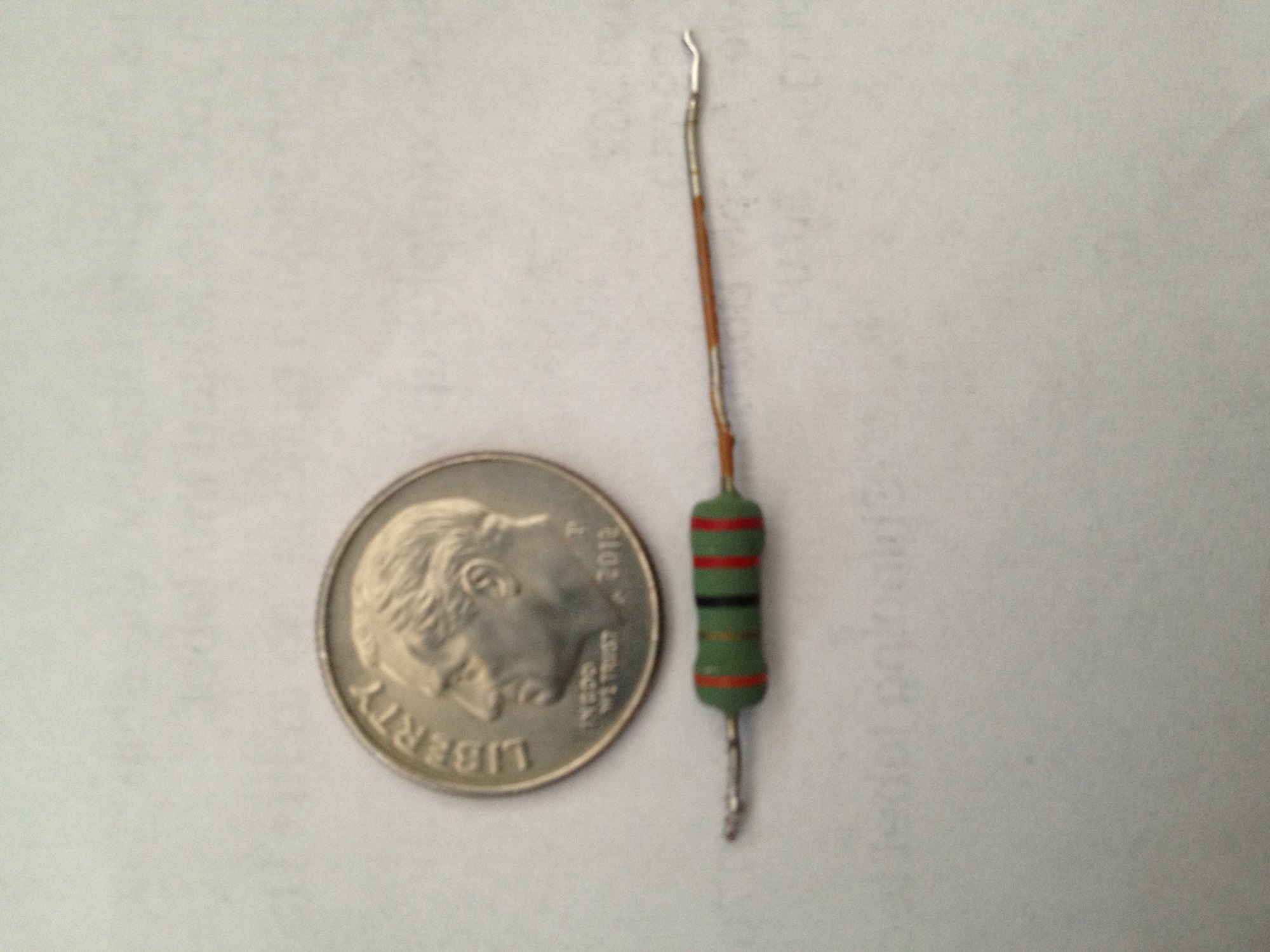

                              Ok so hopefully I did this right. I soldered one end to the BU5V and the other to the screw hole as seen in the photo.
                              I disconnected the two cables shown that go to the main board.
                              Measuring with black probe on ground and red probe on the BU5V I'm now getting a measurement of oscillating 0V to 0.09V.
                                Hmm, seems to indicate a problem with the PSU. Can you try a 100 ohm resistor too? Just to be certain...
