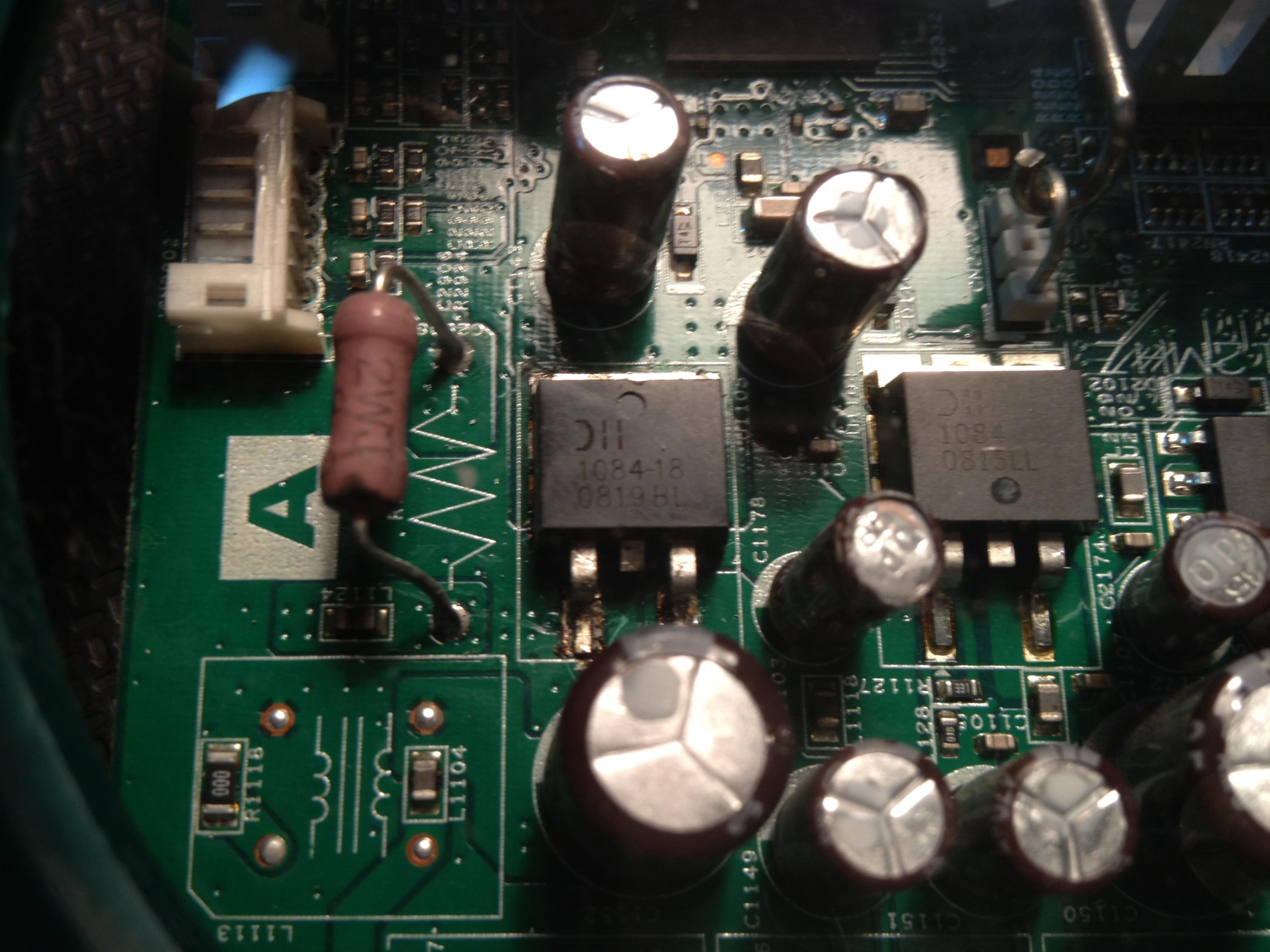

cant find one on google
what name is the company of this regulator
Re: what name is the company of this regulator
You've probably already worked it out but I'm thinking one is a 1.8V reg, the other adjustable. , I'm sure there'll be a number of manufacturers of it.
No ideas for those markings
EDIT: Diodes Incorporated, exact match below AP1084Attached FilesLast edited by tw2005; 03-28-2013, 06:08 PM. -
Diodes Inc. , probably AP1084-18 for the one on the left:
See the last pages, logo is very similar if not identical.
Anyway, it's a "jellybean" regulator, any low drop voltage regulator with 1084 in it will do ... the one on the left is 1.8v fixed ( hence the -18 in name) , the other is the adjustable version ( -ADJ or nothing, no hyphen something)Comment
http://www.digikey.ca/scripts/dksear...48=87&PV16=848
http://www.digikey.ca/scripts/dksear...07=68&PV16=848
From what I can see, yours looks like TO-263 package but you'll have to check thatComment
What voltage reading are you getting between the ADJ pin and the Output pin on the Adjustable regulator, it should be 1.25V.
The output voltage should be = to the reading of Adj pin and ground + 1.25v = output.Never stop learning
http://www.badcaps.net/forum/showthread.php?t=24809Comment
