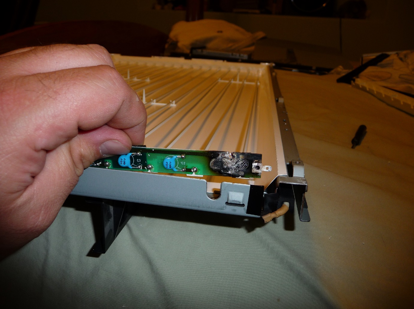

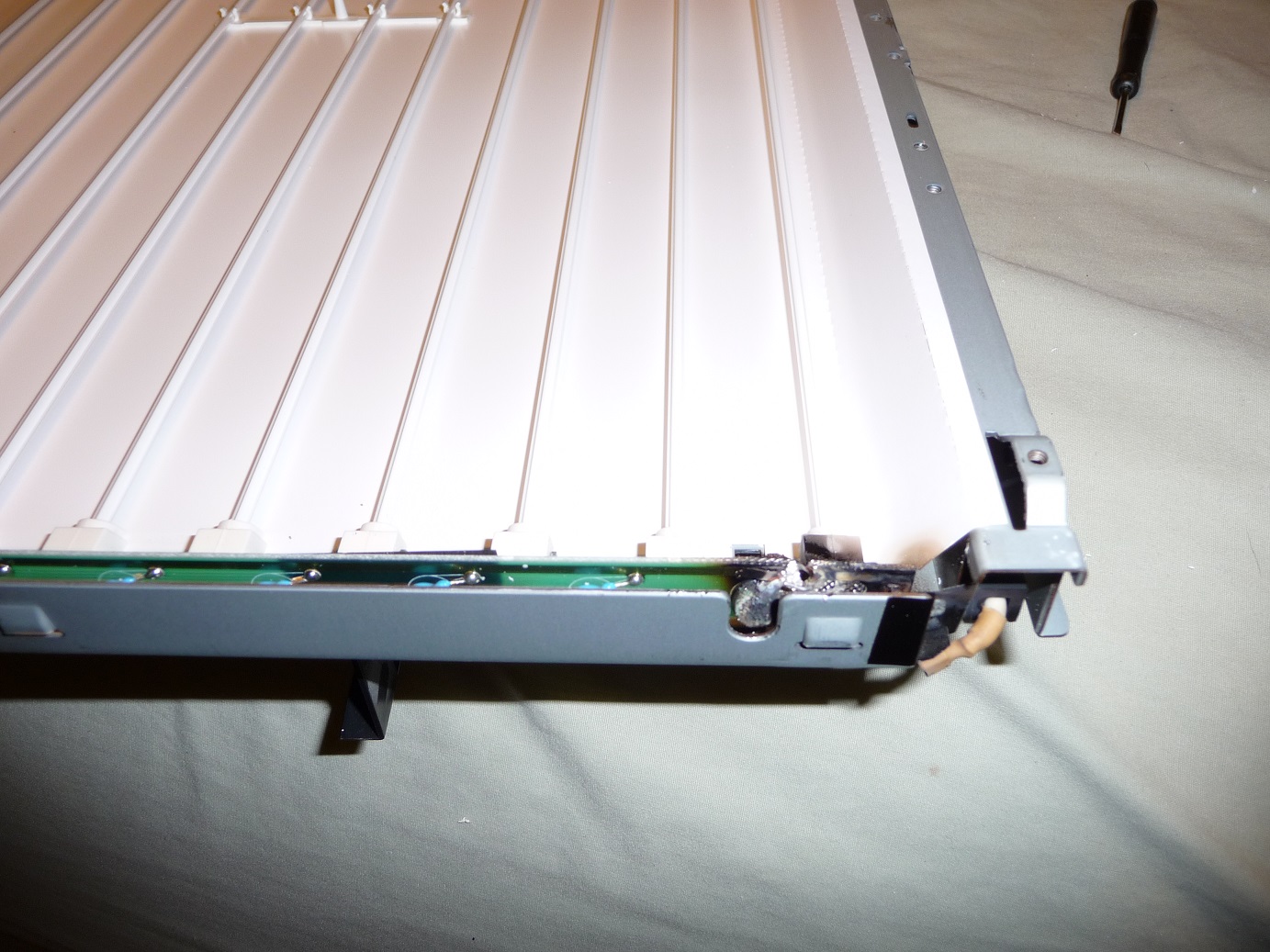

    Ok so I am working on a POLAROID TDA-03211C. Backlight issues. Recapped the PSU board. Replaced all caps, larger ones were blown. Still backlight will not stay on and red light on PSU flashes red. Thanks to these forums I checked the circuit board inside the lcd panel itself where the ccfl lamps solder into. And sure enough near the top on one of the boards where the high voltage wire from the PSU board connects, there had been arcing and it burned out a ceramic cap and burned the trace and made a hole in the board. My question is, can I bypass the traces on the board with wire? If so what kind? I know this is high voltage, but the solder traces on the board were not that beefy. I have replacement ceramic caps as well. Another question is why did this happen in the first place? My theory is bad solder connection for the ceramic caps lead to arcing against the metal frame of the lcd panel. What do you think?

      Thanks for the reply. I plan on replacing all the ceramic caps now. Still need to know how to best bypass the burned circuit board traces.

        You can use magnet wire (enamel coated wire), what ever you do, make sure to clean the board real well with Acetone or Alcohol. It will arc like crazy if there is any contamination or carbon traces due to high voltage arcing. I had to open my panel twice and ending up using Silicone RTV to coat on the cap and wire exposed solder pads.

          Re: POLAROID TDA-03211C Backlight issue
          Cool. So the RTV can be used to insulate? Could I use regular 16 gauge zip wire? or would that not be thick enough?
            It is high voltage low current, the wire used for the lamps are 22~24AWG with silicone insulation.
