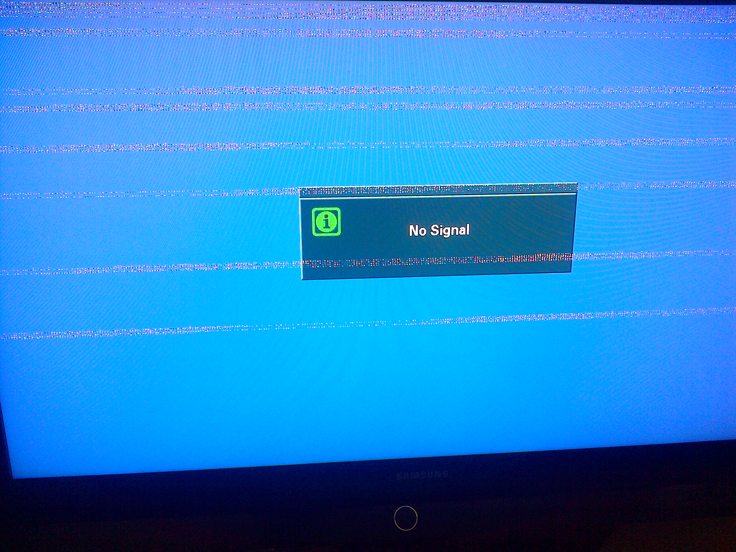

    See attached picture - These Horizontal lines appear on all inputs. The picture is clear other than the noisy lines left to right, they do not move.
    any suggestions would be appreciated.

    Since is a Samsung, I would start replacing all the power supply capacitors.
    Just to exclude them.
      Re: Samsung 46 LNS4692DX/XAA SP01 Horizontal Lines
      Thanks for the response - I have replaced the 4 bulging 1000mf caps on the power supply - none of the others looked bad, i certainly can do the rest.

            Fry's do not sell the required low-esr capacitors. They only sell general purpose capacitors. You would need to order proper replacements from places like Digikey, Mouser, or this very website.
            Digikey carry Panasonic FM/FR/FC which are highly recommended around here. Shipping is under $3.
              Just a note, the horizontal lines were there before I replaced the few caps i mentioned above, the horizontal didn't change a bit.
              Advice taken, thanks - will order the "right" capacitors and replace them all.
                You may have further problems, but it's hard to get a baseline without the right components. If in any doubt about your order, list the items to us first so we can confirm if they are suitable.
