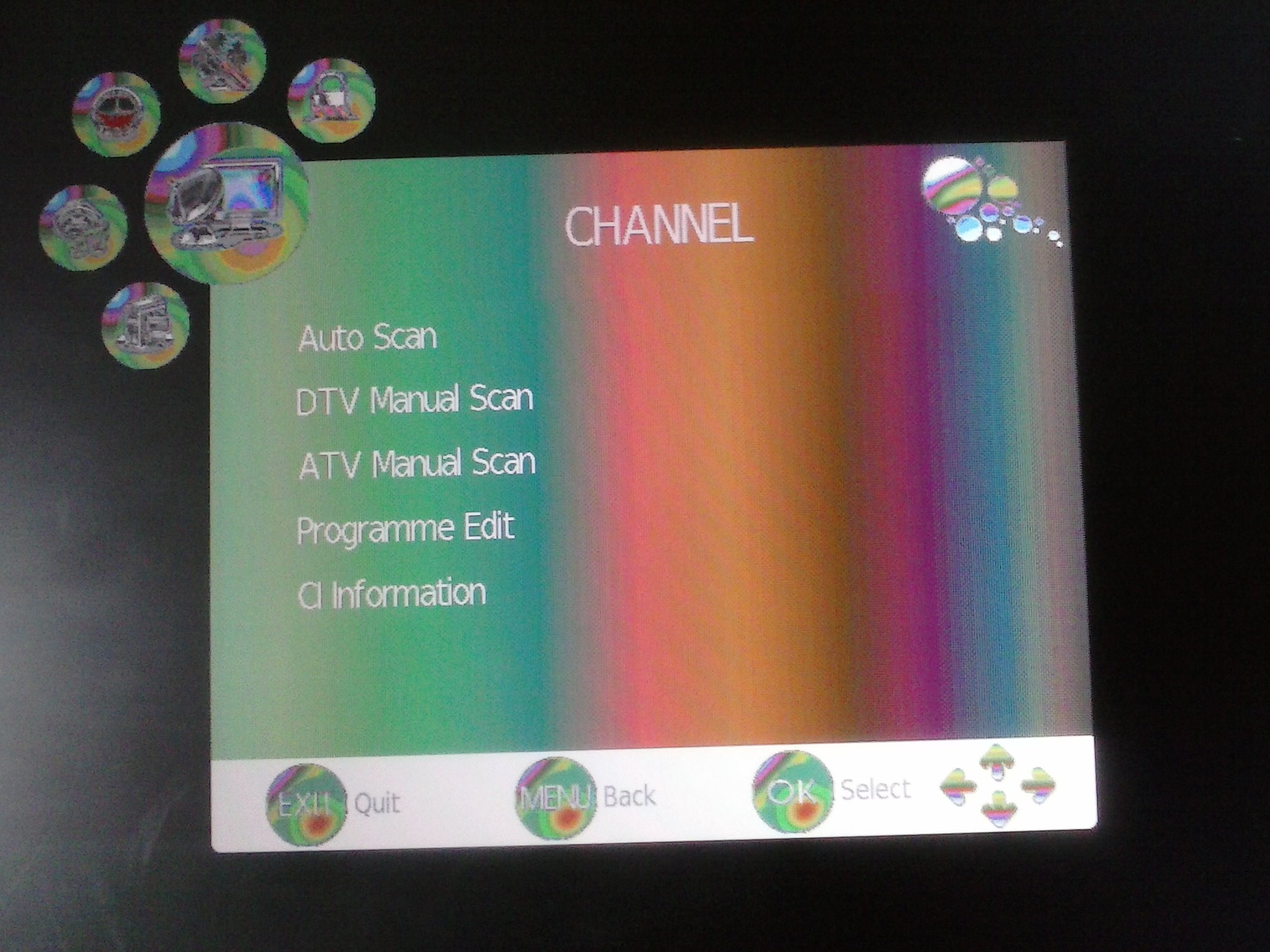

                                        Re: baird lcd tv no backlight
                                        heyyy can anyone tell me what is wrong with my tv please ????? all the colours have gone like this this morning and i need to replace what has gone wrong!! MAKE, Baird, MODEL, CN42BAIR
