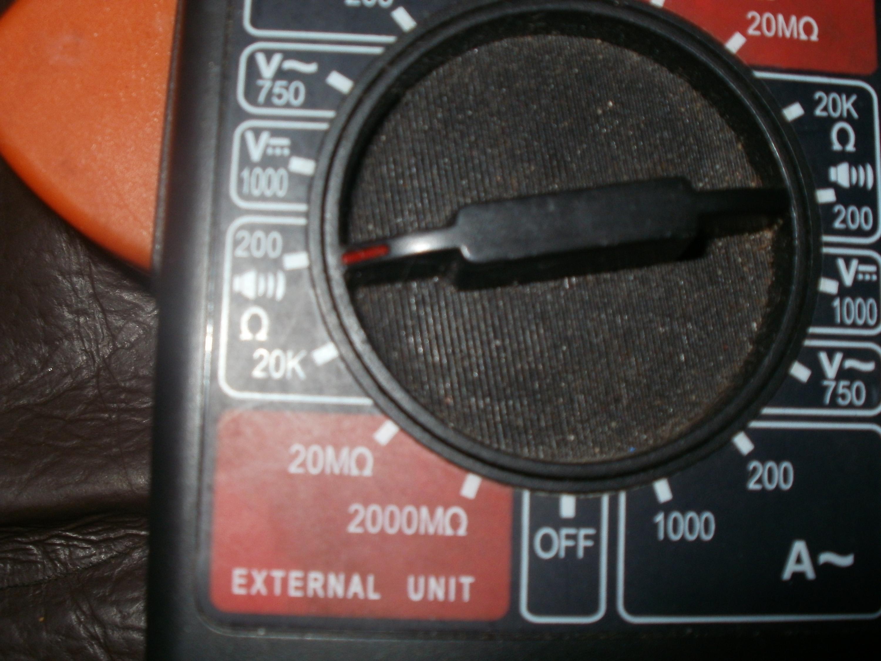

                  Re: baird lcd tv no backlight
                  hi again heres a pic of the setting i had the meter on.
                    That's the correct range. When you touch the probes together, what do you see?
