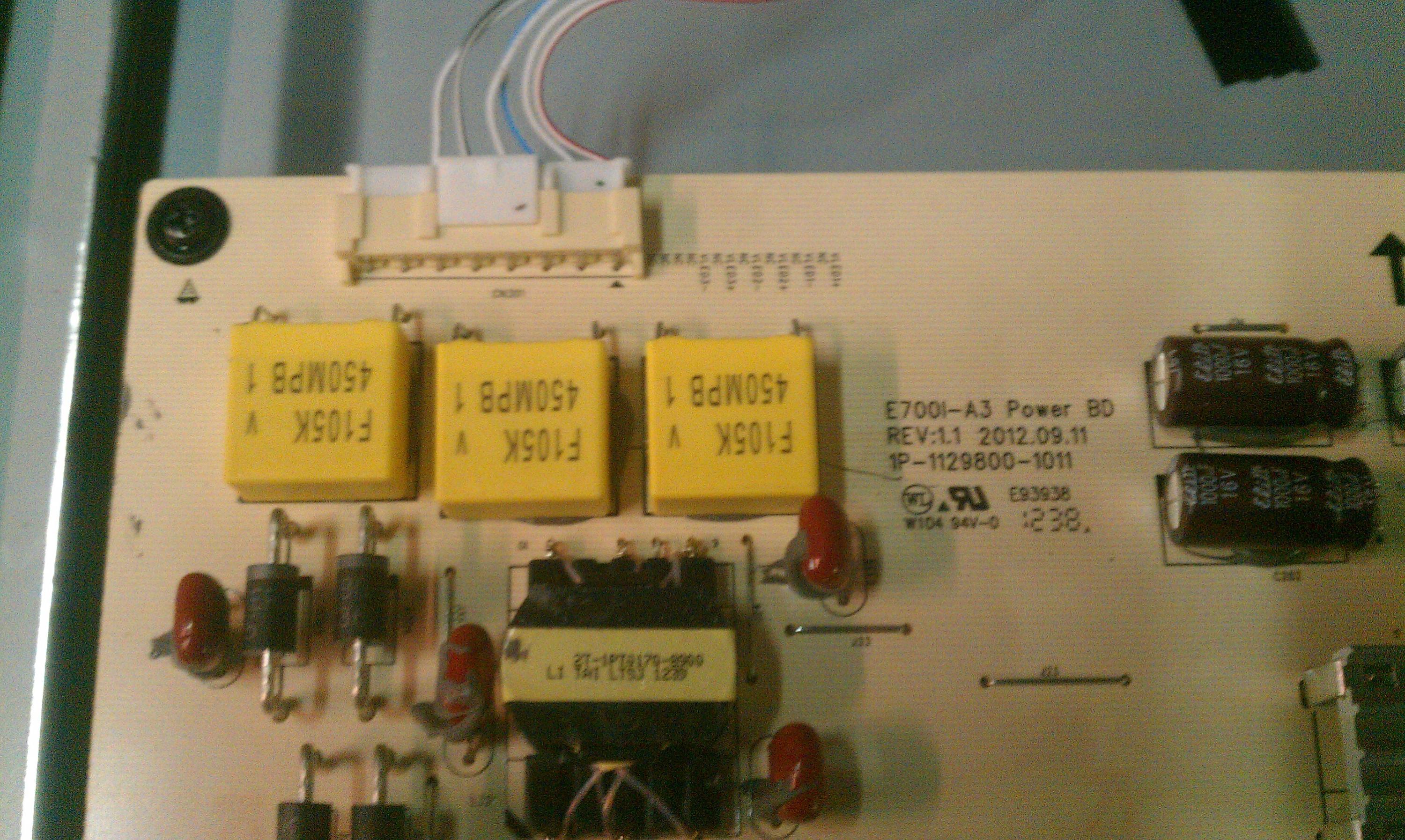

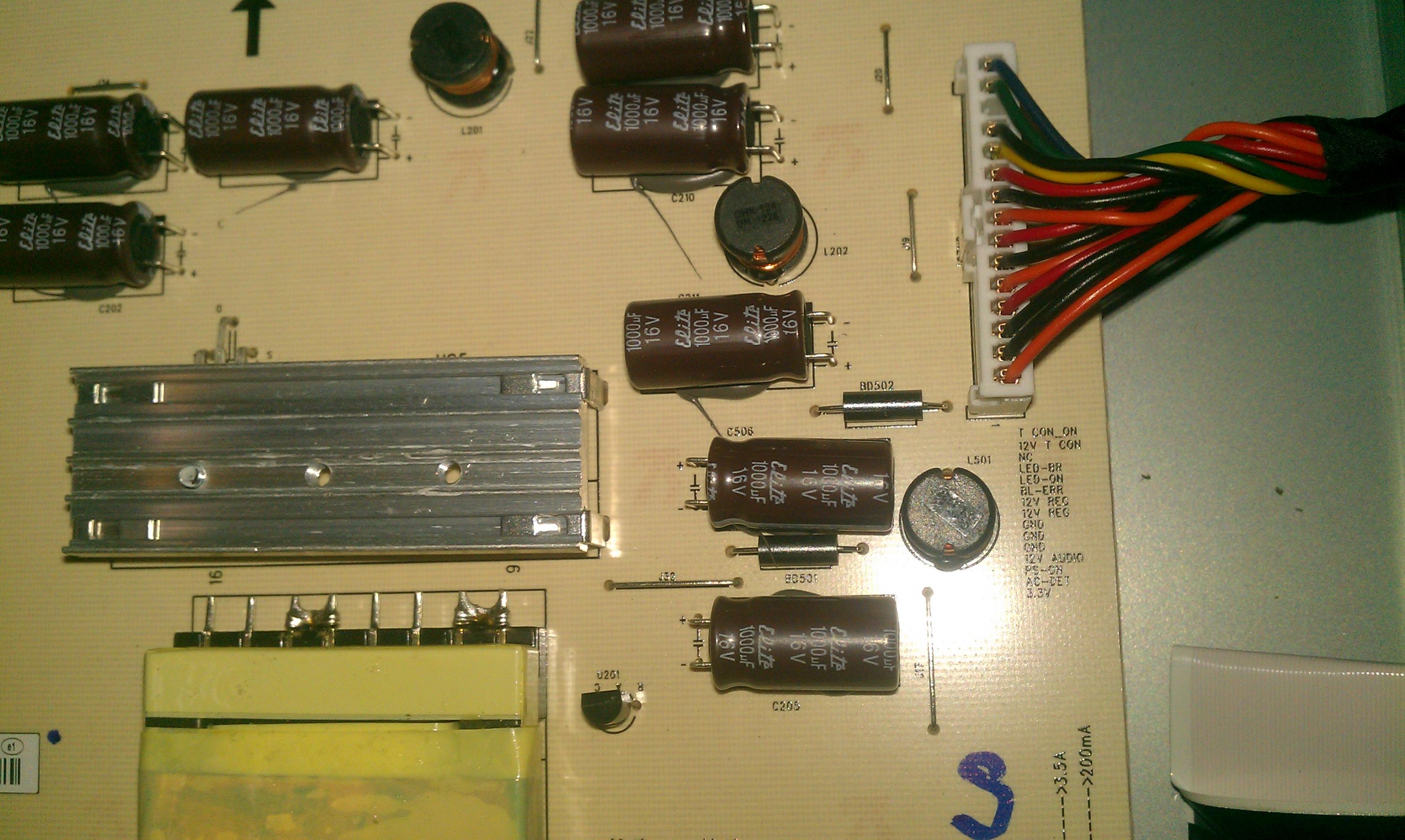

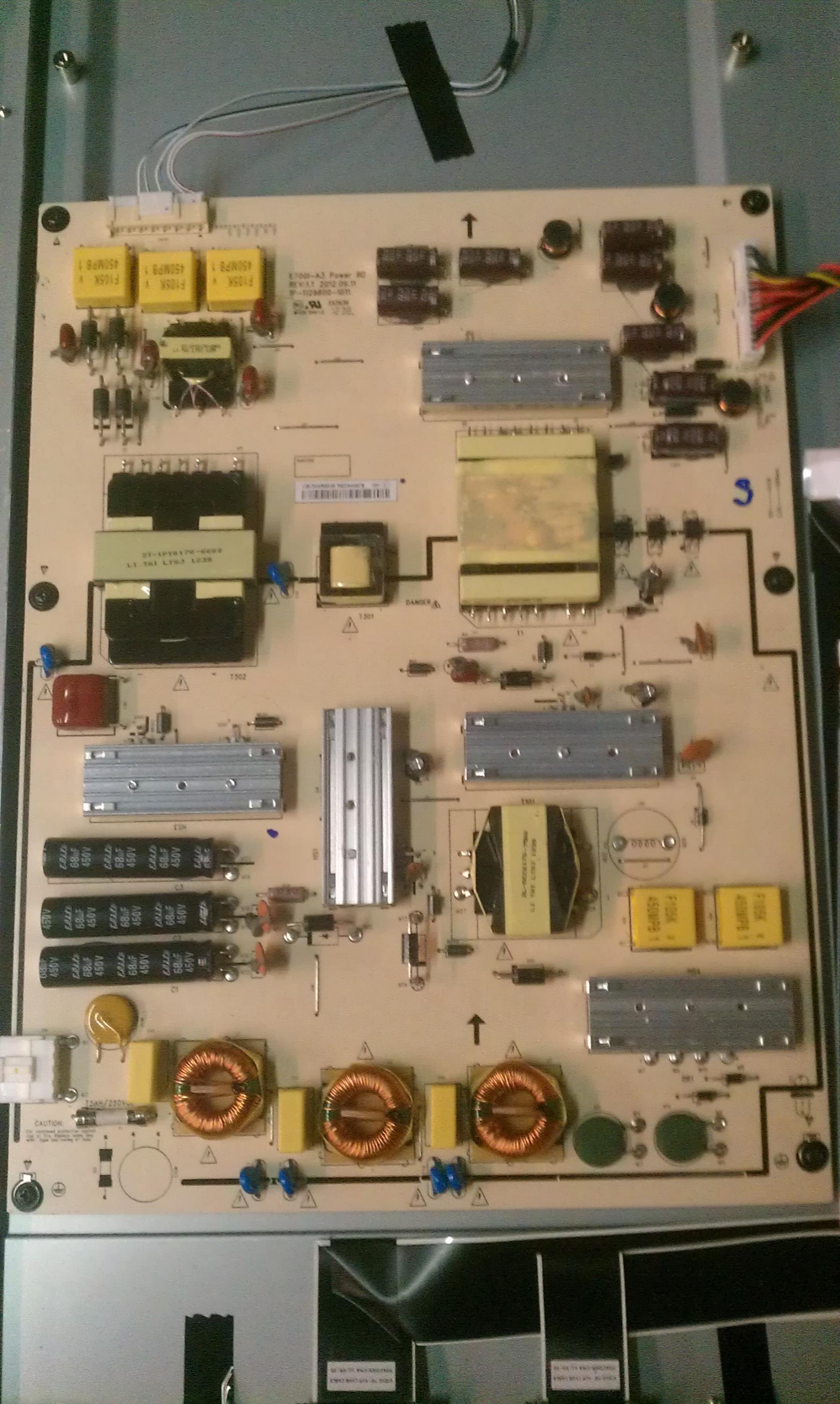

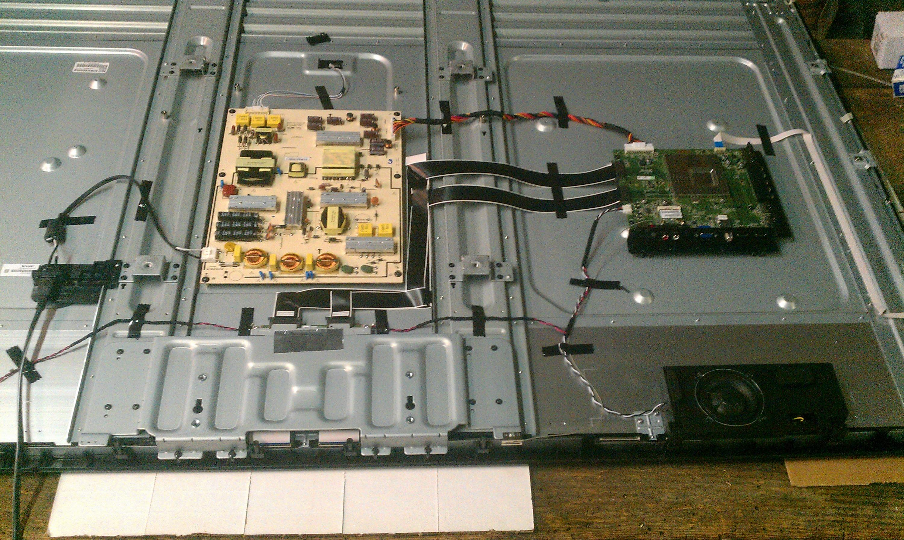

        Re: Needing confirmation Vizio E701i-A3

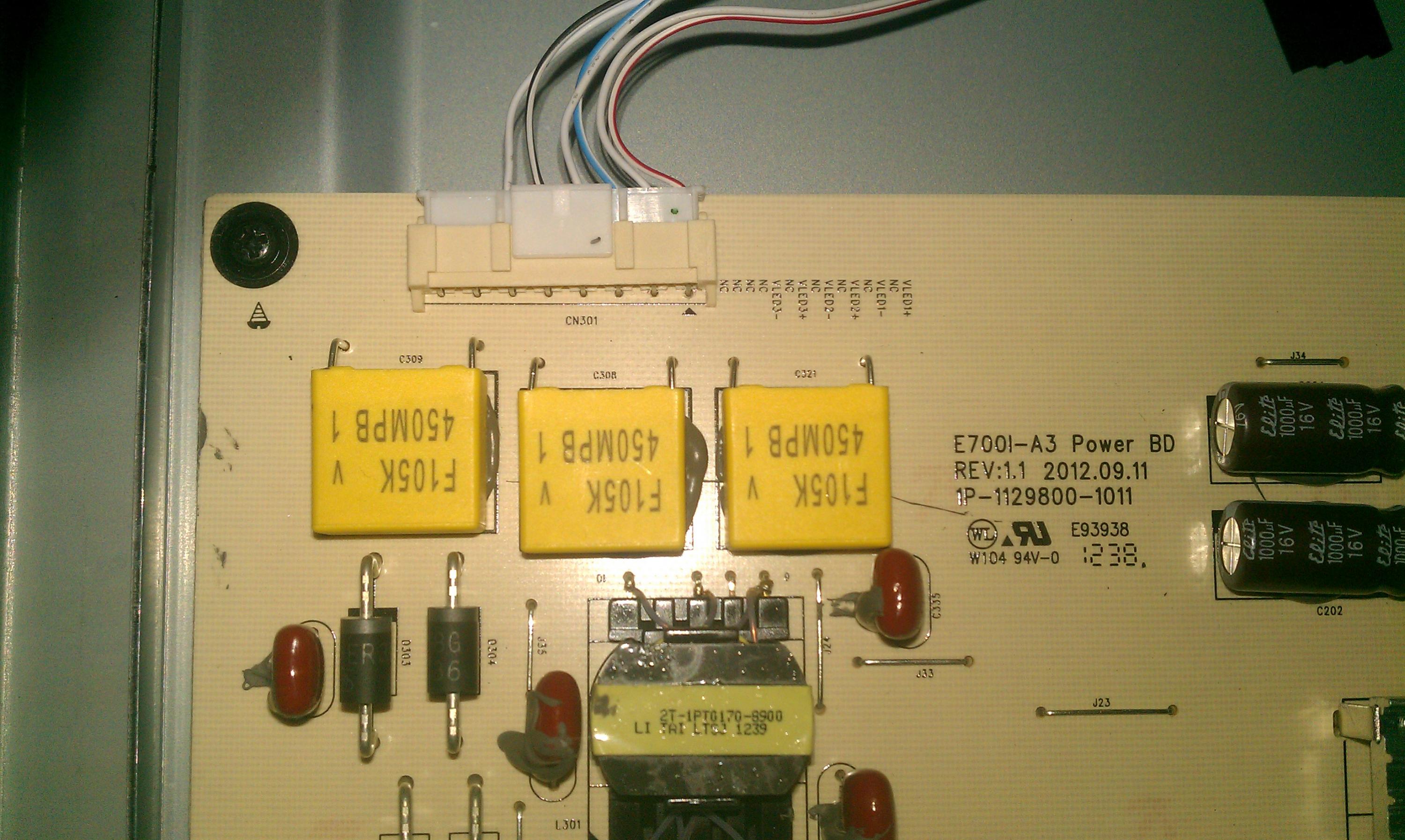

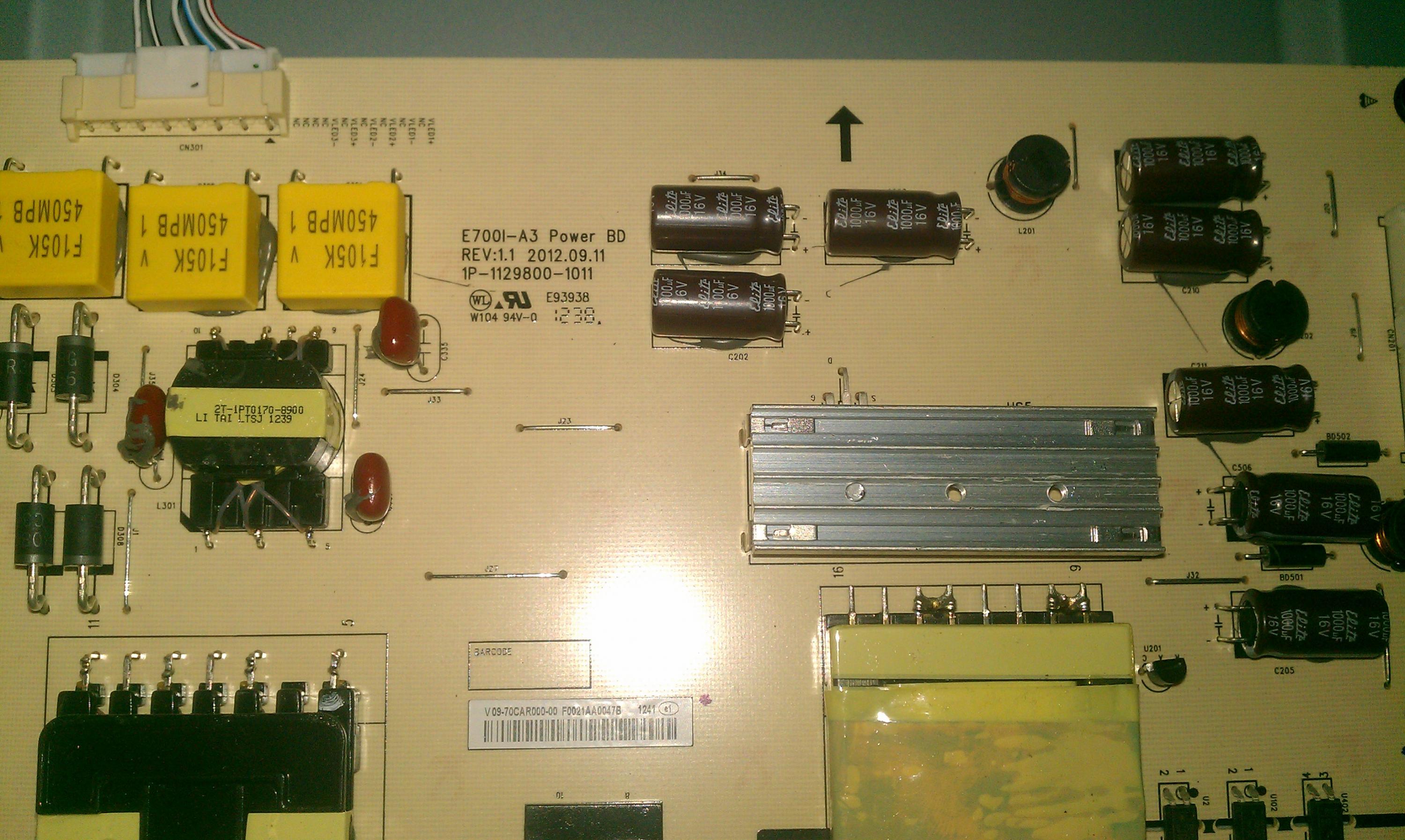

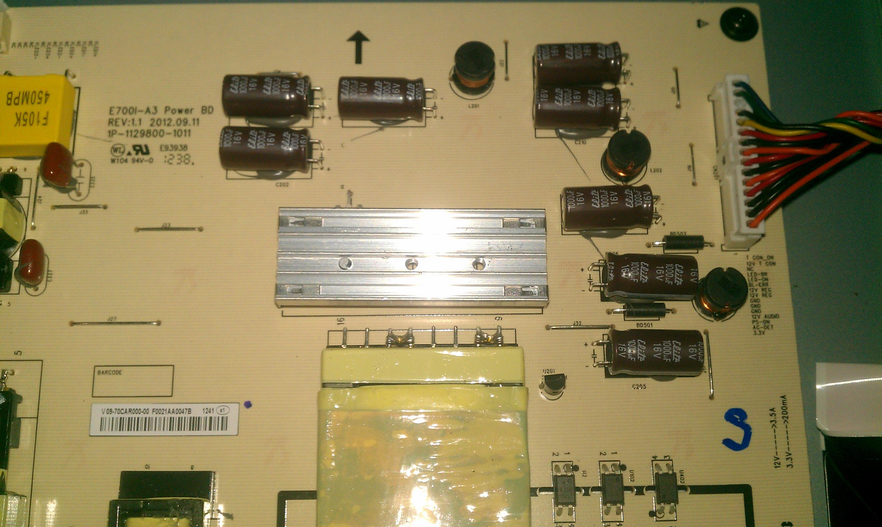

        You may be able to repair the PSU. Please post clear high resolution photos of the PSU for starters. A shot of the whole chassis would be great too.
        • sbeck
          • Mar 2013
          • 31
          Thanks,
          The TV is so big, its hard to get the whole chasis in there, but if you need better, let me know. Also the Power supply board is large too, so if you need a better spot on it, let me know.
          S
            Originally posted by sbeck
            Thanks,
            S
            good pictures
            • martyparish
              • Dec 2012
              • 313
              Pics look good! To get more info, please test all pins on the same connector with LEDON and list all results.
              eg.
              T CON_ON: 3.3v
              12v T CON: 12.2v
              etc...
                Top to bottom Tested to chassis ground
                tcon_on: 3.25
                12V T Con: 12.52
                LED-BR: 2.72
                LED ON: 3.33
                BL ERR:-
                12V reg: 12.52
                12V reg: 12.52
                12V Audio: 12.52
                PS ON: 3.33
                AC-DET: 3.49
                3.3V: 3.36
                  And here I thought this was a 17", not a 70"! Blimey... that's very little for a 70" TV... I'm guessing it uses a Sharp panel, as Sharp are currently leading the field in big screen TV (especially LED backlit.)

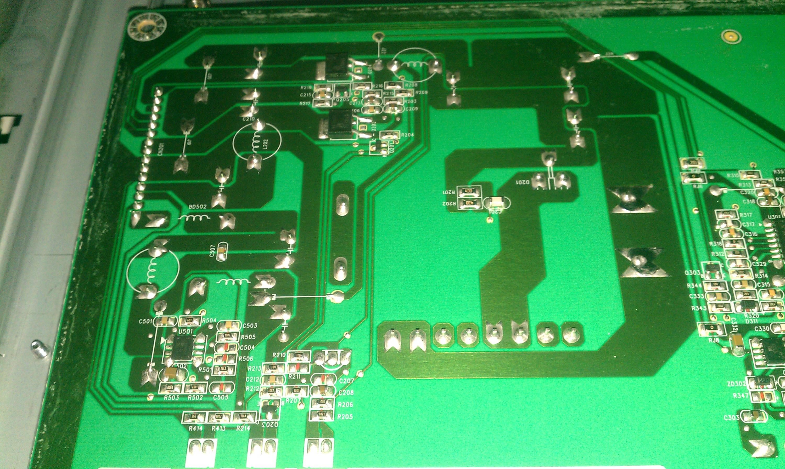

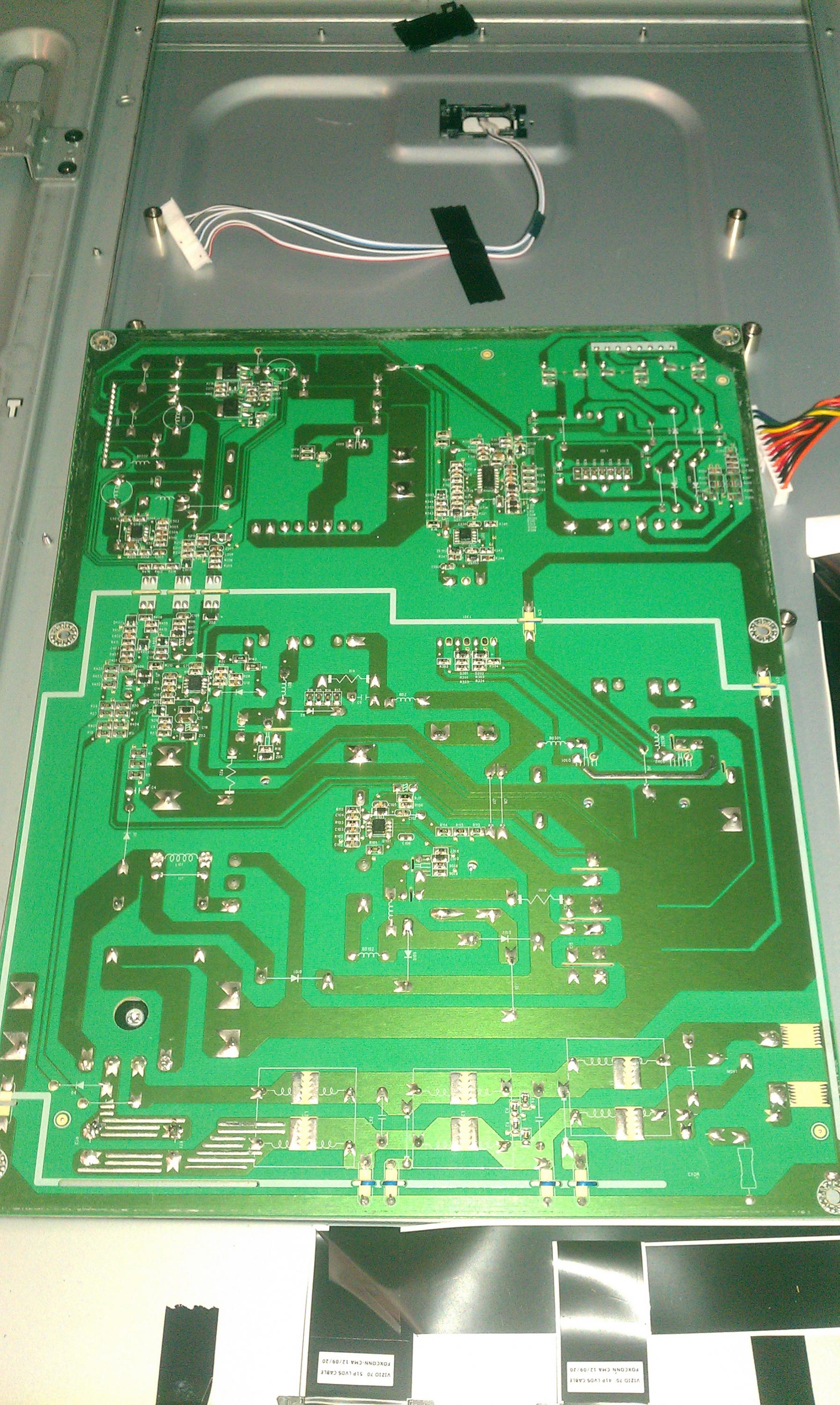

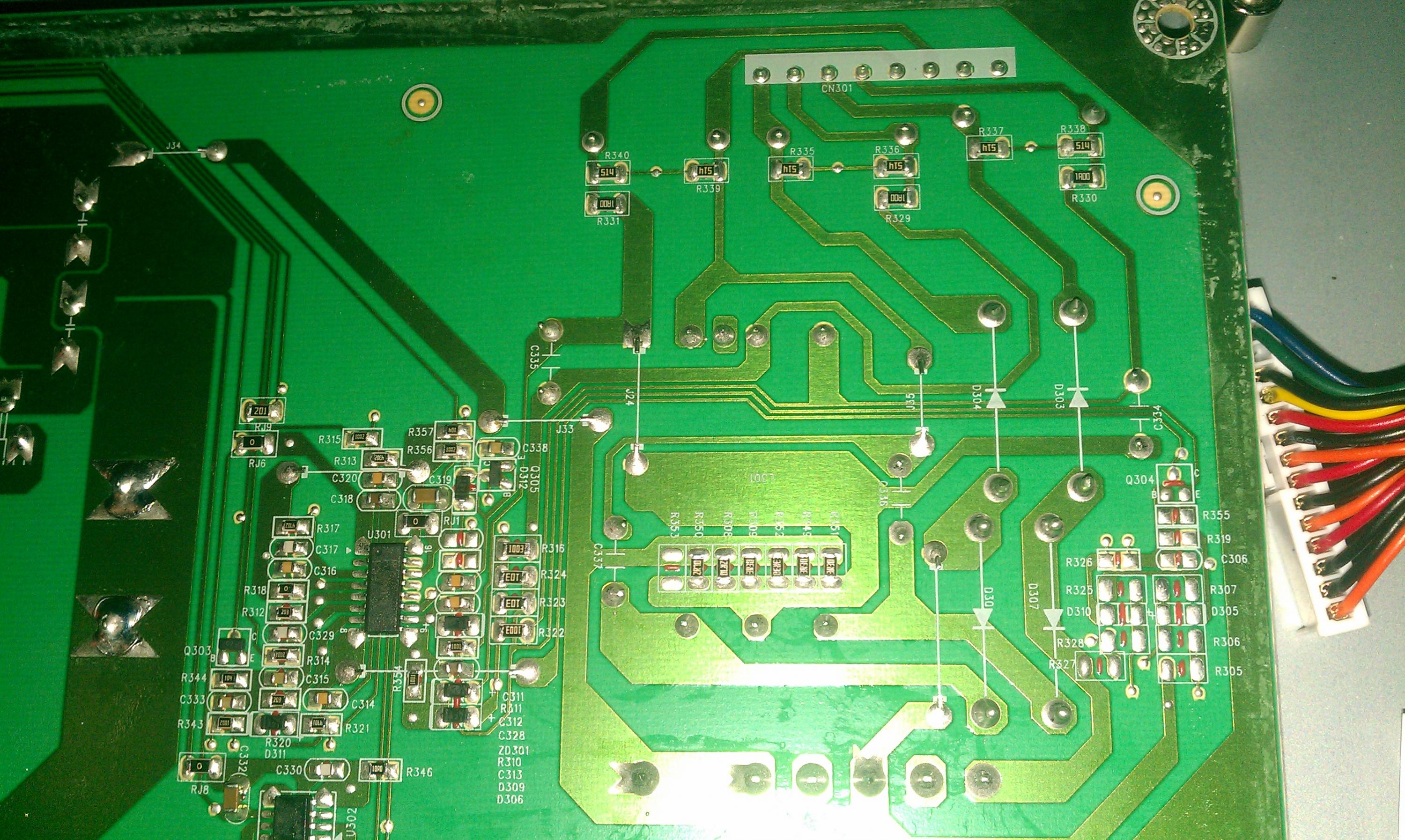

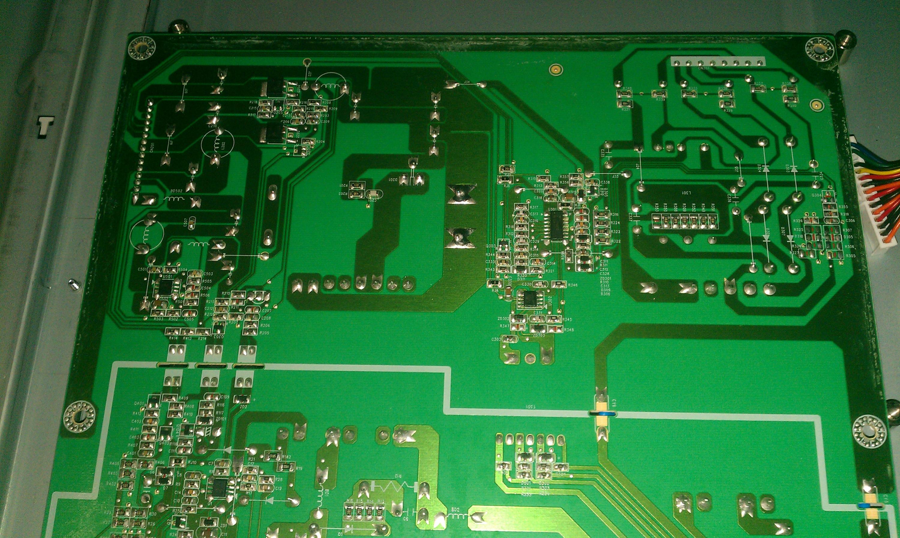

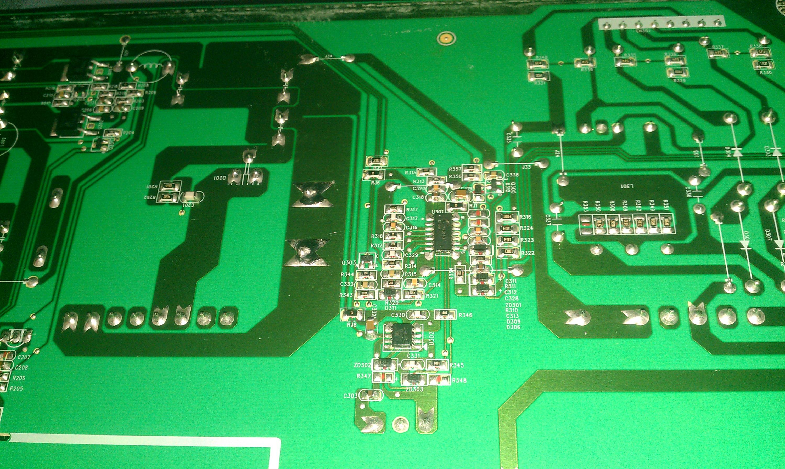

                              Can you remove the power board and get a picture of the underside?
                              • sbeck
                                • Mar 2013
                                • 31
                                Yes while the set is on it has the 3 volts on LED_on
                                In the pictures, top is still top I have flipped it left to right
                                  From looking at the outputs that go to the LEDS, it looks like it will not be steady DC but pulsing DC output at high frequency with pulse width modulation. So if you use DC meter to read those outputs, it will not show correct DC voltge.
