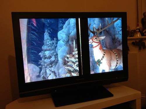

    Friends just got this problem with this tv
    basically it's a black bar going through the screen with what looks like static
    not had a chance to get it open yet just thought i'd see any suggestions before i look for the obvious

    Looks a lot like an eBay auction I saw a week or so back; hope they didn't buy it for repair, because the plasma panel is bad and this fault is not repairable.

      tom are most/all vertical black bars panel failures as seen a couple on gumtree with this problem in the center of the screen.
        Re: Panasonic TH-37PX8B
        Almost always a panel failure. Regional defects are a thing to avoid for both LCD and plasma displays.

          he was the one the selling it, got messed around by a buyer and decided to try get it repaired
          thought it was worth a ask anyway
          the parts inside worth anything as i think it's a fairly old model?
            Not that old (2008~2009 I think), yeah, they're worth a bit. Probably £30~50 total.

              thanks, suppose he can try and part it out or try again on ebay
              least i know now for the future that defects like this aren't repairable
