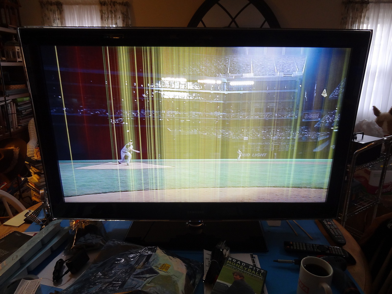

Samsung 46" lcd ln46b650 vertical lines and a gridlike pattern on right half

    Re: Samsung 46" lcd ln46b650 vertical lines and a gridlike pattern on right half
    Where on the tcon board would the voltage be checked i have never checked that on one but im sure i can. Is it near the lvds cable input or general location to look. What should the voltages be and do i just ground to metal chassis or frame while checking i know some test points need to be grounded in certain spots.
      It varies with each T-con. You will see white lettering next to a gold test pad.
        I still think of main board. But you said Tcon at bottom of panel. Then watch for windex issue That make board corrosived
        • snake91876
          • Feb 2013
          • 236
          Ok here are the TCon readings
          VON 23.4v
          vOFF -13.7v
            Spray freeze spray directly on the tab bonds one at a time waiting 10 seconds on each before proceeding with the next, try pressing on them after using the freeze spray.
            You can also try heating the tab bonds with a hair dryer and pressing on them while they are warm, sometimes they have to be heated or cooled before you will get any results.
              Both VON and VOFF look fine to me. There is also usually AVDD (15~20V), but this is generated on the same supply as VON/VOFF so all three or none should be present.
                Well i dont know what direction to go now. You think its the lcd panel or could i have main board trouble.
                  I'm thinking panel or t-con. Doubt it's the main.
                    My instinct tells me t-con , i just fixed an insignia 47 lcd with a tcon. It would play for 5 mins do some weird picture colors and go out but still have sound. I feel like this is doing the same thing as the picture just gets worse and worse if you play 30 minutes or so it almost gets a ghostly white all over the screen but images can still be seen. Then i read about the samsung panel failures and have been scared its that and debating paying much for a t-con. Do you think if it was panel it would be progressive failure like this or would it be failing right at turn on.
                      Heres a picture of the same ln46b650 a guy is selling the tcon from on ebay. He claims the lcd panel is bad. This is what mine looks like just thought it might be a better picture where you can see it. Maybe i do have a bad panel or maybe he dont know what parts are good or not.
                        So i followed mister D's instructions above and went back and re-analyzed the tab bonds on my lcd screen edge. I sprayed with cold spray and heated with a hair dryer at each of the 16 spots. I pressed them and saw no changes what so ever in picture. But as usual as the picture warmed up it got worse. I flexed the screen and moved it a little at the tab bonds and get no kind of change in my picture. Anybody?
                          Well I got the new T-con in the mail and popped it in and bam same darn lousy picture. I guess its not that cause it did the same exact thing in progression. Well the big question now is do i try a main board or call it a bad lcd display and sell my parts. Thanks matt
                            Anybody , what do you think?
                              There are some chips in the 16 ribbons, do they heat up a lot?
                              Do you have sound?
                                I had a similar problem with this same model and it was the mainboard. I popped in a replacement from a TV with a broken screen and it fixed the problem immediately. I also have one with tab bonding problem where the picture starts out half dark and with lines and in about 10 minutes it pops in clear and perfect, especially if i give it a slight twist.
                                  I have good sound the chips in the 16 ribbon cables get hot. Dakota kid you have given me hope. i may try a mainboard. Are the chips supposed to heat up. i have twisted and flexed
                                  and cant find a bad tab connection.
                                    Ifthey way to hot, them maybe the driver ICs are damaged. Inspect them for burned marks.
                                      #38
                                      The ICs on these sets run much too hot which is why they fail so often...
                                        Anybody else think i should go for main board!
                                          Did you try a main board? Did it fix it?
