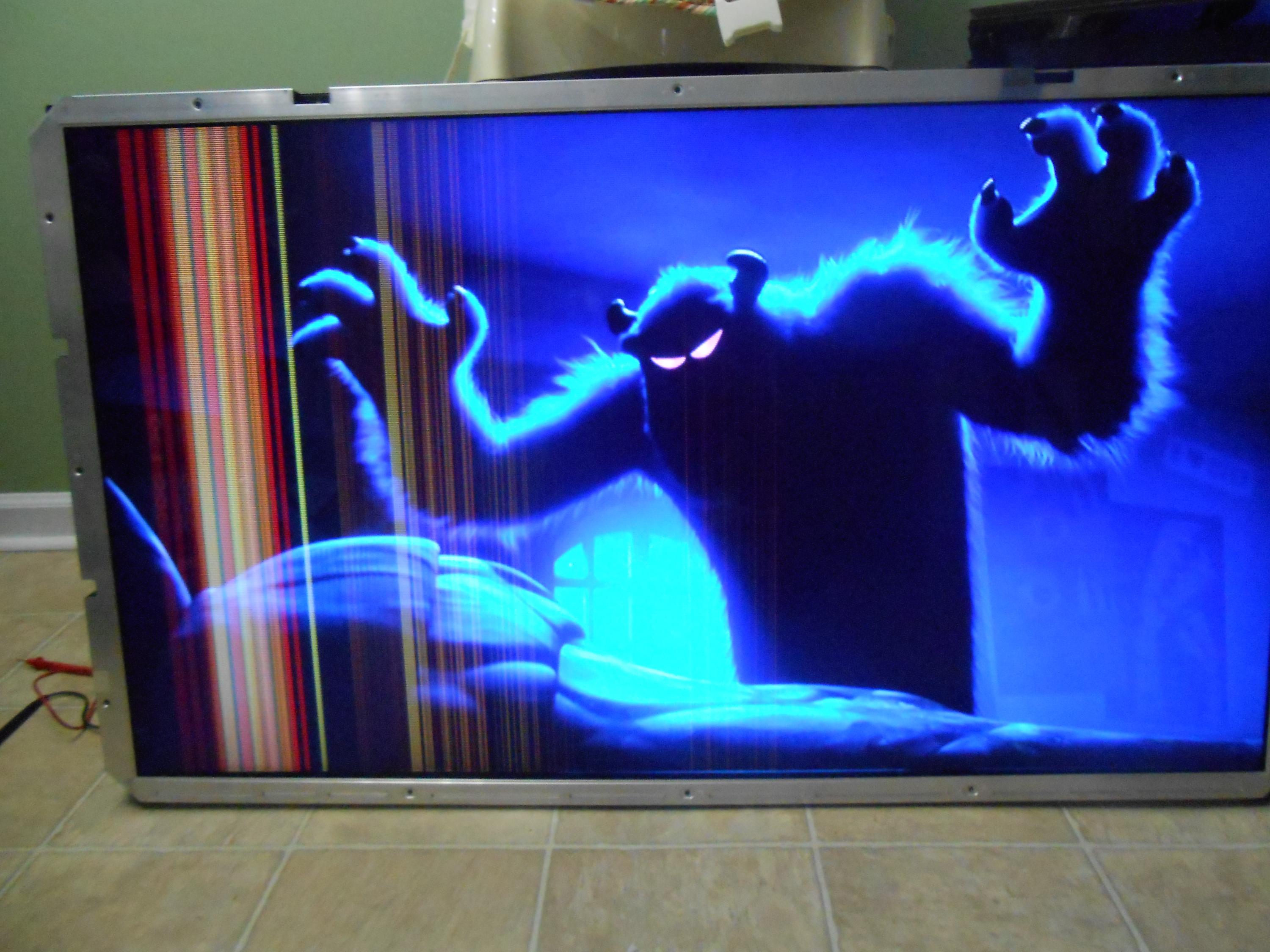

    Samsung 46 lcd model ln46b650 powers on normal and plays relatively great then after 2 to 3 min it starts getting vertical lines or strips of color down the left side in 3 or 4 in wide band, right side half has a grid like pattern in everything on it, its real clear but the grid is in background of all colors. Turn the tv off and back on and clears up for a min or two, then after it does it again turn off and back on it will clear again for a minute. Eventually the discoloration and vertical bands appear probably three quarters of screen after watching 15 min or so. The only thing i have tried was went into factory reset mode with tv off pressed menu 182 then power and was in service mode and hit factory reset.

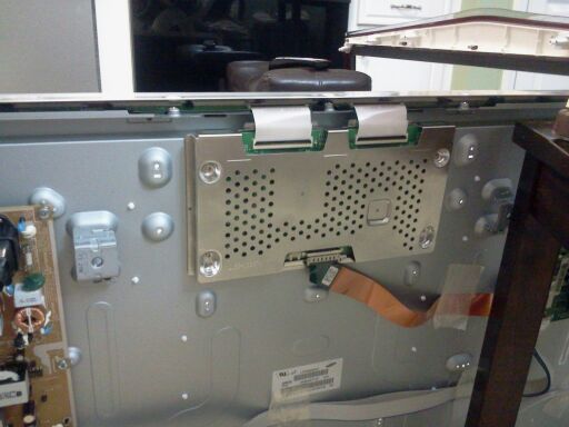

    Re: Samsung 46" lcd ln46b650 vertical lines and a gridlike pattern on right half
    I have opened the panel and disconnected and replaced all ribbon cable. Took the frame off lcd and checked the tab bonds and found nothing that would make the screen change by pressing on them , went ahead and applied something to put pressure on them and reinstalled the frame . No change. These tab bonds are on the bottom , i dont know if these give trouble like the ones on top. Unplugging the tcon board on one side or the other would change the picture some. I dont know where to go know i have a grid like pattern in the whole screen. lines are horizontal about 1/4" apart in the background of colors and then i have the groups of bands 3 or 4 wide in multicolors running vertical. Should i try the tcon , i will put pictures on here tonight.

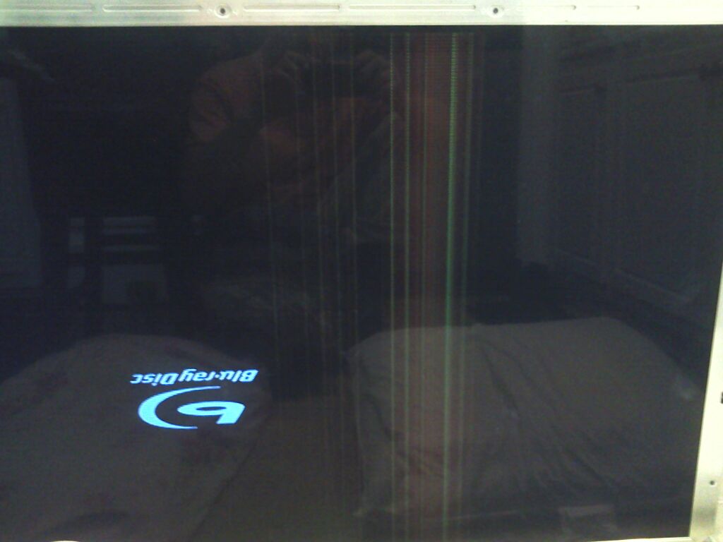

        Heres pictures of the black screen when the dvd player was in standby, the panel is upside down and what your looking at is actually mainly on the left side. The colors start faint and as the set is on longer more lines and colors develop in the same way, there is also a gridlike horizontal pattern in the background of everthing with color, the grid is not visible in the black.

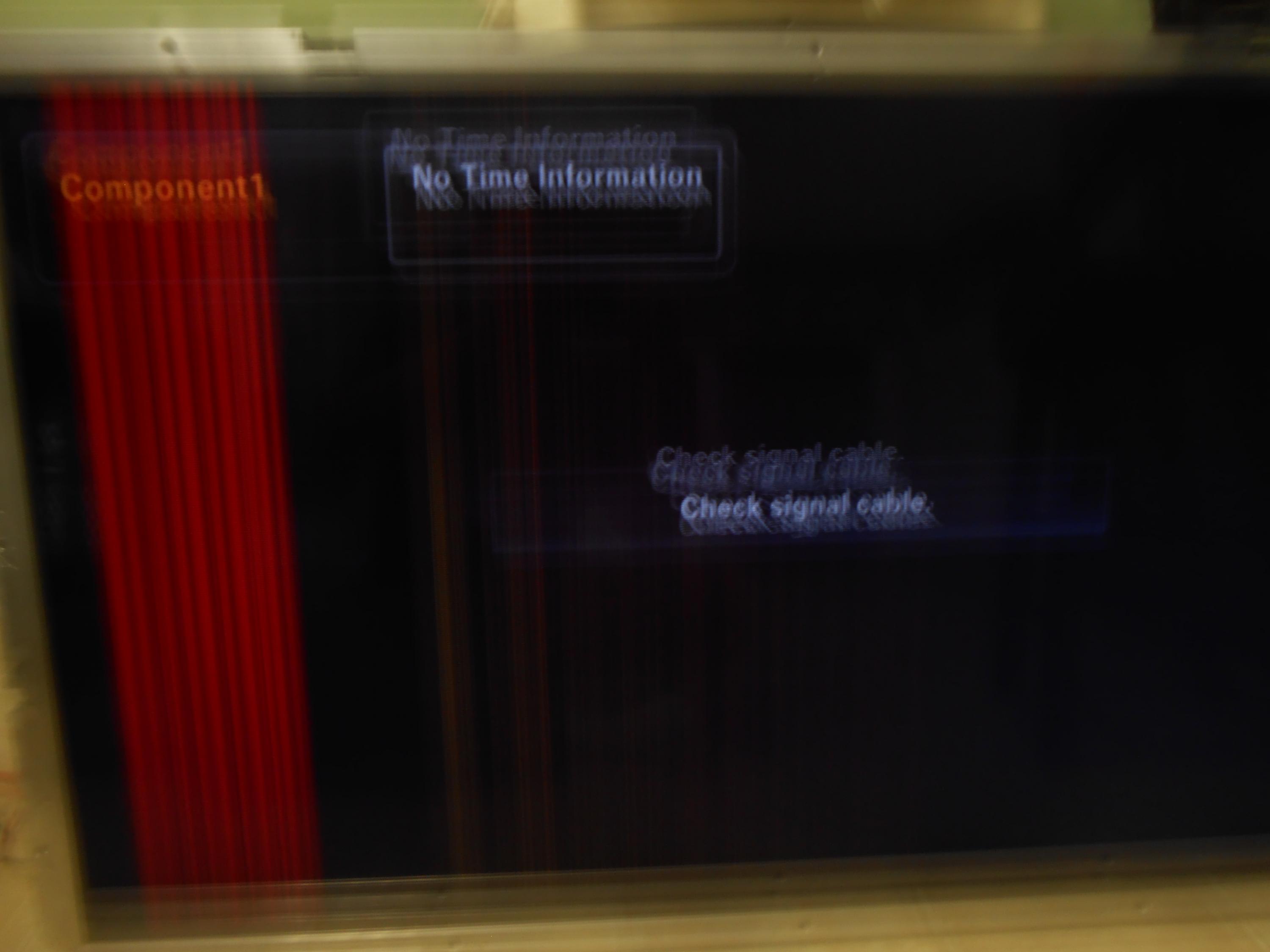

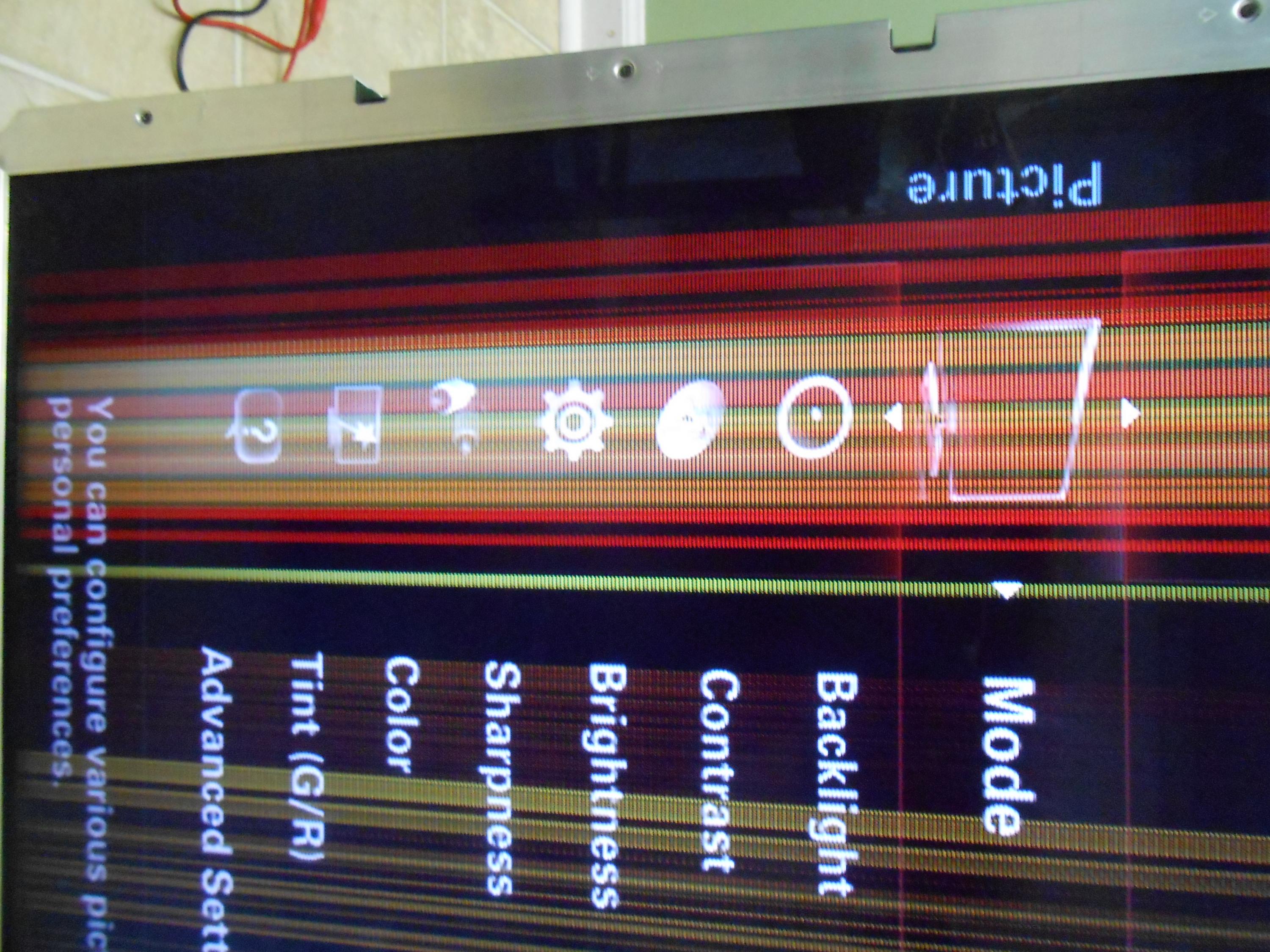

          Are the lines present in the menu display?
          • snake91876
            • Feb 2013
            • 236
            Yes the vertical lines and colors and the horizontal lines i speak of are present in the menu screens or on screen display.

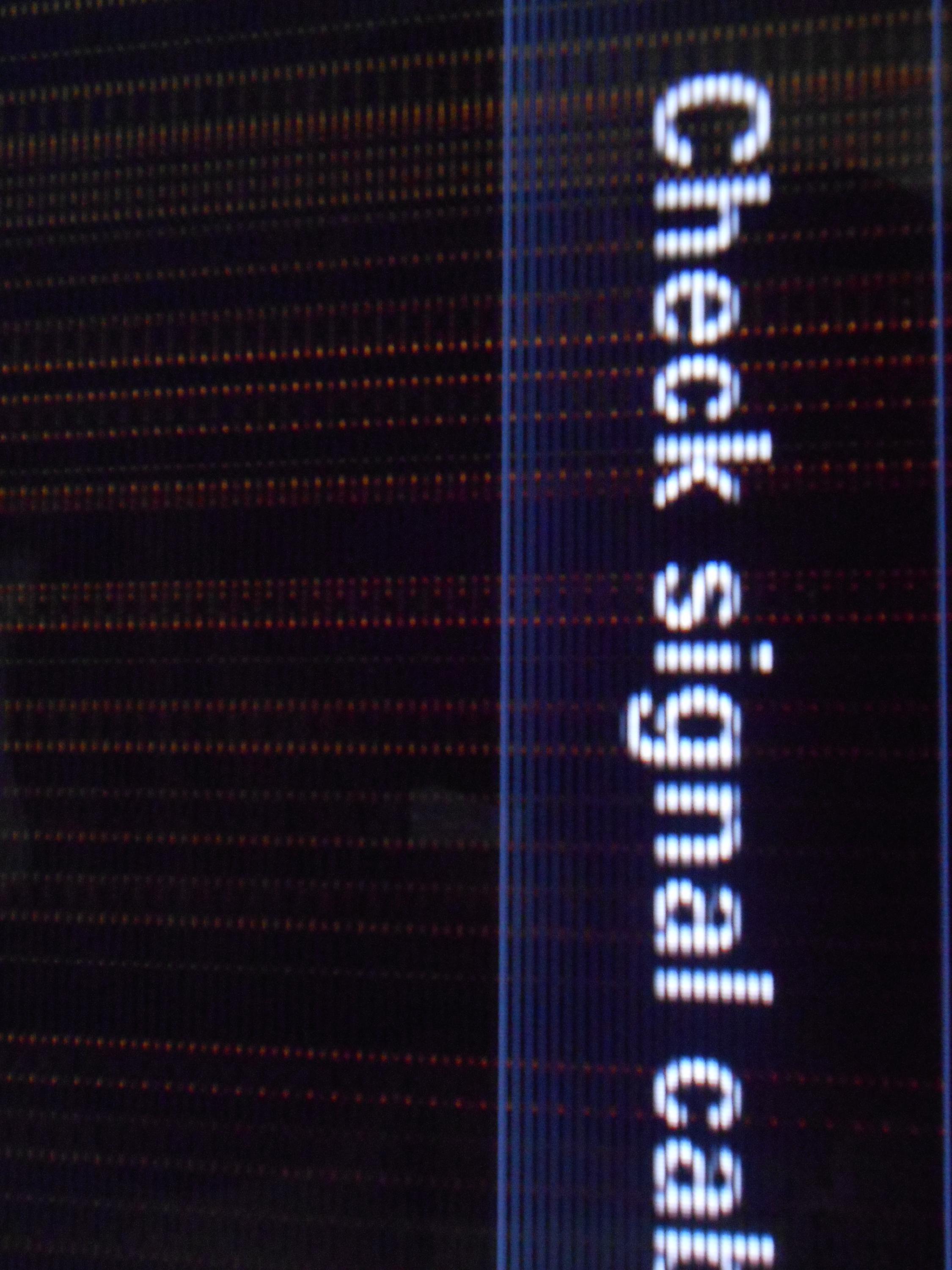

              Here is a little bigger photo and in the colors that run vertical you can see the horizontal lines a little. Then the rest are the setup tcon, power, main.

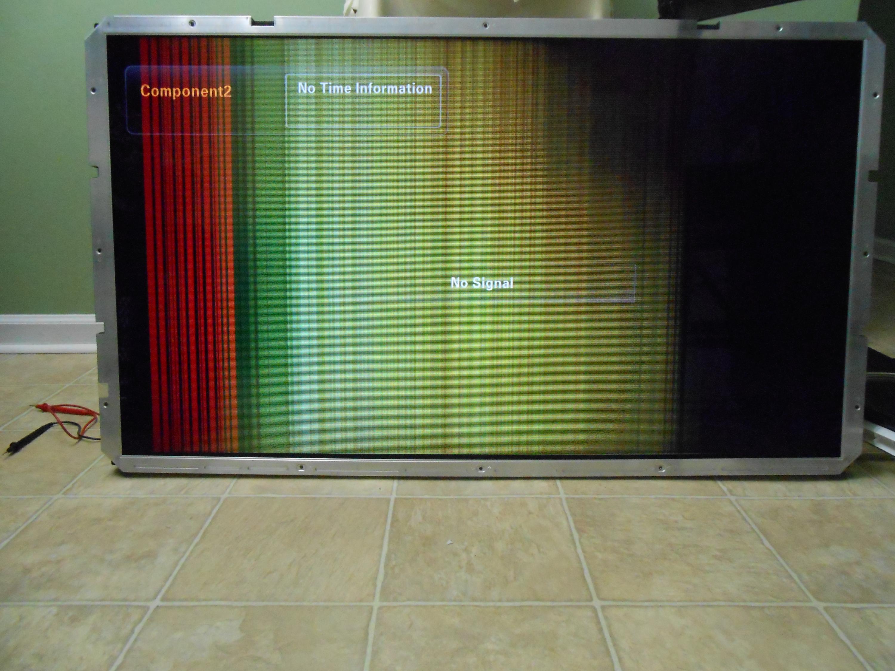

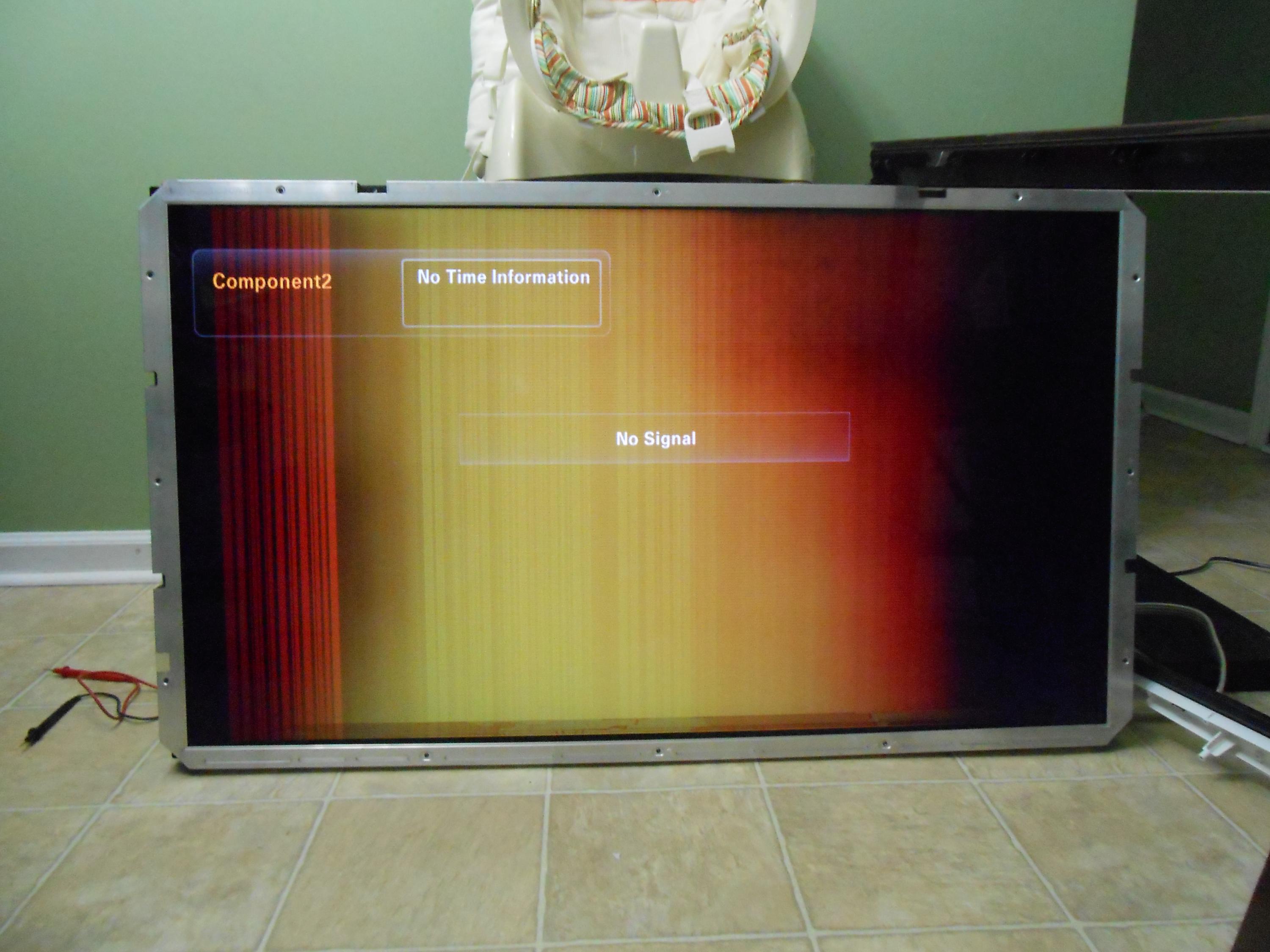

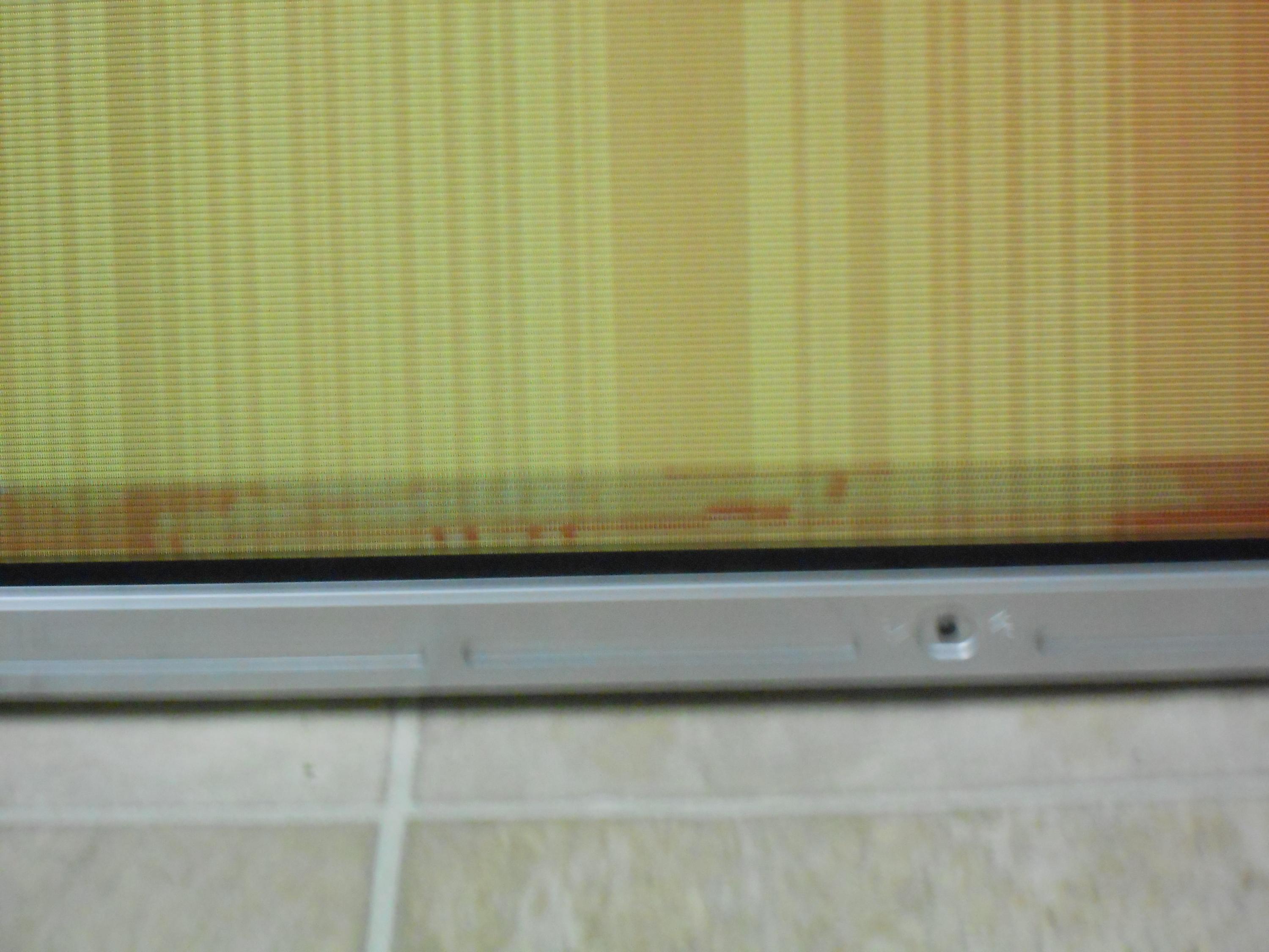

                          Well if anyone can help me i have a full chronilogical picture set showing what happens in 15mins time of having the tv playing. See attachments
                          Pic 1 shows when i turn it on its good for about 20 secs then this starts
                          Pic 2 you can see the horizontal lines through whole screen and colors
                          Pic 3 shows how its affecting menu or on screen displays
                          Pic 4 blu ray disc after about 10 minutes on lines spreading on screen
                          Pic 5 the longer it runs now at 15 minutes colors and lines spreading across
                          Pic 6 weird color pretty much all over and screen taking on white haze look
                          Pic 7 pic of line at bottom that appeared after 20 minutes.
                          After cool down it goes back to the way it looks in pic 1 and starts the progression toward pic 6 all over again in about 5 minutes time.
                          What do you think? Lets fix it!
                            Try cooling the T-CON board using freeze spray or use canned air duster upside down and see what happen. If you flex the panel, does it do anything?

                              i def feel like as it heats up it gets worse. If i flex the panel it makes no difference. Anywhere on the Tcon board that i should freeze specifically.

                                  Sprayed Tcon board and it had no effect. Changed picture none. I did have the tv in my shop today that was about 40 something degrees farenheit all day and when i turned it on it had no vertical colors in it until it heated up but had the grid like horizontal lines in the pictures right when i turned it on.
                                    I am pretty sure this is a tab bond failure.
                                    The reason I do not think it is the T-con is because the T-con is inherently digital and only supplies the LVDS data and clock to the individual panel drive packs.

                                      The picture does not change when flexed and i applied foam tape and spacers on the tab bonds pressing them firmly , messing with the tab bonds have no effect on the picture. Remember this is a screen with tab bonding at the bottom, i dont know if that makes a difference. This is a LTF460HF07 panel i think that is a Samsung brand and not an inferior brand. Are they common for failure.
