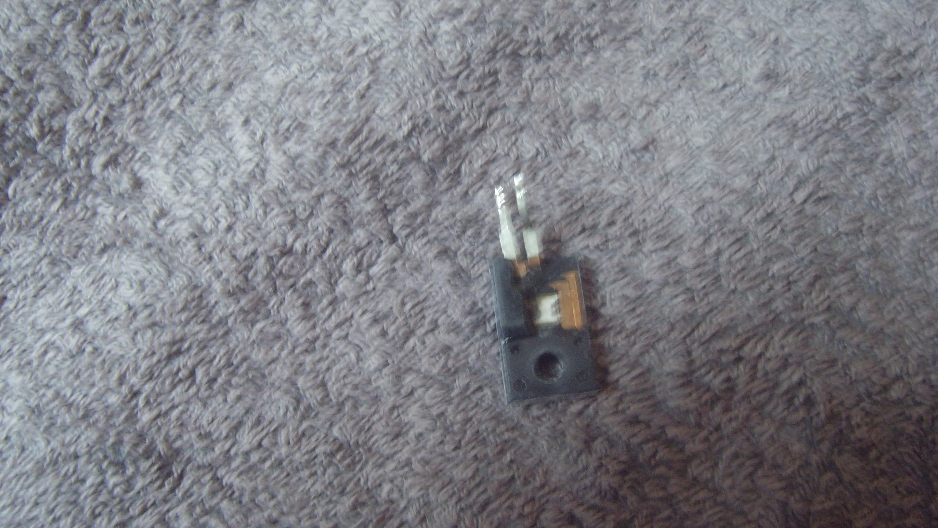

    The first one I came across was fuse destroyed and fets s/c'd, I replaced the fets and checked everything and still couldnt get no life from it, so I just got another board
    The second one is a little strange, fuses all intact, but one of the fets destroyed other one s/c'd...see attached pic, I replaced the fets 8n60 and still nothing, again all the other components check out fine, I have done all the school boy errors that catch you out ie switch o/c, 240v is getting to the board and primary seems fine.
    To be honest with this board I think someone has been playing engineer and proding probes everywhere with the power on and shorted the fets (tv had half the screws missing out the back)

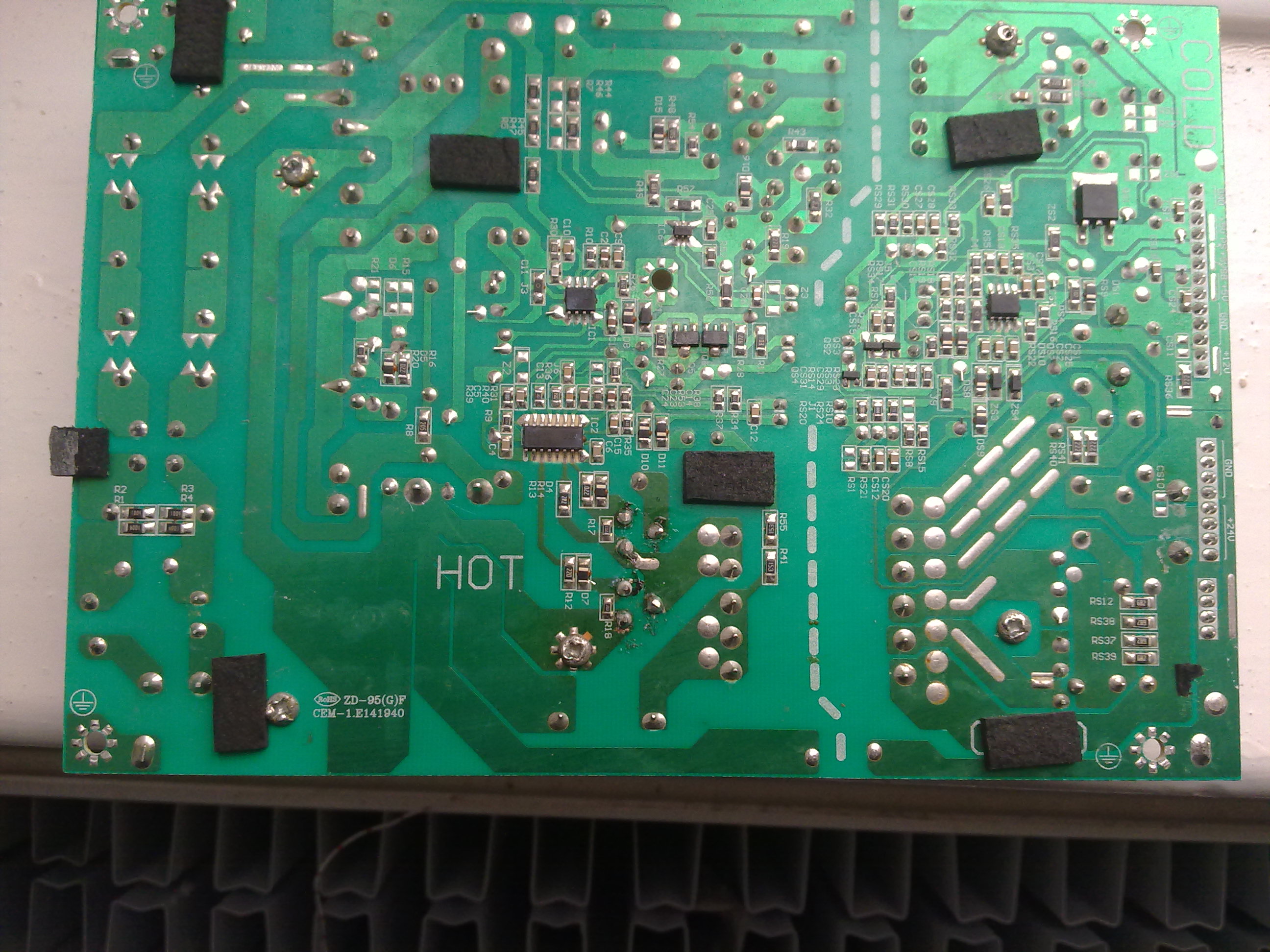

      is there any components on the underside of the board?

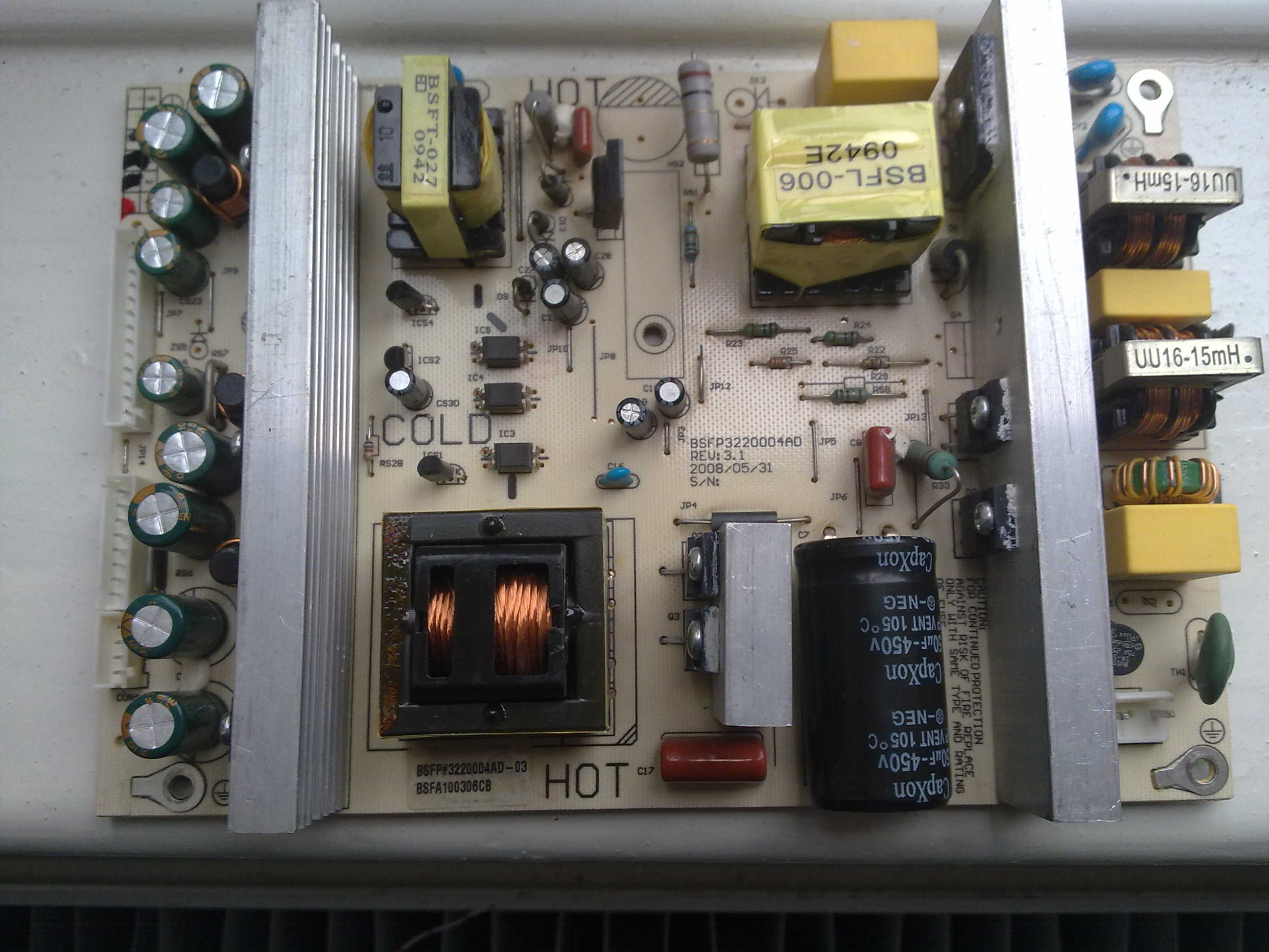

        Sorry I should of been a little clearer, I am not working on the other board or comparing with the one I am working on else like you mentioned it gets messy, the first board is trashed and in the pile ready for me to nick decent bits I need in future.
        The second board (pictured..which I will update later for clearer images) this is the board the pictured fet came off....no fuses were blown, which did surprise me a little looking at the state of that fet and the other being s/c'd
          Will take pics of underside too

                Re: DIGITREX CTF3271 PSU bsfp3220004ad
                Are the pins on the connector labelled (back or front)
                The 5 small caps on the primary side - one is likely to be the startup cap 25v or50v can you test the voltage across it.
                Jumper4? near the big cap and the heatsink is it just a wire with a ferrite tube or is it something else?
                When you do more pictures can you post topa nd bottom of the main board and inverter board

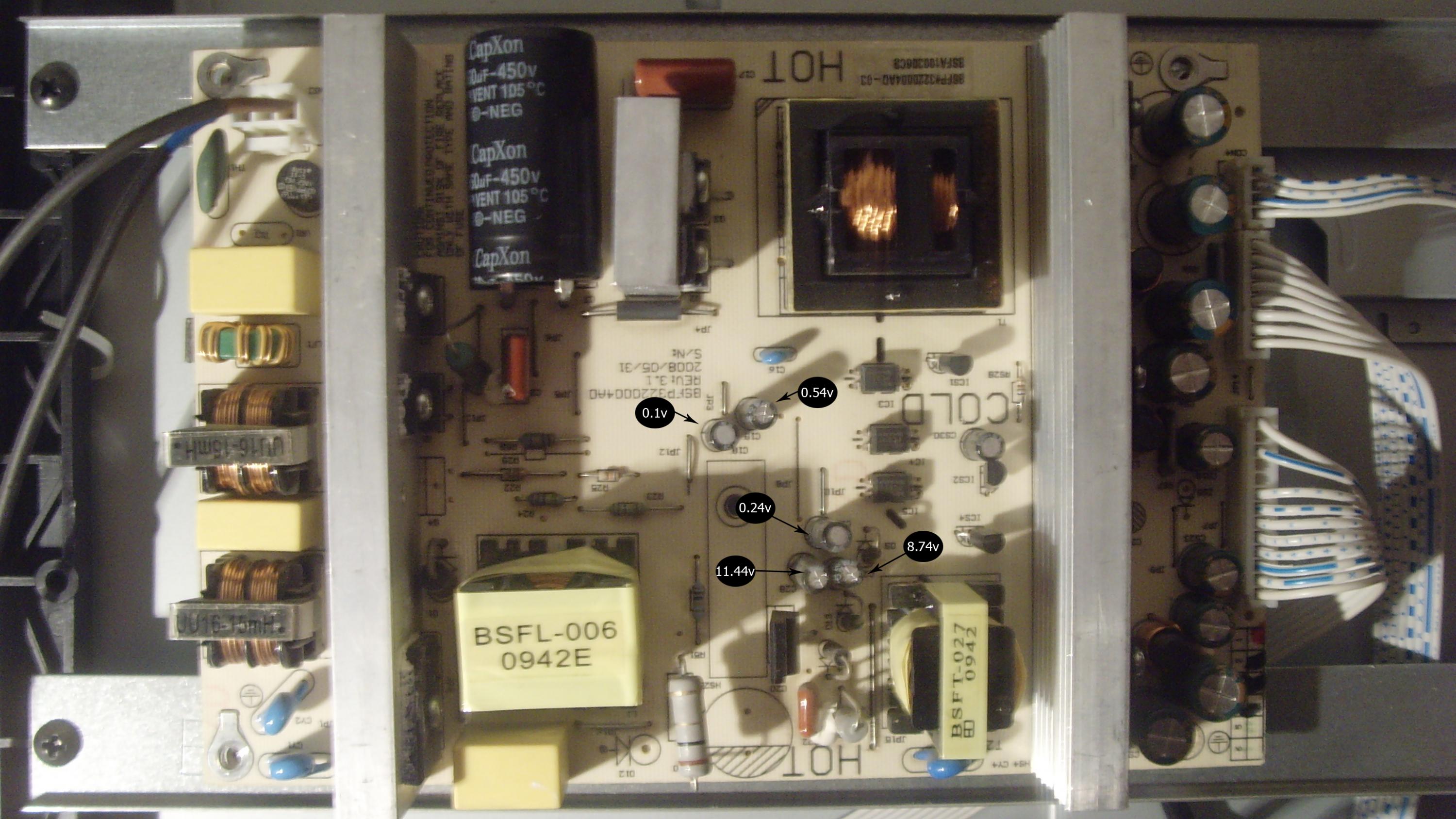

                  Hi sorry for the late reply.
                  The story so far, I have tried taking better pics but my camera is rubbish, and my shakey hands dont help,
                  J4 Yes just a jumper wire
                  Connector is labelled both sides, I have attached the best picture I can with all the voltages across the 5 caps you mentioned
                      Q7 should be on a heatsink! I would check that first, and then check the voltages at the output voltage connector.
                        Hi
                        Q7 is no longer attached to a heatsink they removed it on a revision as I have seen the earlier board...(which normally takes the bridge out), Q7 is fine no problems.
                          You keep giving us just half the information - remember we cannot see what you are doing. Can you get someone else to take the pictures or set up the board and the camera and use the shutter time delay?
                          Please list the cap values against the voltages you put on the picture.
                          Please use the list you have above for the connector but give us each voltage at each pin.
                          Need to test/list 3 times. First when its plugged in second when its switched on and third as its switched on ( No need to test the ground pins )
                          The PS/5V is probably the pson and perhaps the third test will confirm.
                              Right here you go
                              Standby Voltages
                              P3/5v = 4.73v
                              P4/5v = 4.73v
                              P5/PS = 0.00v
                              P6/5VSB = 5v
                              P7/5v = 4.72v
                              P8/5v = 4.73v
                              P12/13/12v = 0v
                              "On" Voltages
                              P3/5v = 4.54v
                              P4/5v = 4.54v
                              P5/PS = 4.42v
                              P6/5VSB = 5v
                              P7/5v = 4.55v
                              P8/5v = 4.55v
                              P12/13/12v = 0v
                              "Start Up" Voltages
                              P3/5v = 4.54v...this did drop to 2.54v when starting but 2nd test showed no drop
                              P4/5v = 4.54v
                              P5/PS = 4.42v
                              P6/5VSB = 5v
                              P7/5v = 4.55v
                              P8/5v = 4.55v
                              P12/13/12v = 0v
                              I have attached clearer pictures too

                                The cap ratings are as follows
                                c18 = 1nf x 50v
                                c19 = 22nf x 50v
                                c21 = 22nf x 50v
                                c27 = 22nf x 50v
                                c28 = 1nf x 50v

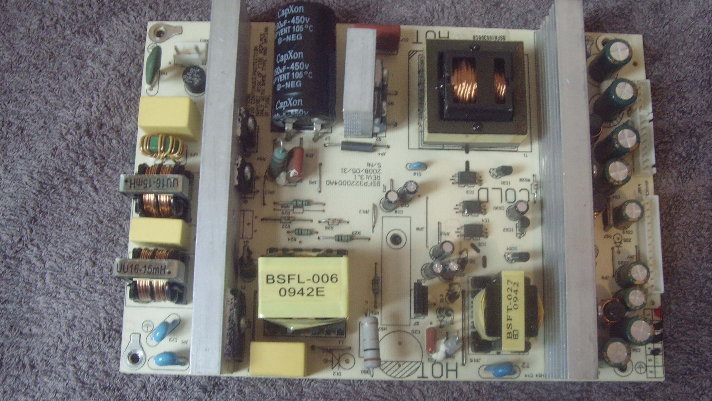

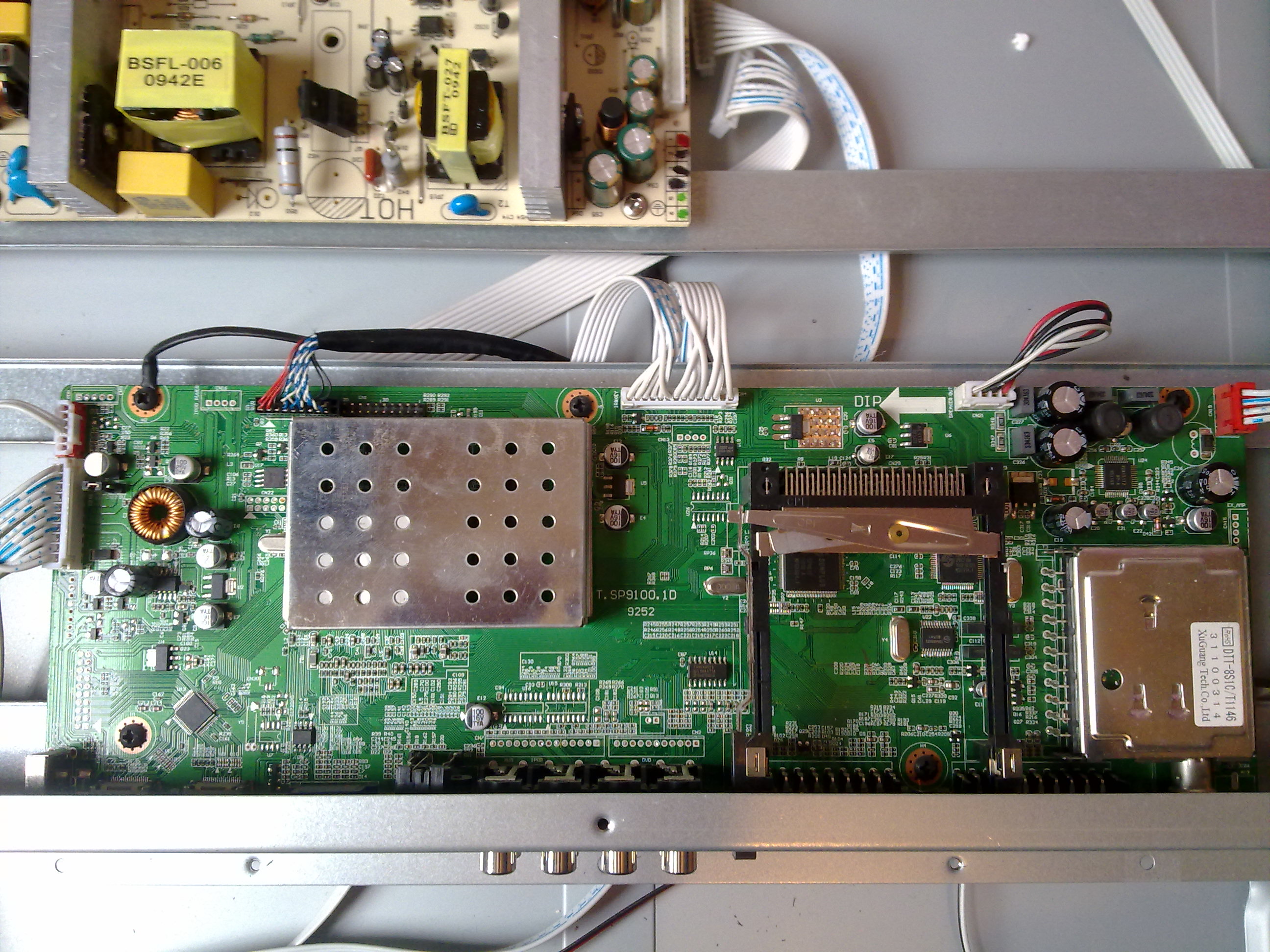

                                  Great pictures - perhaps try to get some of the main Board?
                                  What are the part numbers on IC1 ( Looks a bit heated?) and the similar device across to the right
                                  Cant see any fuses to check other than the main which is obviously ok, can you
                                    Will post main board pics in 2 minutes, ironically the phone is much better than my camera at taking pictures
                                    IC1 = ob6563cp
                                    Cannot read the number on the other ic :o( will check on the other boards if any better
                                    I did disconnect all the connectors and shorted out ps with 5v but still got nothing from the 12 and 24
                                    I cant see any other fuses
                                      Here are the images of the main board and the other icc is ez949
