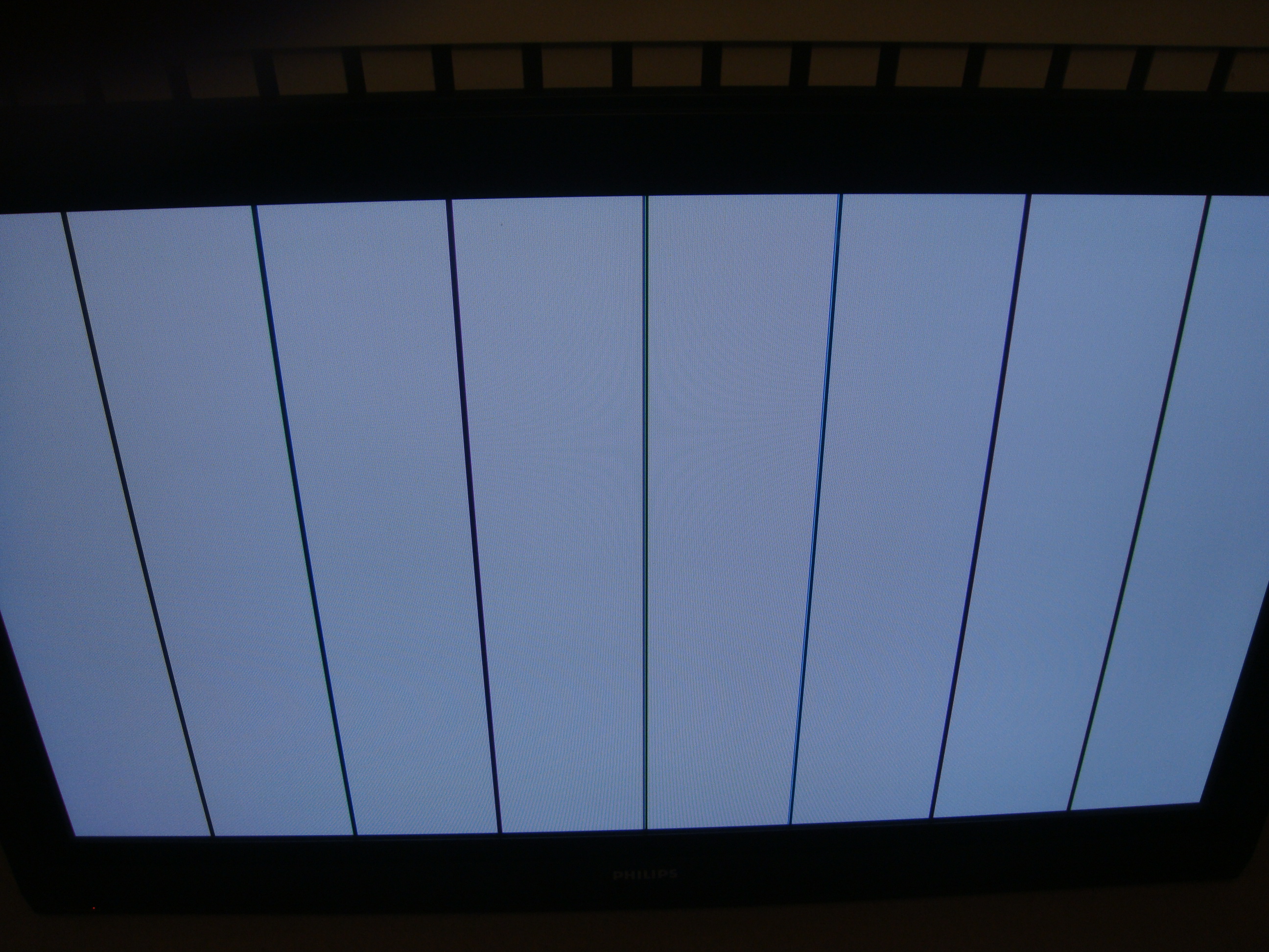

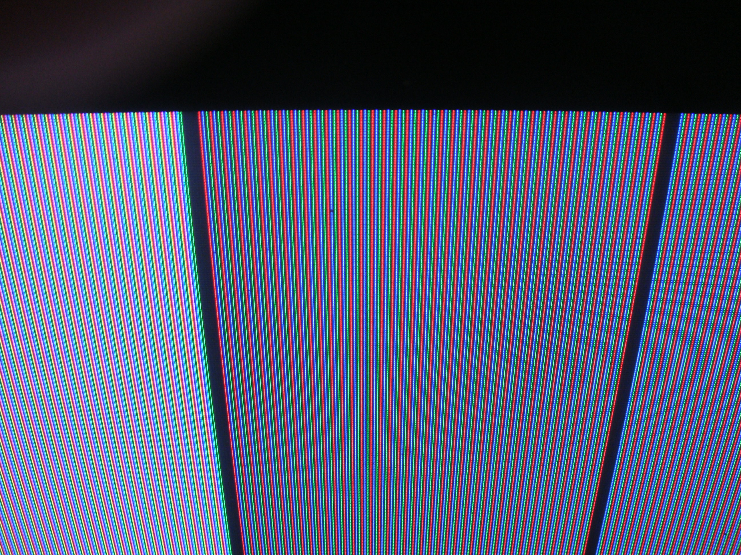

    Hey Guys,
    Another one to tax the brains! Just started one day to give a picture as per the attached image, sorry it was taken on my phone as the TV is at my friends house and is soo heavy we decided to leave it alone till we know if we can fix it.
    The sound is fine, all connections externally have been checked.
    Andyd
    Re: PHILIPS 50PFP5532D-05 Image Issue
    Bad digital board. Does it affect all menus and all inputs?
      Hi Tom,
      You are a super star helping me, thank you.
      I ahve checked with my friend and he gets the same image from any external device and also when he uses the TV menu's he gets the same image.
      Andy
        So, the lines cover the menus on the display?
          I have spoken to my friend and yes you get the same image when you select the TV menu and also if you plug it into an analogue aerial.

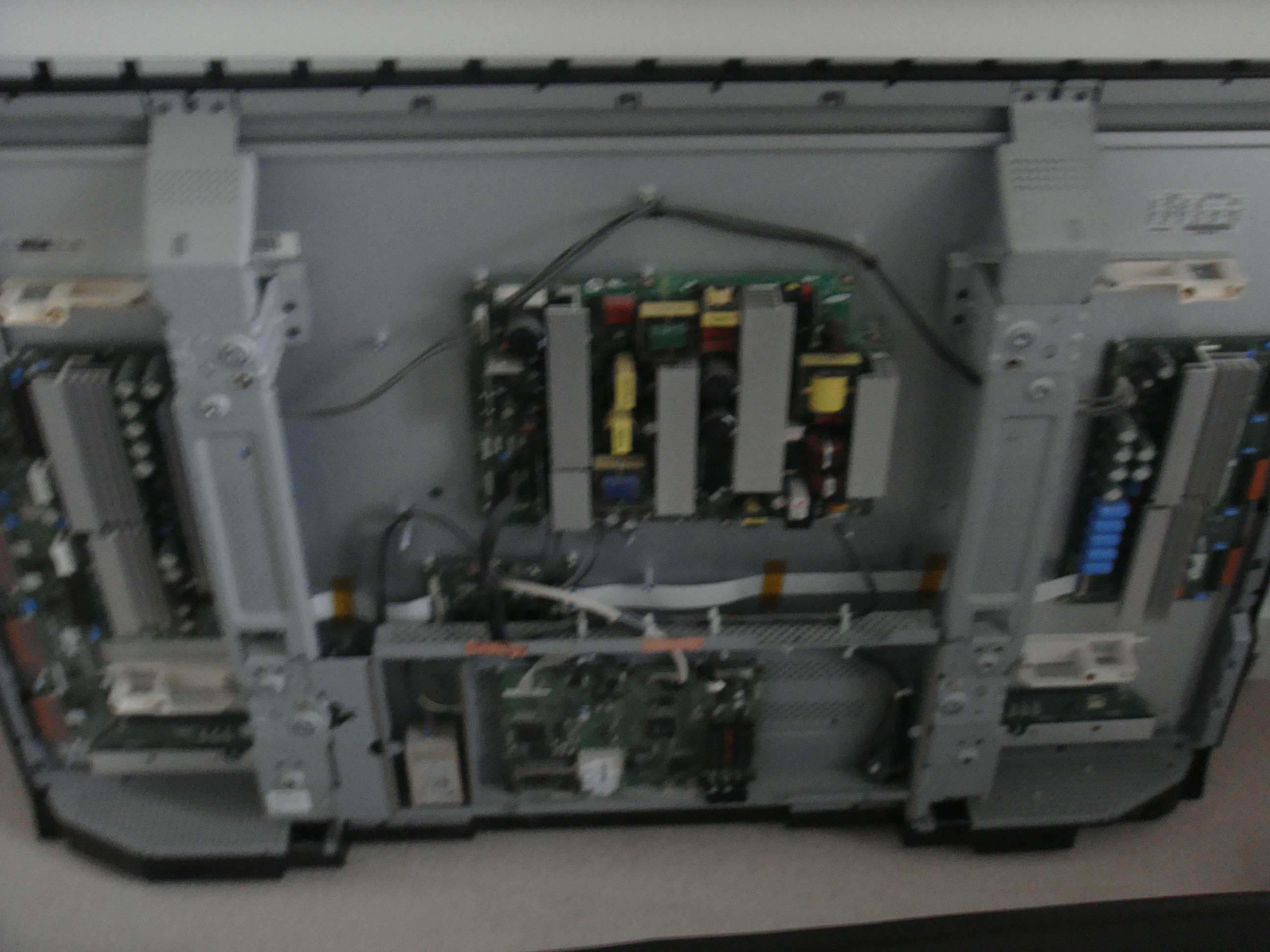

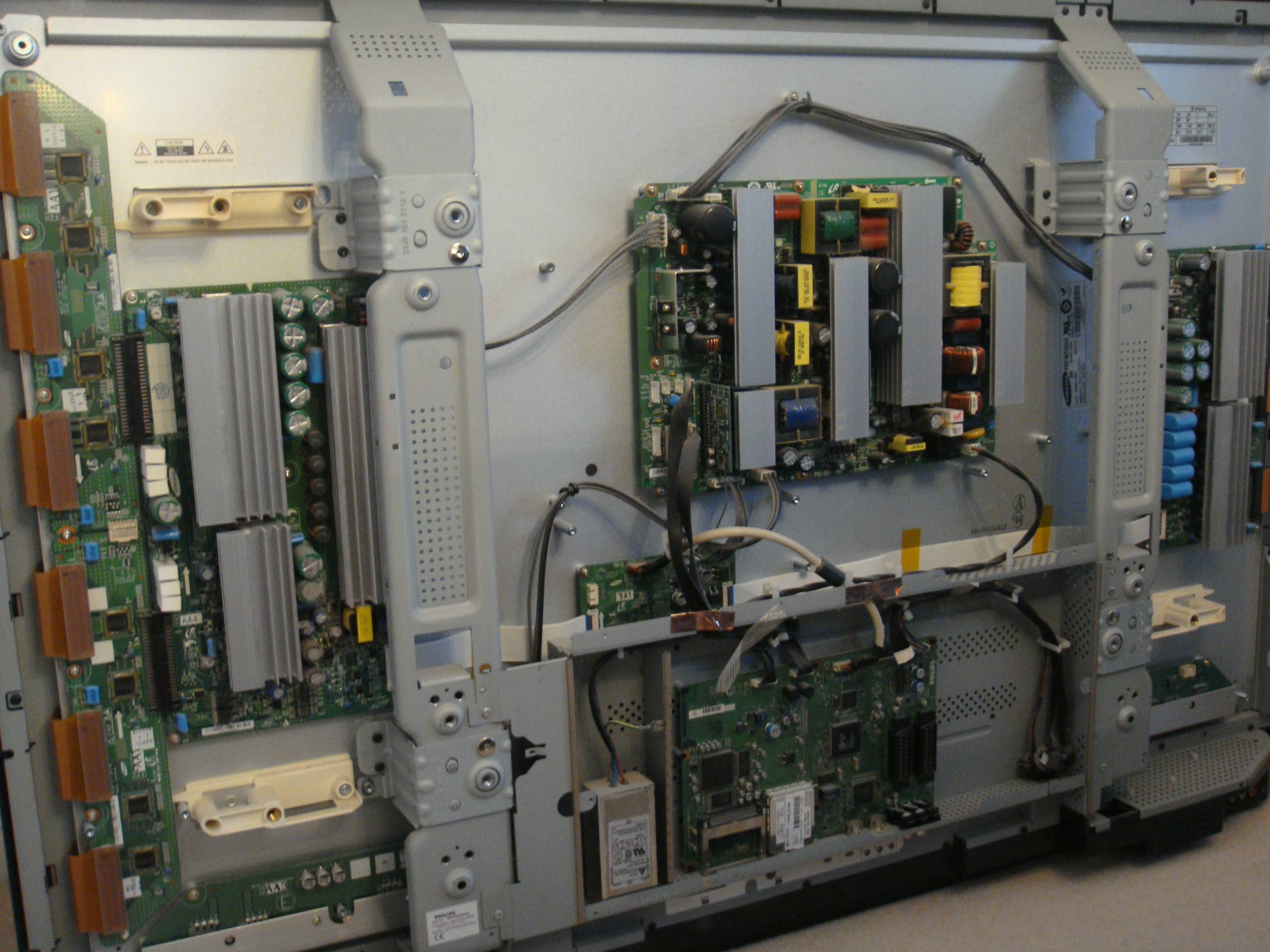

                  Your camera, to take pictures of the chassis. Everything is working apart from those lines, so it's not going to be a PSU issue.
                  • Andyd1970
                    • Feb 2013
                    • 374
                    • united kingdom

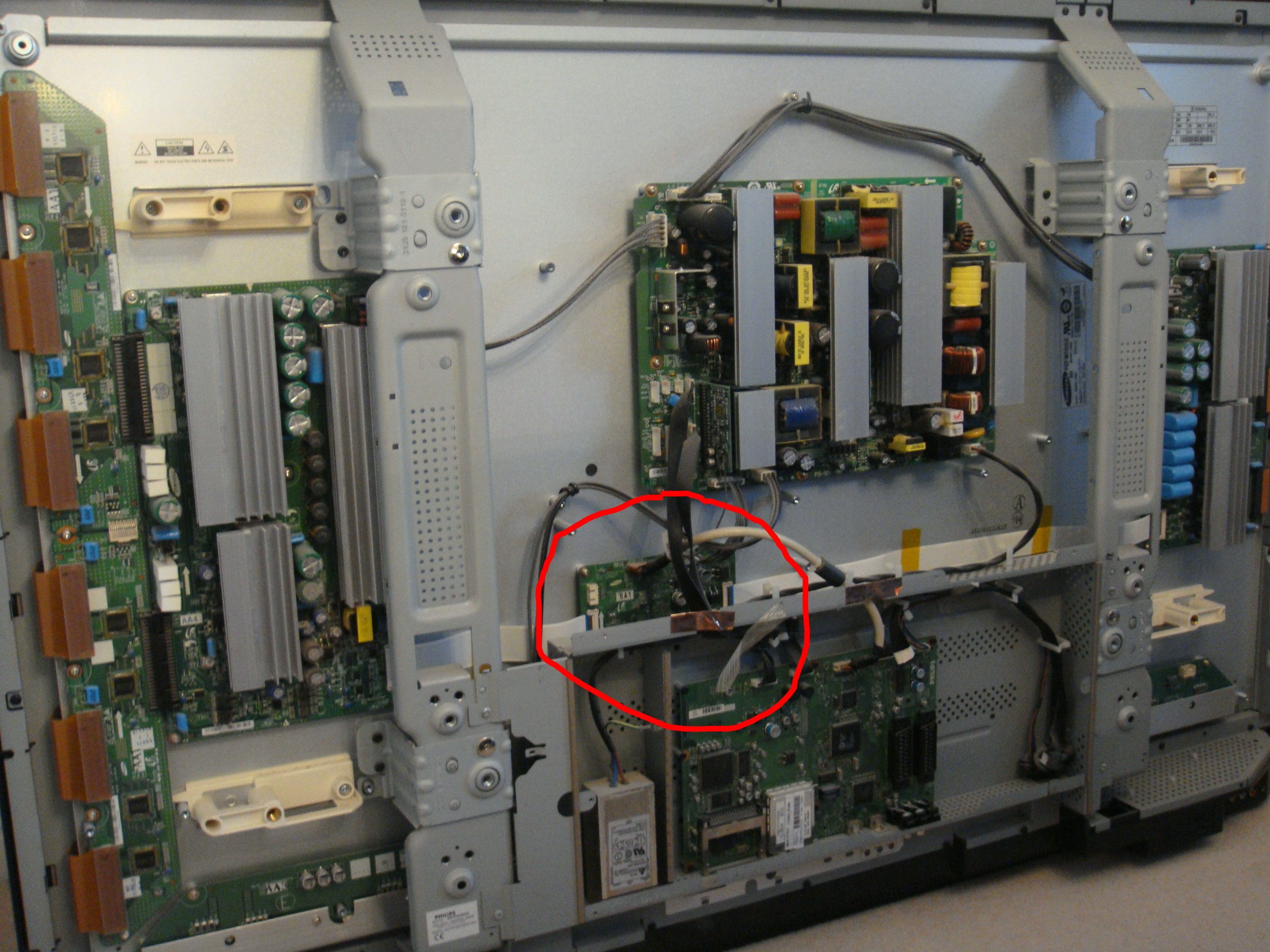

                    Hi Everyone,
                    As requested pictures of the chassis..
                    Any suggestions?
                    Thank you Andy
                    PS - Its realllly cold in East Kent today

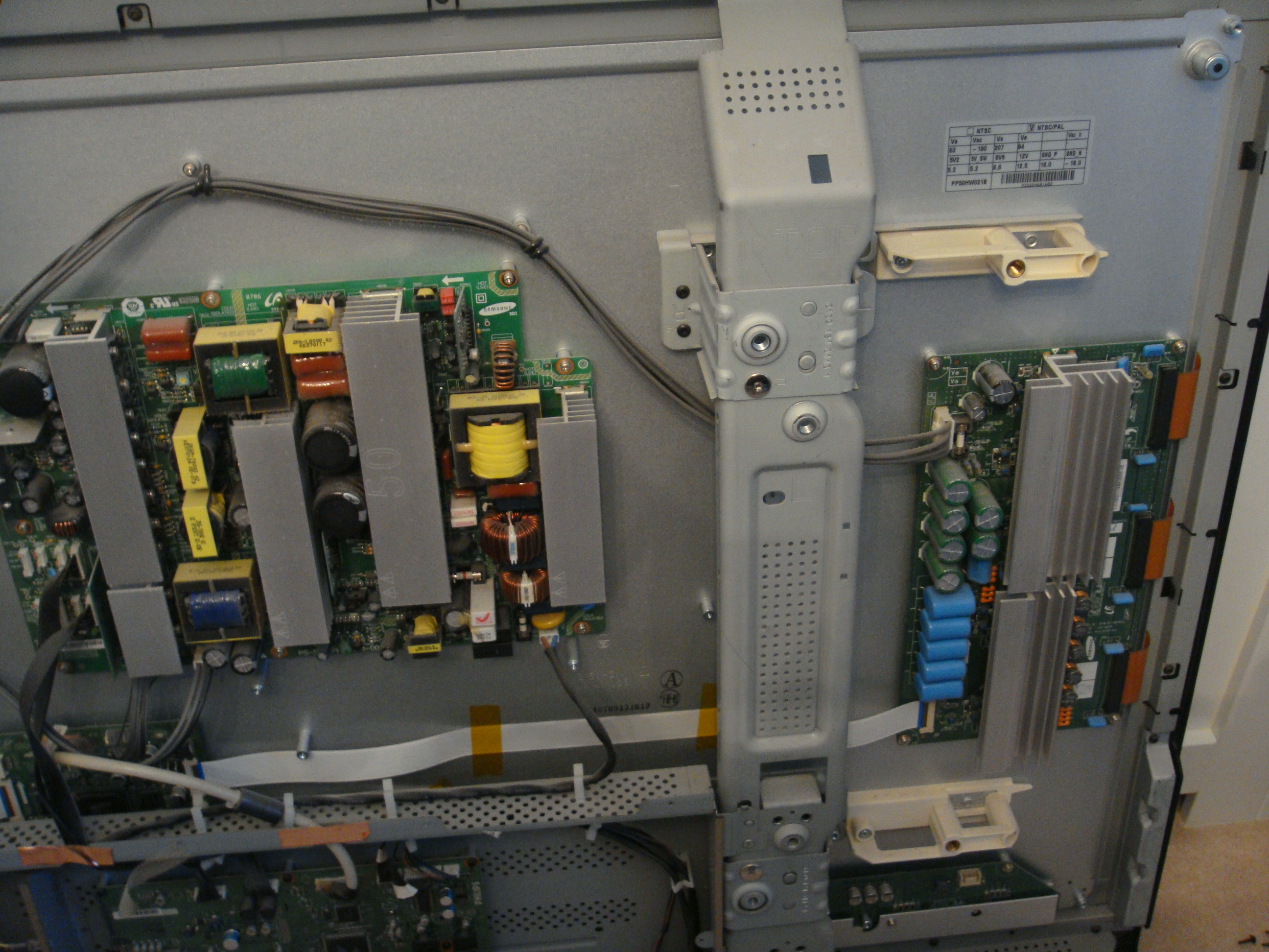

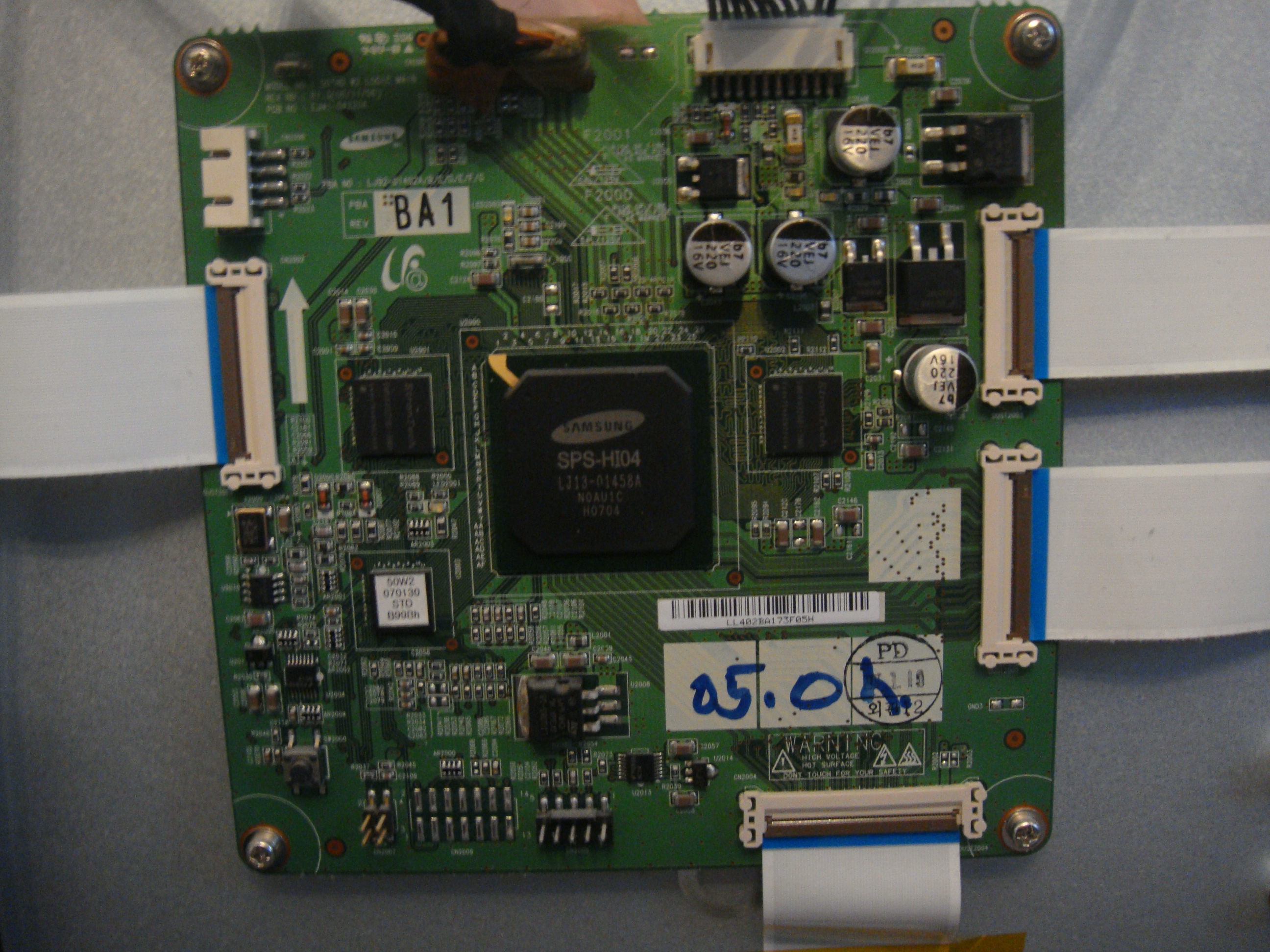

                      Here's the control board.
                      Can you remove the main board frame, and get a closer shot of it?
                      PS - It's extremely cold in Leeds.
                      • Andyd1970
                        • Feb 2013
                        • 374
                        • united kingdom

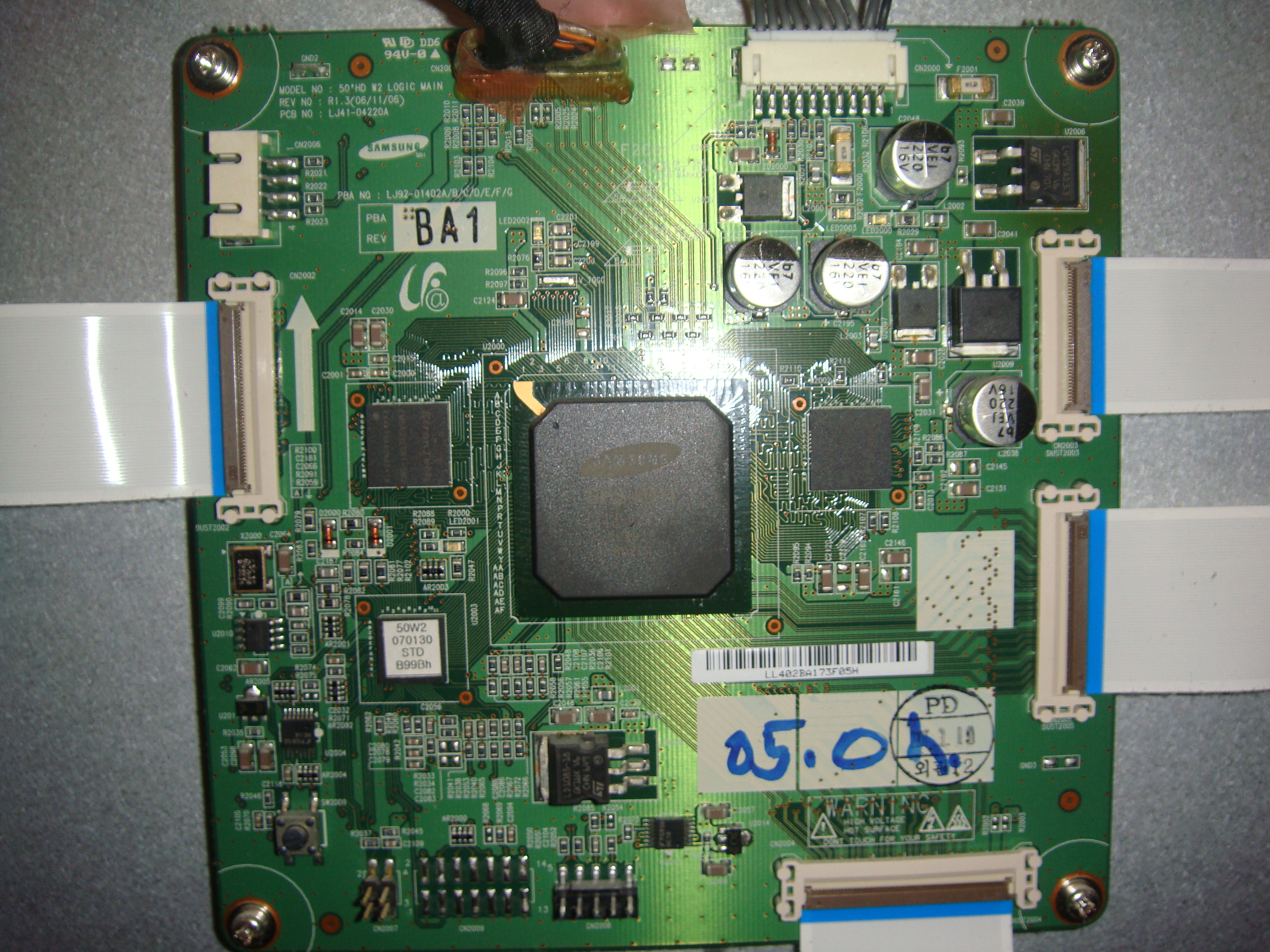

                        Hi Tom,, See pics of the PCB.
                        Andy

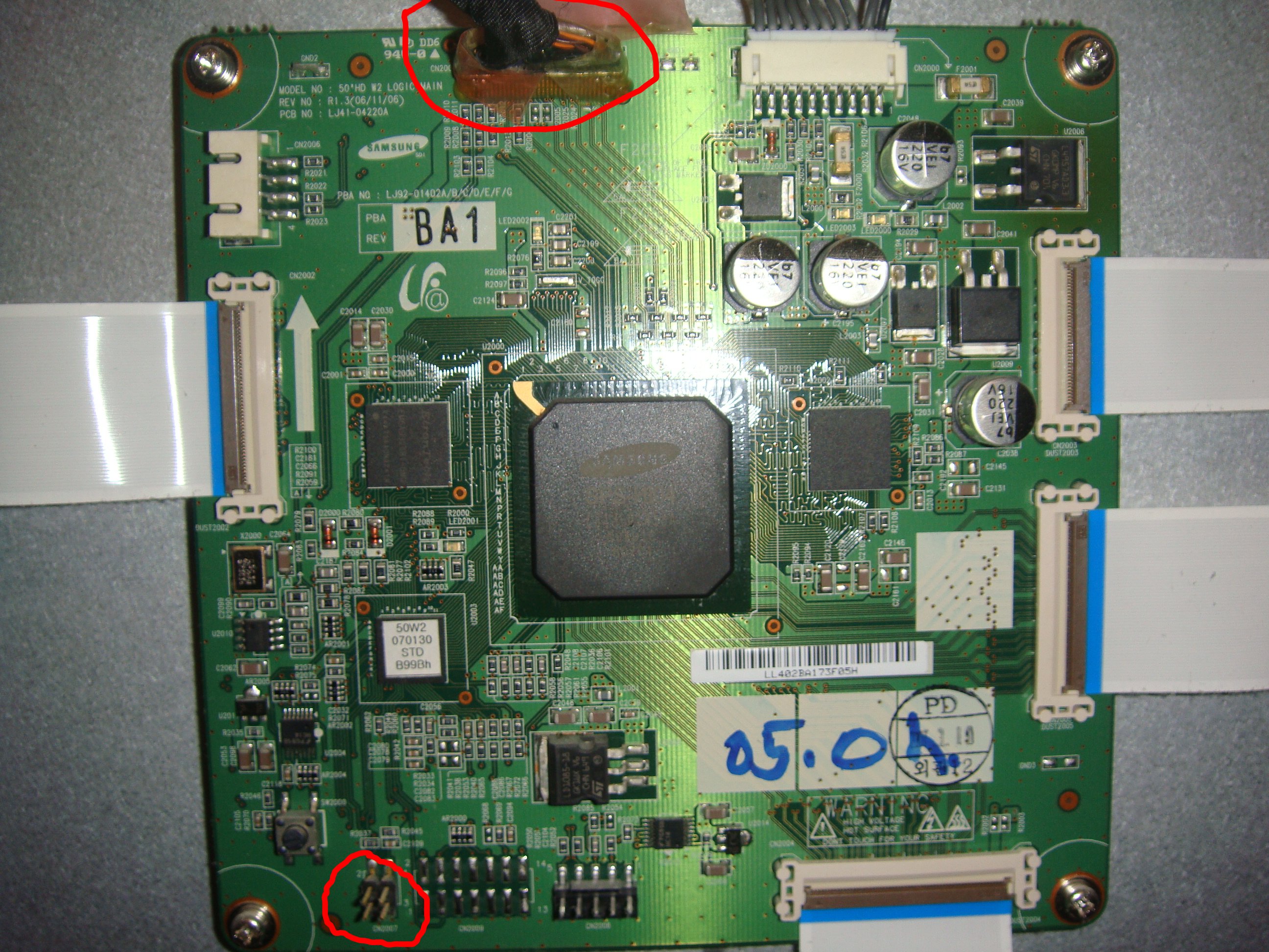

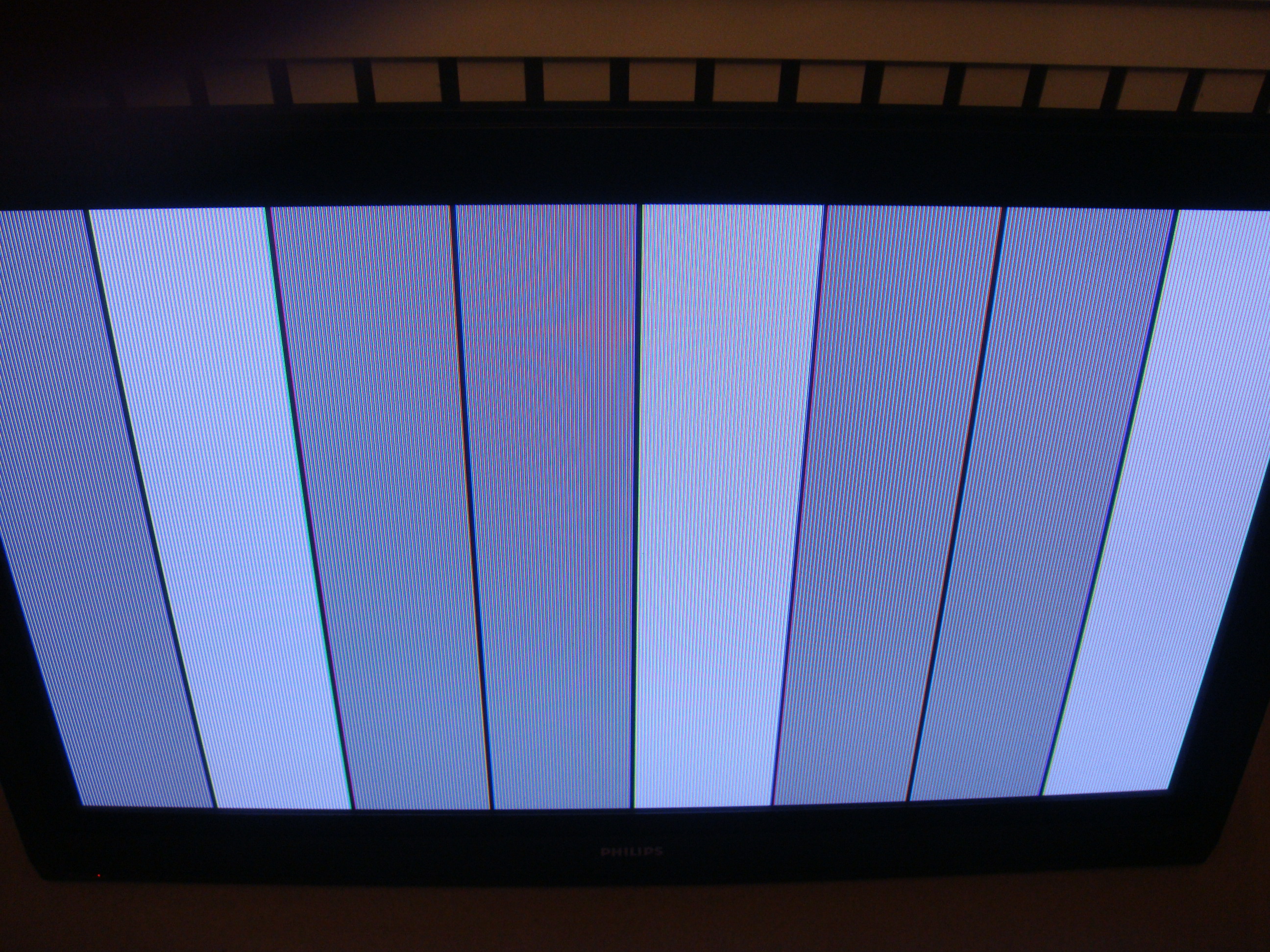

                          See pic.
                          Power OFF and unplugged.
                          Place HDD setting jumper across pins 3-4 of the 4 pin block CN2007. A piece of bent wire works too.
                          Disconnect LVDS, the glued connector, at the main board end (not on the control board... the glue will make it a nightmare.)
                          Power ON normally.
                          Test patterns should appear. Do the lines cover the test patterns?
                          If YES: Control board 100%.
                          If NO: Main board 95% or Control Board.
                          • Andyd1970
                            • Feb 2013
                            • 374
                            • united kingdom

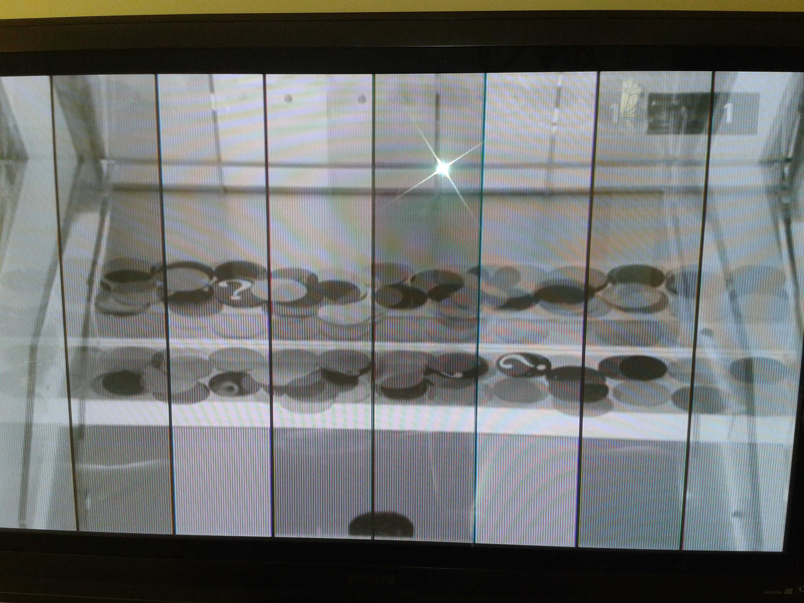

                            Hi Tom66,
                            Just did as you suggested and the banding was still there. So guess that proves control PCB, just go to find one now.
                            Andy

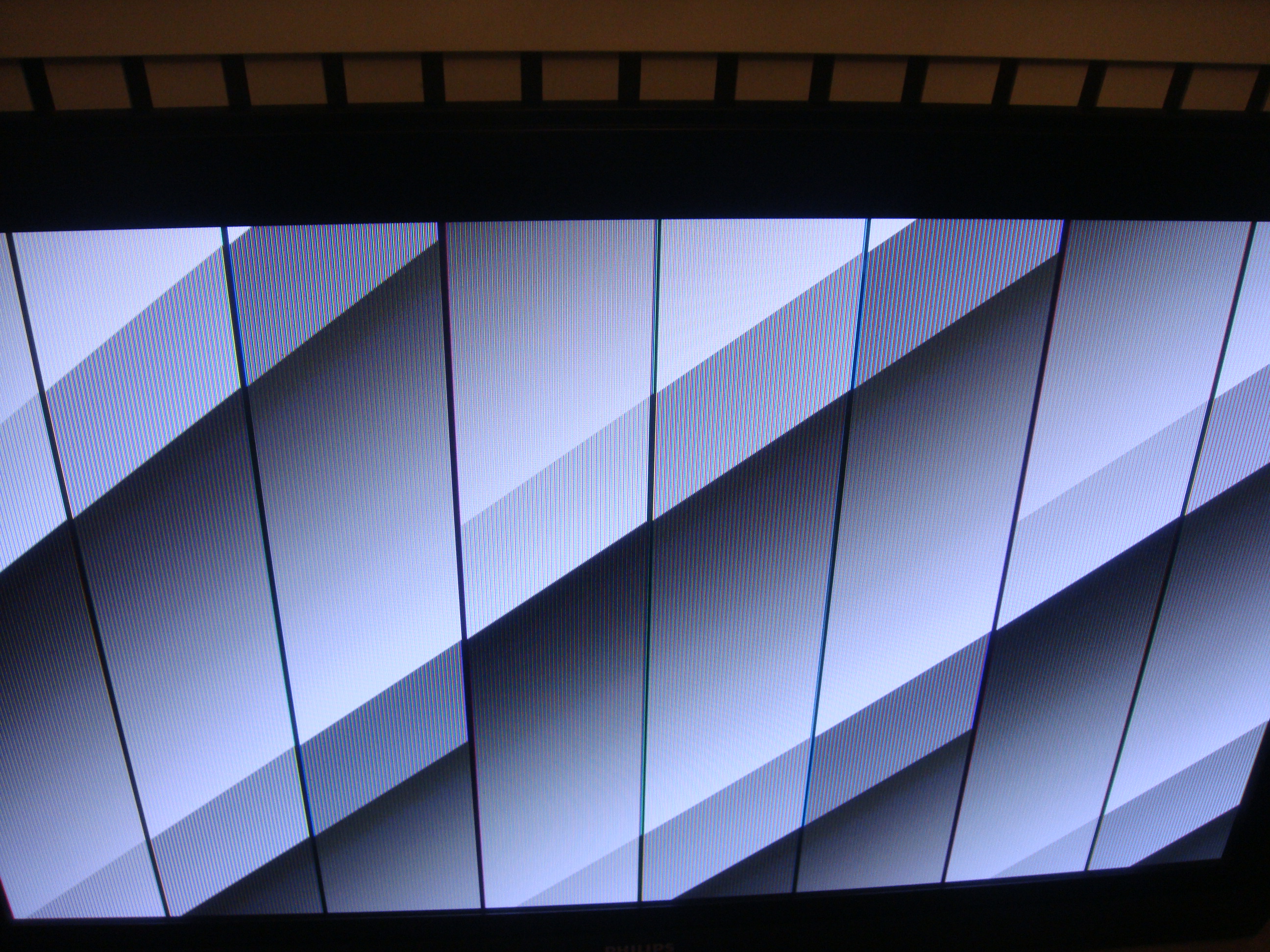

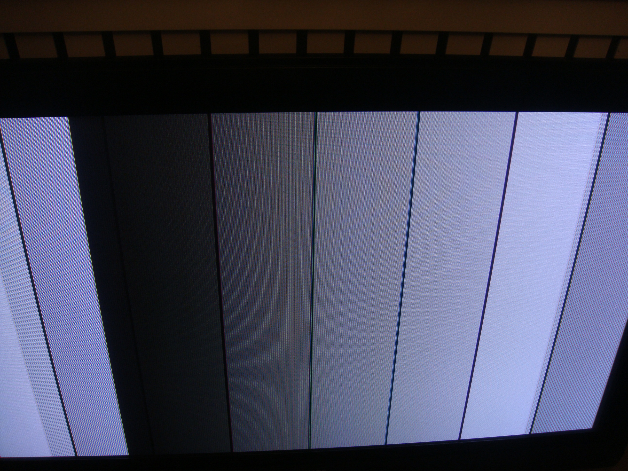

                              Can we see a picture of the test patterns?
                              • Andyd1970
                                • Feb 2013
                                • 374
                                • united kingdom
                                Pics below
                                  If I were to guess a particular fault on the control board I would say a problem with the RAM or BGA bondings on the processor. I note it is around £50 from several suppliers.
                                    Thank you Tom ,your a star.
                                    When you say bonding could it be a cold joint? is it worth reflowing anything?
                                    What suppliers have you found that have the PCB?
                                    Thank you again
                                    Andy
                                      I would give reflowing a go -- nothing to lose.
                                      eBay was £50, this guy has two:
                                      http://www.ebay.co.uk/itm/SAMSUNG-PH...item19d6a86c70
                                      • Andyd1970
                                        • Feb 2013
                                        • 374
                                        • united kingdom
                                        Hi Tom,
                                        The PCB arrived today, fitted it to the TV and hey presto it works!
                                        Thank you for your help, I will certainly remember what you have explained to me.
                                        Really appricate your help.
                                        Andy
