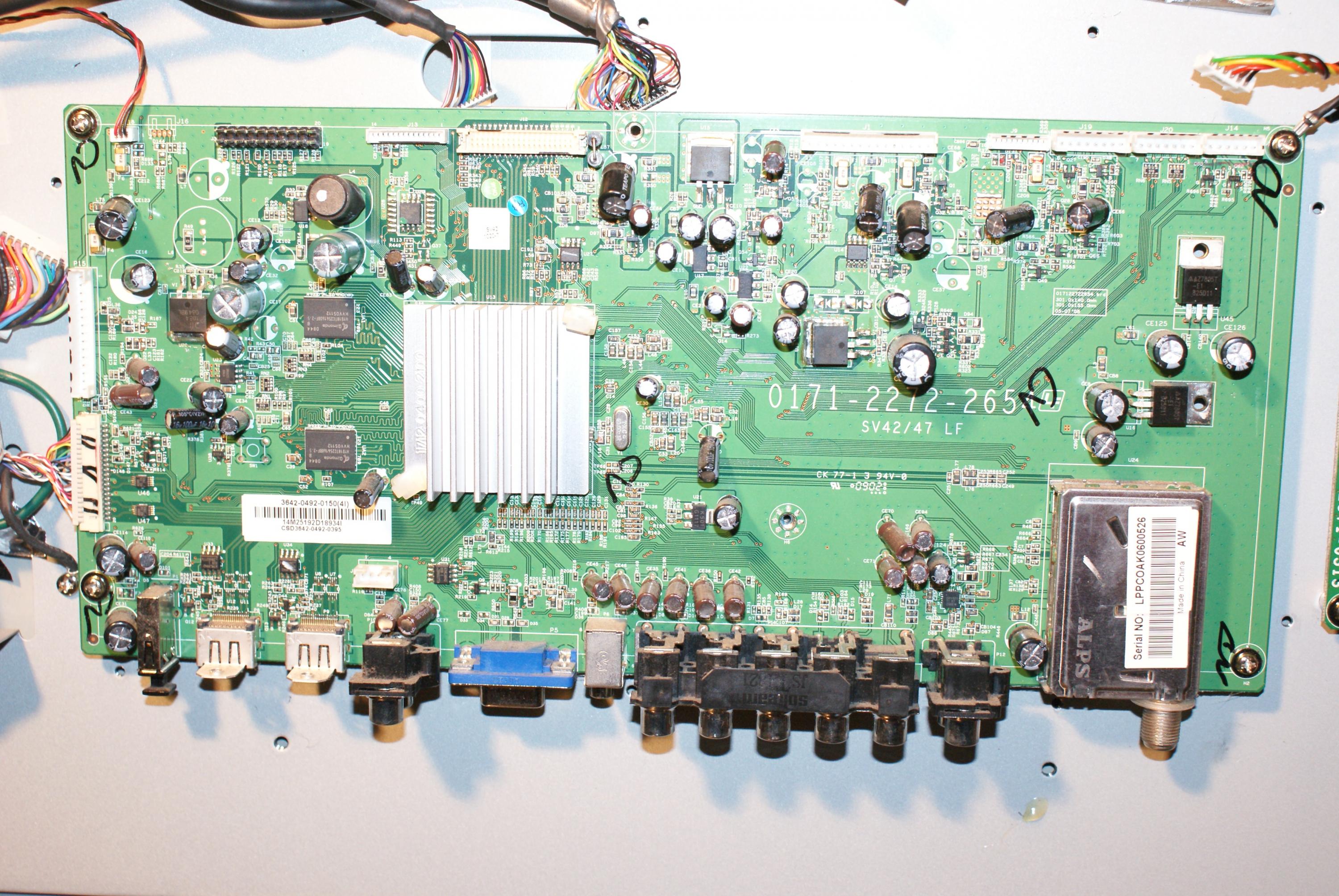

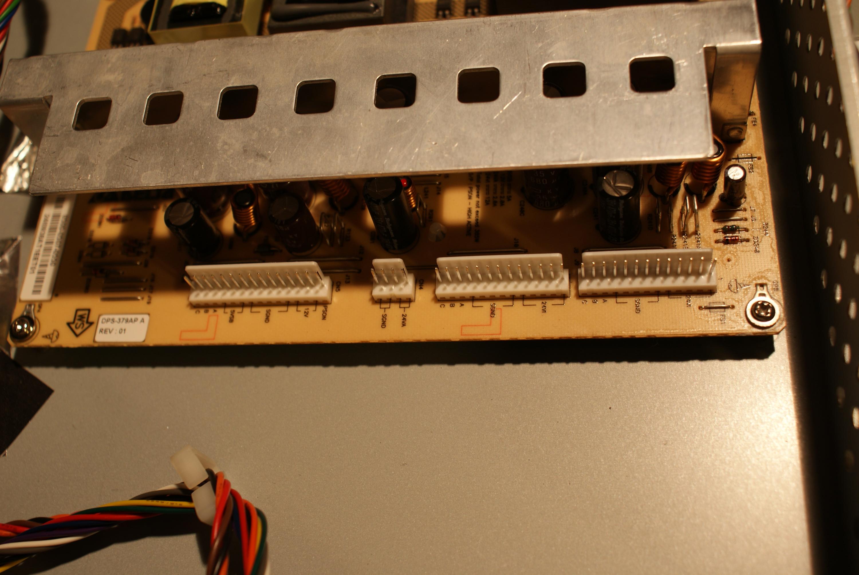

    I'm very glad to be able to come back with another adventure and willing to make it to be a very pleasant experience. I really learned a lot last time. I got this tv from craiglist. The tv turn on with back light but no sound or video. I'm able to turn it on and off with the remote but tha's all i can do. I bougth a main board on ebay but it did tha same thing.On the power supply I am getting the 24.v on cn2, cn3, cn4 and 11.74v and 5v on cn5. At the t-con board i'm getting 11.6v boths side on the pico fuse. Pico fuse on the inverter are good. Main board pico fuse are all good. check both side, getting same reading. f6=5v, f4=4.6, f1=5v, f2=11.7v, f5=5.v. Audio board is getting the 24.v

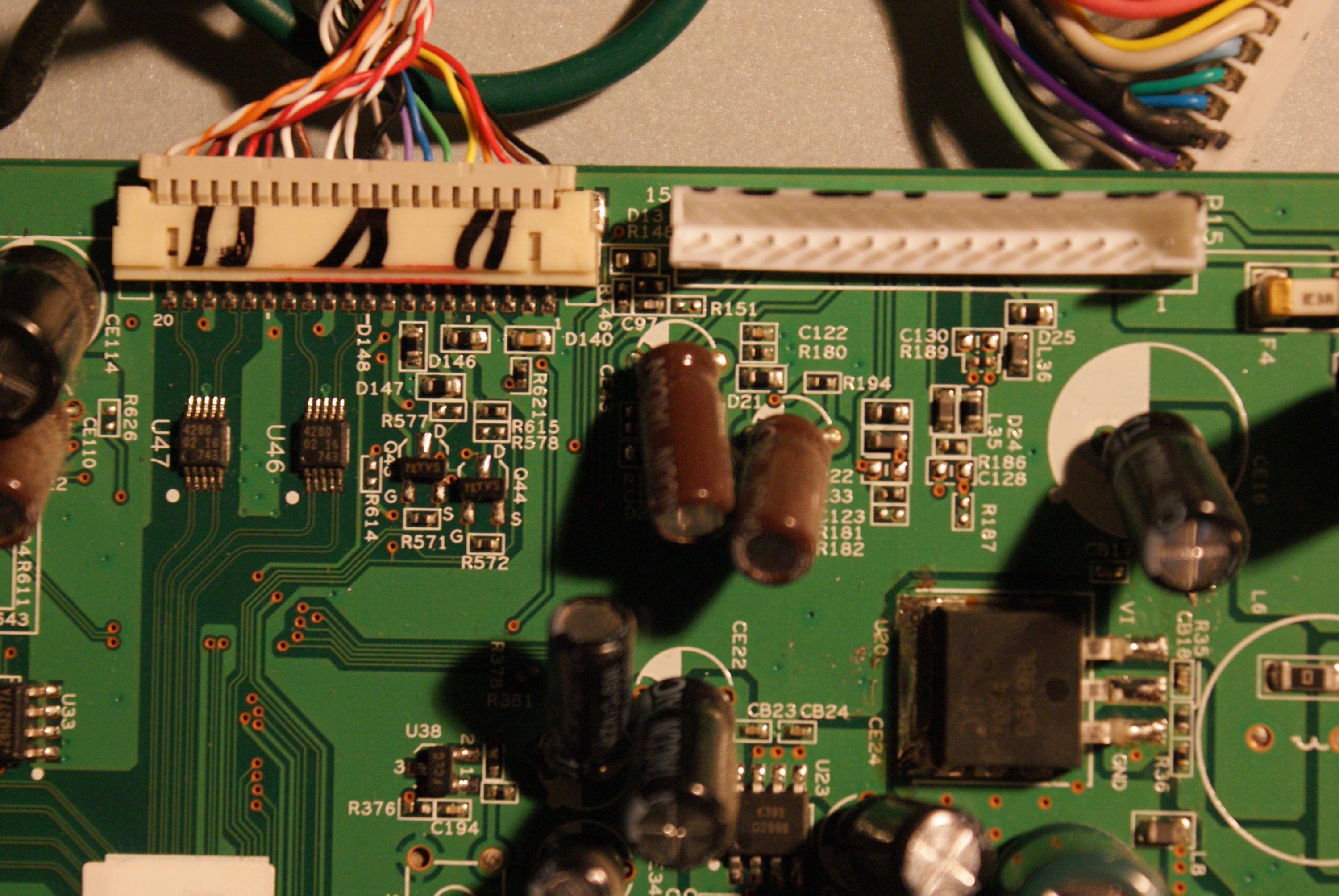

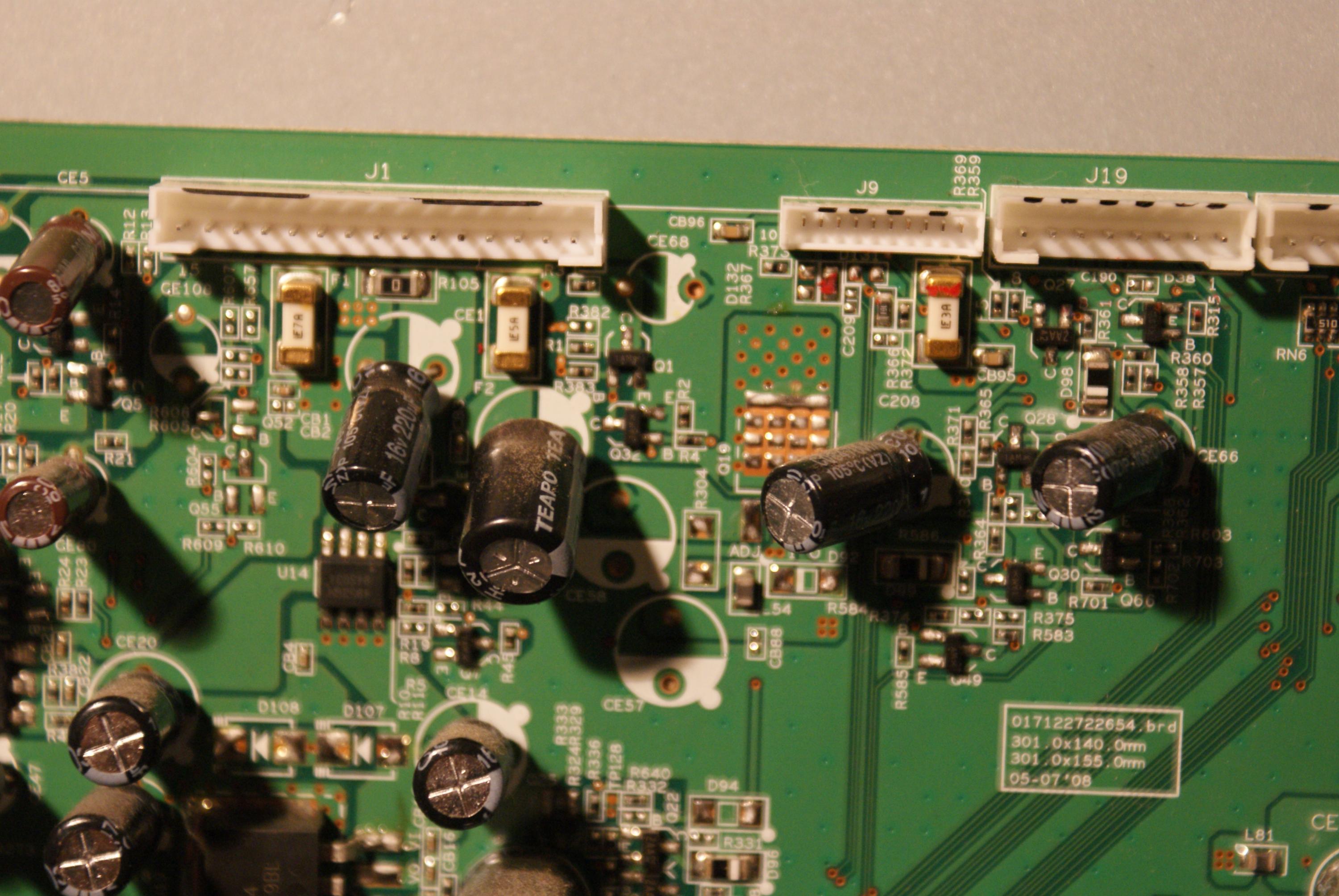

                    Re: vizio tv sv470xvt 1a white screen
                    I been doing some more research on the boards and this is what i got. On the main board I tested the voltage regulator and got this:
                    u16 in 11.7v, out 5.0v,
                    u45 in 11.7, out 5.0v,
                    u15 gnd. 2.1v, vo 3.3v, vi 4.9v,
                    u20 gnd .5v, vi 3.3v,
                    u21 pin 1, 0, pin 2, 1.2v, pin 3, 0 (I DOUBLE CHECK THIS READING, BLACK PROBE ON GROUND
                    U22 PIN 1, 2.0V, PIN 2, 3.3V, PIN 3, 5.0V
                    U17 PIN 1, 2.0V, PIN 2, 3.3V, PIN 3, 5.0V

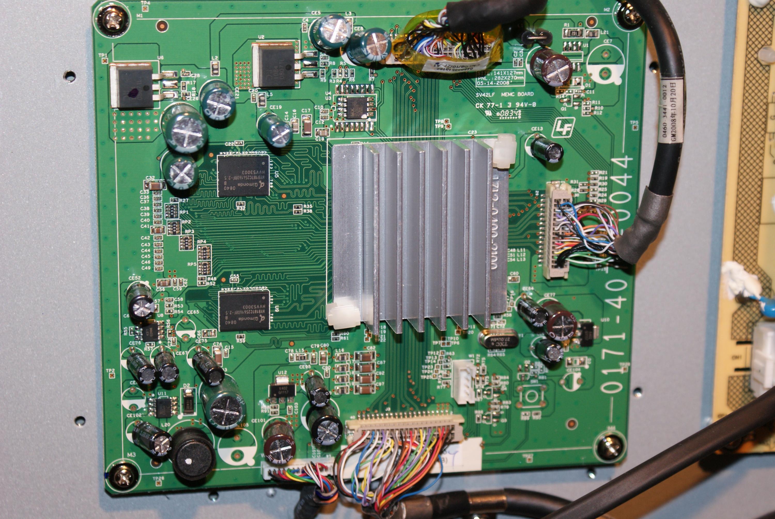

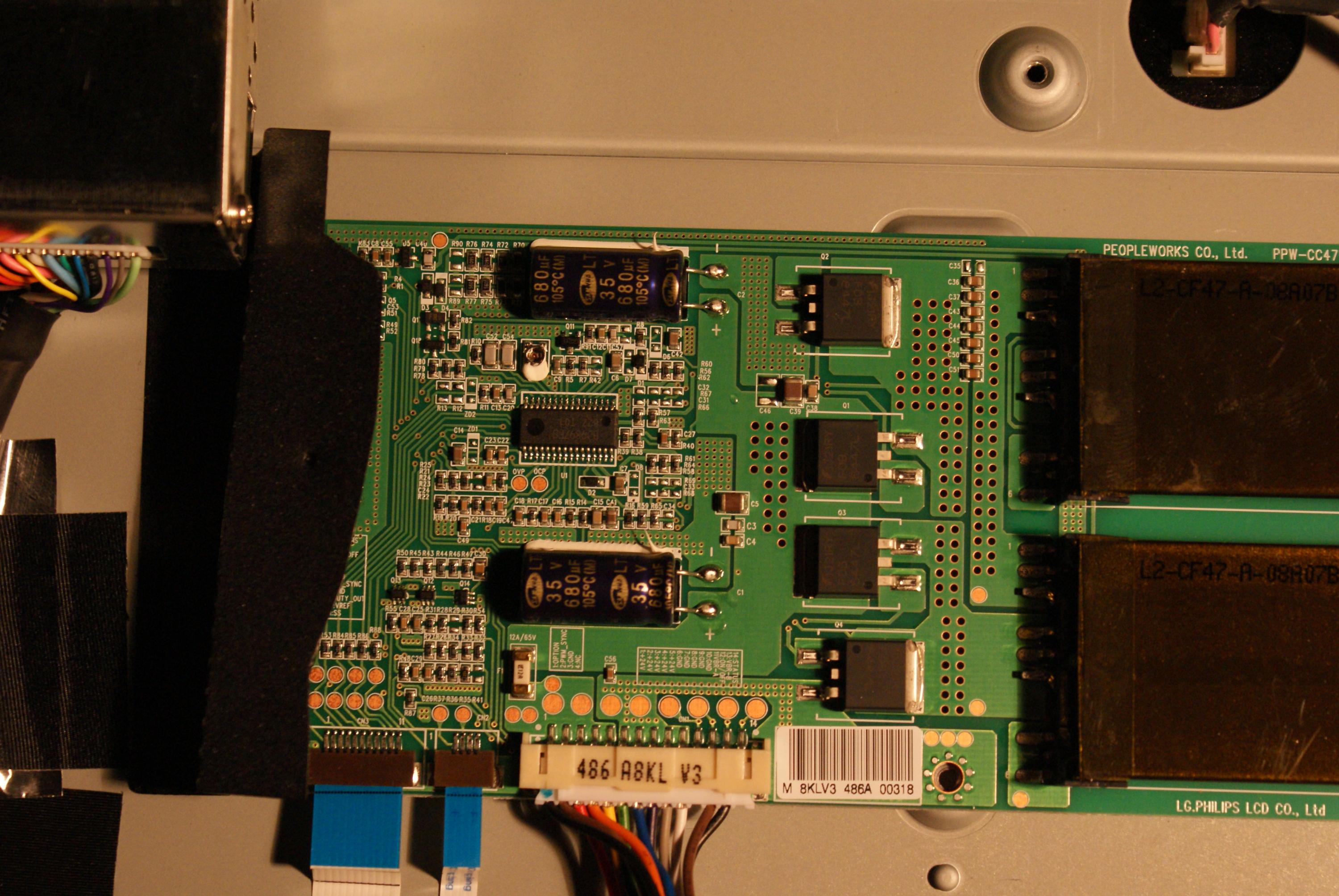

                    ON LOGIG BOARD, (DAUTHER BOARD)
                    U10 PIN 1, 0 READING, PIN 2, 0 READING, PIN 3, 3.3V ( i REPLACE THIS REGULATOR BUT STILL GIVE ME THE SAME READING). HOPE THIS INF. WILL HELP

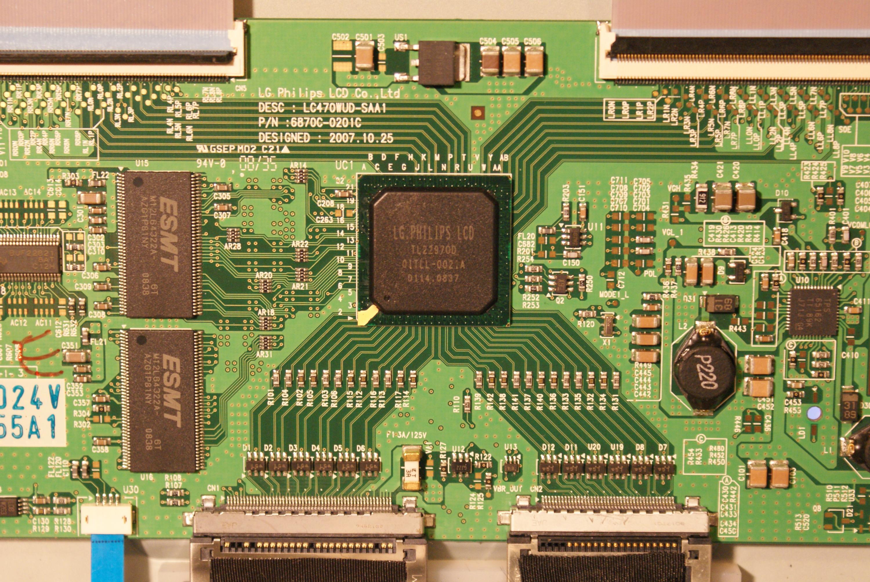

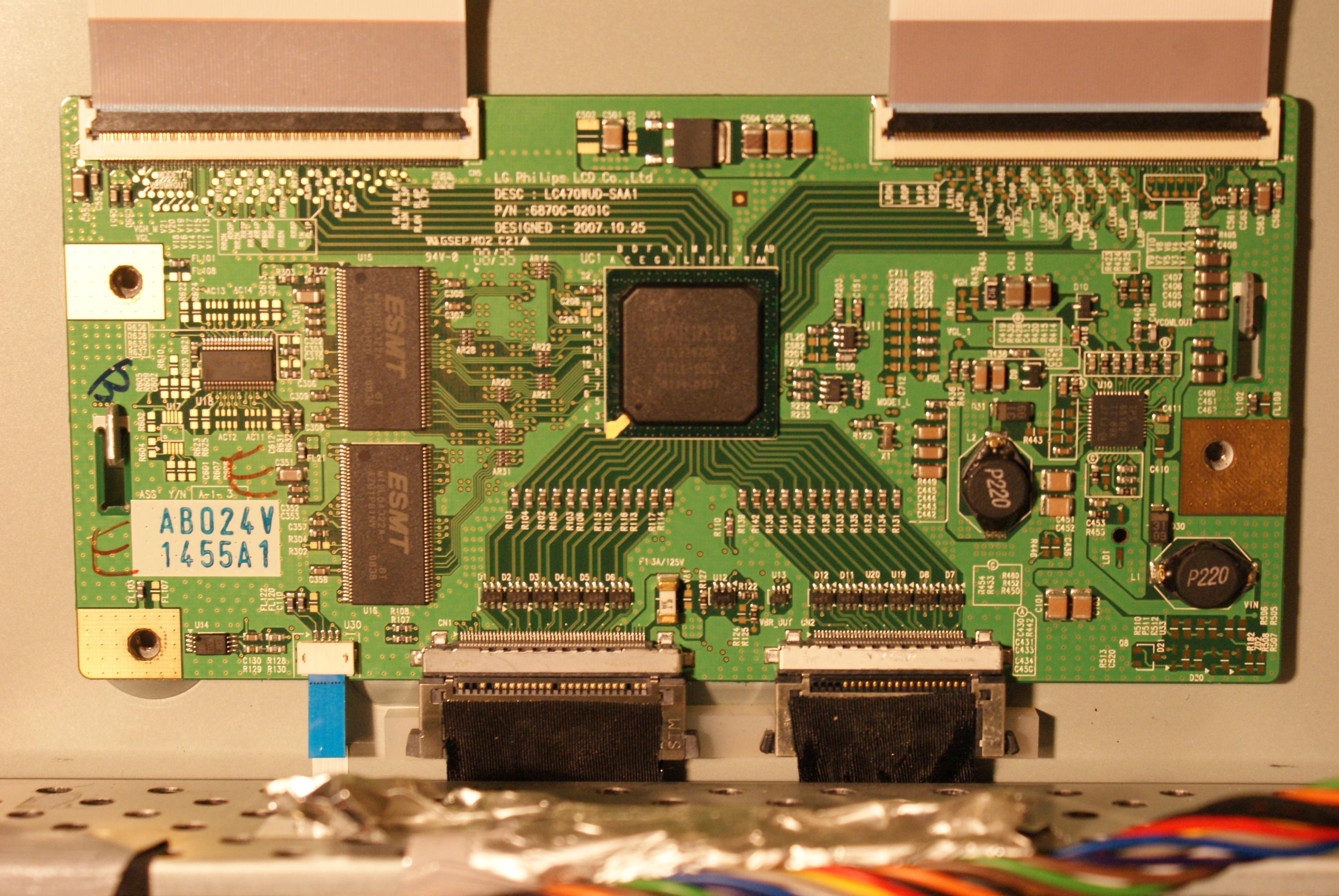

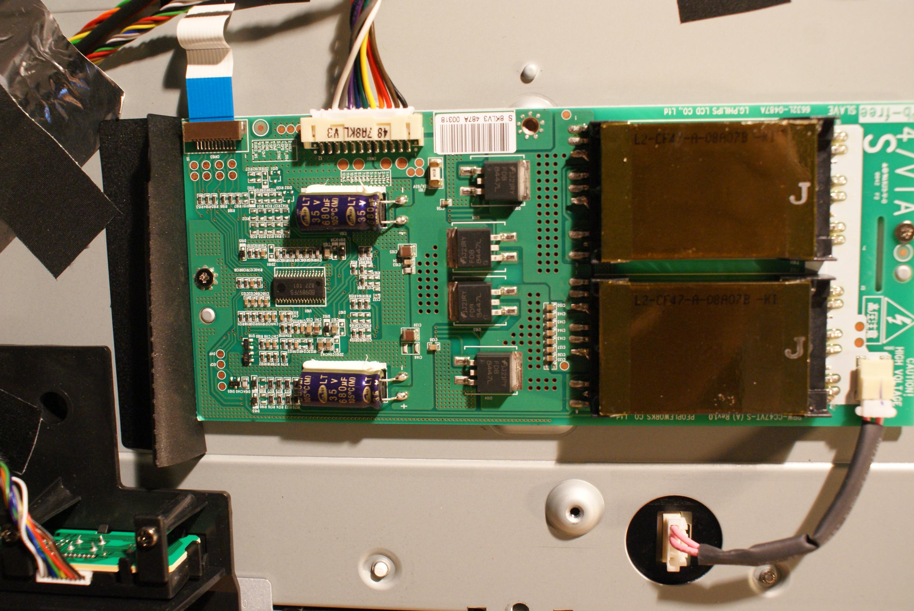

                      Hi Bud, I been playing with this tv all day, but i think i found out what's wrong. I unplug one of the top t-con ribbon and half of the screen came alive with sound, that tell me that i have a problem in the t-con board. I am going to check if there is another fuse for that side, if not i am going to order a t-con board. Keep you in touch.

                        can anyone tell me if there is another fuse in this t-con?

                          good afternoon budm. I installed the new (used) t-con board and stii don't have a picture, it does have sound and back light. Were do i go now?

                            Your tcon appears to have 6 fuses, the main ceramic one plus the other 4 on the left side labeled fl21, fl22, fl120, fl122. plus one more on right fl20, hope that helps
                            Liberating magic smoke one part at a time
                              FLxx are not fuses but ferrite beads.

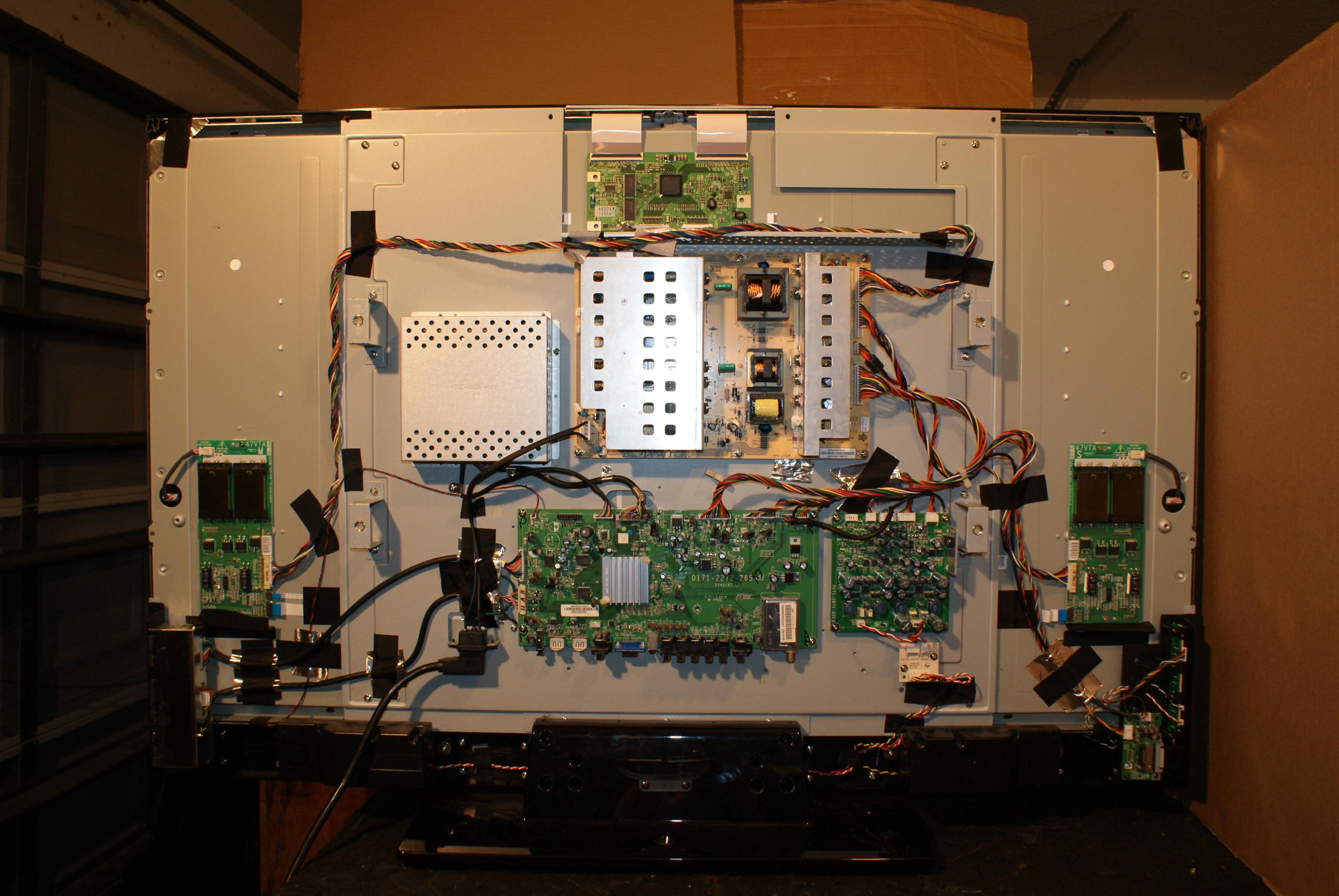

                                I had one LCD TV I was working on that had a white screen only no picture with sound, I had to take a hair dryer and heat up the top area of the LCD Panel/Screen going all the way across it back and forth, that's where the 2 ribbon cables come out of the T-CON and go to the small narrow boards at the very top, after doing this I got vertical lines and then eventually a normal picture.
                                Also try slightly twisting the panel and see if your picture returns, sometimes bad tab bonds can cause a white screen and or vertical lines. be sure to make sure the ribbon cables are seated into their connectors properly.

                                      Can you completely remove the ribbons from the panel and the T-Con? If so, you say with one side connected you get a half picture, right? Try taking the ribbon from the good side and swapping it to the other side. Maybe you have a short in the ribbon cable.

                                        not anymore. went i plug the new board and it did not work went i put back the old one it stop working. I still have back light and sound but no picture
