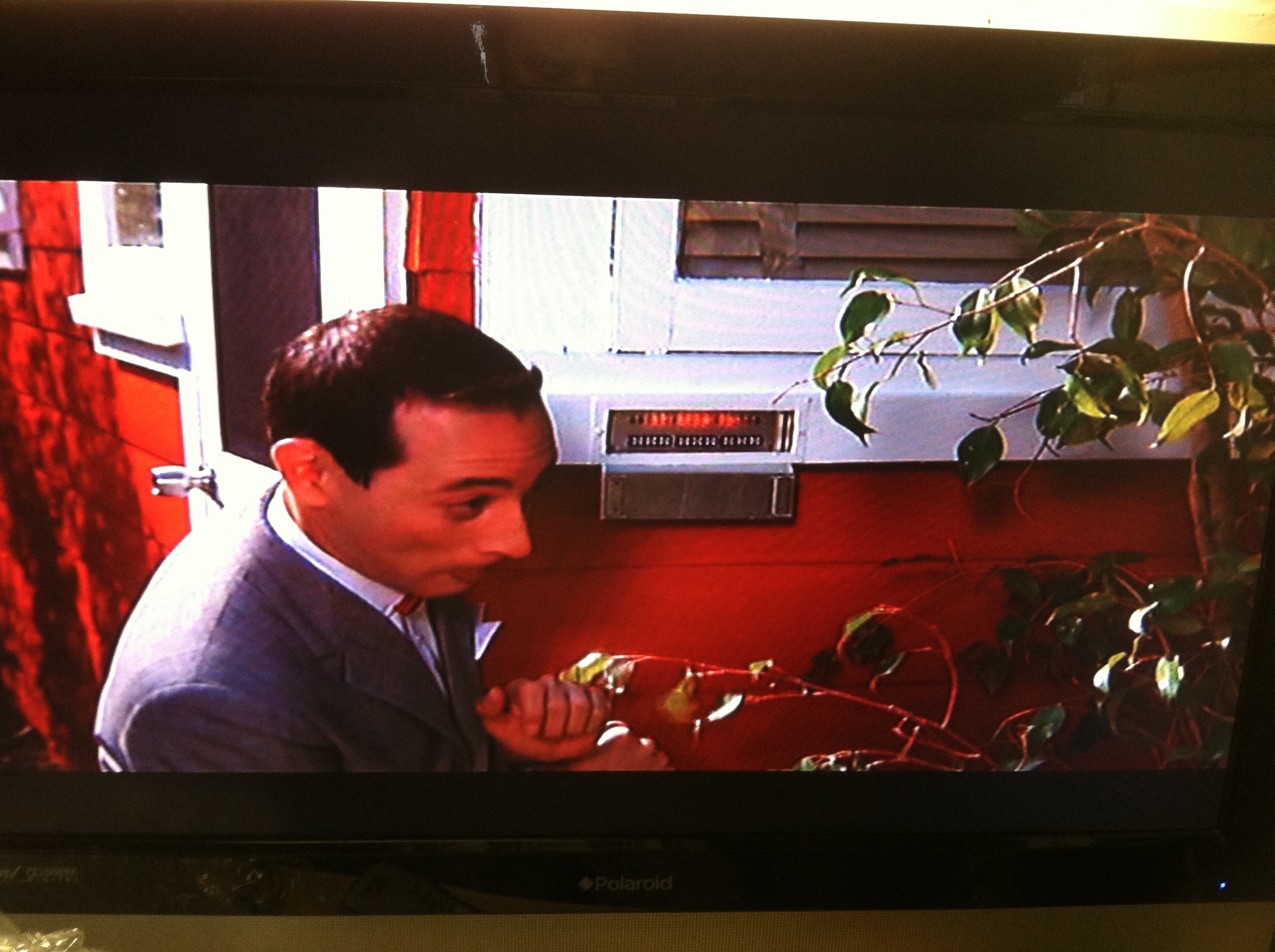

    johnboy, i had one doing the exact same,found by accident probing leads that it had bad solder rings on the inverter side.i resoldered both of the inverter and ps conections and the problem left. it was a flm3732. just throwing this out sometimes symptoms are same for different problems.
    • johnboy1313
      • Nov 2012
      • 1959
      Re: Polaroid FLM-3232 No Sound, No Picture
      I went ahead and ordered the control box. For $57.82, I figured it was worth it.
      • johnboy1313
        • Nov 2012
        • 1959
        New control box in and working.
