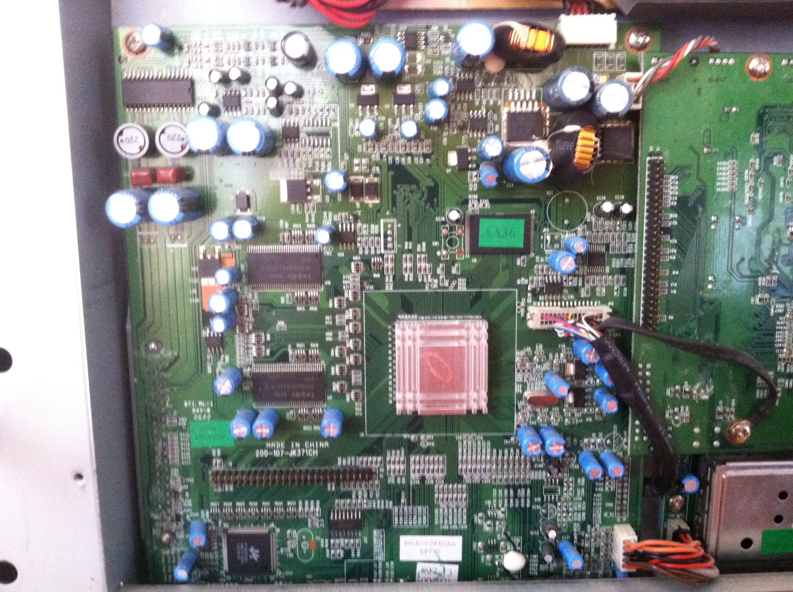

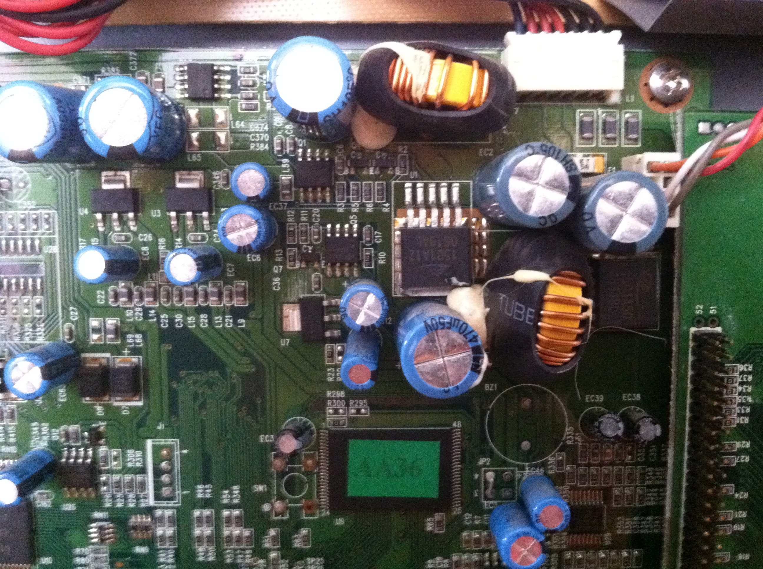

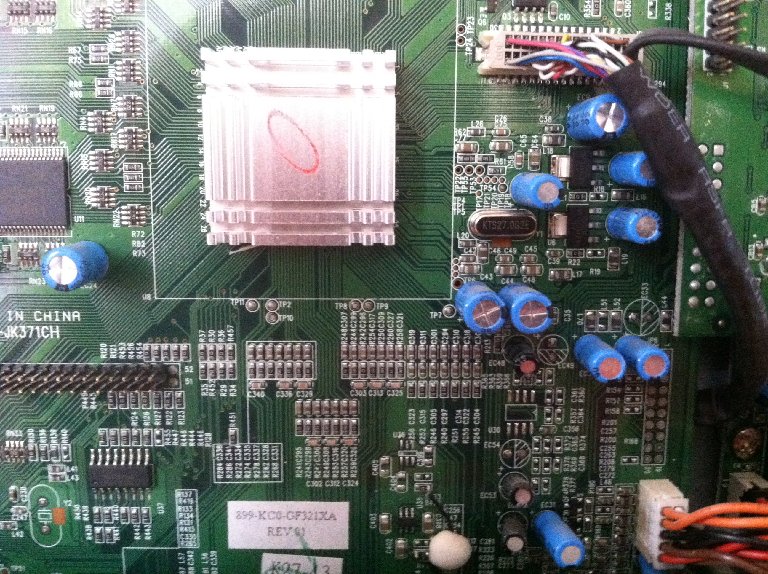

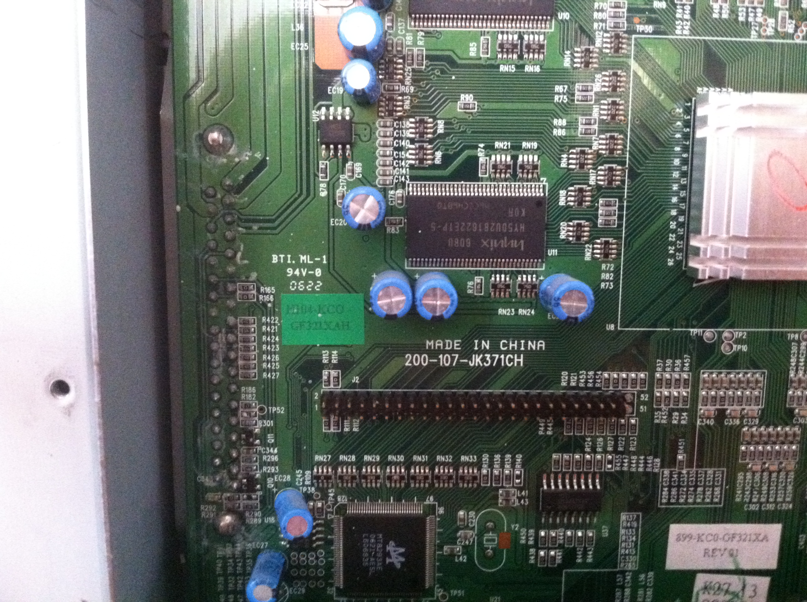

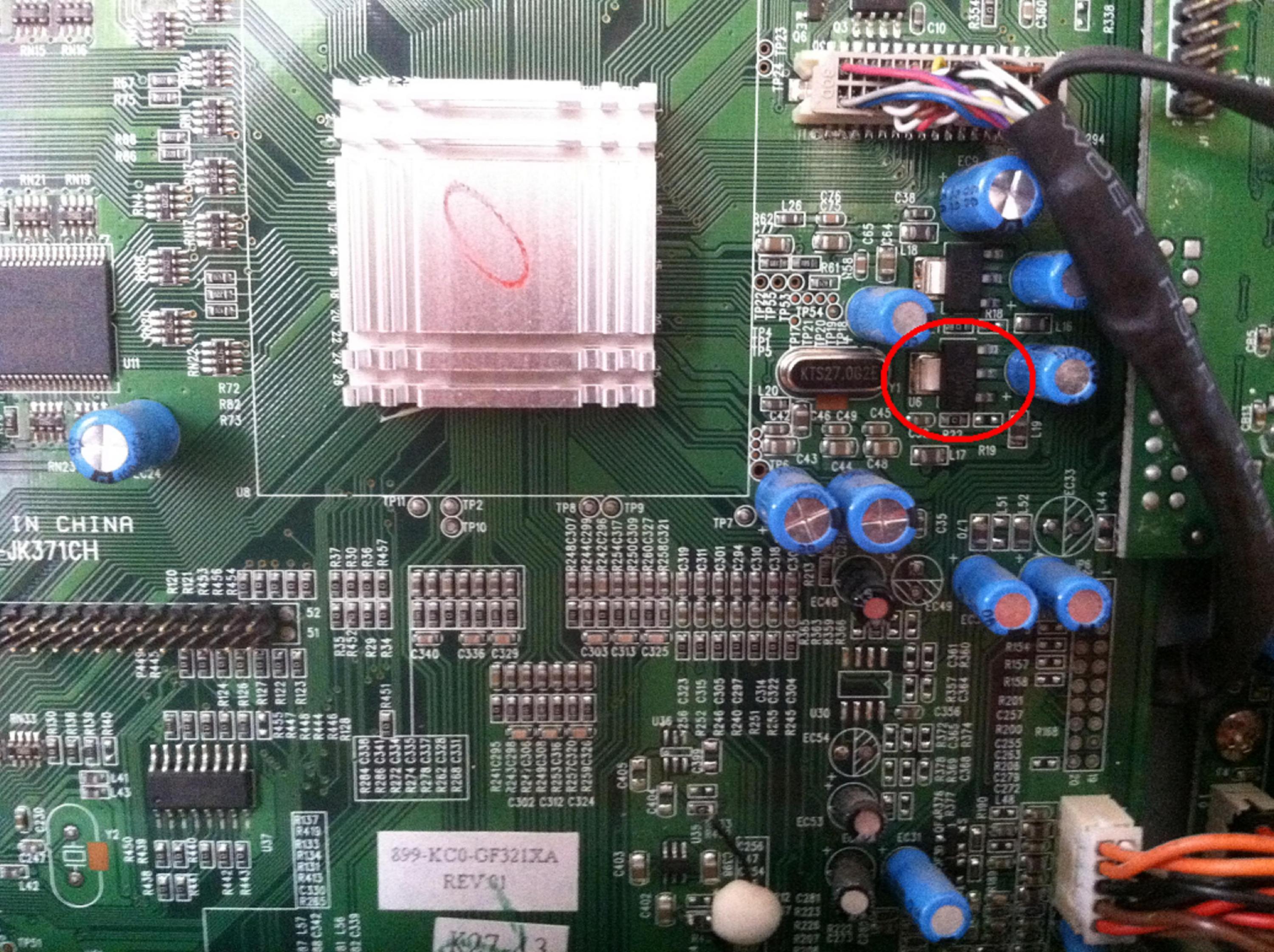

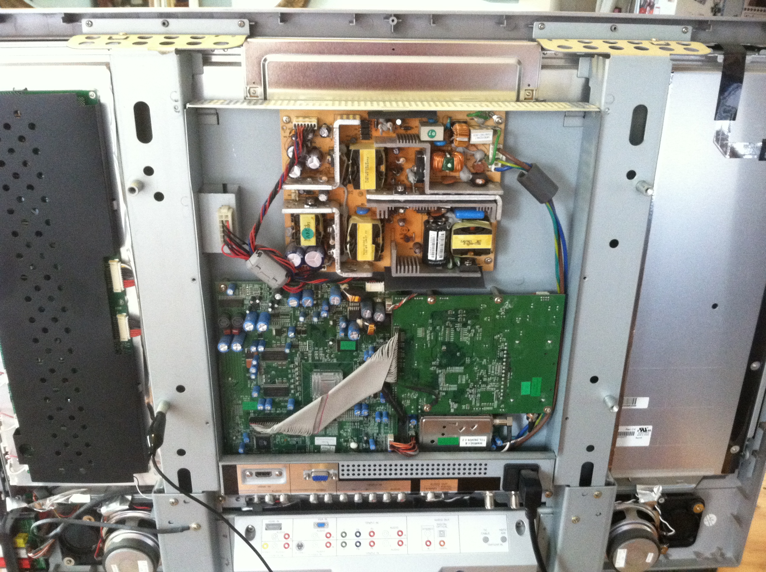

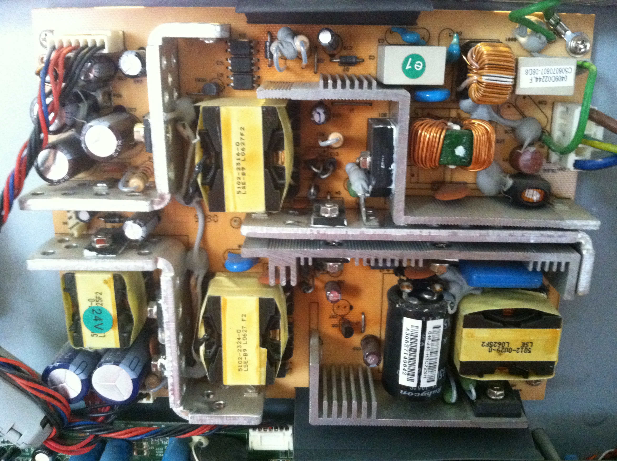

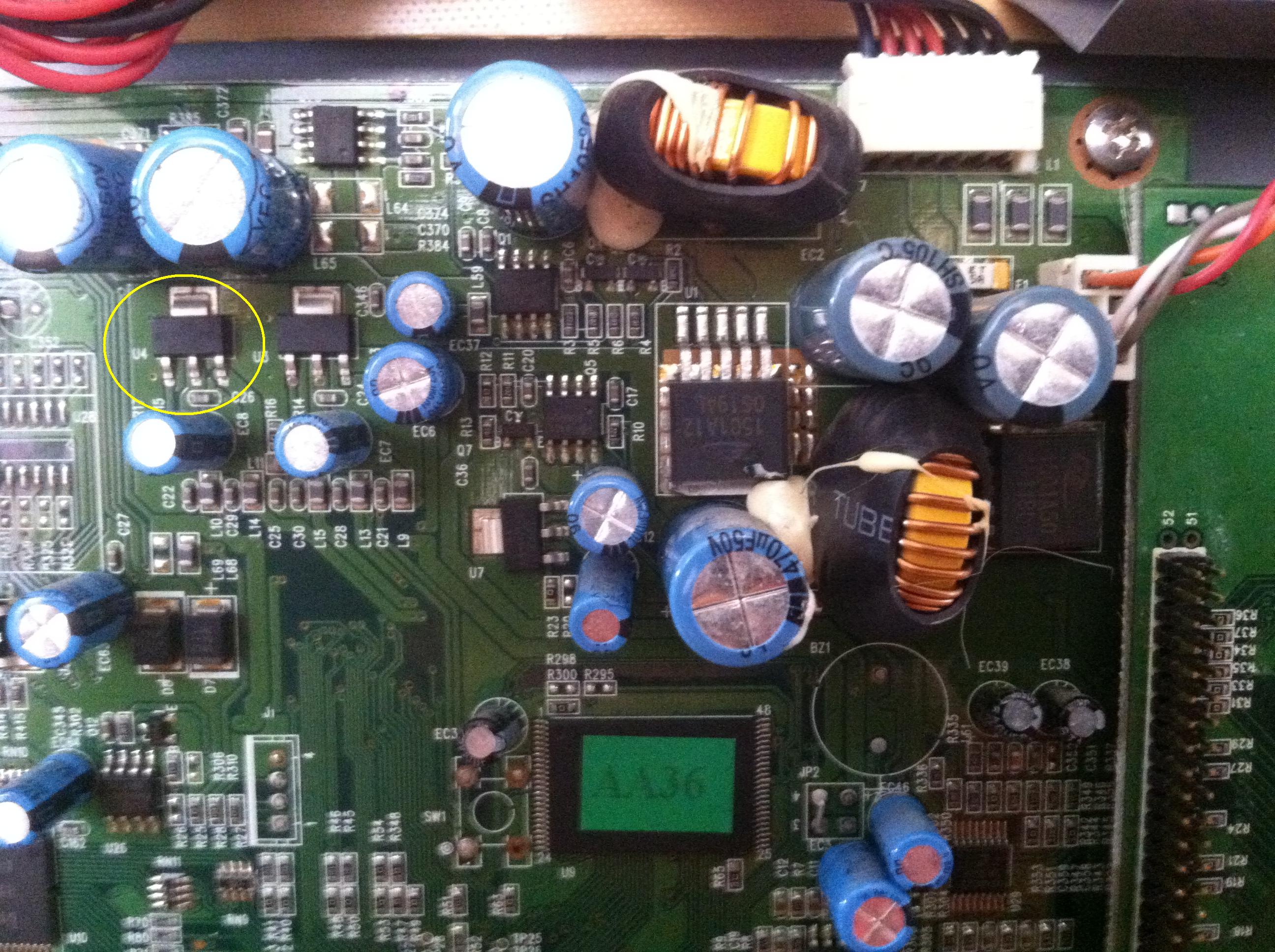

This set just came in this afternoon. I say no sound, no picture but I'm not certain because the backlights don't ever come on. I've tried the flashlight trick to look for a picture with my phone connected for audio but I can't tell if the menu is coming up and I have no idea what input this set was on when it went bad.
I do have 24V in standby (it's odd, but apparently normal for this set) when the power button is hit the red LED turns blue and I have 5.1V from the PSU along with 24V at the inverter. This follows the troubleshooting guide in the service manual and the blog below, so I'm assuming the PSU is working correctly.
http://blog.coppelltvrepair.com/2010...0804-0901.html
It looks like the 5.1V from the PSU travels through the main and is supposed to eventually wind up at the inverter to BL_ON, but I'm not seeing it.
At this point, I'm suspecting a bad main.
