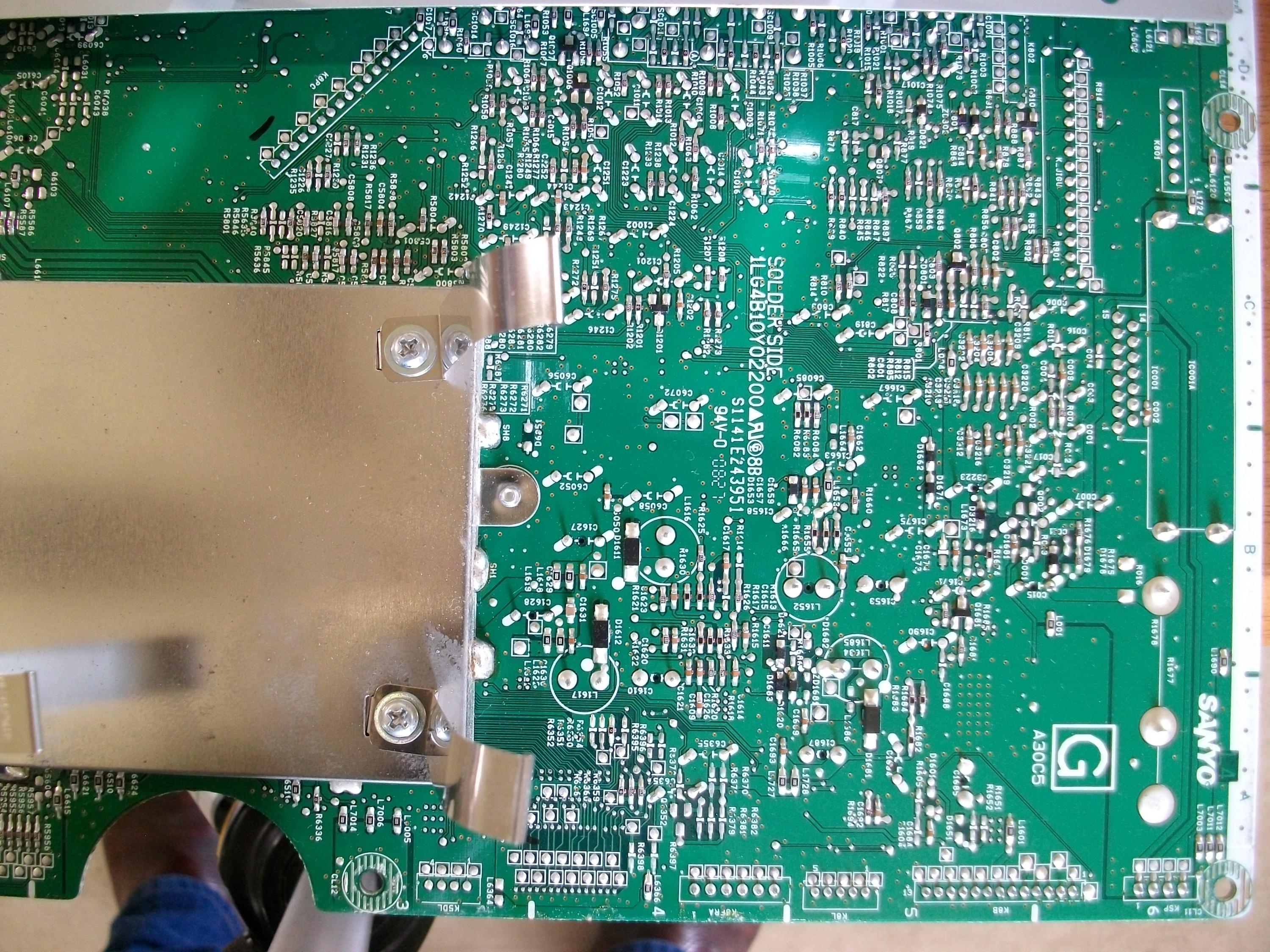

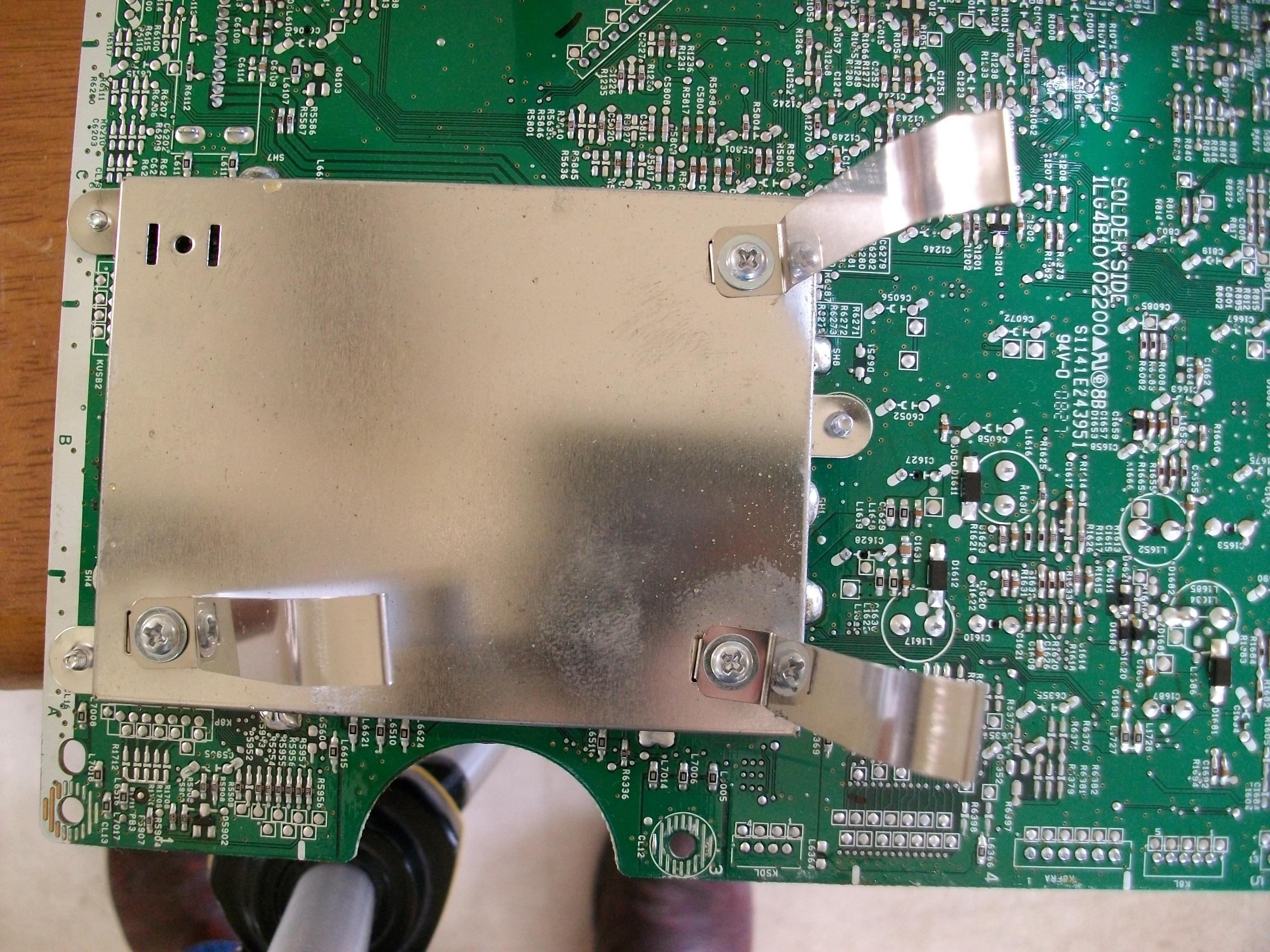

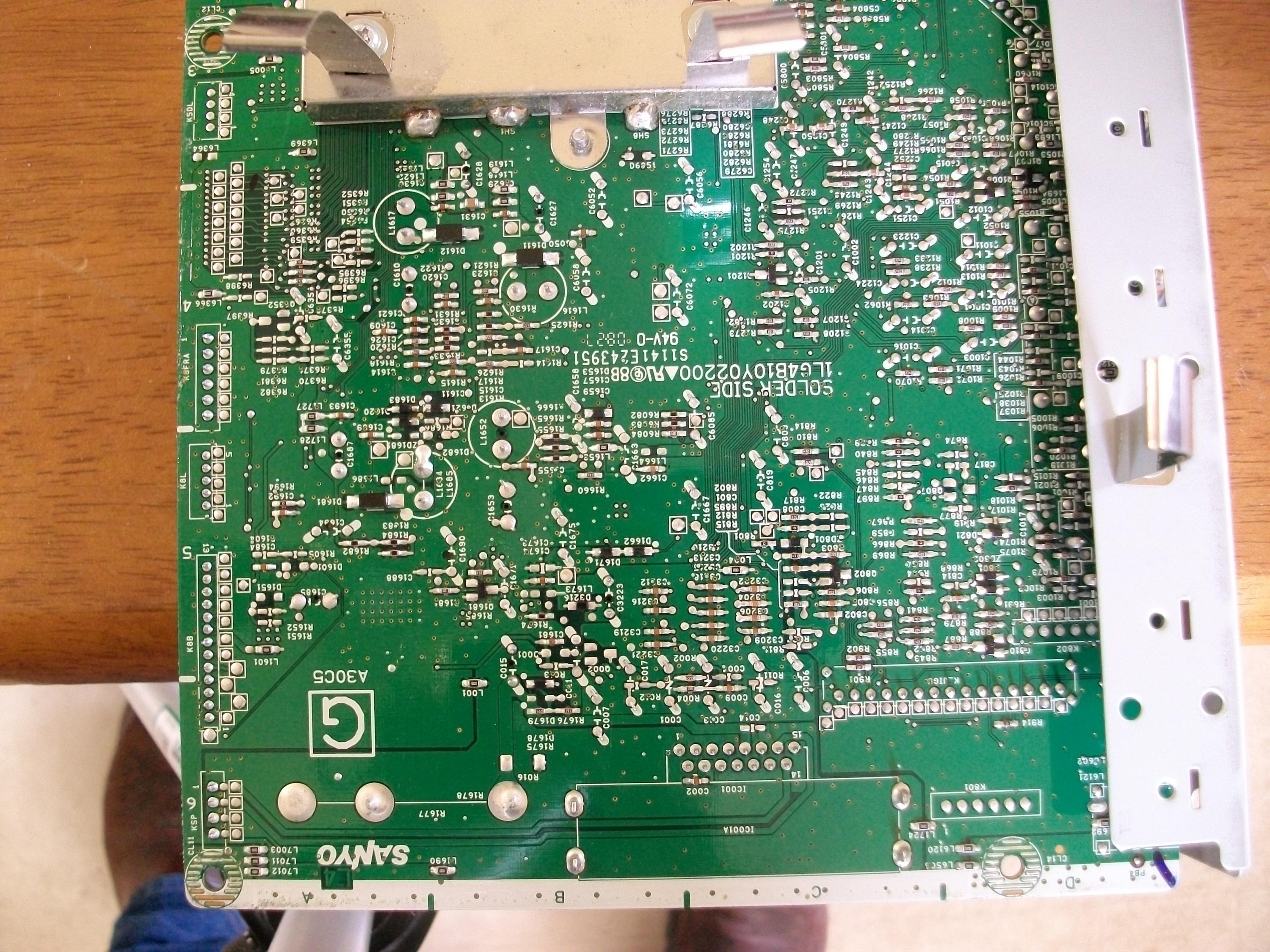

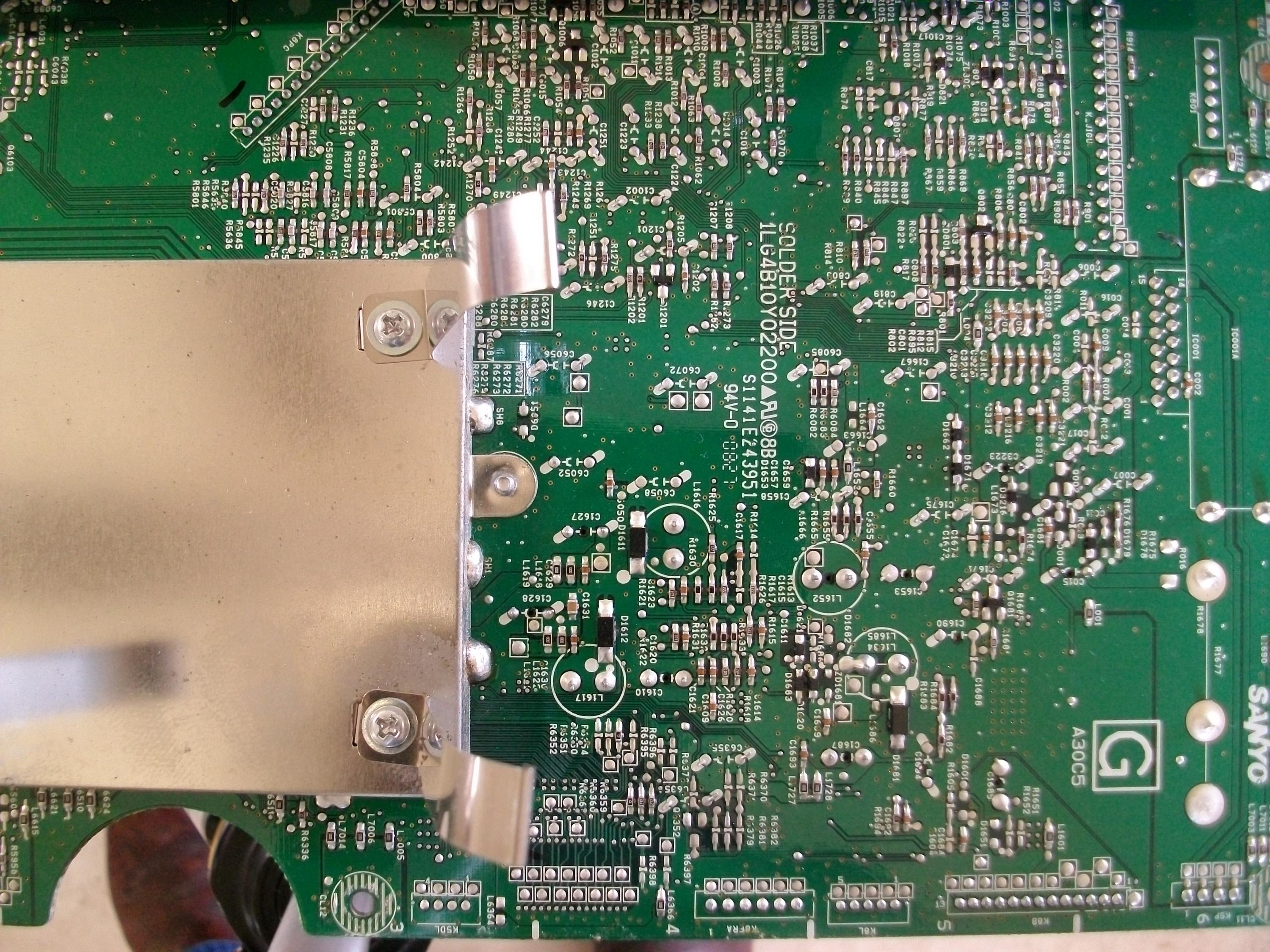

                                        Re: sanyo DP32648 tv will not turn on
                                        Pictures of back of main board
