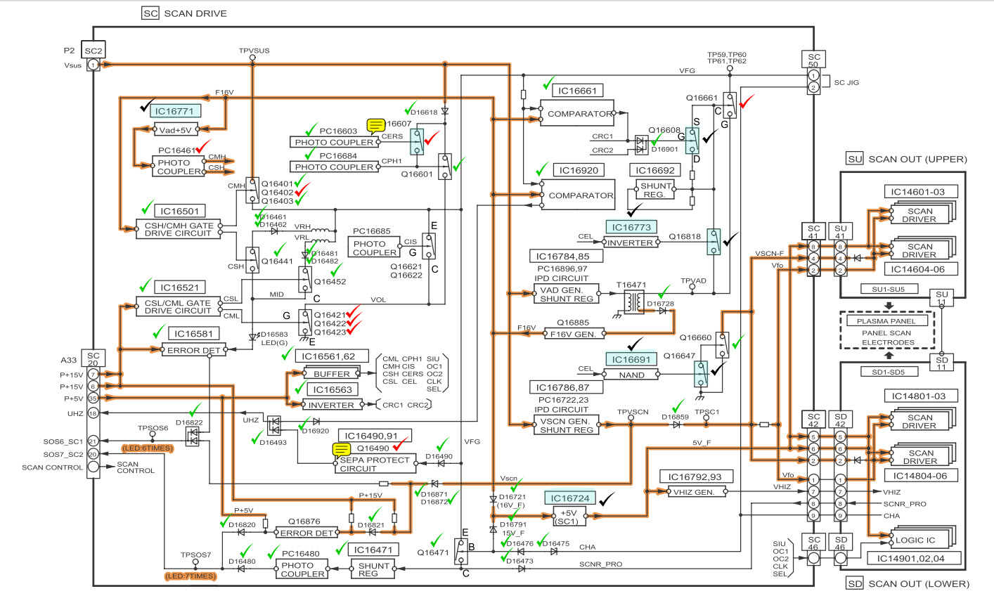

                      If you take a look at this picture you will see what the SC50 bypass is doing it's providing the VFG to CHA
                      I don't know why but I have a strange feeling that the SU11/SD11 ribbon cable was not seated right.
                      If I am right that would mean Q16471 was not turned on and SCNR_PRO would have been shorted to VFG causing it to go BANG. Well that a theory I have probably full of shit but trying to figure it out.

                                  The thing I noticed in the block diagram is when in bypass (SC50 Installed) Q16660, IC16792, IC16793 are not being tested so maybe I have one of these bad?
                                  What really sucks is I don't have a known good set of SU/SD boards so for all I know I am fighting all this just for a bad SU/SD board.
                                  I found this quote in the 2009 handbook so this explains what the SC50 Loop is doing.

                                  the SC board. This floats point “CHA”
                                  triggering the SOS7 detect circuit. This
                                  outputs a high to the A board through
                                  connector SC20 triggering shutdown.
                                  • Alastair E
                                    Chief Womble
                                    • Mar 2013
                                    • 1963
                                    • U.K.
                                    #377
                                    Re: Panasonic sc tnpa5081 rebuild
                                    Q661....
                                    It Always comes back to that one bloody transistor it seems....
                                    Its strung between the -VAD and the VF-Ground (VFG)
                                    -- We know VFG aint really a proper ground--Its pulsing up to VSUS with each sustain cycle, and the Buffer-chips ride on this, so VFG is their Local Ground--sorta.
                                    --Q661 Appears to be the Set/Reset Ramp generator, supplied by the -VAD on the bottom end (E) and VSUS at the top. (C)
                                    VAD isnt a supply that can (I dont think) source Much in the way of high current looking at its transformer, so the current that destroys Q661 in fault-conditions therefore--Must be coming from VSUS, that grounds through the VAD Transformer and the rec diode--as Q661 is on when it shouldn't be..
                                    --The Transistor, RJP63F4A Q661 I know from experience can handle some considerable current, as Ive used one in a supply for a washer motor--Has No trouble doing a full 7Kg load and 1600 spin! Whatever is killing it on TNPA5081 is Pretty High Power stuff...
                                    Ive tried with partial success to prevent major blow-ups using a 150W bulb in the VSUS to the board,--but still Q661 can die, probably due to the charge in the caps on VSUS Supply.
                                    So--Idea, Use a Bulb in series with Q661 Collector...
                                    It would need to be Two 240V lamps--As -VAD is around what?--170V? and VSUS over 200...
                                    On the Next Blow-Up (As thats all I'm doing lately!) I'm gonna rig up two 15W 240V pygmy-bulbs in series with Q661 Collector...
                                    I dunno--Might prevent Huge blow-ups and tell us if the board is still buggered,-- Or maybe I'm just talking bollox....
                                    --It May make things a Whole lot Worse--Who knows--Gotta be tried!
