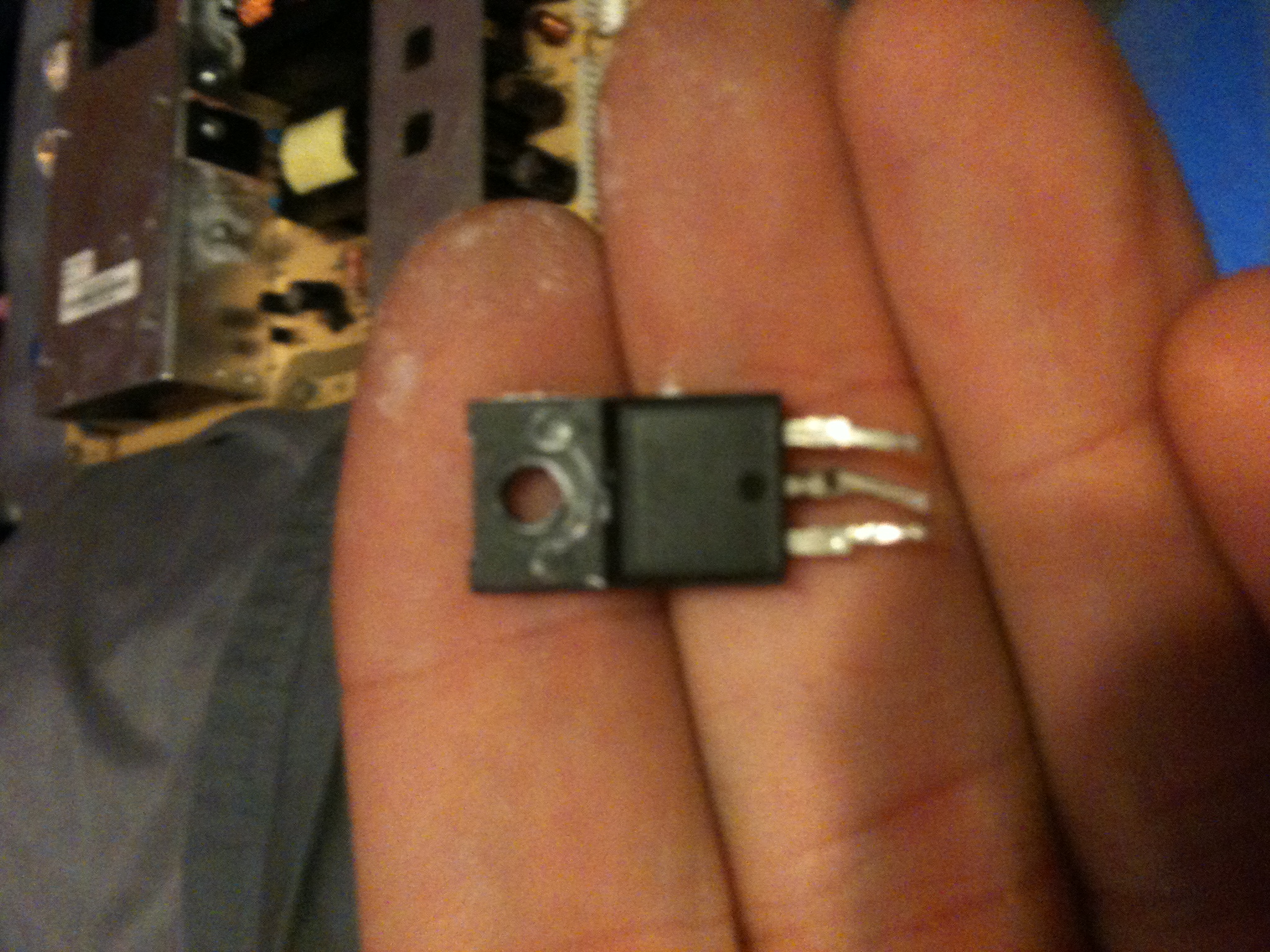

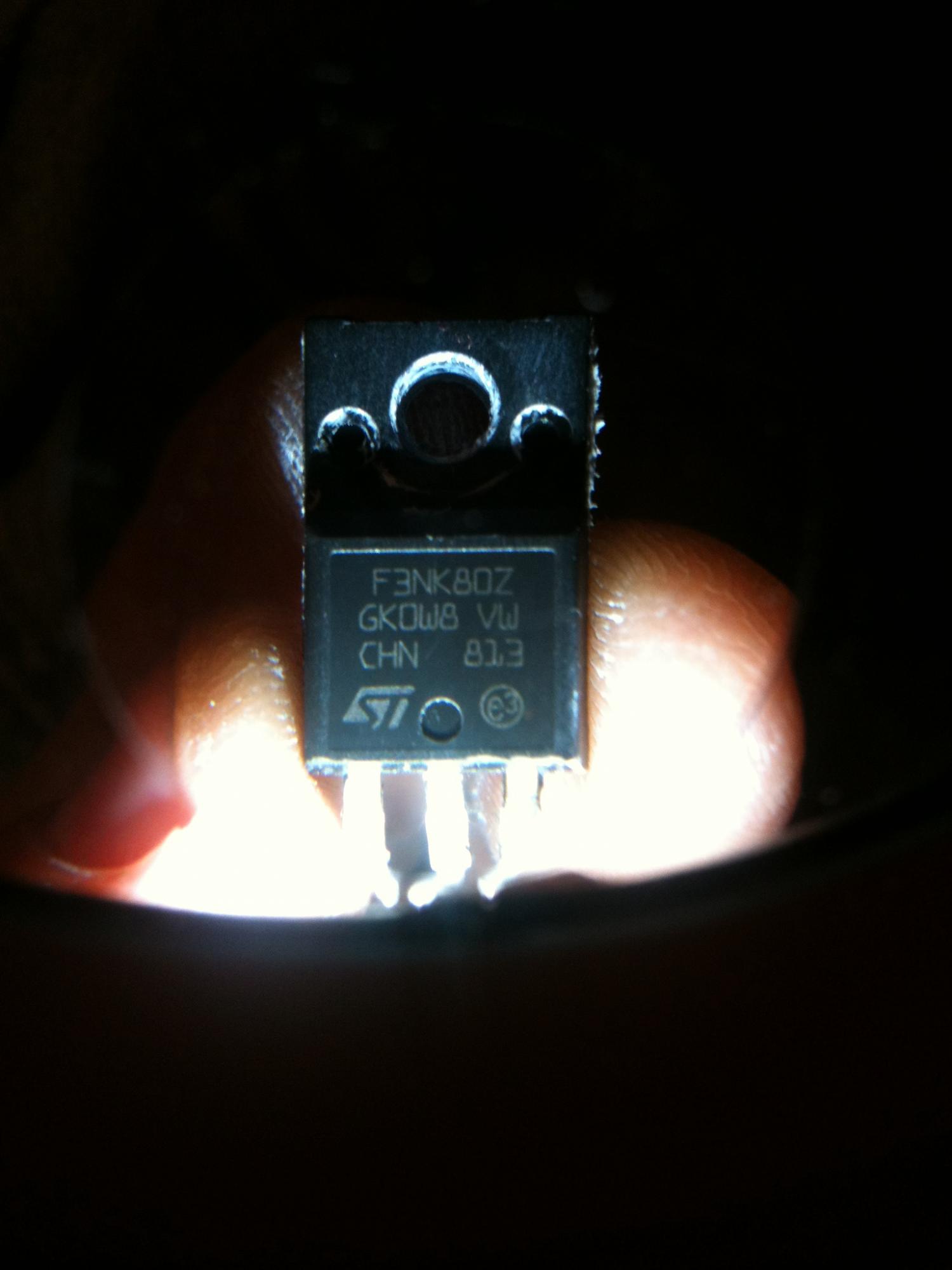

just no clue, have been looking for awile fig i would give a try and see if anyone can help me. Vizio42'' fhdtv10a. part is from power board.
need help finding and identify
Re: need help finding and identify
http://www.digikey.com/scripts/DkSea...=0&y=0&cur=USD

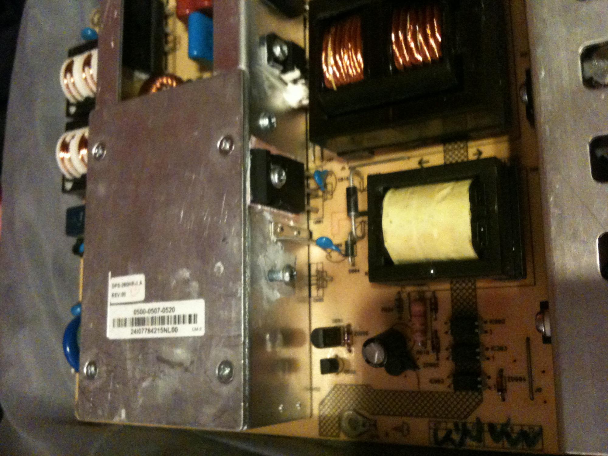

That's for the part number that was on the mosfet in pic #4 -
Be sure to check the Gate drive components and the output pin of the IC that drives this MOSFET, otherwise if the output stuck high instead of switching ON/OFF it will take out your new MOSFET. Also check the Source pin resistor.Never stop learning
