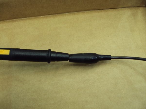

                      Good tip johnboy1313. I like to connect my alligator clip to my test lead like this though. This method gives you insurance that if the hanging end of the probe/alligator clip swings and touches anything, you don't get smoke or sparks. I learned this from personal experience.
