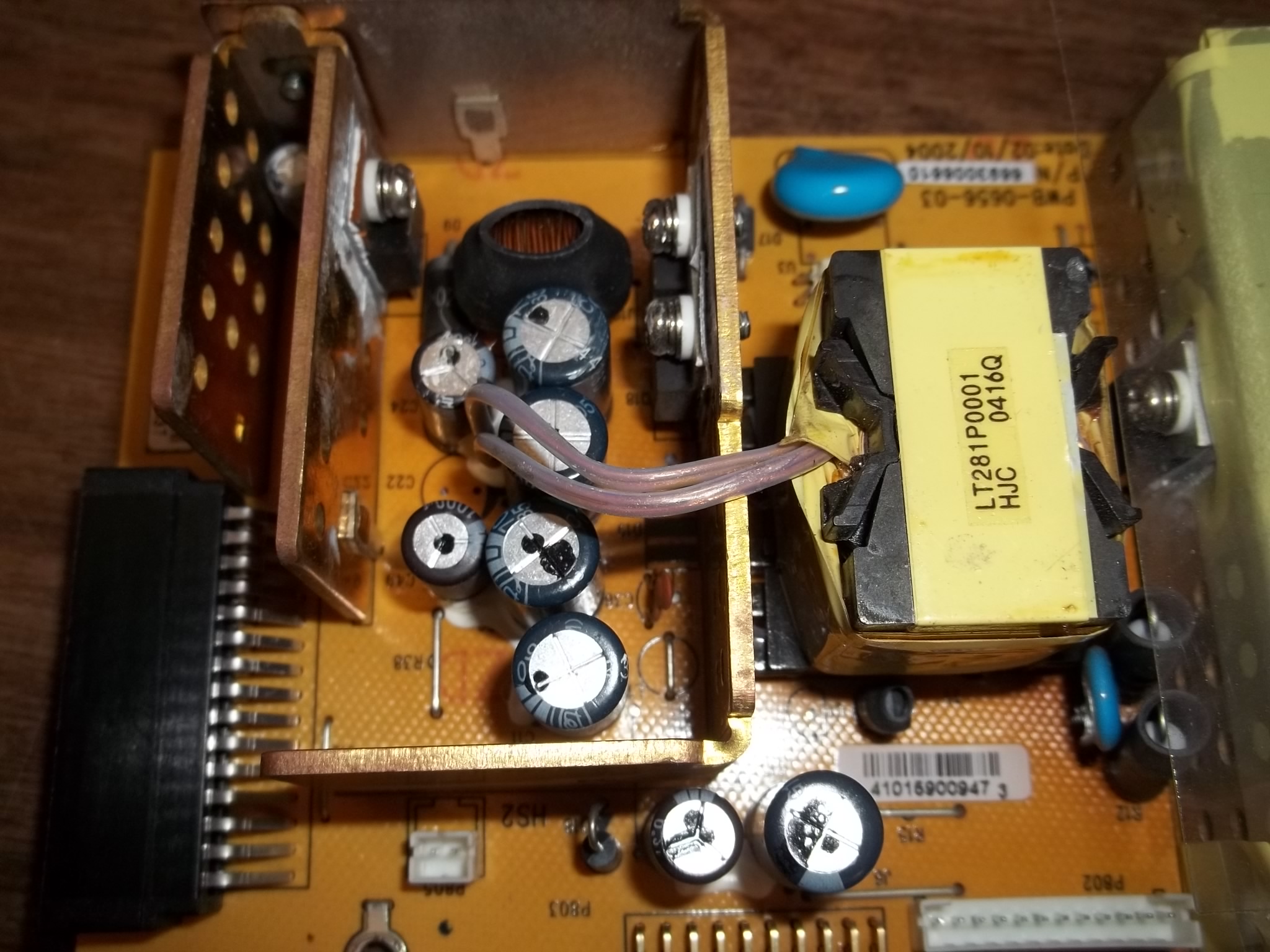

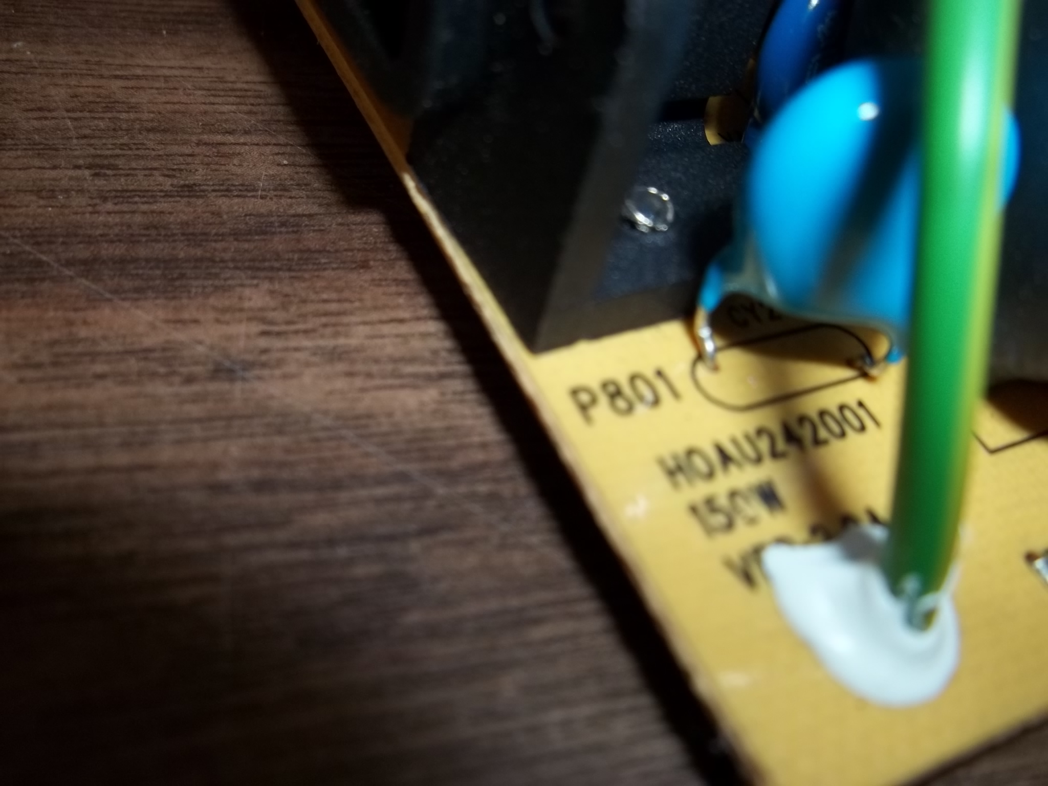

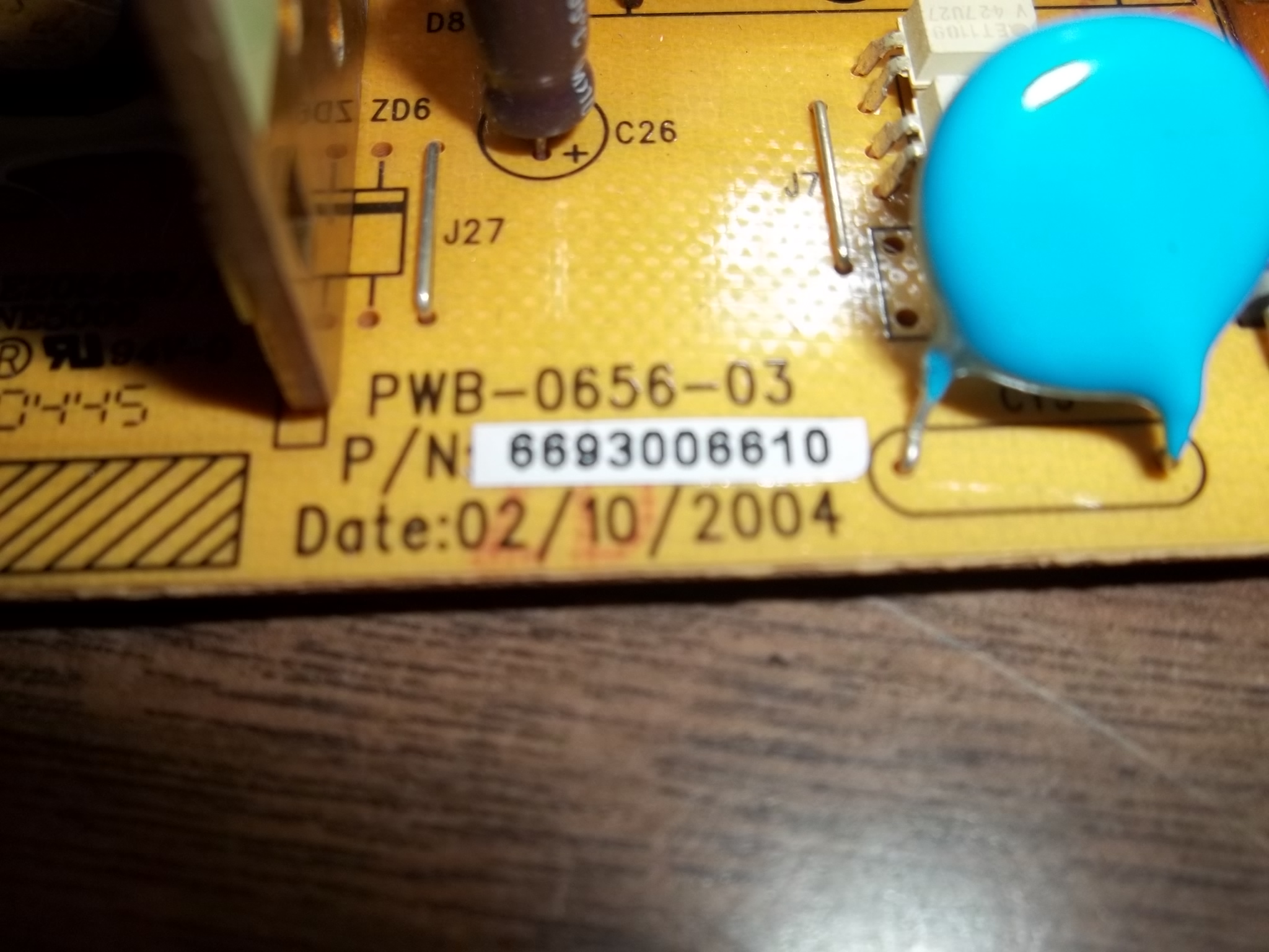

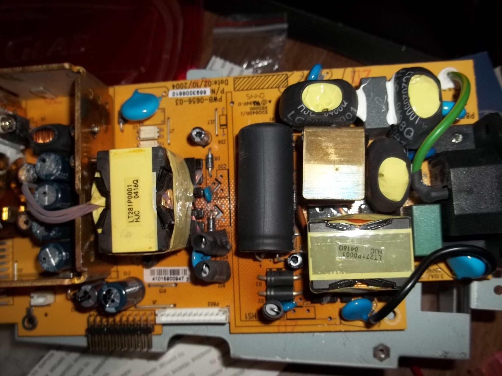

    I am working on a PowerSpec v30dmbt, that has a dead power supply. Googling this model # found some other post that has problems with this unit, but no solutions. Looking at the board Q1 and Q20 have been replaced by previous owner who couldn't get it to work. I checked the fuse right away, and it's open. I need to order some more before I can test further.
    I was wondering if there were common problems with this power supply and anything else I need to check or include in my order.
    The power supply also has a p/n 6693006610 and the schematics were under HOAU242001.

    Remove the FETs that have been replaced and check if they are shorted now.

      I removed the FETs and tested fine, however noticed one didn't have a mica insulator and drain was shorted to ground. Went through all diodes, FETs, and caps, and all appear fine. Going to order the fuse and will report what happens after that.

        A short from the drain to ground would quite easily blow the fuse

          I wonder if the old FET was insulated tab type, so now we may not know what the original MOSFETs were.

            Just wanted to follow up with this now that the fuse came in. I added the mica insulator and fuse, (and re-soldered two bad solder joints) and the power supply is now working again. I plugged it in for about 10 minutes before bed and no problems. Will have to burn it in and see if anything else goes wrong.

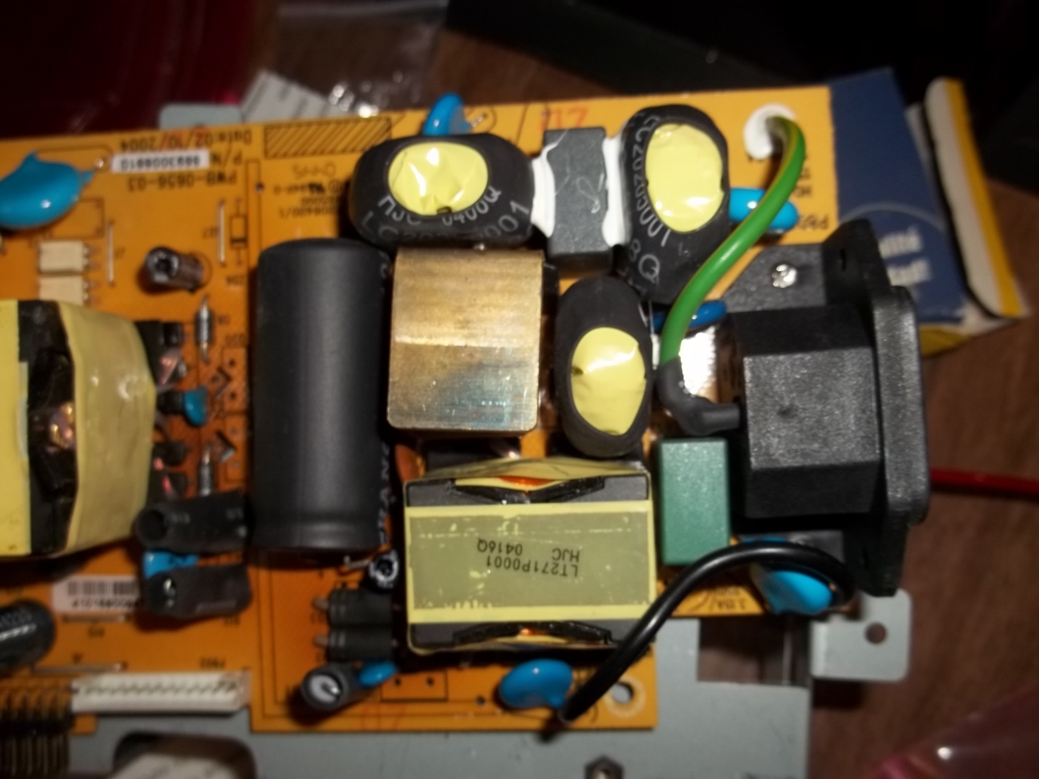

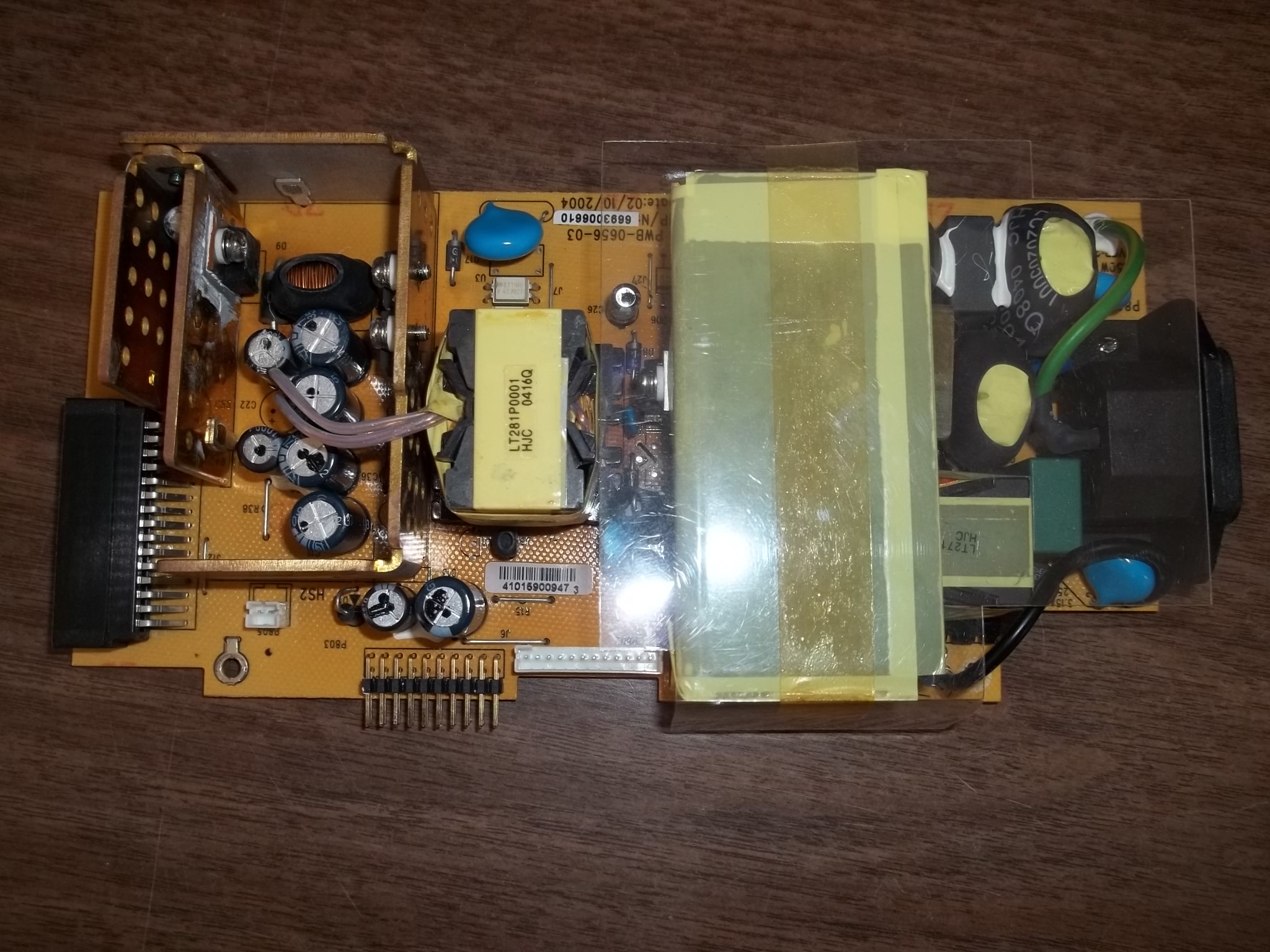

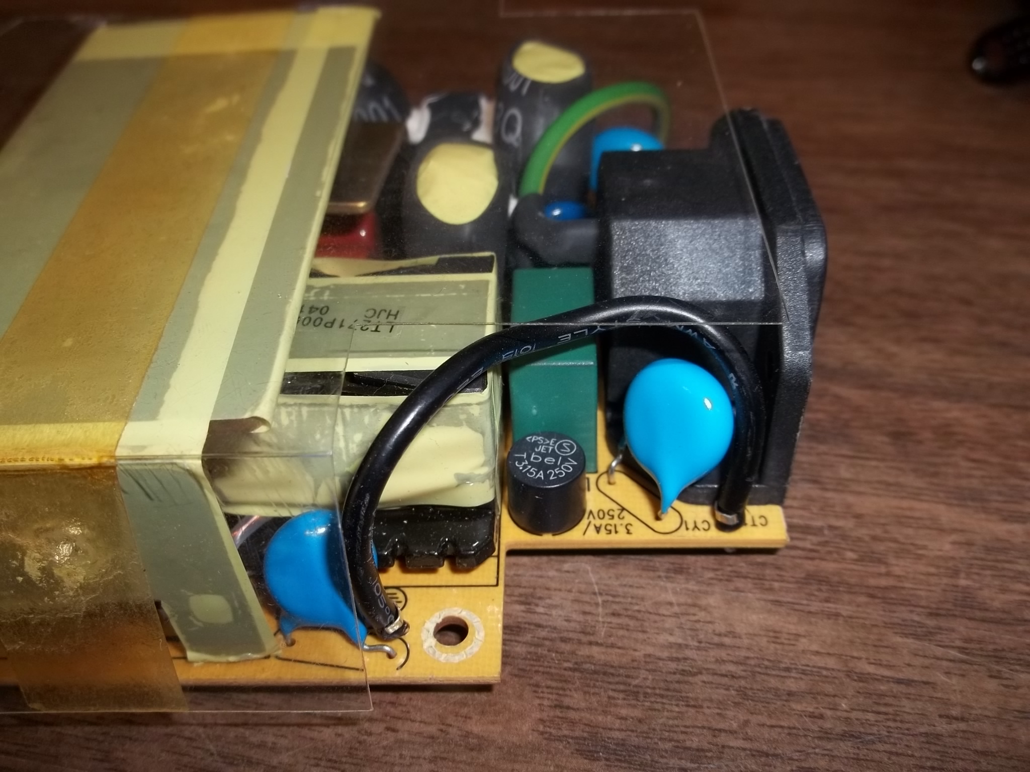

              Re: Dead PWB-0656-03 Power Supply
              Here are a couple more photos of the power supply without the shield.
