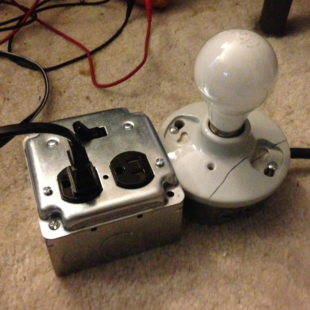

          If you have a 25W or 40W (120V) lightbulb available, remove the fuse and touch it across it, or clip it to the terminals on the bulb. If there's a fault in the standby circuit, the bulb will stay lit, but if everything's fine, the bulb will flash then go out, and you should see a standby LED. When that is successful remove the bulb and attempt to power on TV normally (the TV will not start with a bulb in series but it will usually run in standby mode.)

                      Re: Sanyo DP46849 46" LCD - Does not power up.
                      Alright, built the rig, tested with a 40W bulb (that's what I had around the house) ... I was also able to get my hands on a 100W bulb for future needs. Enclosed picture of load-rig just for fun. Never mind the cracked bulb base, came that way out of the box, planning on exchanging next time I venture out of the house. Will open package and check this time. Argh.
                      The bulb flashed quickly and went out (40W) but no standby/pilot light. I did check for power between the 5VSTB and GND pin on the power board and I do get 5V now, just not sure where to go from here. I guess it's possible we've got a problem on the main board. This also came out of a near lightning strike house. Oh, and if it matters, I tried the procedure with everything plugged in to the power board and with nothing plugged in. May not have been the best method but I plugged everything in after reinstalling the board and transporting the TV to my home workshop.
                      I didn't want to just hit power without a pilot light because I've done that in the past on electronics before and let out the magic smoke in doing so.
                      Any advice is, as always, much appreciated.

                        Neat!
                        What I would do is power up the TV without the bulb. Some TVs do a self-test of the power supply when powering up, if that fails then the standby light won't light or will blink an error code.
