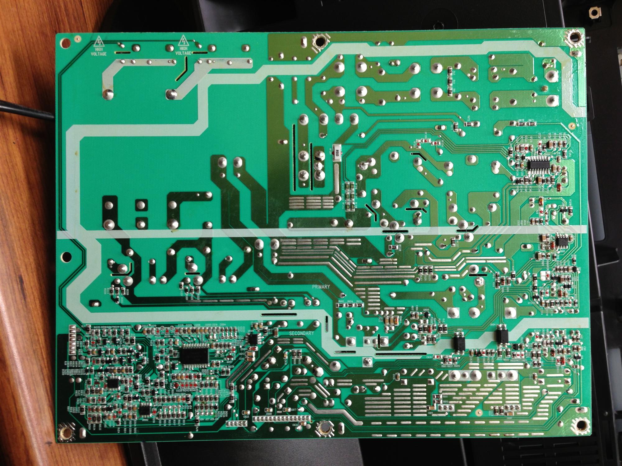

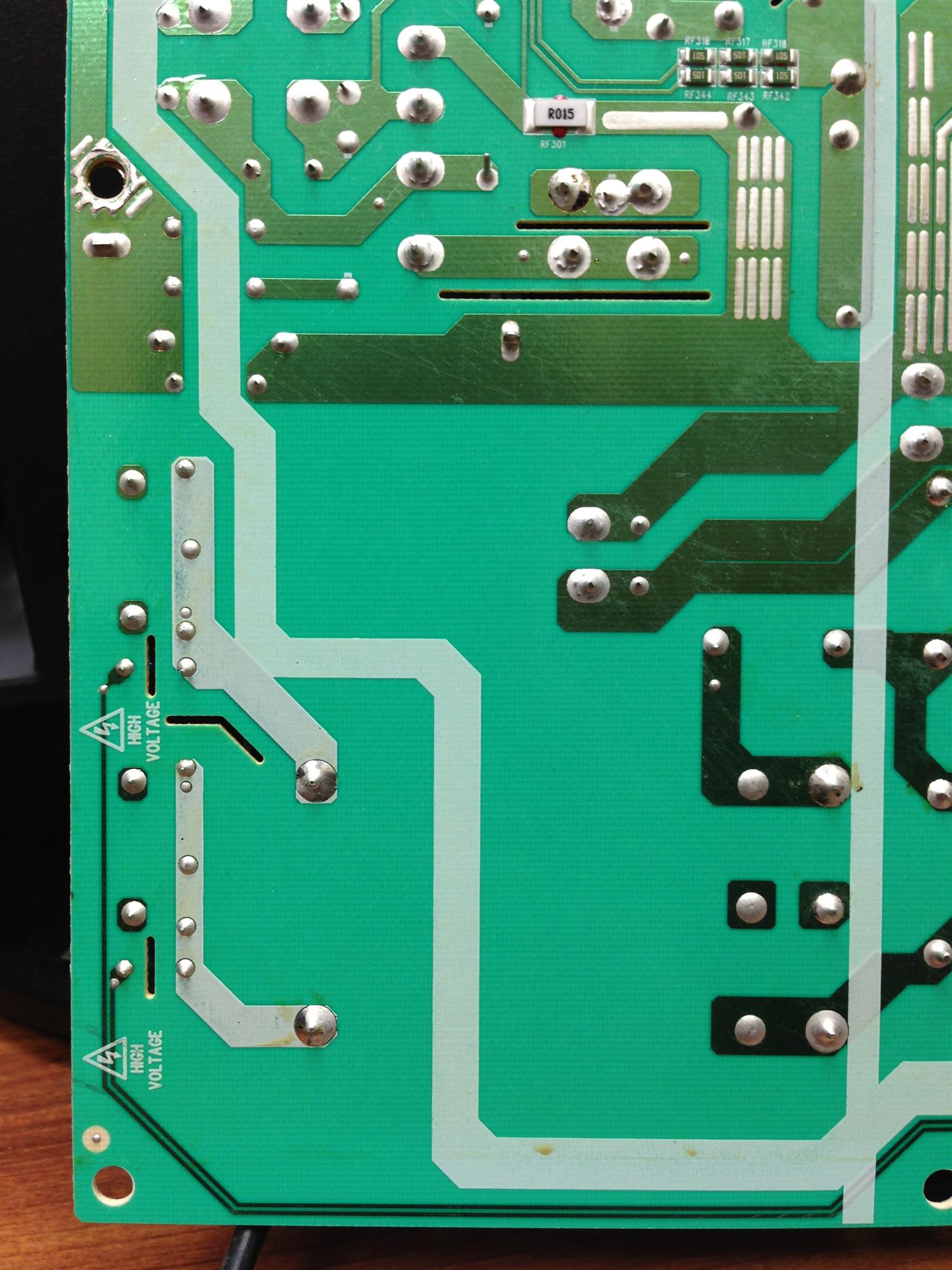

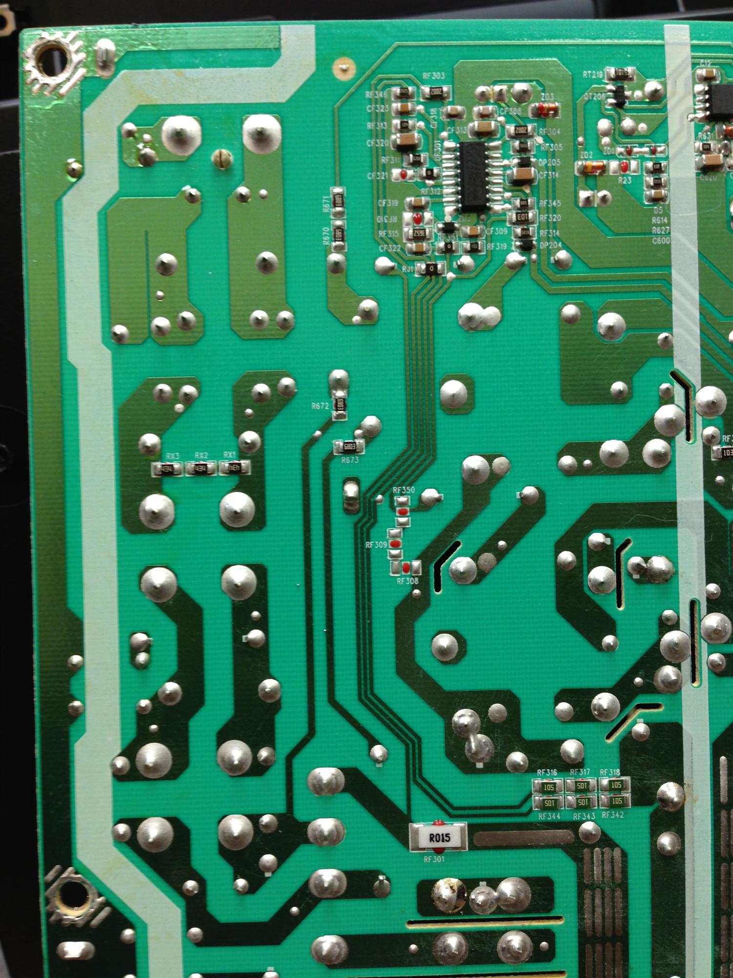

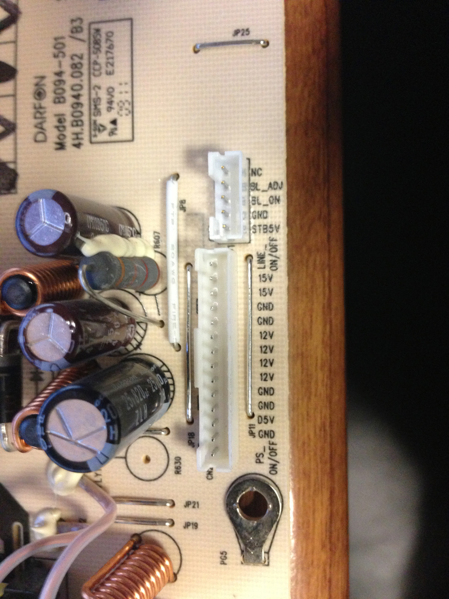

    I feel that I'm pretty handy at fixing electronics, but I haven't really worked on a TV in quite some time. Boss brought three TVs from his house that quit working at one time or another. One was a blown fuse, I'm on the second one and am experience these issues.
    It's a Sanyo DP46849 and it does not power up at all. There's no pilot light lit on the front (I'm assuming there's supposed to be) and I am fairly certain I do not have the 5V Standby that I've read about here (thanks to Bud Martin for his guide). Looking for some advice as to where to look.
    Attached are the best photos I can come up with here at the office (iPhone 5) so I took one top-down of the power supply board and two of the connector areas so the labeling can be clearly read.
    I was at a slightly angle when I took the picture, so the main AC fuse is obscured in the photo, but I checked it for continuity and got tone, as well as confirmed 120VAC on both sides of it. I checked for DCV between the GND and STB5V pins on the connector and got nothing. Short of "shot-gunning" it and checking every diode/etc... looking for advice as to where to look first. None of the capacitors have obvious damage (to me at least) and there's no obvious burns or discolorations on the board that I can tell.
    Thanks for any advice offered. If the pictures aren't of suitable quality I'm happy to take them with my DSLR and post them.
    They are excellent for our purposes.
    On your board are two large filter capacitors (KMG 400V 150uF).
    What is the DC voltage across the legs of each one? WARNING. It could be as high as 400V DC so be careful. If you have aligator clips on your multimeter probes, I suggest using them (like I do).

      Thanks for your quick response! Thanks for the warning...I love my trusty alligator clips for my probes. Keeps me that much further away from my healthy respect for electricity.
      Both of the KMG 400V/150uF filter capacitors show 163.7-ish VDC.
      All readings taken with a Fluke 189 (just for reference).

        Good voltage. 163V is fine for standby. So, to check. On STB5V, you measure <0.005V, or just a few volts?
            0.3955V tested for the STB5V using a chassis ground AND the pin in the same connector as the STB5V.

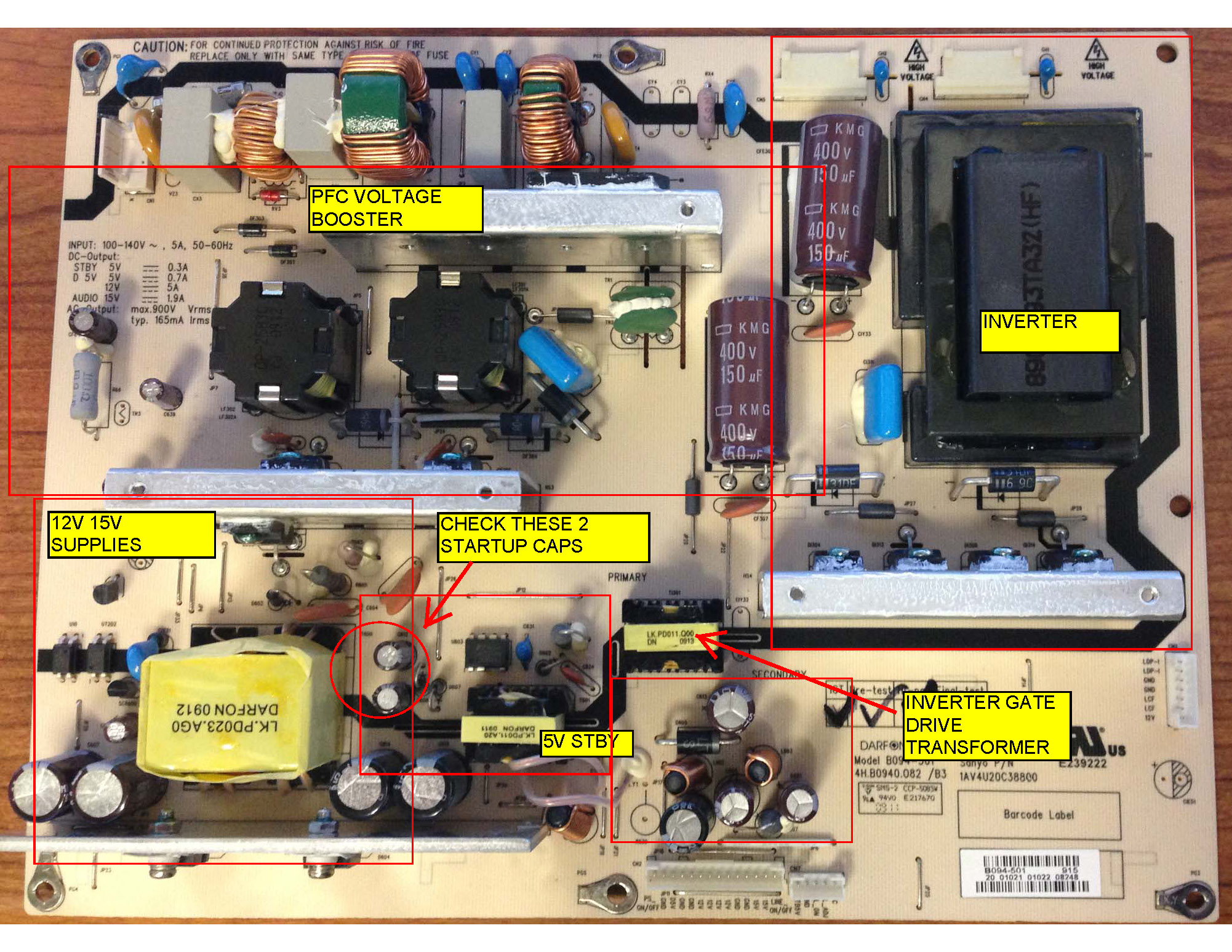

              Re: Sanyo DP46849 46" LCD - Does not power up.
              This may help. Try heating up those two startup caps with hair dryer to see if the 5vstby will start running, it is an always on power supply.
                Oh, wow, thanks for that handy diagram!
                I did the hair dryer bit, but it doesn't seem to bring the STB5V back to life. Not exactly sure on how much to heat them up. The hotter I got them the lower the STB5V reading became (Was 0.3995 down to 0.2xxx-ish VDC). Not sure if that tells any stories.

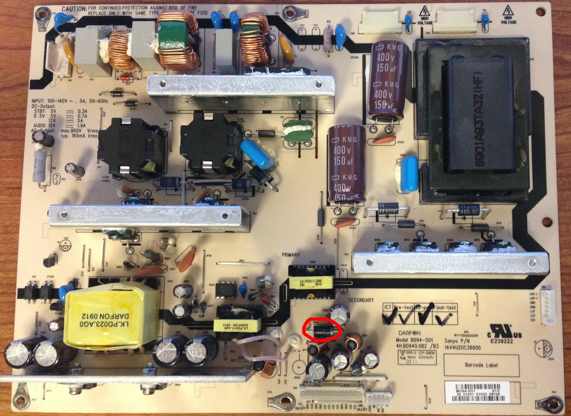

                  OK, check this diode.
                  1. TV off & unplugged.
                  2. Meter on diode test.
                  3. Red probe on one end, black on other - record reading.
                  4. Reverse probes - record reading.
                  5. If possible note down part number.

                    Results:
                    Red on Cathode, Black on Anode = .9305VDC
                    Black on Cathode, Red on Anode = .2205VDC
                    Part number is a little more difficult to read. Definitely starts with LT7, might be LT77. Under the LT7 it reads SB. If anyone has a schematic it's labeled as D605 on the board.
                    If it's imperative we get the full part number I can remove it from the board tomorrow.
                    Thanks!
                      We don't need part # for now it looks OK but just to be sure can you lift one leg of the diode and test it & see if you get a different result.
                      Then, carefully, on the caps budm highlighted before for heating, please check the voltage across them (positive probe on positive, negative probe on negative.) One will likely be for standby controller.

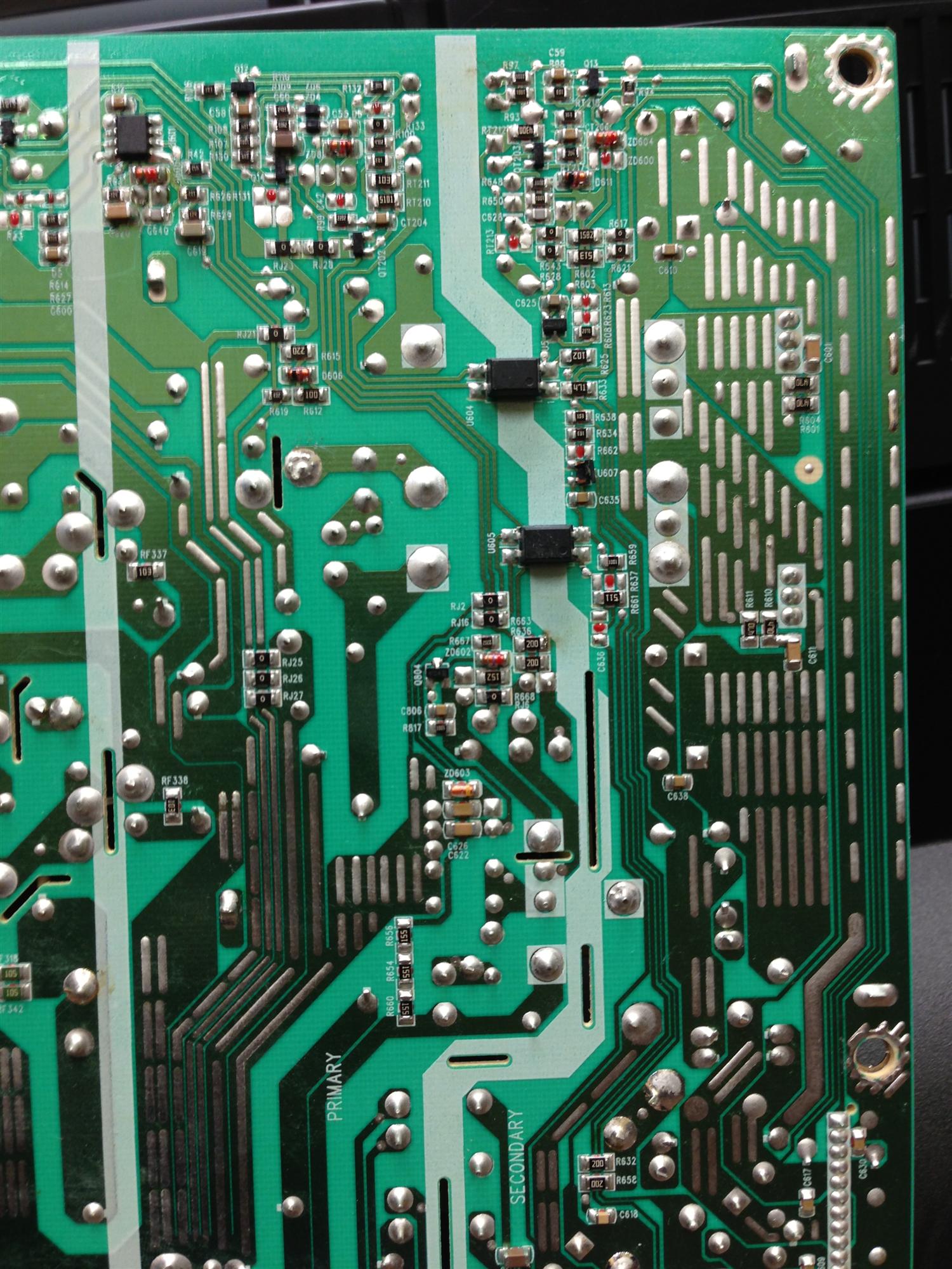

                        What is the little 8-pin IC in the 5STBY section.
                        Also post good clear pictures of the bottom side as a whole, and also four 1/4 section that are really clear and focused so I can trace the connections.

                              Referencing the picture budm highlighted for me, the top one is designated as C612 and shows 5.808V, the one below it is designated C634 and is showing 1.28XV. C634 seems to fluctuate a lot and never really hold a reading, seems to be 1.27X-1.29X.
                              THe 8pin IC is labeled with three lines of text as follows:
                              M846
                              TNY274PN
                              58514J (the 1 (one) could be a capital I)
                              Attached you will find the requested photos.
                                OK, that TNY274PN IC is for the standby 5v power supply. Take the resistance reading between the ground pin and the other 7 pins, report the readings.
                                Next, you will use the Negative leg of the large 400V cap for the ground ref point (It is the ground ref point for the Primary-HOT side) and the use the red probe to check the voltage reading on all 8 pins, the example circuit in the data sheet should be real close to what you have on the board. Since the voltage is fluctuating, it can mean that the start up caps are bad or it is sensing shorted circuits some where. You can test this board by itself without other board hook up to it. You can solder in 47 Ohms 1W resistor to 5vstby pin and ground to give about 100mA load for it.
                                Report the voltage reading on the IC.

                                  Hrm, okay. We're venturing into territory where my electronics becomes a little fuzzy.
                                  Does it matter which 400V capacity I use the negative leg on?
                                  Which pin is the ground pin? There's 1 drain pin and 4 source pins that appear to be connected to the same thing. Would the drain pin be the ground pin?
                                  edit: scratch this below, I didn't even see the sheet you attached! Sorry!
                                  --- I'm comparing it to the attached data sheet from Mouser. (Assuming it's the right sheet.) ---
                                  I'll have to dig through the box or get a hold of an appropriate resistor for load. Do I need to have that soldered on before doing any/all of the above tests, or would performing them with the other board attached provide load?
                                    You solder the resistor in after you check the resistance reading of the IC, then solder in the resistor, and then take the voltage reading, the neagtive leg (the one with white bar is negative) of either caps will be fine, the two caps are connected in parallel.

                                      Resistance readings are as follows. As I'm not 100% sure which one is the "ground pin" I took some various readings.
                                      • All source pins (5-8) between other source pins are 0.12 Ohm.
                                      • Drain (pin 4) to every other pin starts out at about 2.5XX MOhm and trickles down, it hit 2.0XX MOhm and kept going. The value seems to pick up where it left off when I switch from pin to pin when testing drain to anything else.
                                      • EN/UV (pin 1) to any source (5-8) is 329.87 (330?) Ohm.
                                      • EN/UV to BP/M (pin 2) starts at 21 kOhm and climbs
                                      • BP/M to any source provides varying readings based which I assume are part of the logic working when jumping from pin to pin with the multimeter.
                                      I ordered some 47 Ohm 1W resistors since I couldn't find any in my stash, so that'll have to wait a couple days. I live out in the forest and there's not really anywhere to pickup such a thing locally. Voltage readings will have to wait until then. I'll post up when I get them!
                                        Nothing looks obviously shorted with the IC.
