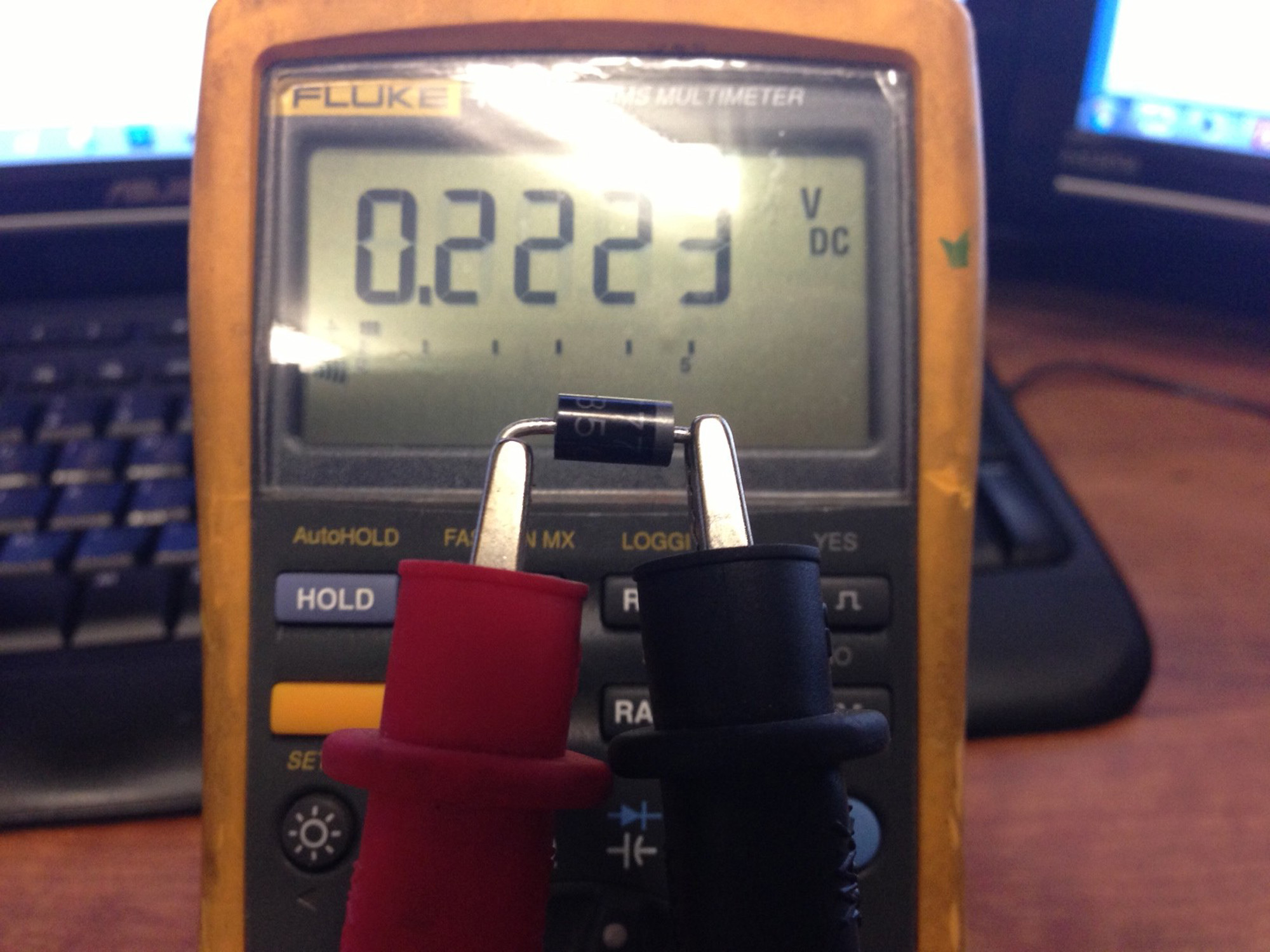

                Just got the IC off the board, despite my desoldering pump committing suicide midway through the procedure (The plunger flew out of the end and landed somewhere in the shop. I didn't even look for it, I ordered a new one.), and pin 1 EN/UV to any of the four S (Source) pins (5,6,7,8) still read ~330 Ohm. (329.95-300.01). I doubled checked to make sure I'm getting Pin 1 right, and confirmed it as it has the tell-tale dot on the IC itself, as well as the pin configuration (3 on one side, 4 on the other).
                Does this lean toward a bad IC? I wouldn't be surprised if it's not the only bad part in this unit, but progress could be fun.
                OK, check this diode..
                I had the iron out so I lifted one leg and checked that diode from earlier. Here are the results:
                Black on Anode, Red on Cathode = 0 VDC
                Red on Anode, Black on Cathode = 0.2215 VDC
                I also got the full part number, it's in 2 lines:
                LT746
                SB560

                  So you you are still readin 300 Ohms on the IC pin?f that is the case, more likely that IC is bad. I would get another one.

                    0VDC, or "OL"?
                    The TNY IC is failed. Perhaps a power surge killed it. It is strange that power surges seem to happen a lot in US, but I've never seen a single device in the UK damaged by such!

                      Yes, still 300 Ohm between Pin 1 and any of the source pins (5, 6, 7, 8). I'll order another one for starters.
                      0VDC, or "OL"?
                      Definitely 0 VDC and not OL. With you being the 2nd recommendation of replacing that IC I'll try to locate and order one tomorrow. I'm guessing this was the result of a power surge. There are 3 TVs that I'm working on from the same location as a result of a surge. One was simply a blown fuse and is back in service, the second needed 2 capacitors replaced to bring it back to life but I've also discovered that all the HDMI ports have failed while other ports work (I'm thinking main board at this point), and the third is this TV you've all been helping me with that appears to have a sick power supply.

                        I have never seen a diode fail with a 0V and 0.22V measurement. You have discovered a new form of zero-drop semiconductor that engineers have been trying to make for years... shame it has only a 0.22V reverse rating . Please test it again for my personal sanity. Consider ordering a replacement for your personal assurance... and mine.
                          #32
                          Re: Sanyo DP46849 46" LCD - Does not power up.
                          If it is that shorted, you should be able to see O ohm on the Ohm meter.
                            #33
                            Oh, wow, I didn't even catch that. My personal sanity is now in question and I can hear my high school electronics teacher scolding at me for not paying attention. I was rushing to get out of the office, at the time I was sure it didn't read OL, but now I'm questioning it. When in diode test on the Fluke 189 I know it'll show OL, but I tried it twice and it just read 0 VDC? (I think.) I'll check it again using diode check and resistance when I get to the office tomorrow. Would make sense to order another since it'll likely be inexpensive and I'm going to get taken to the cleaners on shipping anyway with only shipping one IC anyway.

                              If you do find this device has a zero-volt drop, send it to the semiconductor lab at my university as they'd probably be interested:

                                          Bad news guys, I haven't made any sort of revolutionary discovery. Definitely 0.22V and OL. I saw a O and the VDC in the corner lit, so I went with it. Was trying to get out of the office at the end of the day, seems to effect accuracy around here. I'll just change my nickname to "zero-volt drop" since I doubt I'll ever live that down.
                                          Will order the IC today and replace and then go from there.
