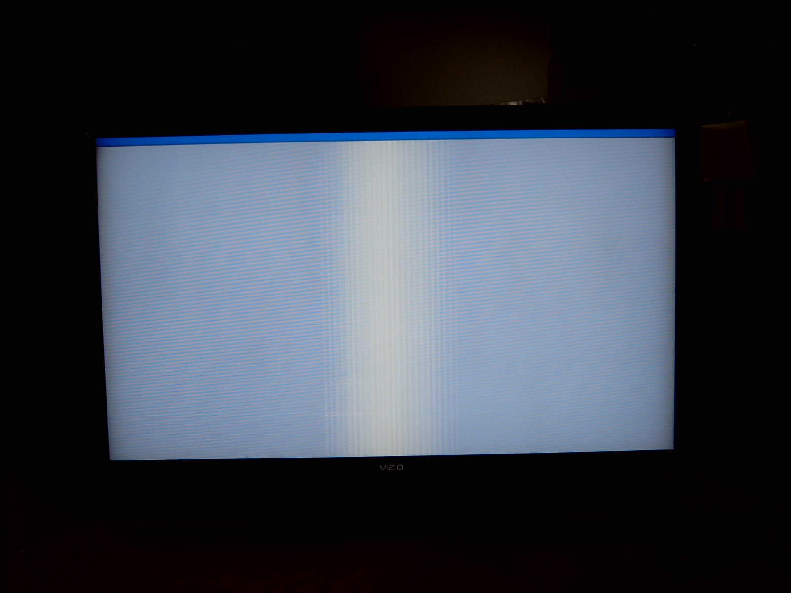

                              Re: Vizio VL470M main board or panel problem?
                              Does this match the problem you guys were seeing here?
                              This is how it looks when I turn the tv on.
                              When I reseat the ribbon cables I get half a screen.
                              Does that sync with it being a posible bonding issue?
                                I've got the same TV same problem, i was about to try using my heatguin on low and apply pressue to the tabs. anyone else find anything else ?
                                  The right side of the panel has problem with the driver ICs on the flexible PCB, not tab bonding problem.
