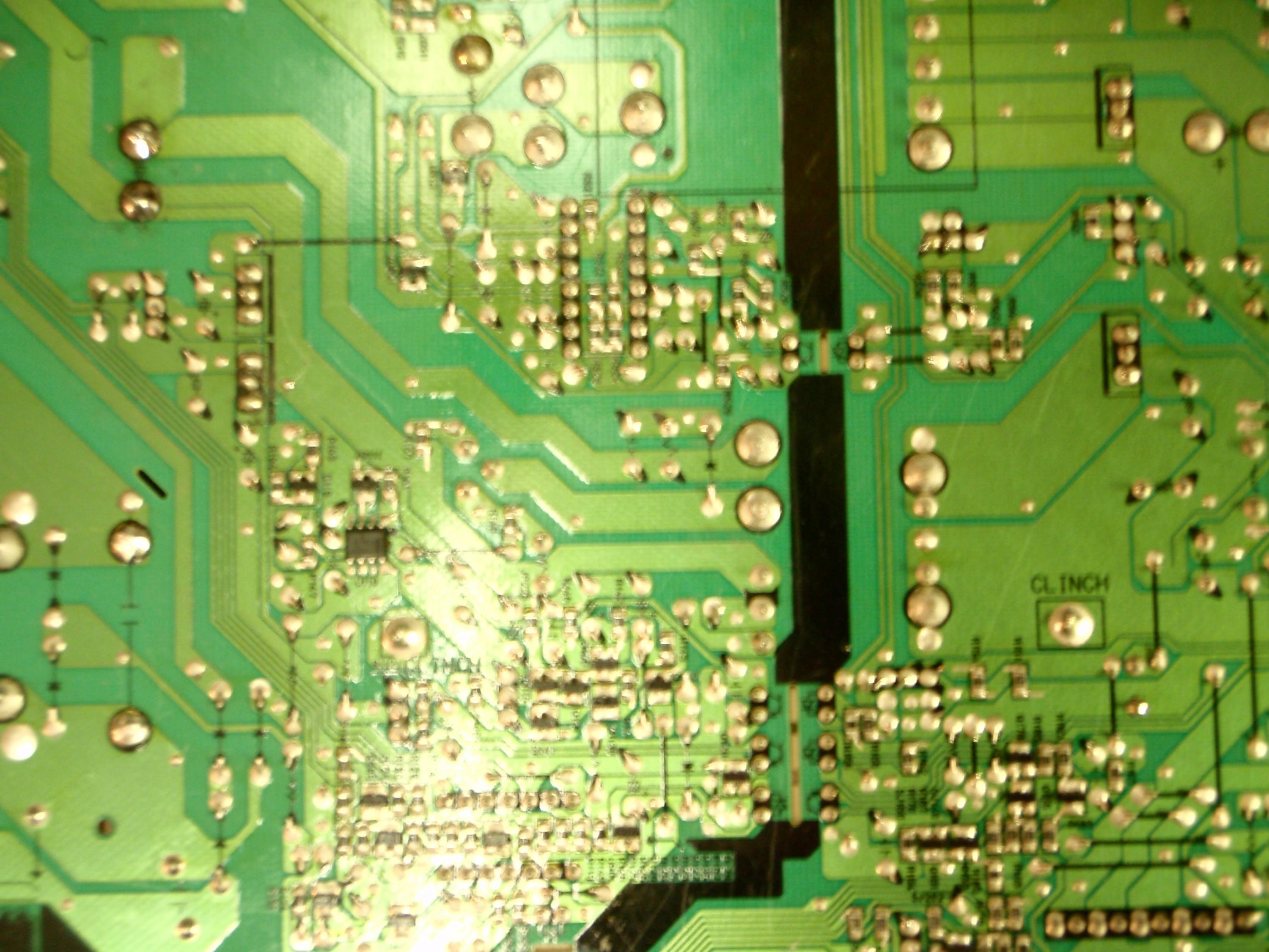

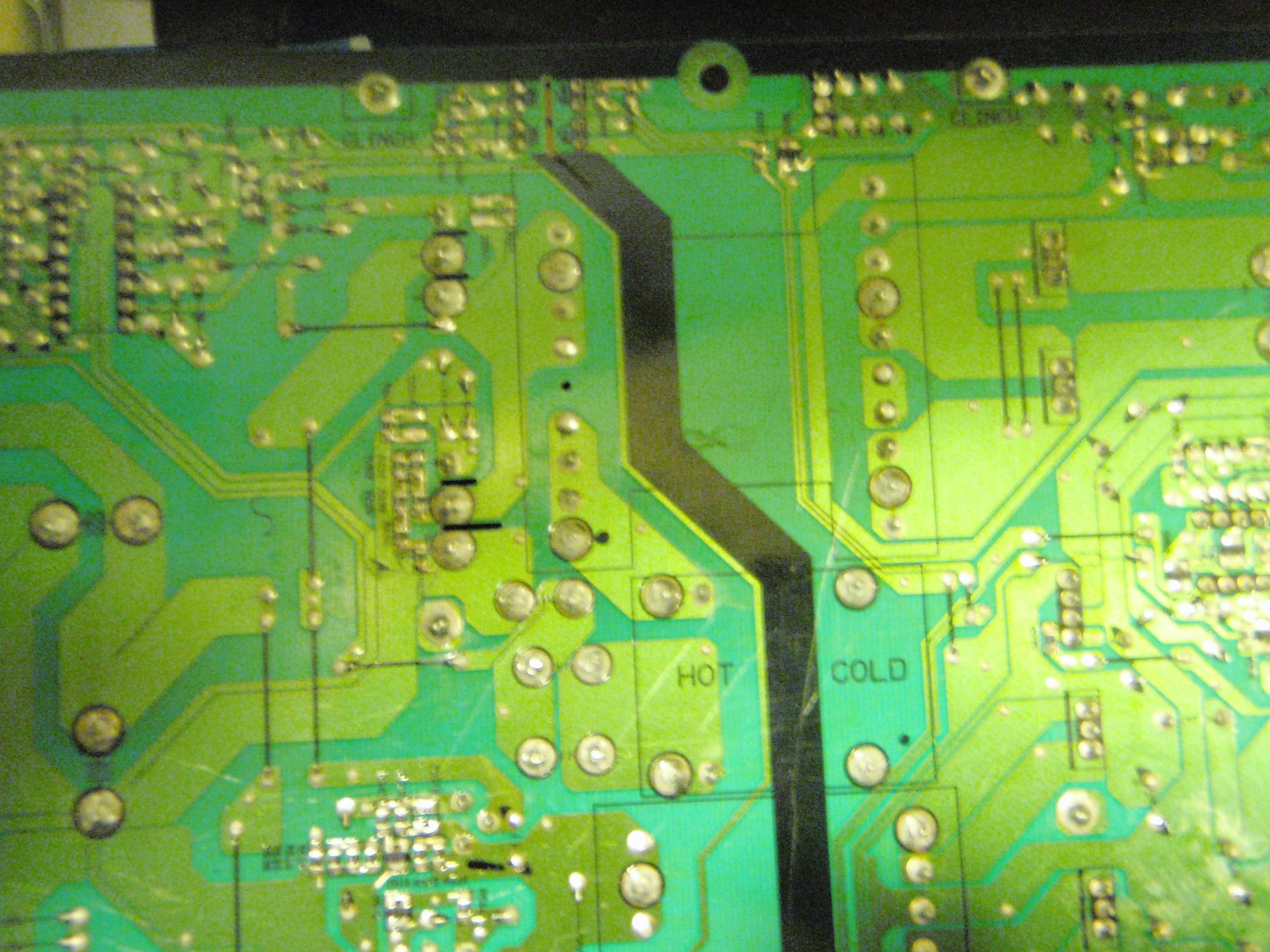

      here is whole board hopefully decent enough

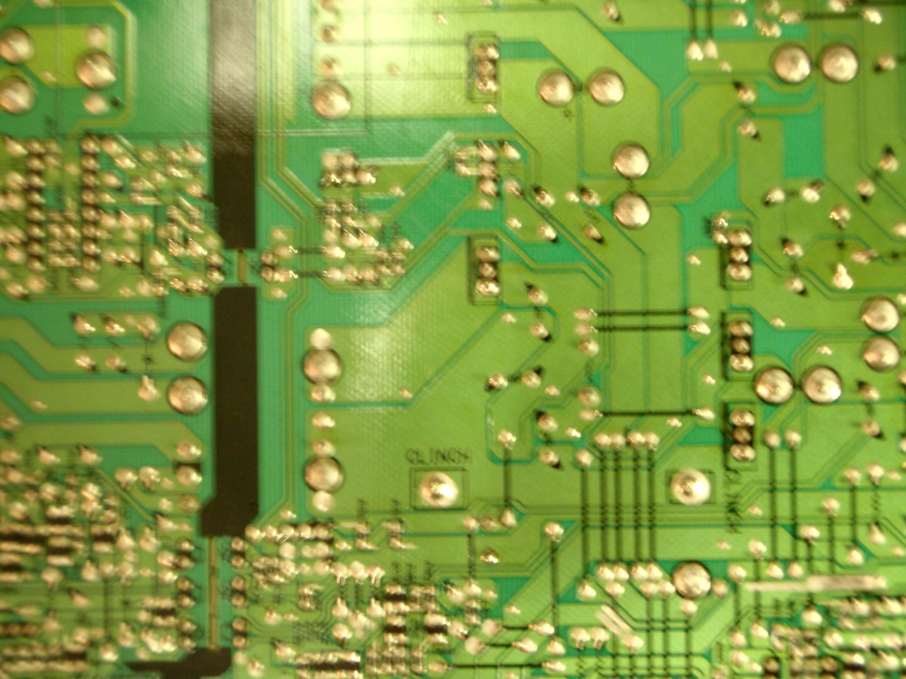

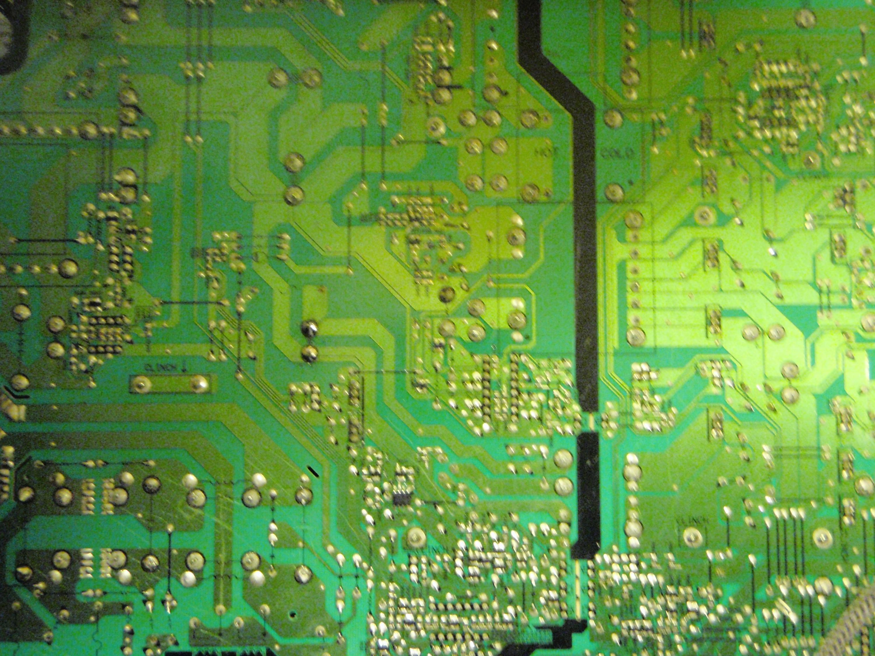

                #47
                Re: vizio vp50
                here they are let me know if you need other areas

                        #51
                        Re: vizio vp50
                        Ah now I see it.
                        See attached. Is this a 431 device?

                          #52
                          Re: vizio vp50
                          Originally posted by tom66
                          Ah now I see it.
                          Darn sure enough it is ....it's located between 2 heat sinks and had a film type capacitor covering it..just so you know there is no way in heck i can do a live voltage test on it it way way to tight in there will have to use a needle nose pliers to desoldier it very tight..umm can i do a basic regulator test with it?
                            #53
                            Re: vizio vp50
                            Can't you solder wires to it? On the bottom of the board, perhaps?
                            We need to measure it in circuit.
