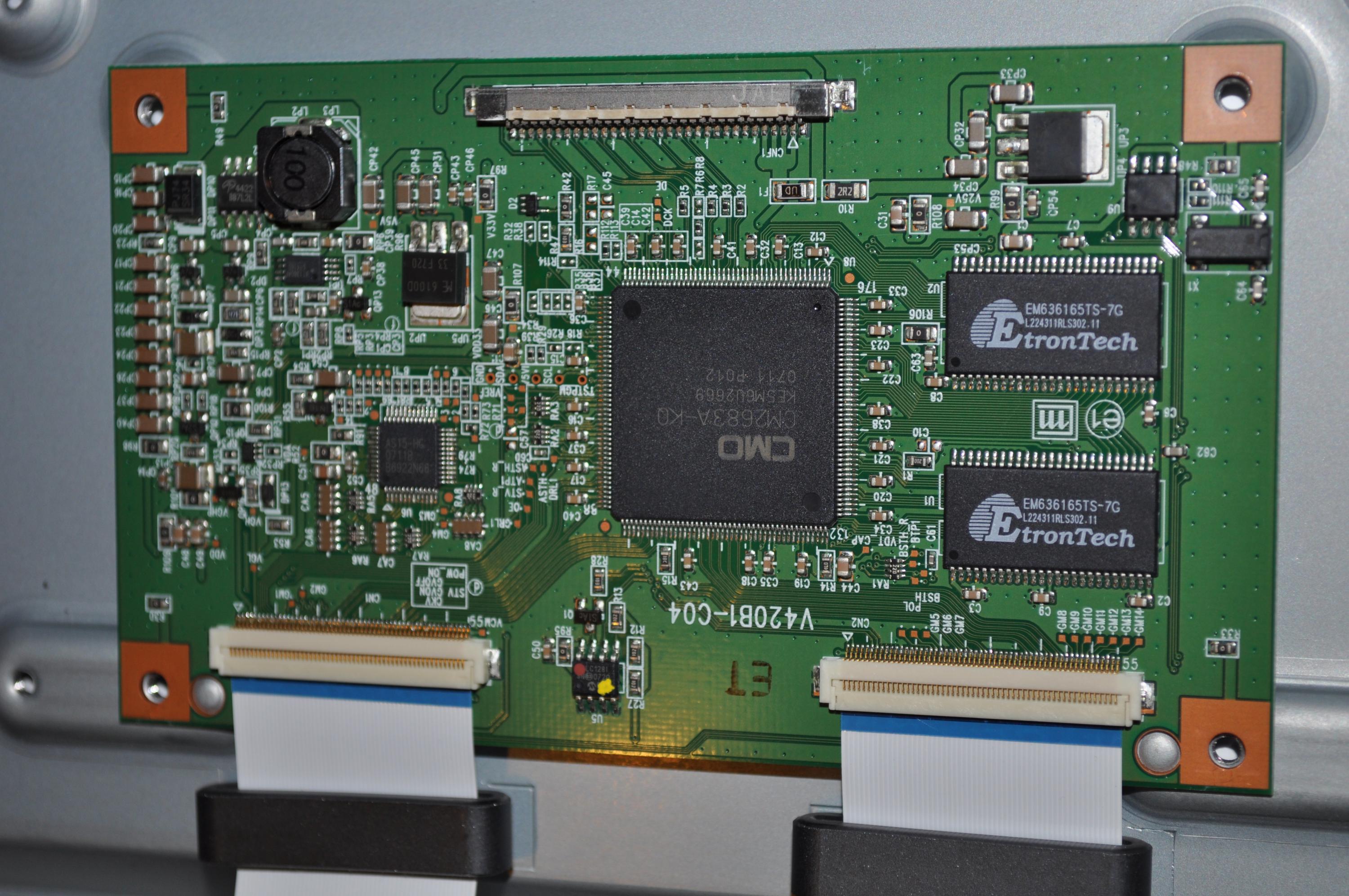

sharp aquos 42. lc-42d43u
  • auyeah
    • Aug 2014
    • 4
    #41
    Re: sharp aquos 42. lc-42d43u
    Sorry for the delay. Thank you for your assistance. Attached is a picture of the T-CON board. Please let me know if the resolution uploaded ok or if you need a close up.
    • auyeah
      • Aug 2014
      • 4
      #42
      I ended up finding tom66's spreadsheet on checking gamma voltages in a different forum thread and tested my T-CON board. It was bad, so I ordered and replaced the AS15-HG IC. Now everything is working properly. Thanks to budm for pointing me to the Gamma voltage issue and tom66 for generating the spreadsheet. Attached is the spreadsheet with my data entered. It didn't format correctly for me (I was using LibreOffice spreadsheet), so not sure whether it will be readable to all. Hopefully this data is useful to someone else in the future. Thanks again.
