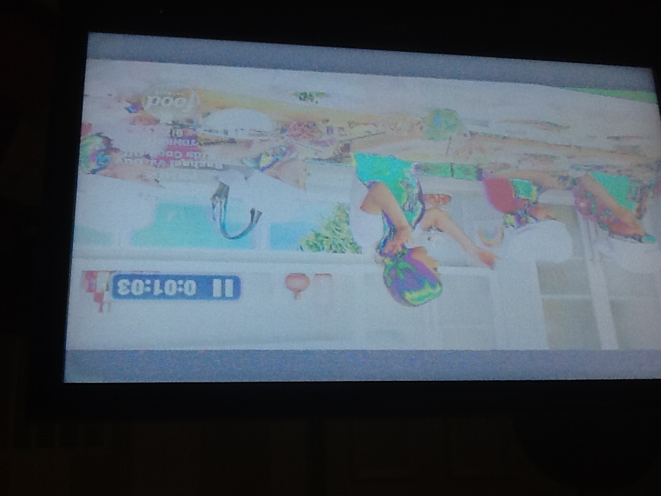

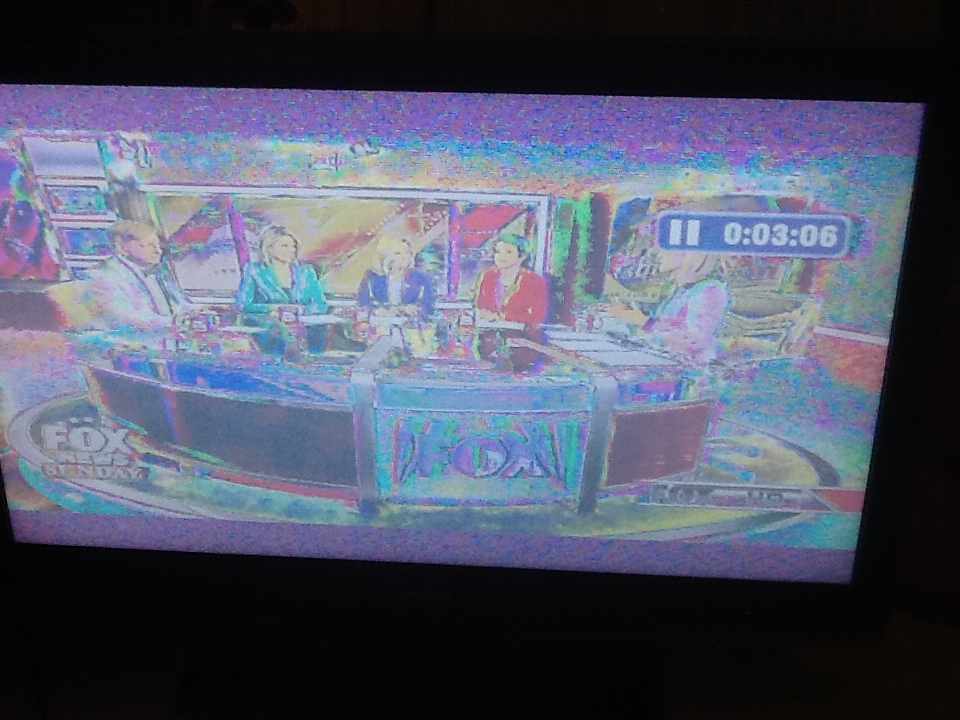

                                        I think I have a similar problem on a sharp LC- 42D43U. The colors are messed up. I took a couple of pictures which I will try to post.
                                        I tried (almost) everything mentioned in this post including reflowing the solder on the main CCA in the oven. I didn't have a can of freeze spray, though, so didn't try that yet. Any thoughts on what may be causing the issue (Seems like the problem is on the main CCA or TCON CCA). From several posts I've seen, the Main CCA seems to have been the problem much of the time on this model tv. Thanks for any advice.
                                          #40
                                          Re: sharp aquos 42. lc-42d43u
                                          @auyeah, that pictures look like it has bad gamma voltages on the T-CON board. Post the pictures of the T-CON so we can tell you where the test points for the Gamma voltages are.
