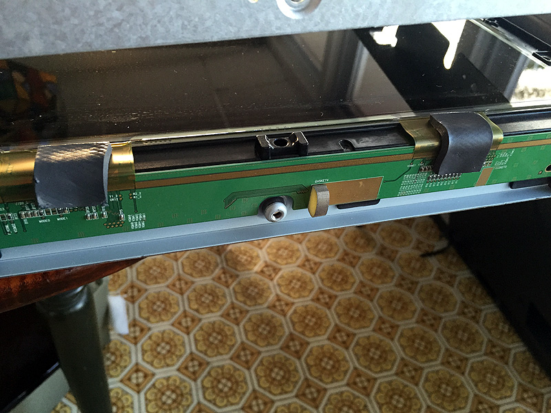

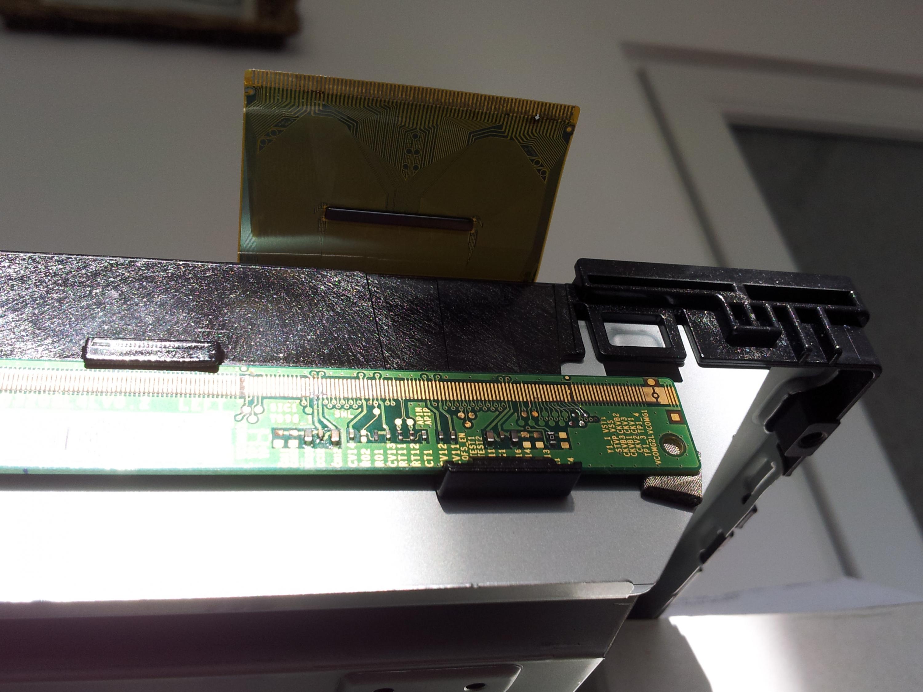

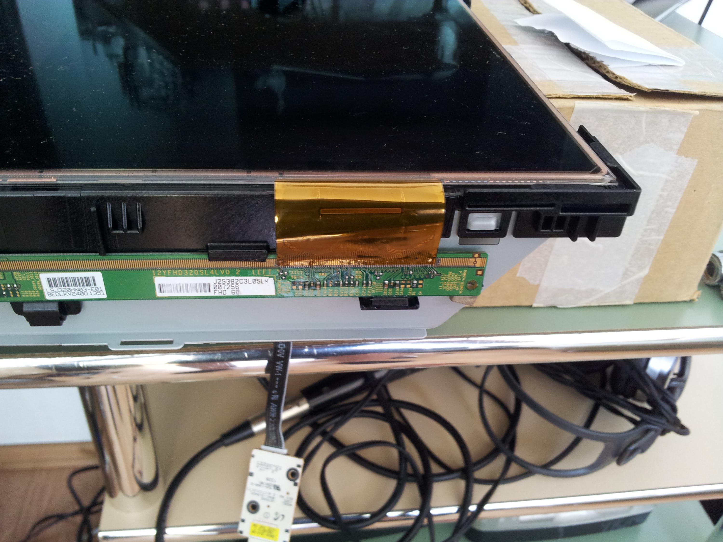

    Spent 30 minutes looking through these threads on failing tab bonds and the symptoms but cant find out what the fix is. Can you please confirm that the repair is made by placing a soft pad of 5mm thickness over the tab connection and then re-assembling the frame to apply pressure on the tab?
    Cheers,
    Allan
      Re: Samsung LN52A530P1FXZA Tab bonding repair
      Yes.
        Thank you Budm, not to be a smart arse or anything but I was wondering because some of the pictures showed 5mm material folded over 3 times, and I didn't really understand how all that would fit between the tab and the frame
          The one folded 3 time are from Deal Extreme which is thinner than the Bergquist one from Digikey, I was using them to see how well it will hold up compared to the one made by Bergquist which is more expensive.

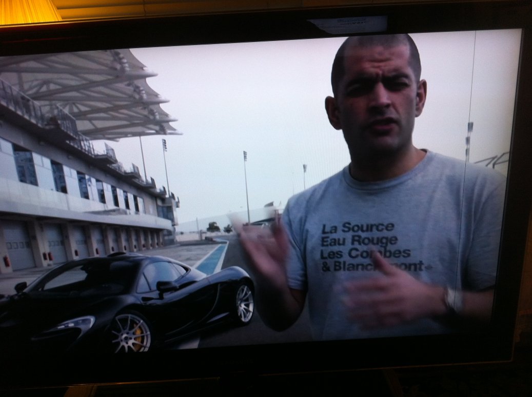

            Starts out pretty bad when cold; gets better when it gets some heat off the TV and after a bit of massaging by me, but I can't clear the last bit (about 3 lines of pixels worth).
            Even so, I reckon my chances are pretty good with this one once I've got it torn down a bit further. Don't you guys?

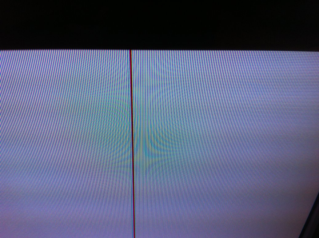

                After having it on for a while, I noticed a second tab bond acting up - the one on the very left side this time - manifesting itself as a single vertical line of turquoise pixels that, again, can be cleared easily by giving the rear cover a thwack.

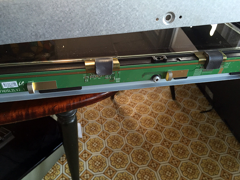

                  Well this one is taken care of. I shimmed both end tabs with a piece of this stuff, triple folded to give it the right girth:
                  http://www.ebay.com/itm/111642792448....M-7840.R6.TR7
                  I can't say I'm all that crazy about the material - it compresses down a lot, and once it gets a bit of heat on it feels a bit more like putty than foam. It did the job though, and the right side tab appears to be completely fixed. I found that I could still get the left side tab to act up occasionally if I squeezed the metal frame just right. It wasn't consistent though - sometimes I could get it to act up, sometimes I couldn't. The answer of course, now it's all back together with the plastic bezel and rear cover, is to just leave it be.
                  The 46A850 I've also been working on was a bit of a different story. No matter how I shimmed it, I couldn't get the picture to stay clear - installing the metal frame and snugging it up would always make a line or two appear on the right hand side of the screen. Even if I left the center screw out of the metal frame, the same lines would still appear once I'd properly installed the plastic bezel. I had that thing apart three or four times...until I somehow managed to crack the LCD. Sigh. So, sadly, that's another one I'll have to salvage for parts. It's a shame, since it was cosmetically much nicer than the 52" and had the stand! Insult to injury is it's also the one I actually spent good money on (to replace the bad PSU).

                            A couple weeks ago I was fortunate enough to pick up a free 52" Samsung LCD that had this same "tab bonding" problem. By reading all the posts here I went ahead and ordered the thermal pads from Digikey.
                            Then when I had some spare time I went ahead and opened it up and applied the cut pieces of thermal pad as others had done.
                            I closed it all up and was done. I didn't time myself, but didn't rush it either. I guess I was done in a couple of hours or less.

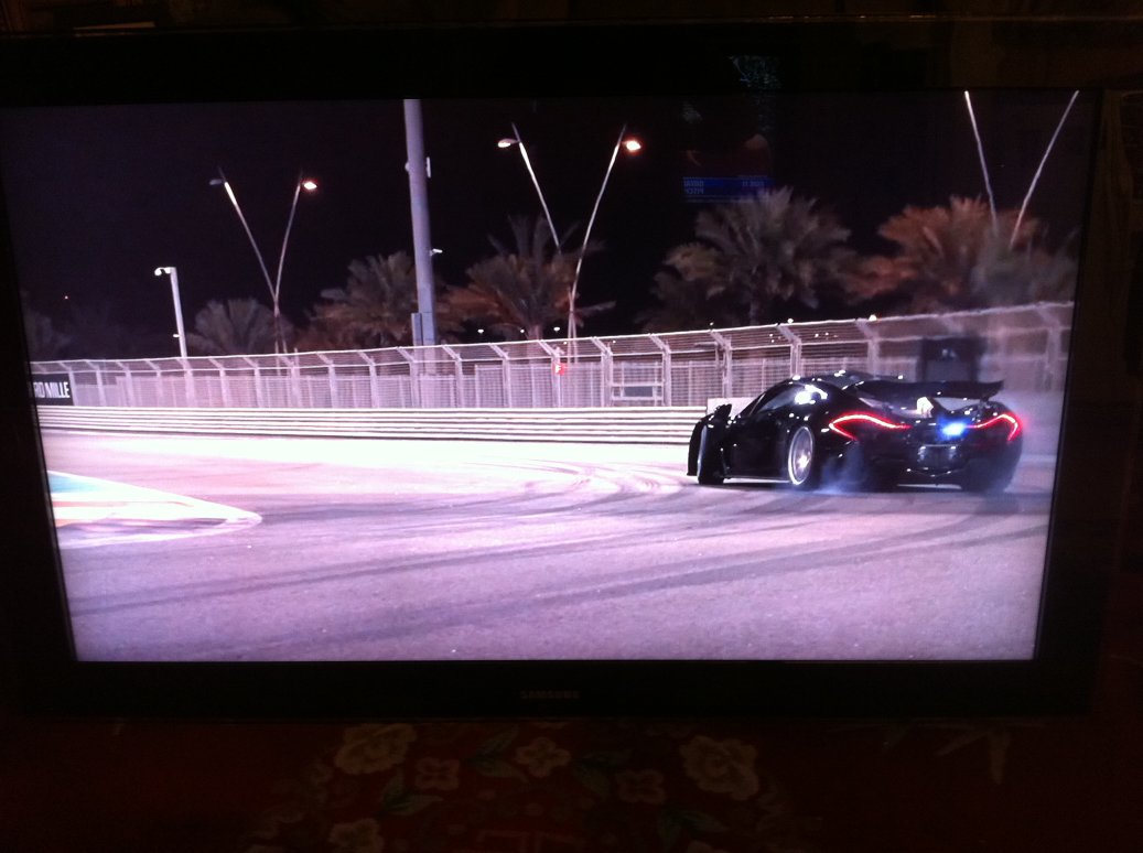

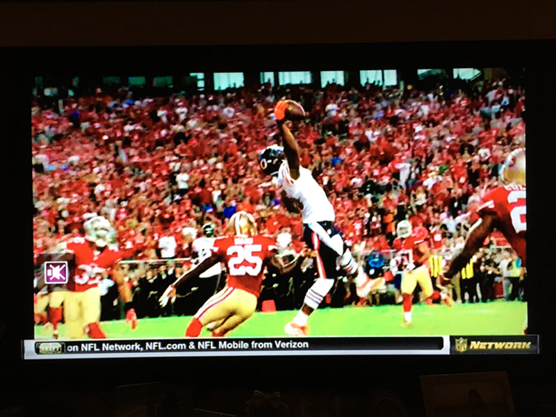

                                Just an update on my tab bonding repair post from two months ago. TV is still working great, not more lines and no issues. It is our main TV that has heavy use.

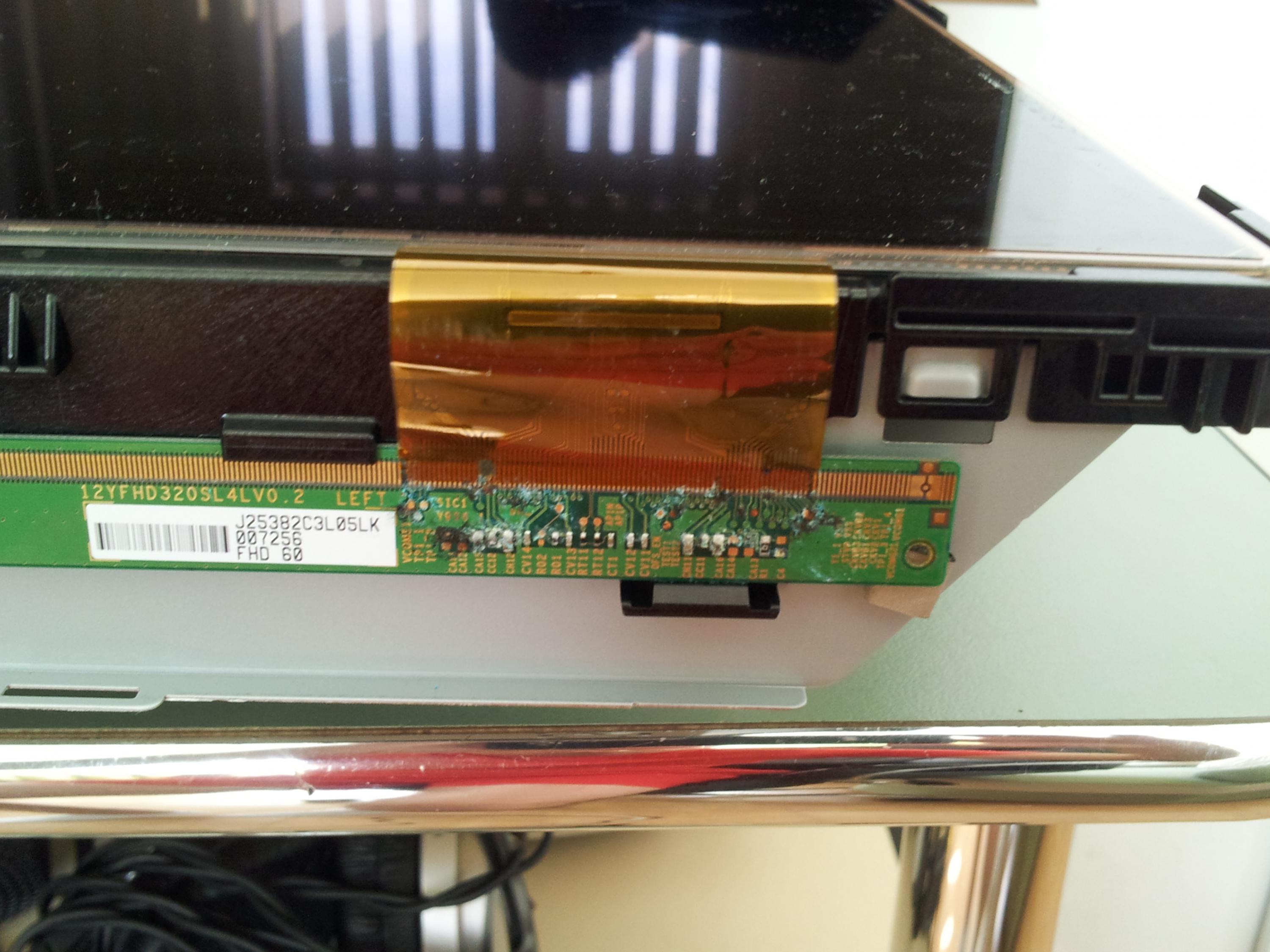

                                        bottom tab/tcon sets get damaged easily by glass cleaner and spills.
                                        It always seems to be the two outer tabs.
                                        BTW, I have recently seen two 26" LCD TV with Chi-Mei panel, bad tab bonds as well, different symptoms though.
                                        When will it end? Wonder if bottom mounted tabs will make a difference to reliability.
