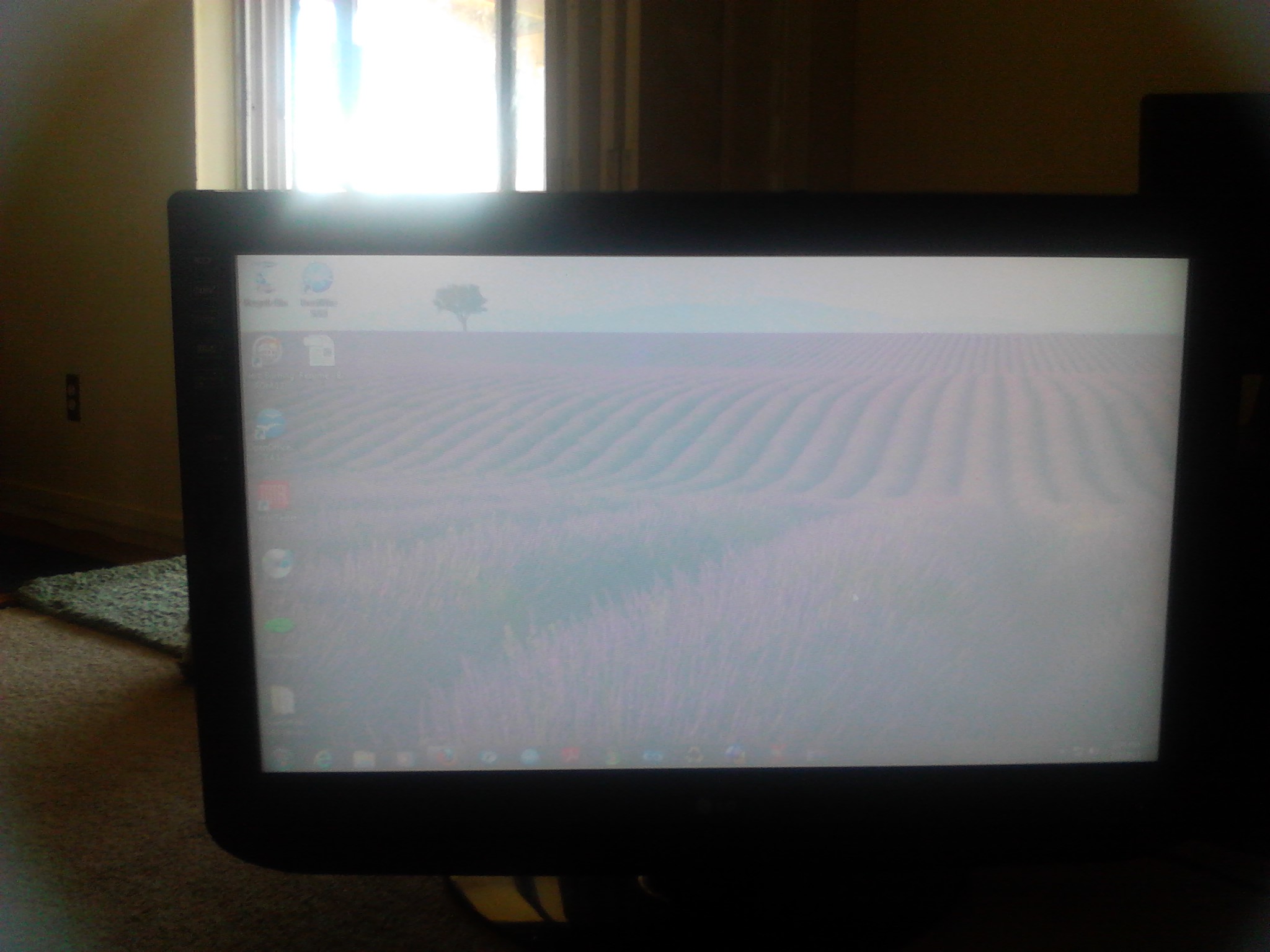

    hello to all, i have an lg plasma tv(mod. 37lg10) and worked fine. was watching a movie and paused it,went to store, came back and now i have a grayish screen. it still has a picture and sound but a white or grayish screen background to it. any sollutions to this anyone?

      i have done the reset to factory settings. just a few minutes ago it went to norm for about 1 second and back to the white and grayish screen again. tried to take a picture of it but didnt show right. the best way to describe it is like their is a white or gray cloud covering the picture. it goes to norm for a couple of seconds and the cloud comes back

        We have seen this before and it turned out to be the T-con board, which is usually less than $30 to replace. That would be my suggestion.
        37LG10 is an LCD display. LG does not make any 37" plasmas, anyway.

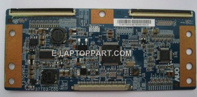

              i should have left that info for u when i had it open. duh.. i got 2 numbers off. i googled this one"37T03-C00" and it came up and this number here"T370XW02". LIKE I SAID, THANKS FOR THE HELP, appreciate it
                Re: gray screen
                Any pictures of the T-CON board, it can be as simple as blown surface mounted fuse on the T-CON board.

                  looks just like this one.
                    Re: gray screen
                    You can see WHITE surface mounted fuse on the left side of the bottom connector. You need to check (with the TV on) to see what DC voltage you have on both ends of the fuse, black probe of the DC voltmeter will be at the metal chassis, the red probe will be testing each end of the fuse for DC voltage, report what you find. Meter should be set to 20V scale.

                          I have same problem. Voltage showing 12.65 on top of fuse and 12.88 on bottom. Any suggestions?
                            Re: gray screen
                            Usually AS15F IC on t-con board.

                                  If you can solder a chip on the board with 0.5mm pitch between leads, then replace the AS15F, otherwise, replace the board. The boards are pulls from TVs with cracked screens so receiving a dud is a possibility.

                                    It's AF15U. I'm probably not that good at soldering. I'll look for a board. Thanks much!

                                      I have one of the LG 37LG10 LCD TV's with the white screen or white clouding syndrome. Rumor has it from the above thread that either the T-Conn board or the AF15U or equivalent will do the job. Has anyone successfully fixed the syndrome by replacing the card or chip? If so where can one get (1) chip, searching comes up with vendors that will sell you numerous batches but nary a one that will sell just 1. I realize I can go with the card but I am good at soldering, even the small packages. Help is appreciated..... Regards; JOE
