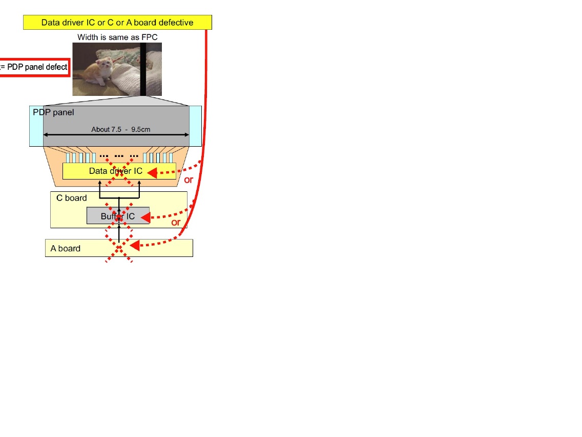

                                  Re: 55 inch Plasma Viera (VIERA TC-P55GT30) not turning on. 7 blinking red lights.
                                  Cannot start a new thread so I thought I post it here. Similar Panasonic TV but bigger screen (VT-P65GT30) which is two years old and suddenly developed Vertical bar about 3” wide that is Yellow color under white background on the left side of the screen. Checking through website and found some Panasonic service training manual showing a similar symptom except all are black bar or red bar with no background showing. My TV shows the picture except it has yellow tint on majority of its presence. The possibilities are C3 board, or A board with occasionally PDP panel driver IC which is embedded and cannot be replaced. Am I on the right path? Any input would be helpful.
                                  • tw2005
                                    • Oct 2011
                                    • 6458
                                    #117
                                    To eliminate A board, in the service menu you can flip the image so the left side is displayed on the right and the right on the left.
                                    If the bar moves to the opposite side then it'll be A board.

                                        #119
                                        Thanks for a tip. I have moved to a new thread under Panasonic TC-P65GT30 Yellow Vertical Bar problem.
