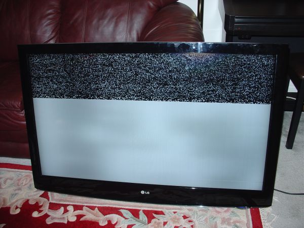

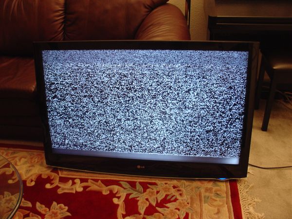

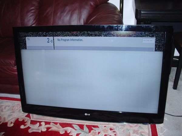

    LG 47 LCD quickly go to white blank screen
    The TV start out fine for 2-3 seconds, then bottom portion freezes and turns white.
    The top portion of the screen is fine and remains working.
    Sound works fine.
    model: 47LH30
  • Twinky
    • Nov 2012
    • 22
    Re: LG 47 LCD quickly go to white blank screen
    I'm no expert but that looks like a chip on the display driver board is toast - maybe overheating or something.
      This one look just like the same problem with my LG 47LH55, it is bad panel, new T-CON board did not fix the problem. Many people has this same problem with this model of you Google it.
