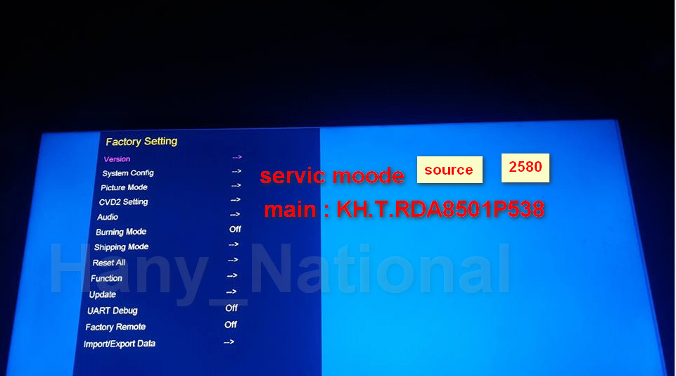

                      Re: Factory Resets Listing
                      Bravo led32 bed11 main-hk.t.rda8501p538
