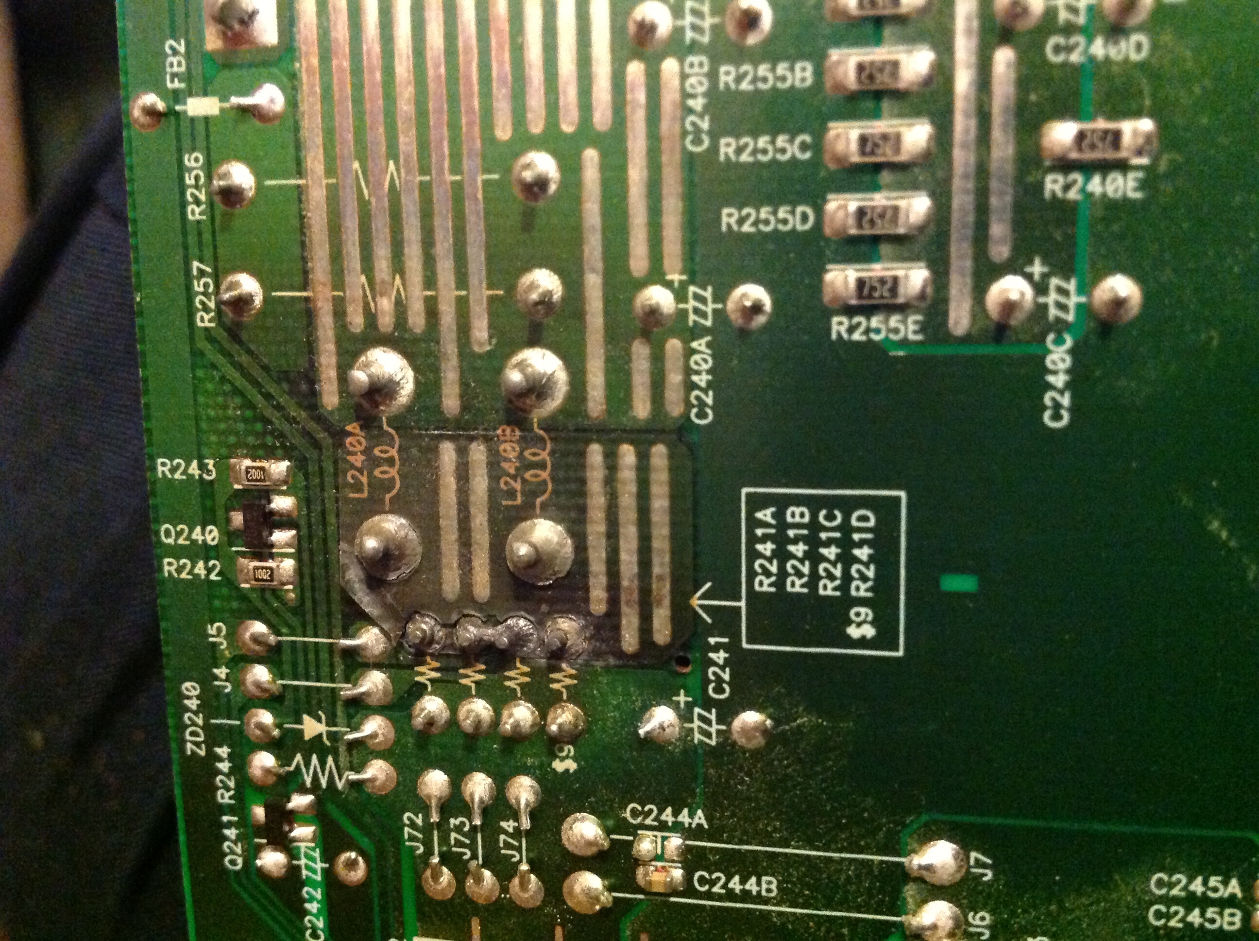

    I just picked this thing up. Probably paid too much for it but I felt sorry for the guy who is apparently being evicted from his house (who knows). Anyhow, There's an obvious burnt spot and a bulging cap, on the PSU, but no blown fuses. There's also bulging caps on both inverter boards. Chances are there's a bad regulator or two on the main board as well.
    The traces on the back of the panel look OK, do you think it's worth repairing this PSU, or should I just try to find a used one?

    Bad caps will cause those inductors to run hot but they are probably OK. Replace the caps. Normally Chemicons do not fail. Poor design if it can kill those!

      I Replaced 1 35V 470uf cap on the PSU, 2 35V 680uf caps on each inverter, and a 10A fuse on the master inverter. The results speak for themselves.

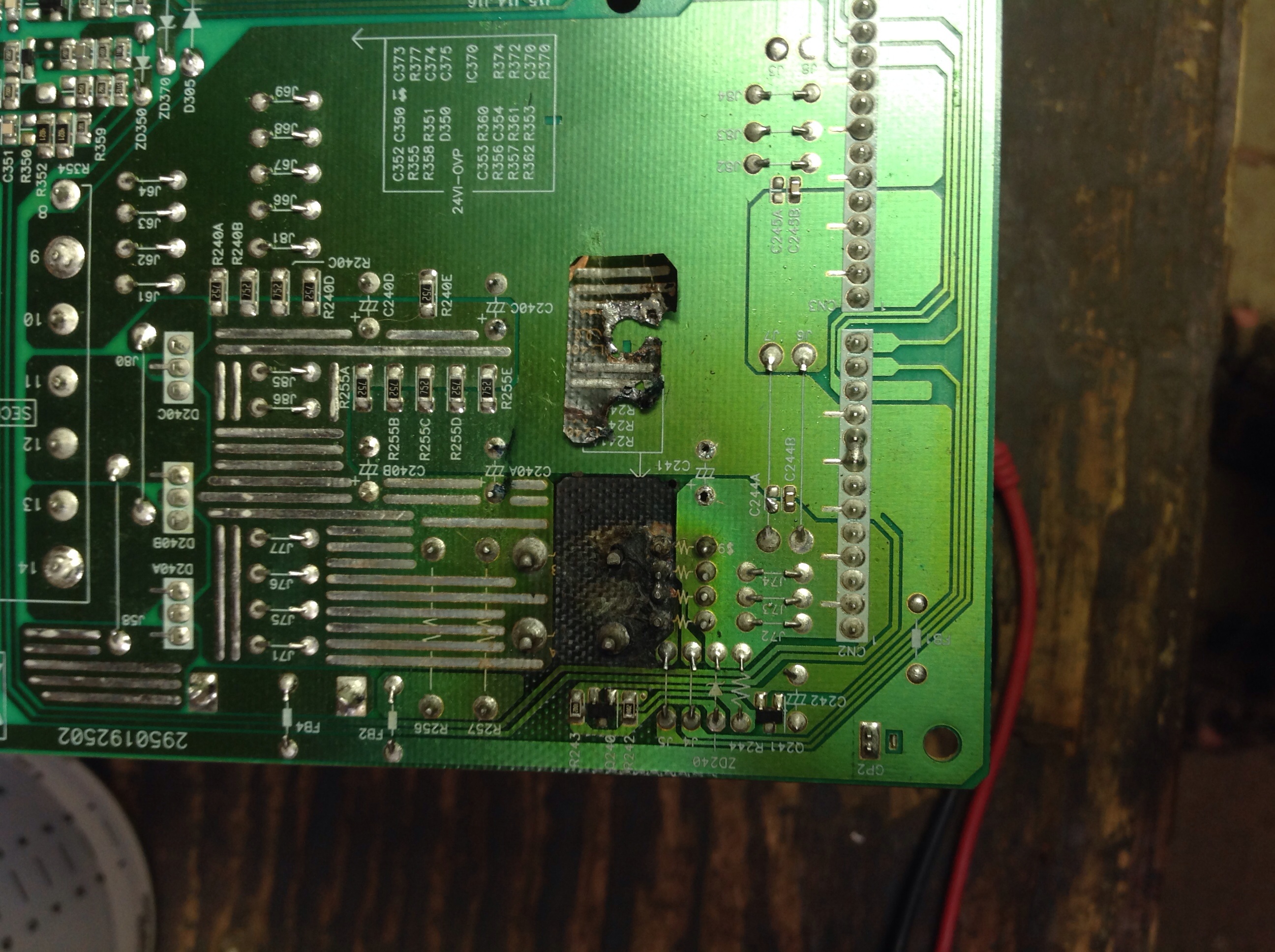

                    I Got the same problem but the board is burnt so bad the board started to peel up as you can see in the picture. I'm going to change the one capacitor. But before I start I was wondering if I'm wasting my time with the board that bad burnt.

                      That is the symptom of bad filter cap in the Pi filter, the inductors are trying to block the High frequency AC ripple from flowing through (inductor blocks AC and passes DC, cap passes AC, blocks DC. You need to change the caps as a set since bad cap can look normal.
                      To fix that solder solder joints, you need to add more regular solder (not lead free) to the connections and remove the solder, clean the leads real well and use solder flux to solder the parts back on.

                        I finally got home long enough time to start working on the board. When I was cleaning the board the rest of the strip came off. Is there a way to repair it or trash it? Please see the pic.

                          It's repairable but you're going to need to figure out where each end of that inductor went so you can solder wires to each end.

                            Please bare with me trying to fix a board for the first time. I would like to hook it up to see if it works but would like an opinion on it first. If you need to see other pictures you can scroll up in this thread. Thanks

                              looks good so far, since both inductors are in parallel. Looking at your picture it seems you have changed C241, but not the other filter caps. I would recommend to change C240A und C240B too as they are responsible for the high ripple current through the inductor coils!
