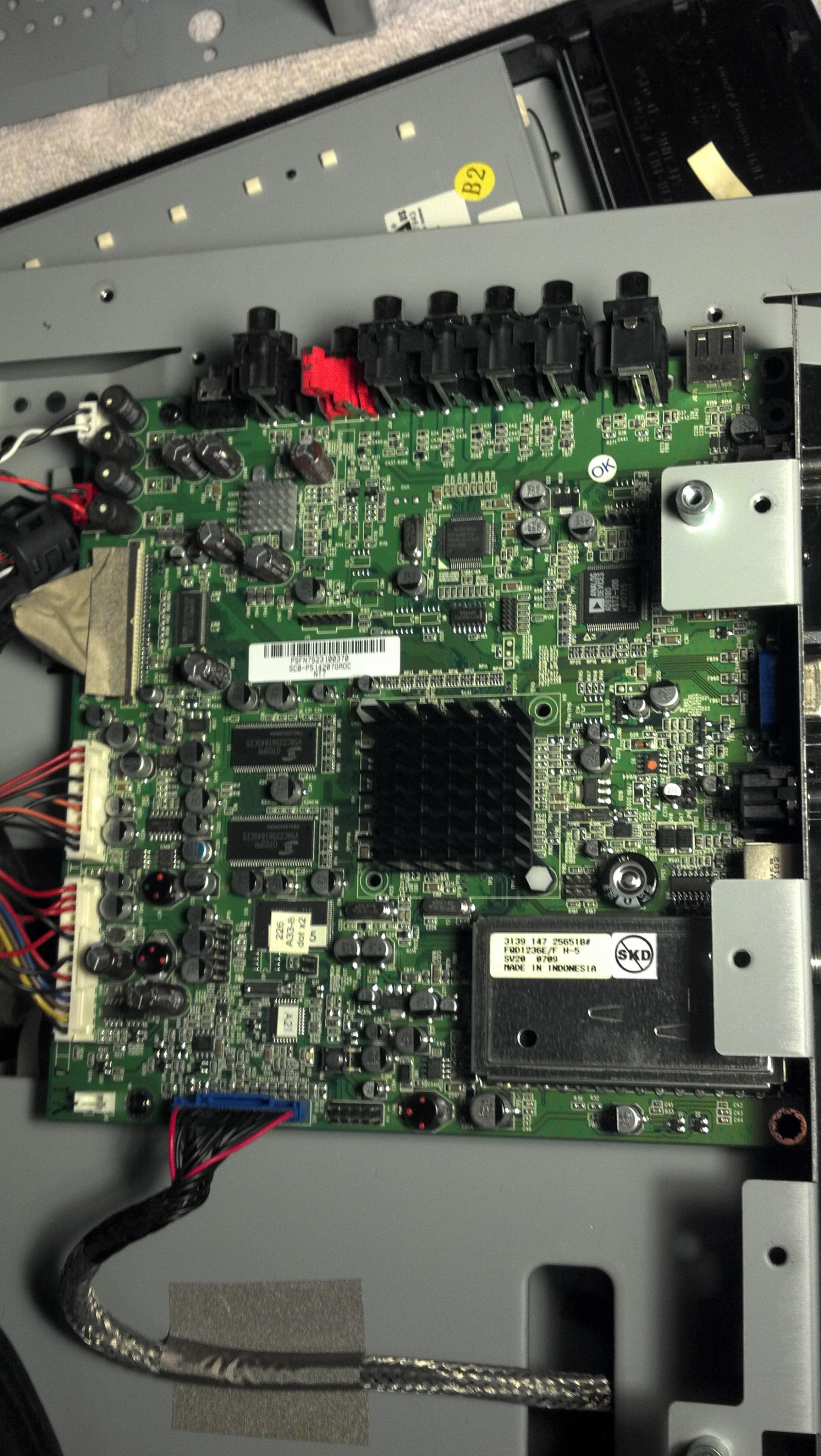

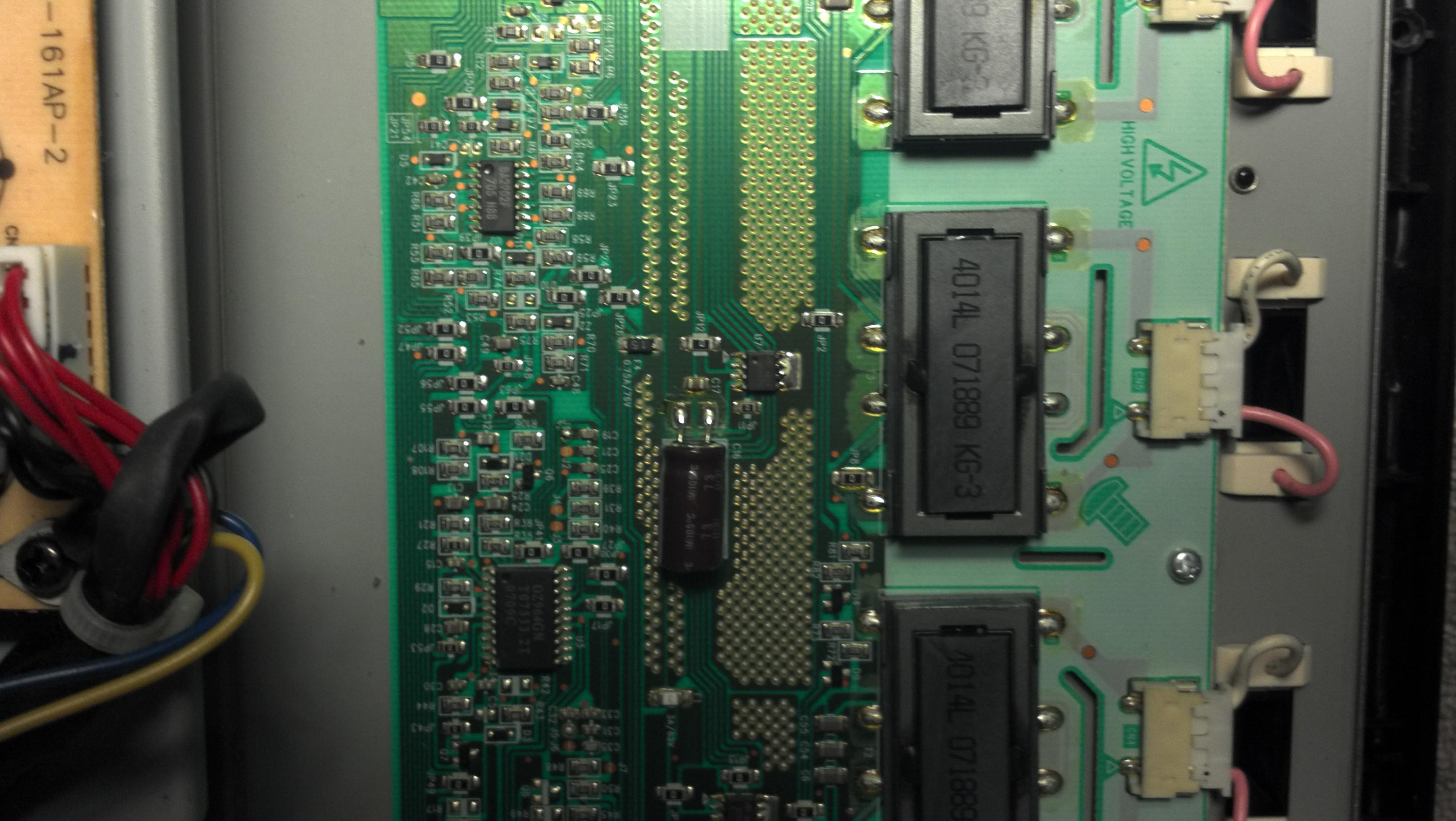

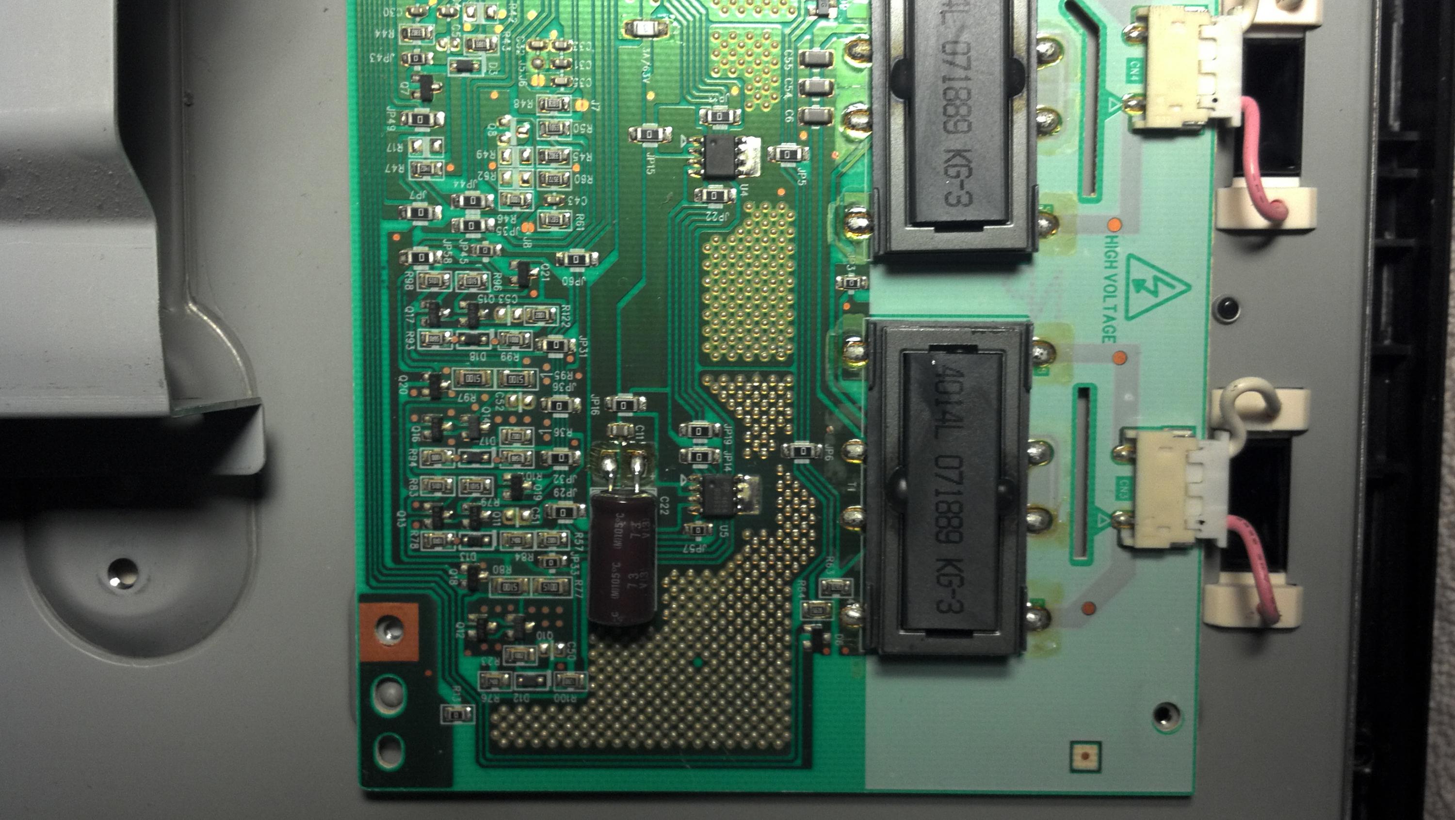

    the blue stand by light is lit but when I go to turn on the tv the blue light goes off and nothing. I have tested the power supply and it is putting 24v out to the inverter. I am open to some ideas. I have tested all 4 fuses on the inverter and they all test good. I have tested the caps on the inverter and they are all good. I have tested the transformers and they are testing good.
    Re: Olevia 226-T11 won't turn on

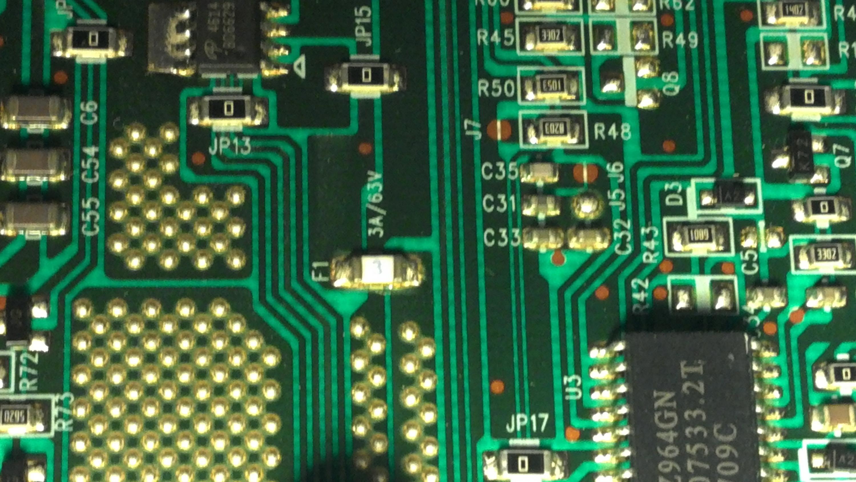

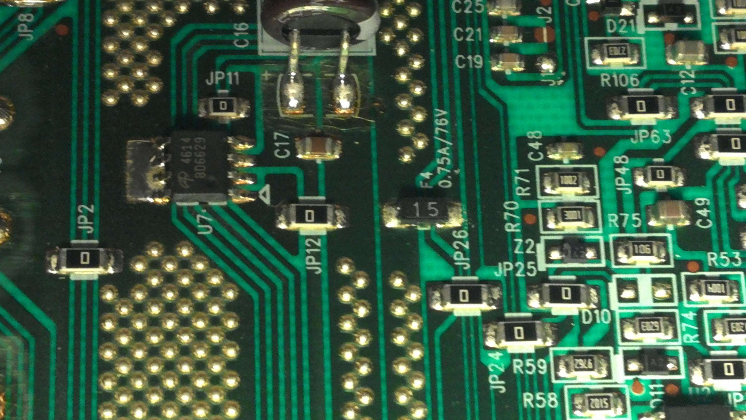

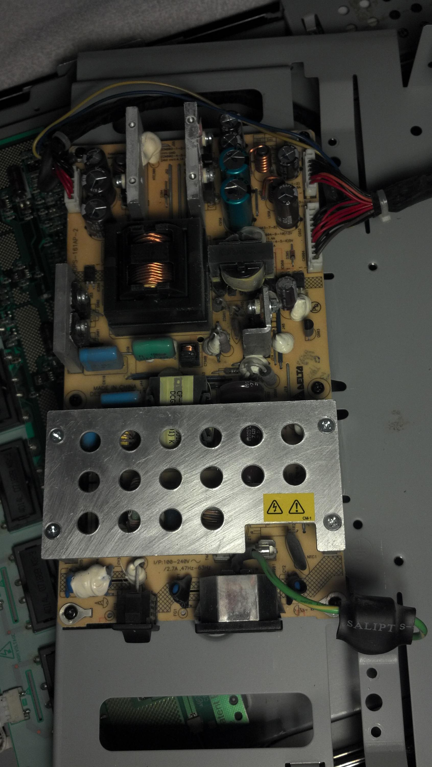

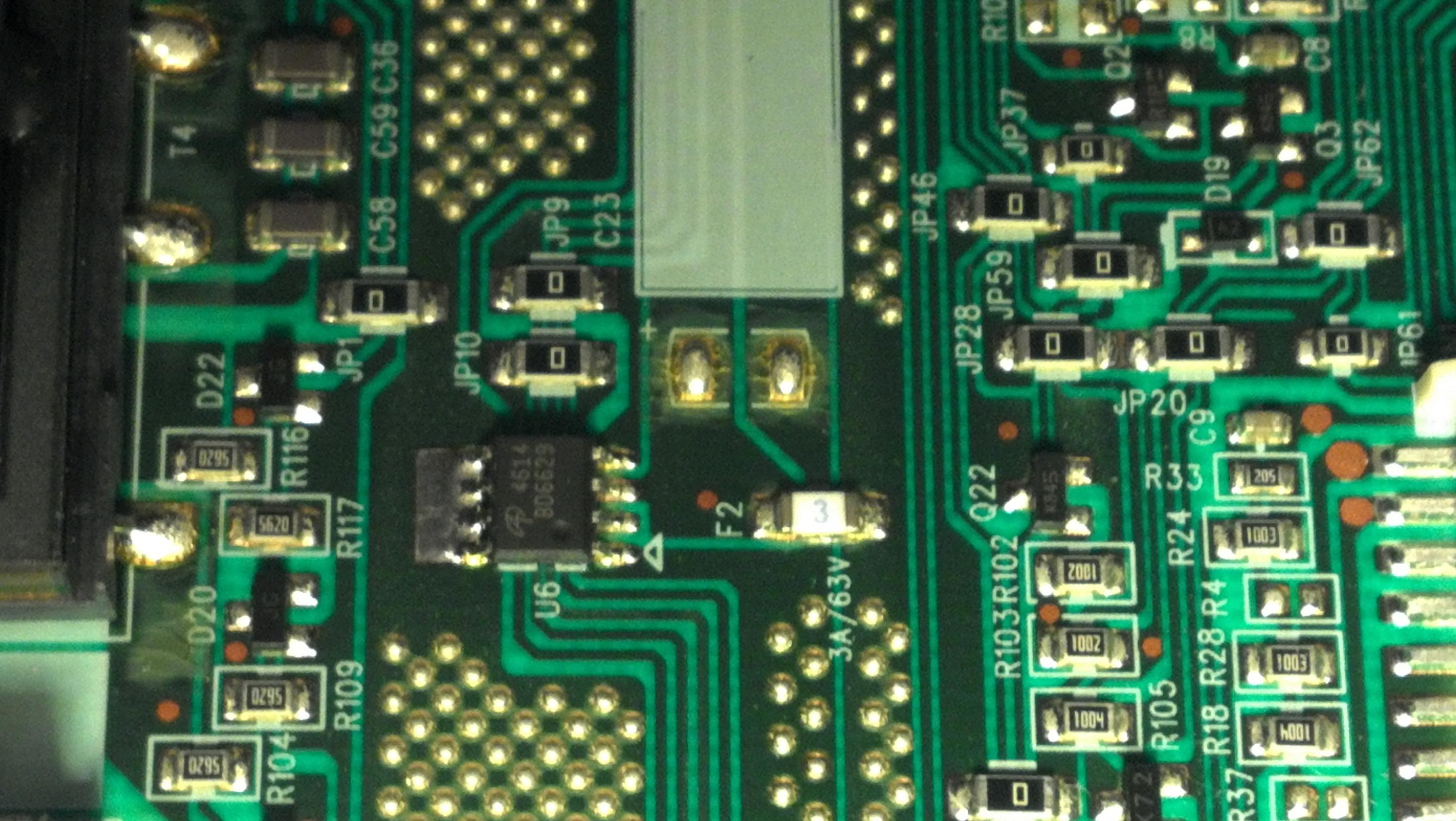

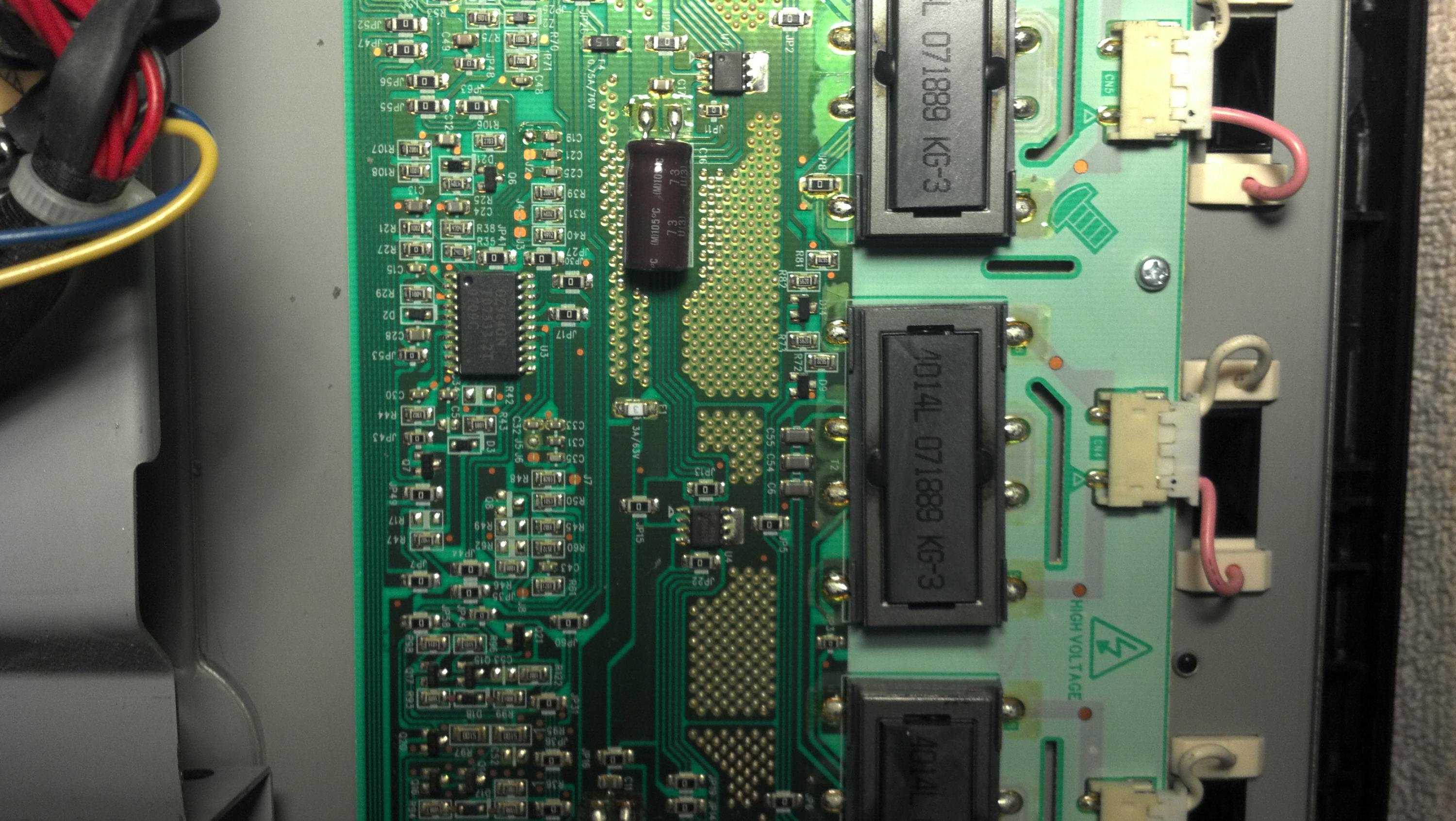

    Here are some picturs of the boards

      Have you checked all voltages?
      Check BL-ON voltage before and after pressing power button.

        The boards aren't labeled very well. Where do I test the BL-On at? I have connected it to a source and played a movie through it. There is no audio or video even with a bright light in the dark nothing.

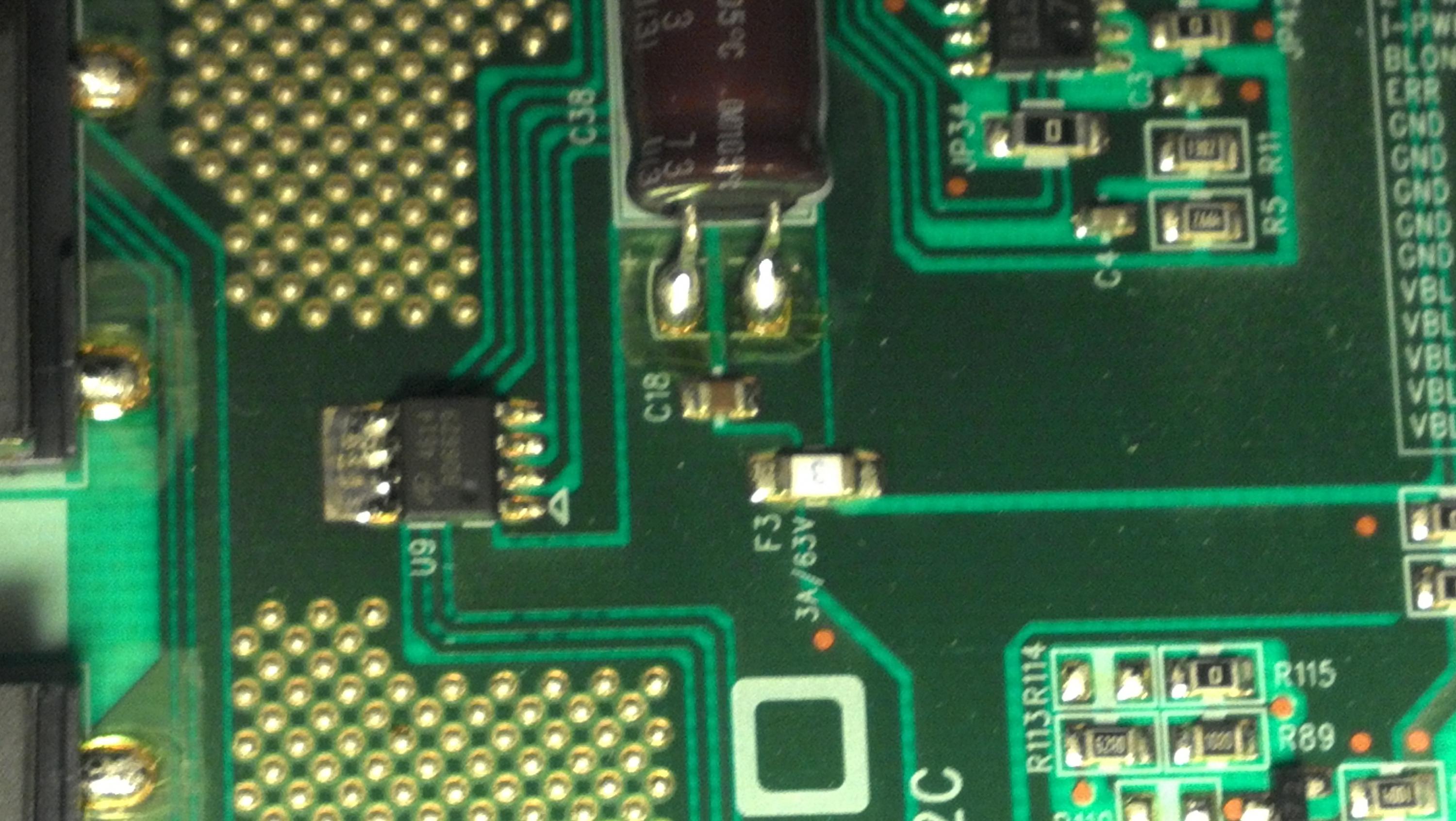

          You can see the BLON pin label right at the white connection picture #6 which the printing is cutout in the picture.. What resistance do you read on that black F4 fuse?

            on the black F4 fuse I get .1 resistance. on BLON power button off and tv in standby I get 0v and when I press the power on I get 0 volts.
