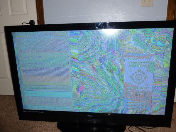

    Vizio model XVT553SV LED LCD. On craigs list for $300. Owner claims the power supply and main board were replaced by an authorized Vizio repairman.
    In the process the picture became "messed up".
    What do you guys think?
    No way am I going to pay $300 for the set. It does look like parts are plentiful for the set.

      Looks like bad main board config?
      Most likely needs a reset -- but that can only be done from the service menu. Do Vizios even have service menus??

        I'd go with TOM. Definitely had 1 Plasma with weird stuff like yours although yours is really funky (and I just realised your talking LCD)and got that fully restored via the service menu and reset.

              OK, finally got around to this one. Reset the ribbon cable from the main board to the Tcon, no change.
              Replaced Tcon board, no change.
              Changed Power Supply, still no change.
              Decided to give the ribbon cable to the Tcon board a little more attention.
              Thoroughly cleaned the cable, reseated, and BINGO....Fixed.
              I purchased the Tcon, Pwr Supply beforehand, just in case I needed them.
              I will be keeping this TV and since it is a Vizio, I'll probably need both these boards in the future.
              I paid $150 for the TV (the most I have ever paid for a broken TV) and another $77 for the other two boards.
