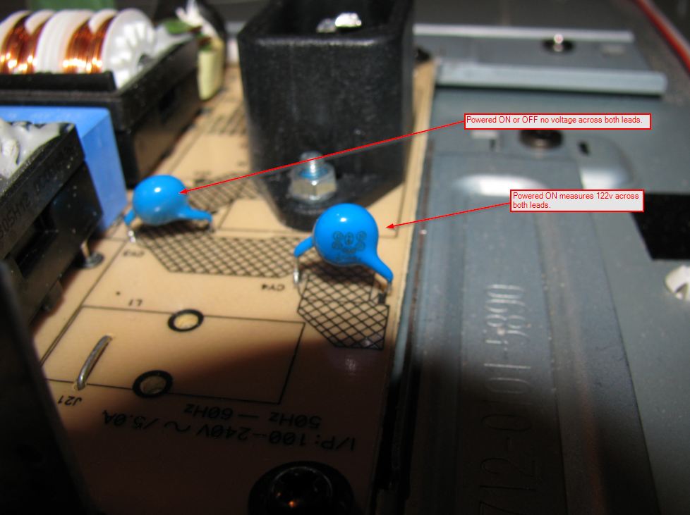

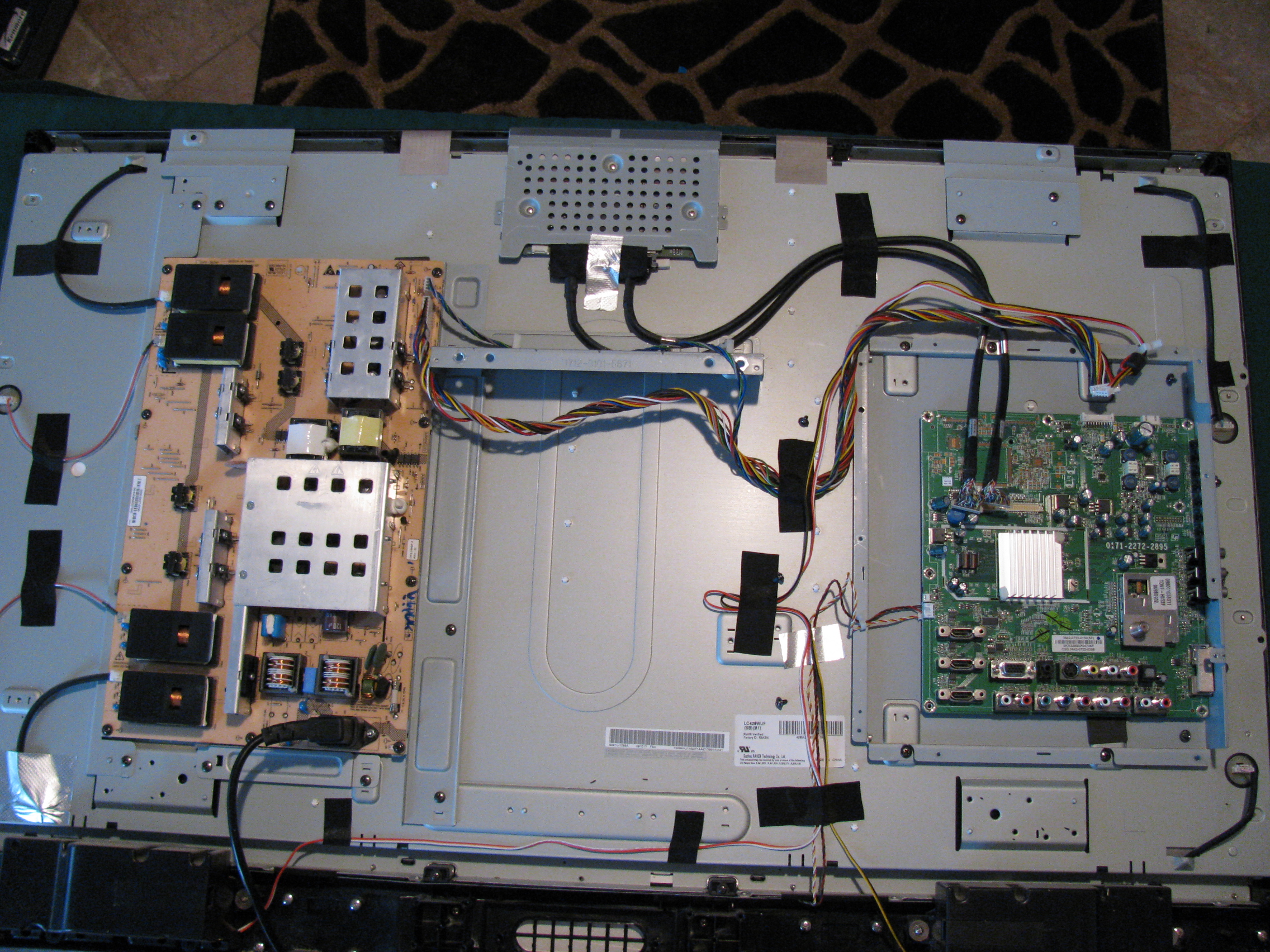

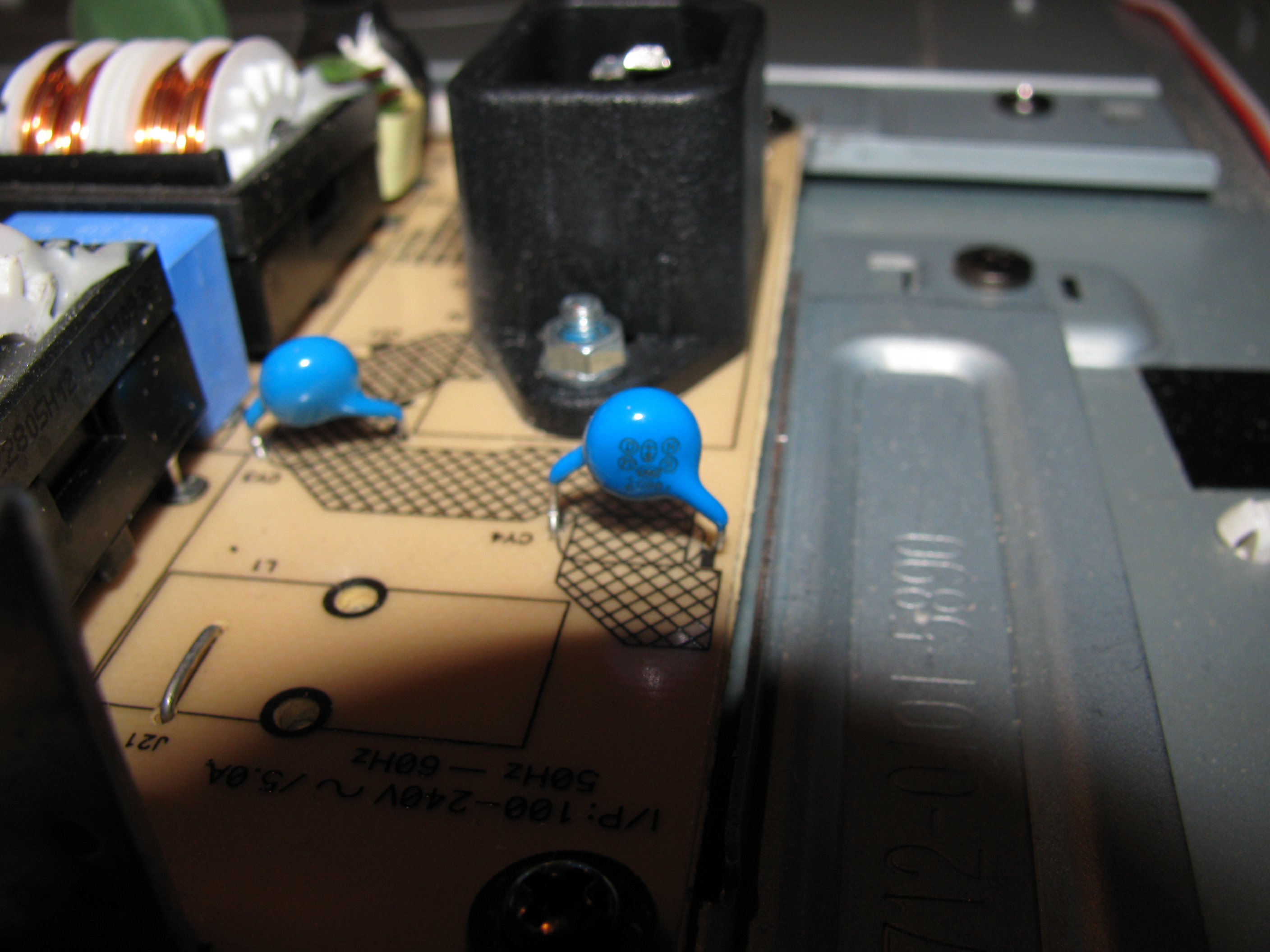

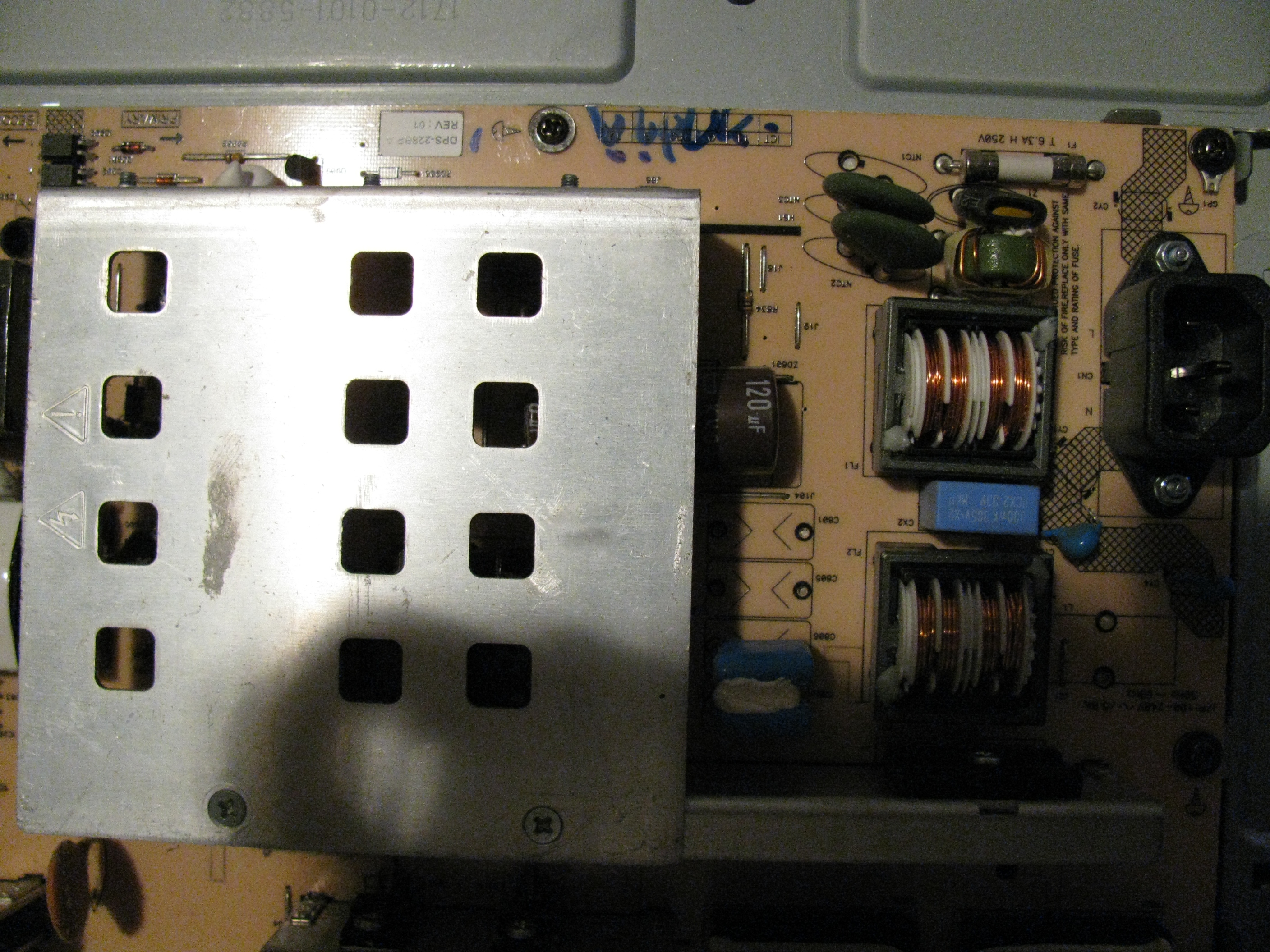

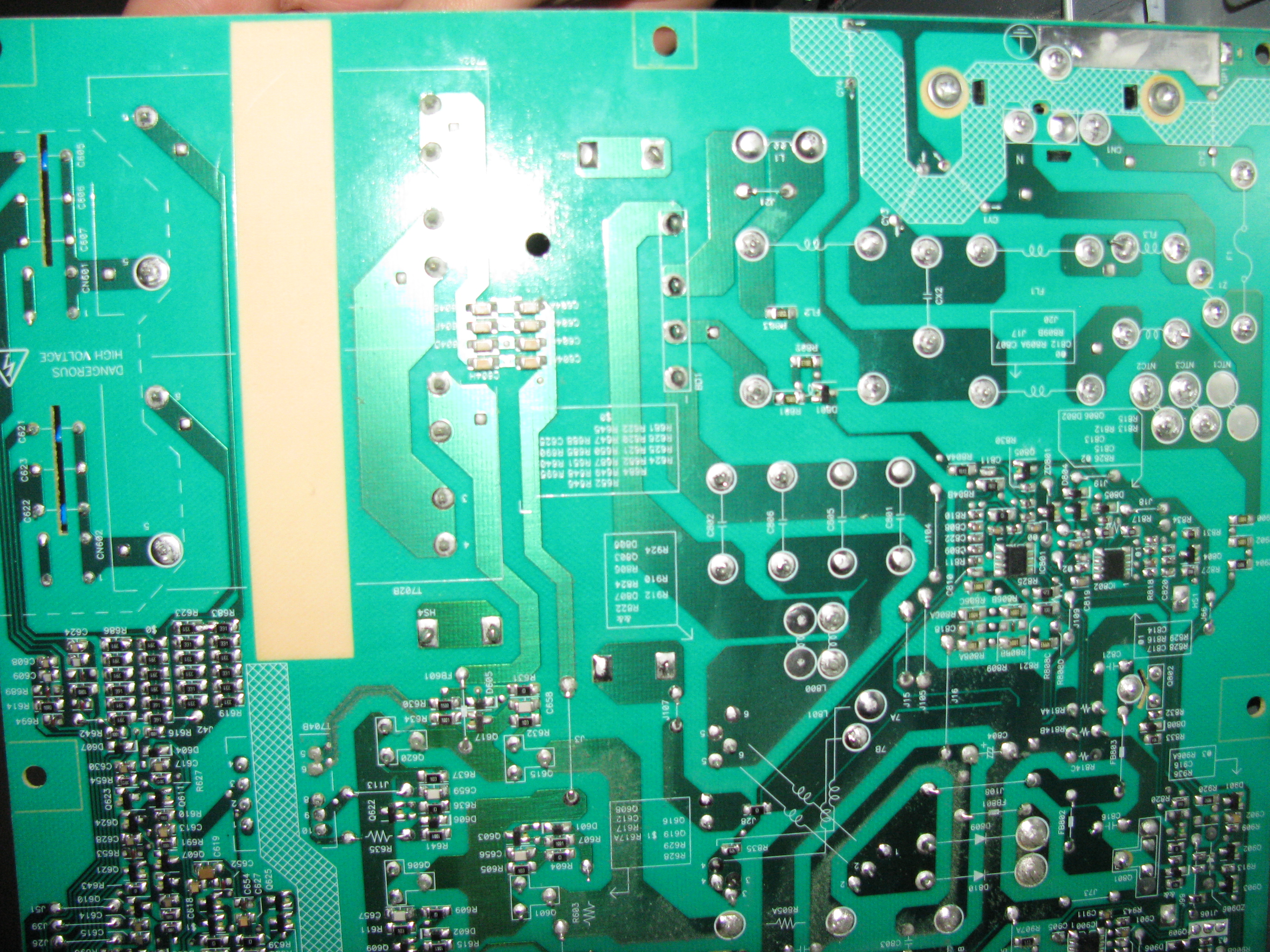

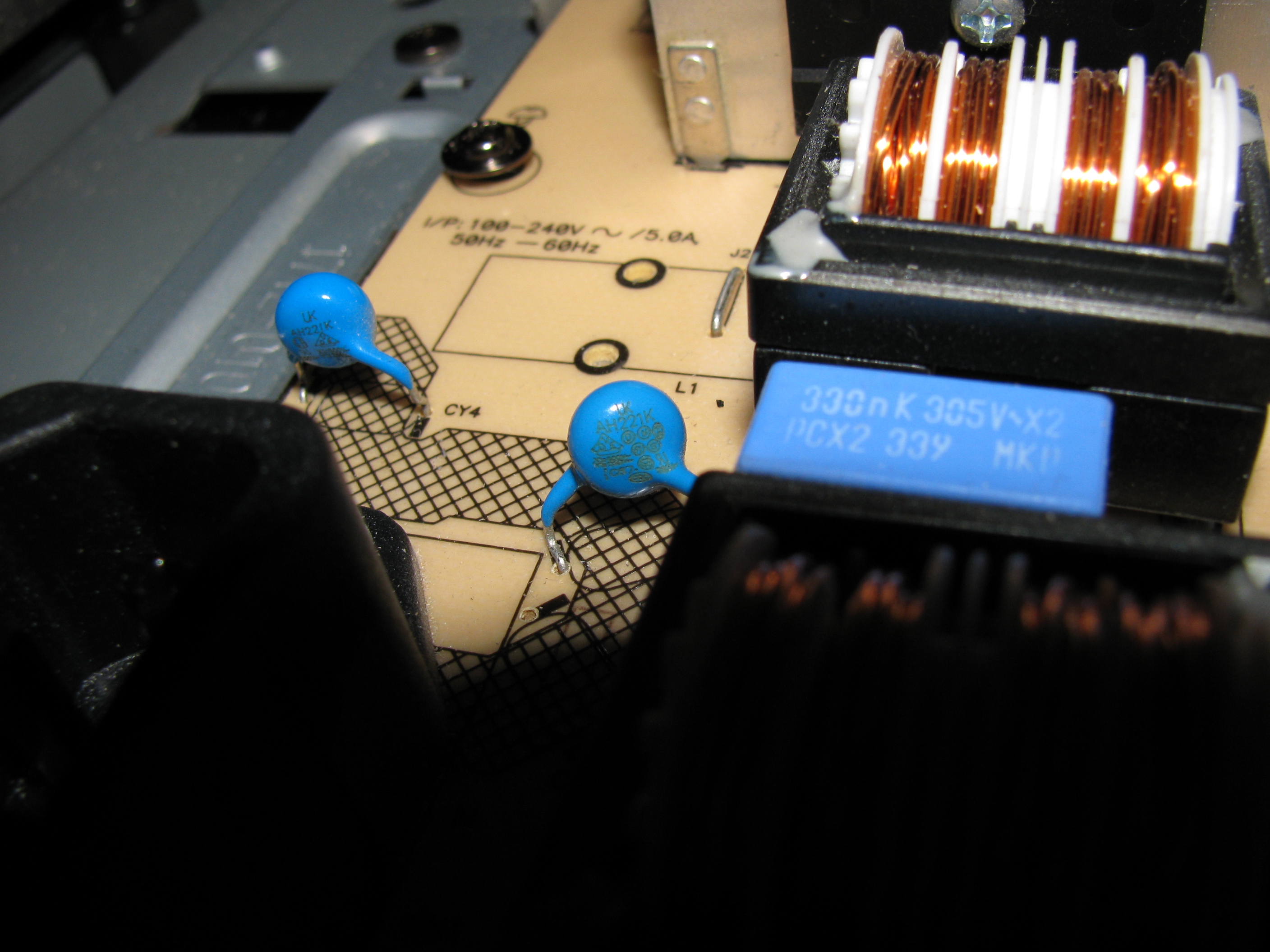

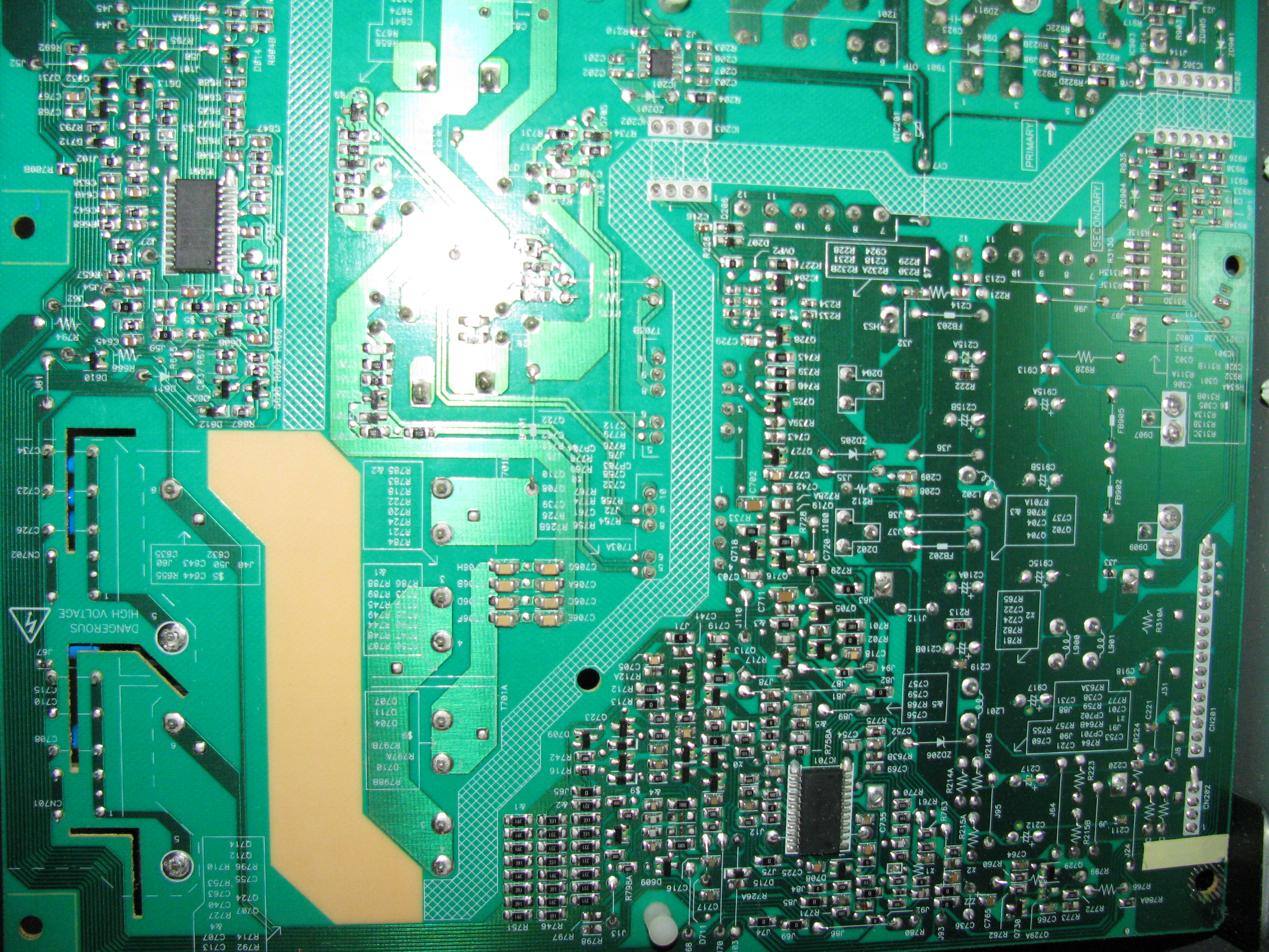

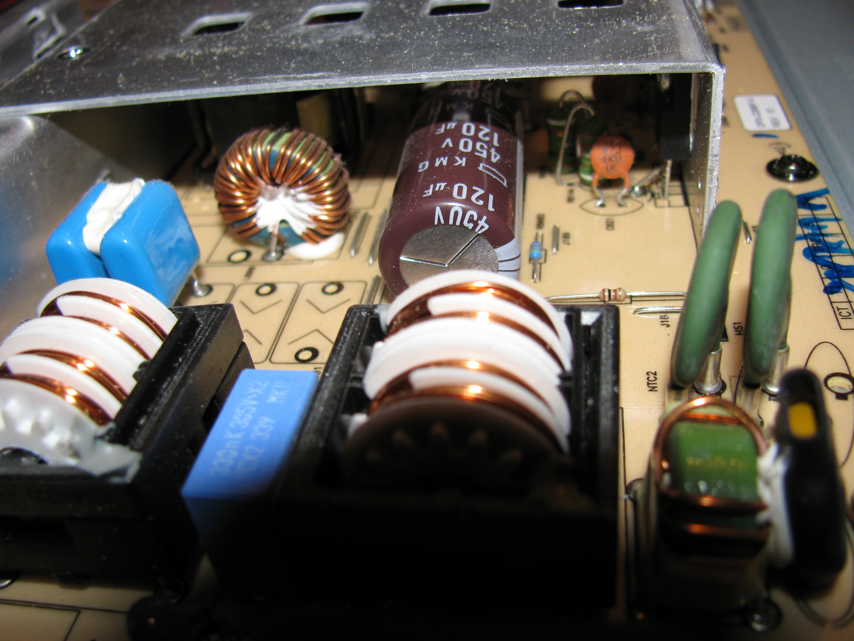

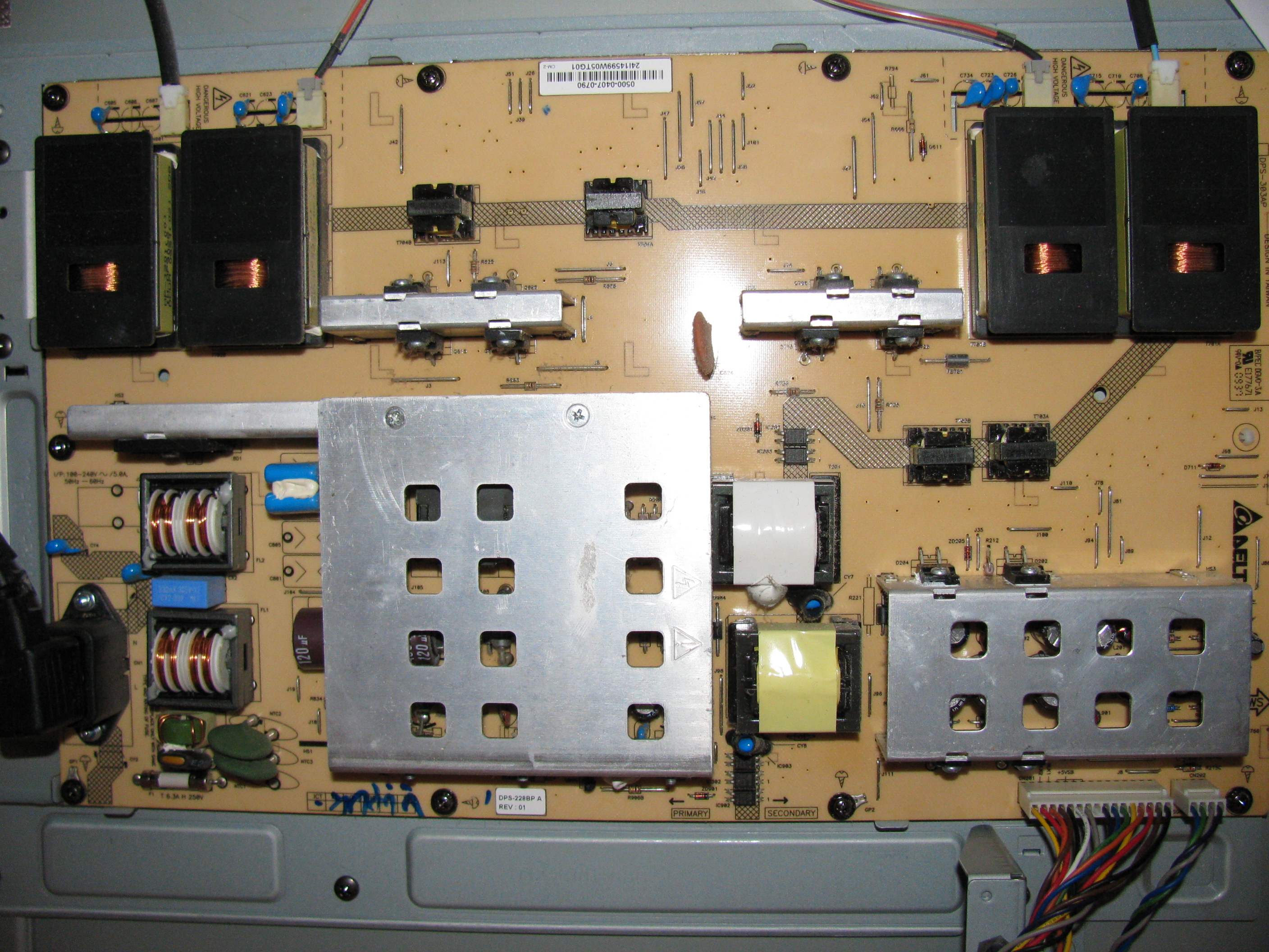

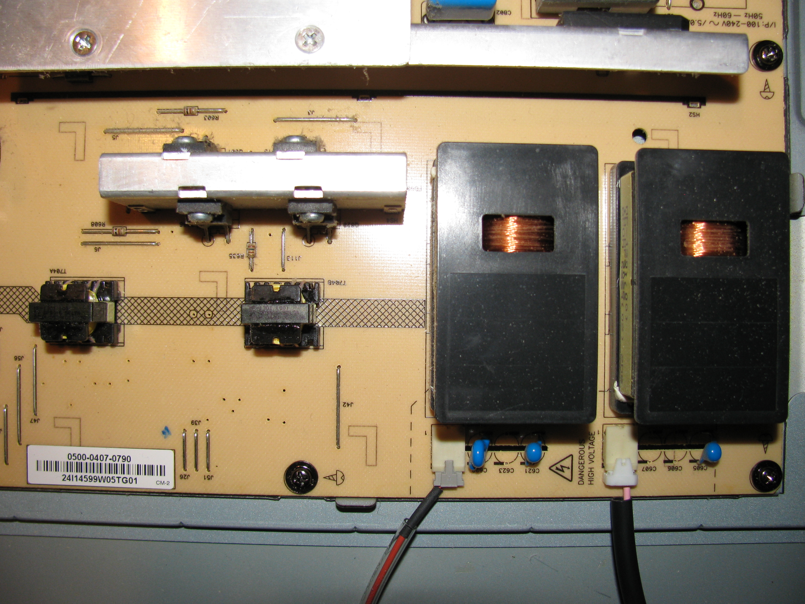

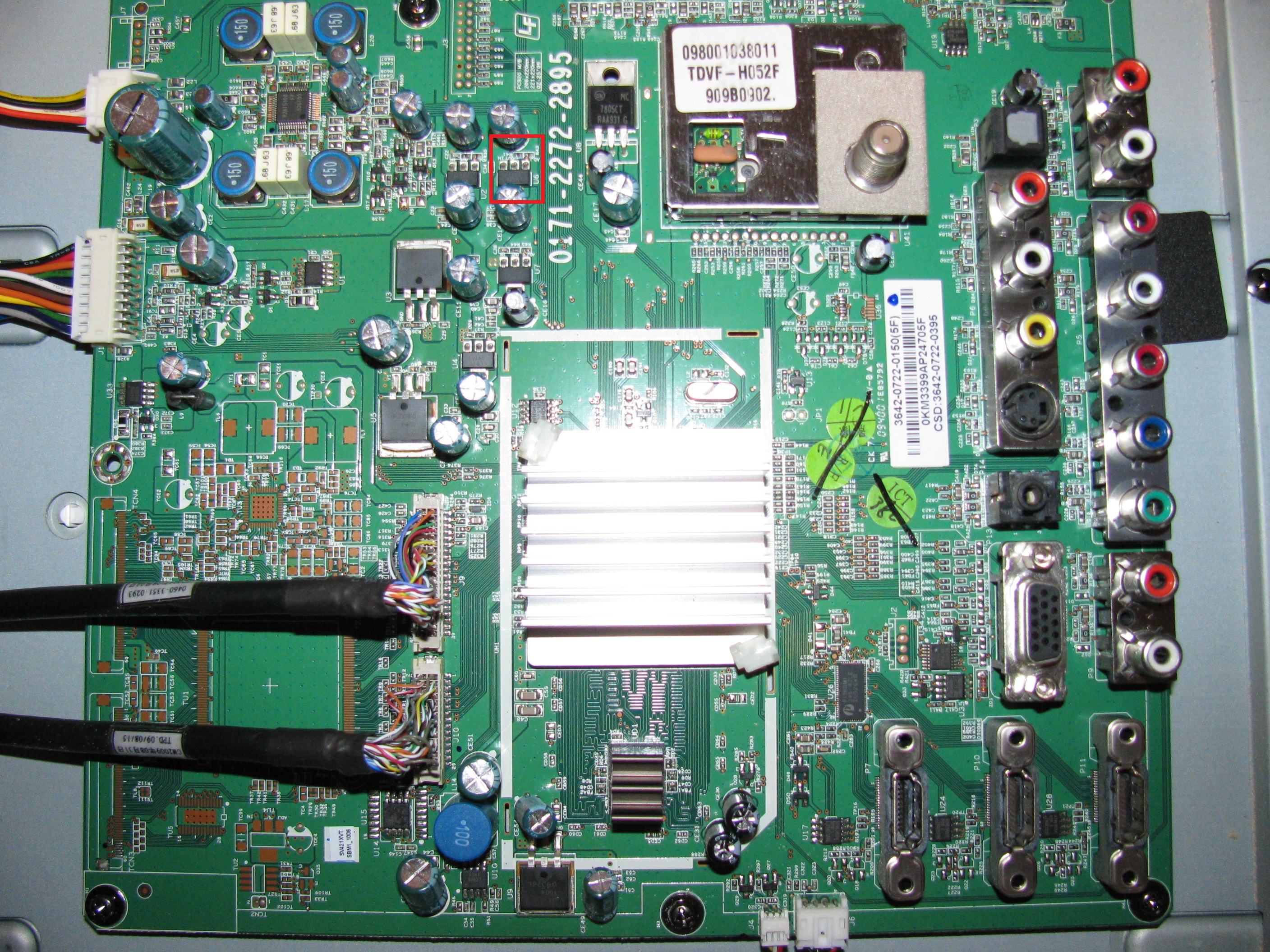

I have a 42" Vizio that stopped working, it appears to be common from what i have been reading. I have read alot of threads on here concerning these boards. There is a wealth of information and knowledge. I havent found out what my issue is as i am limited when it comes to component level troubleshooting. I have a desire to learn and appreciate the wisdom from the members hear! I have included photo's and the troubleshooting diagram from the service manual I followed. The Vizio emblem is yellow in standby and white when powered on. I am hoping someone here can help me get this tv working again. Here is what i have discovered so far.

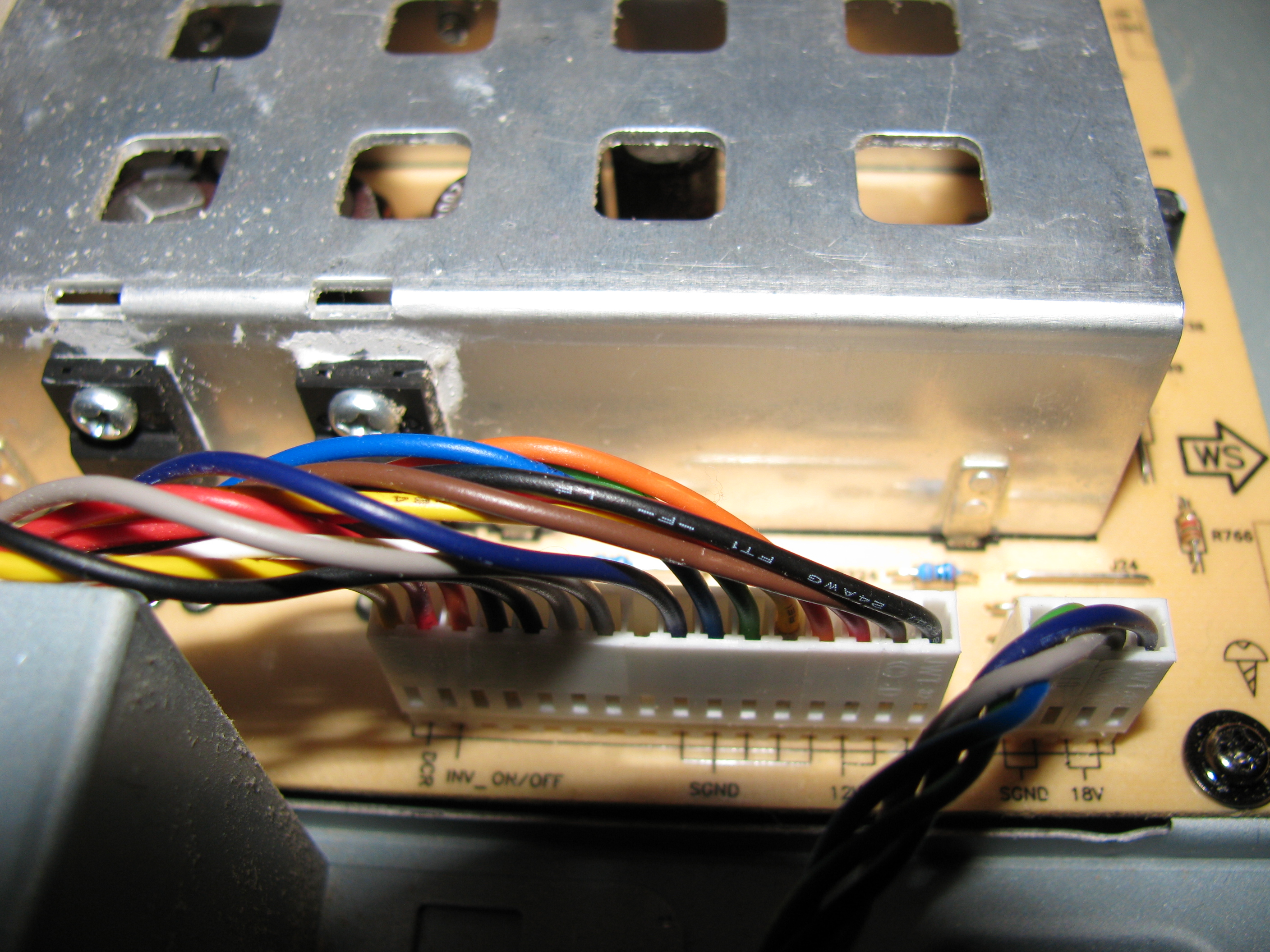

I have tried to disconnect the Tboard and inverter cables then powered it up to see if the power supply or Mainboard would give me any other readings and it doesnt. There is no voltage going to the Tboard that i can see.
Hoping someone will have some wisdom to pass on.

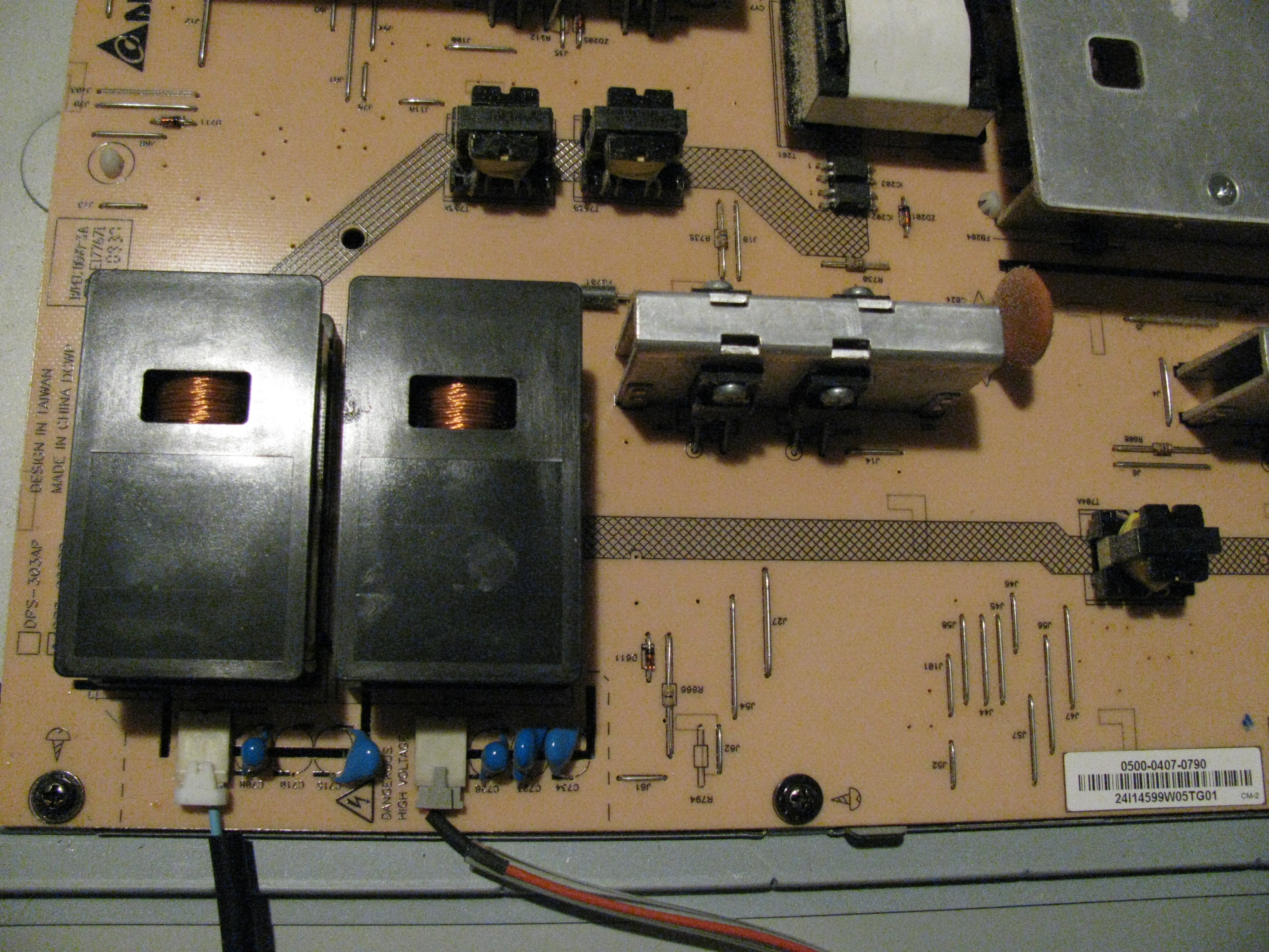

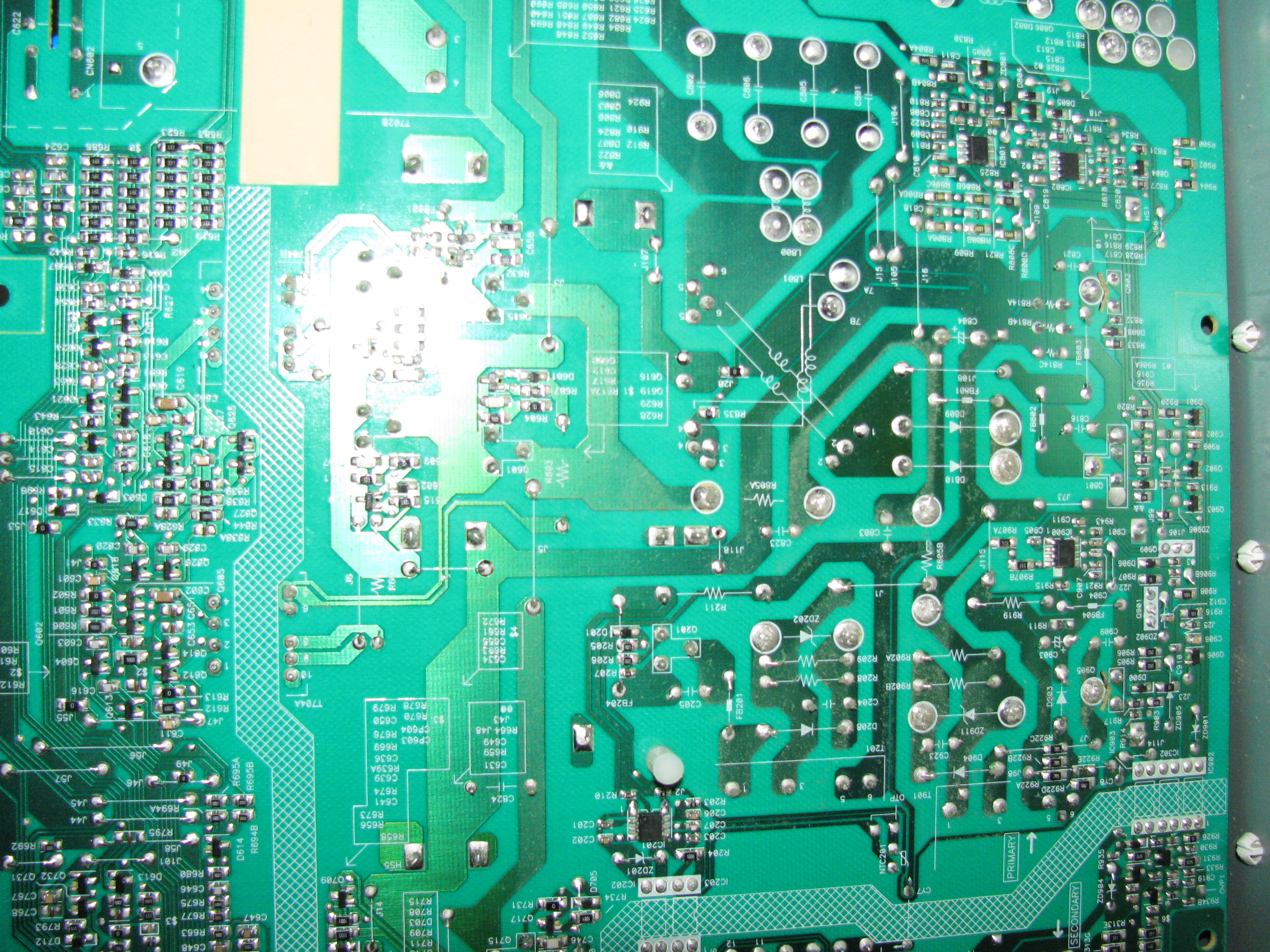

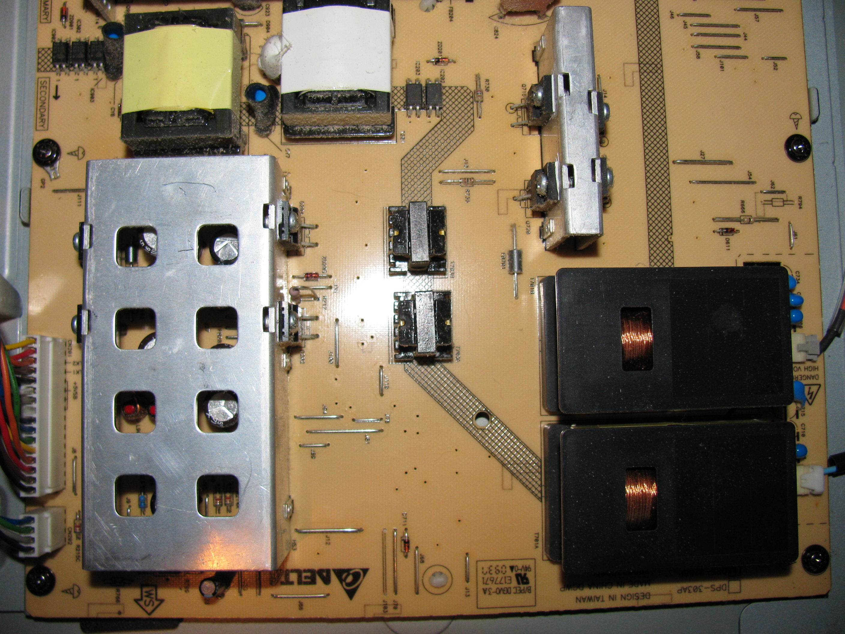

- went through list on troubleshooting sheet
- 5v standby appears to be good
- No 12v (seems to be controlled by the mainboard from reading other threads)
- Every other voltage measurement meets the troubleshooting guide until U6 Nothing there
- U10 looks to be correct as well (if i am counting the pins correctly)
- Didnt find any bad fuses that i could see (continuity test)
- The fuse to the left of PS_ON has no power but checks to be good
- PS_ON with the unit powered on is 2.25v
- INV_ON/OFF with the unit powered on is 3.25
I am unsure of where to go from here, any ideas?
