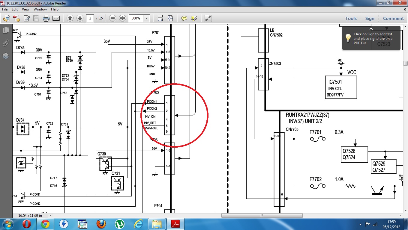

          Re: Sharp Aquos LC-32GD8E
          what voltage should blon be? tried jumping all 3 coz they are next to each other with the same 3.3v but relay clicked off.
            Hmm, that is strange, but try using a 1kohm resistor instead between 3.3V and BLON/INV ON.
            If that does not work you will have to break out the wire from the inverter and feed 3.3V in that way.

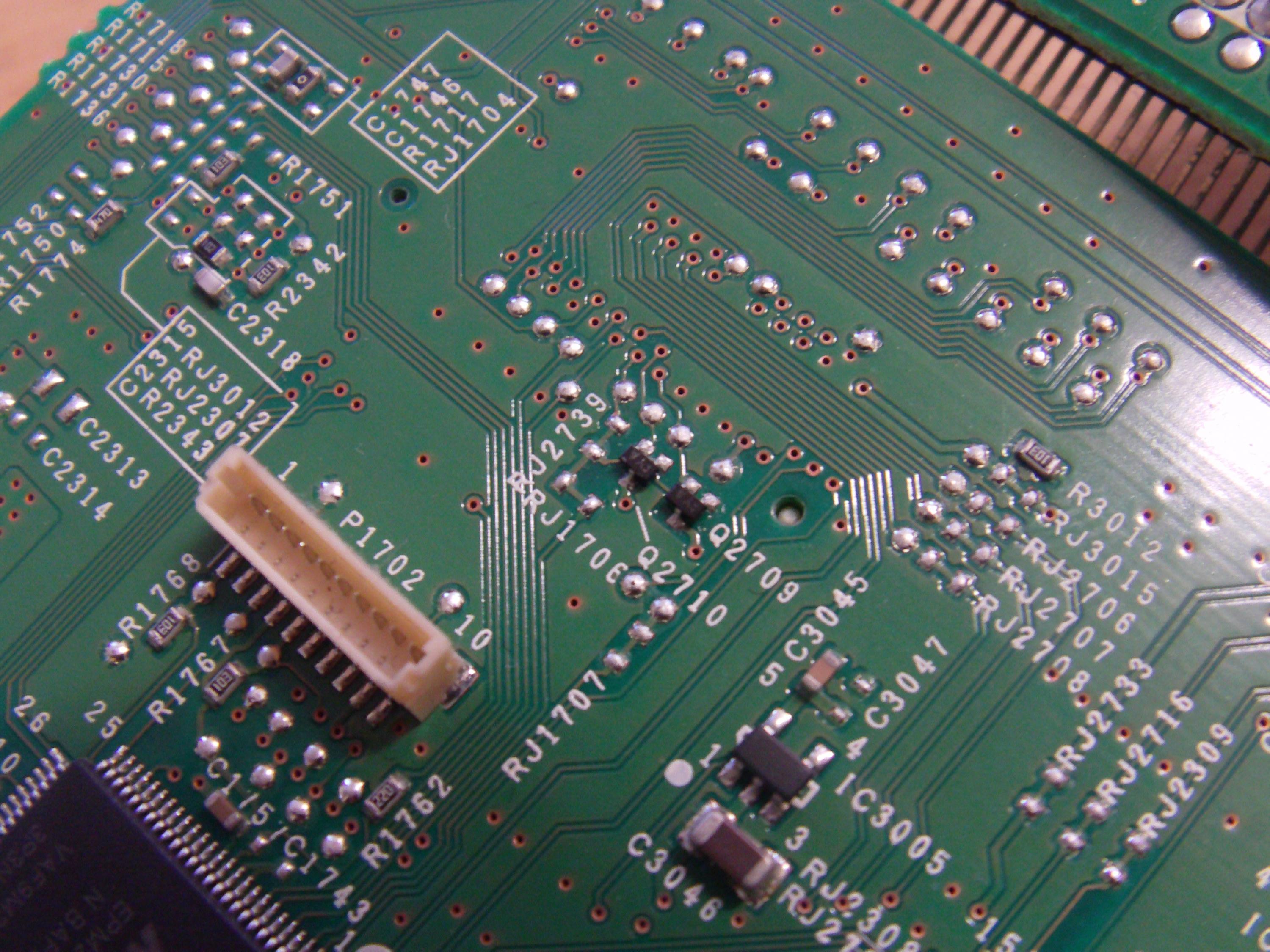

              Can i use the 3.3v from a pc psu to do this or should i carry on using a 3.3v source from the tv mainboard?
              Would the inv_brt be jumped too? I am guessing this controls the brightness.
              Thanks Tom.
              EDIT,
              Woops, just noticed that BLON is actually pin 4, and not 3. Pic included.

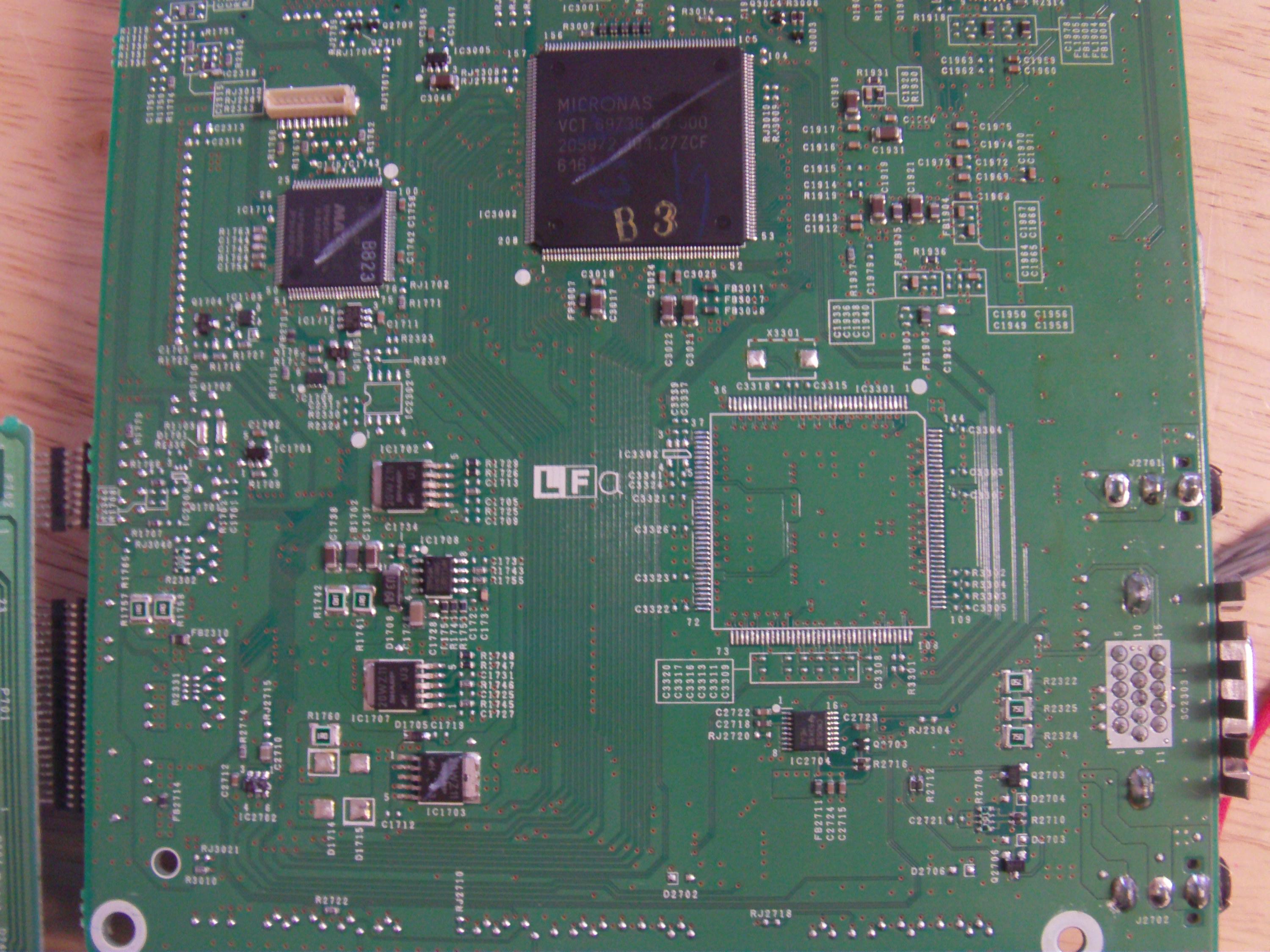

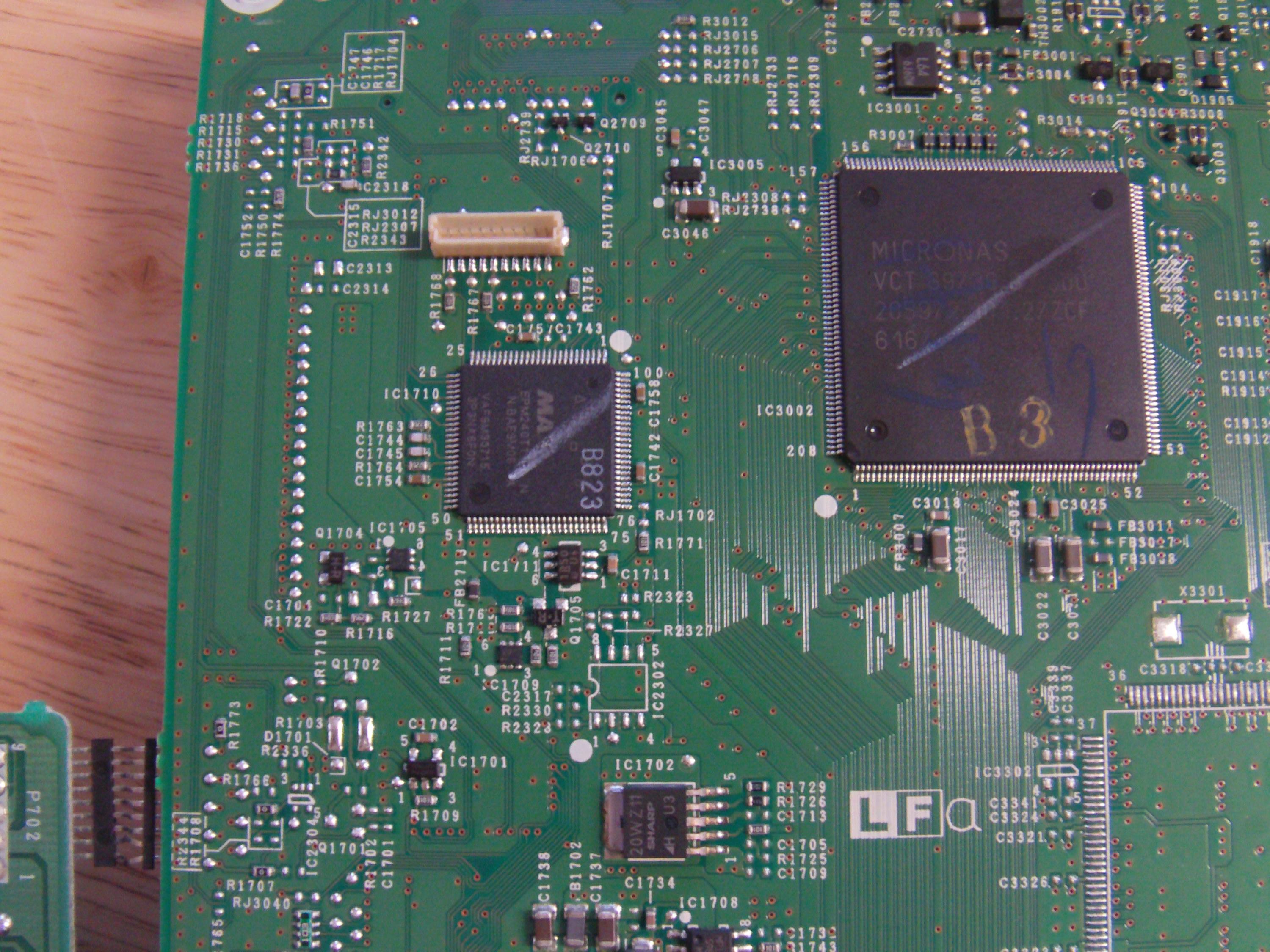

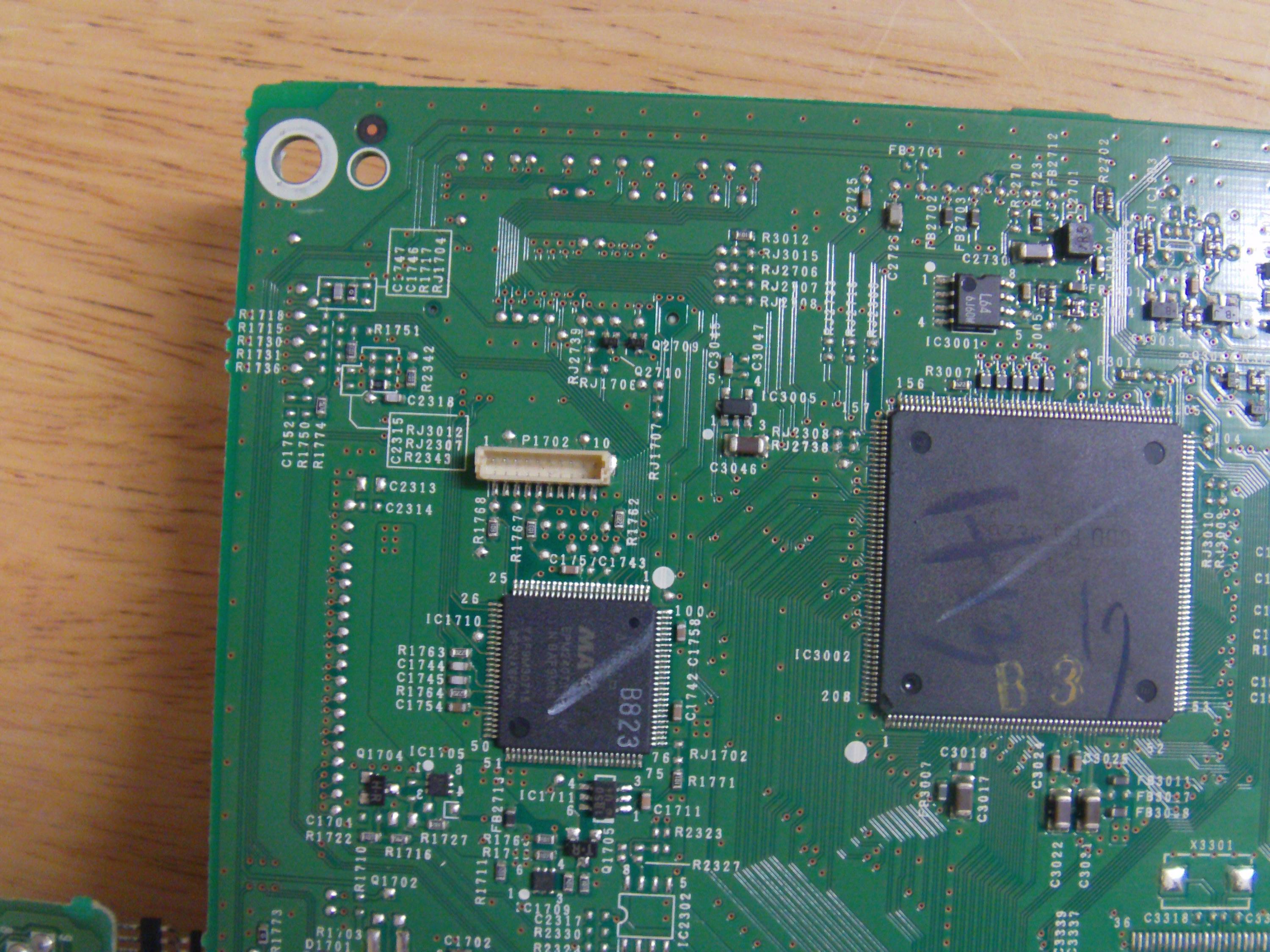

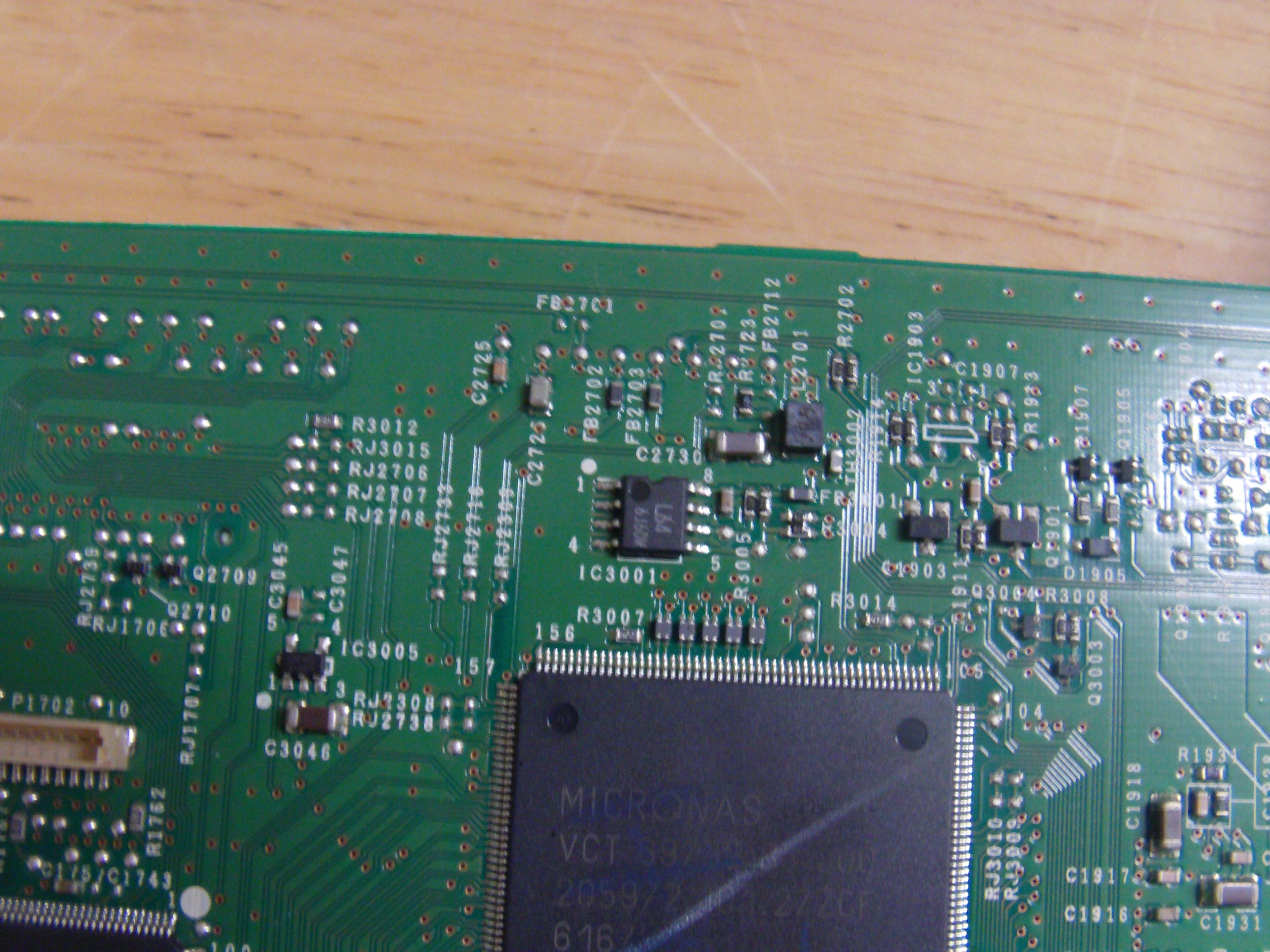

                  I have got the screen to come on by jumping pcon1, pcon2, inv_on and inv_brt, all whilst connected to the main board. The screen lit up but had lines down it, they started from about halfway down the screen then to the bottom of the screen, dont think it it tab bond issue as it wasnt all the way down the screen.
                  Here is some pics of the mainboard, in the service manual it says BU5V goes to 2 voltage regs, a 3.3v and 1.8v reg but i cant find them to test them?
                    Sounds more like a T-con not getting proper power or main board crashing -- may be quite normal... I have seen weird patterns before when getting screen to light up with main board dead.
                      Can you spot any voltage regs to test Tom? Or point me in a direction to test something.
                      I dont like to give up on things

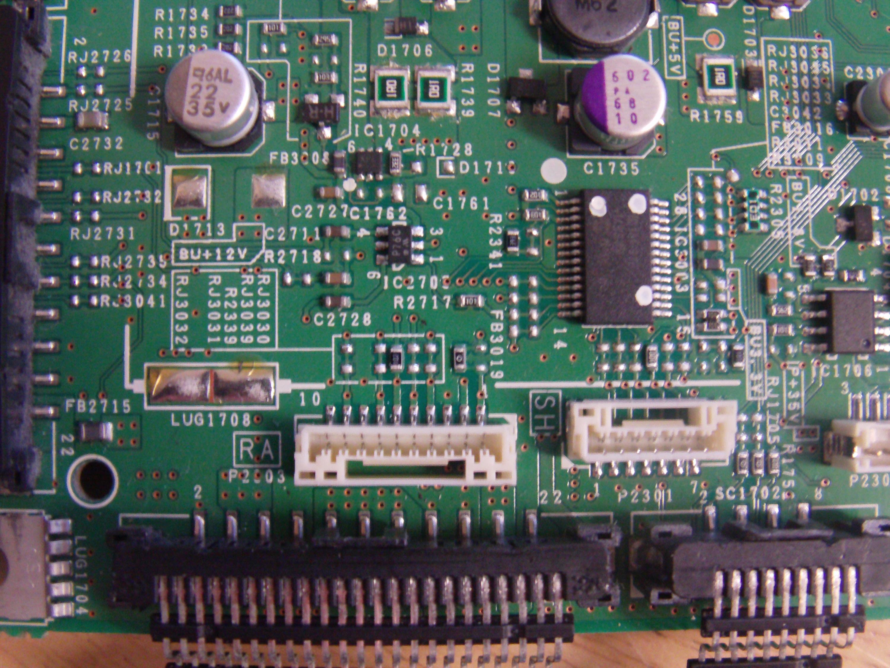

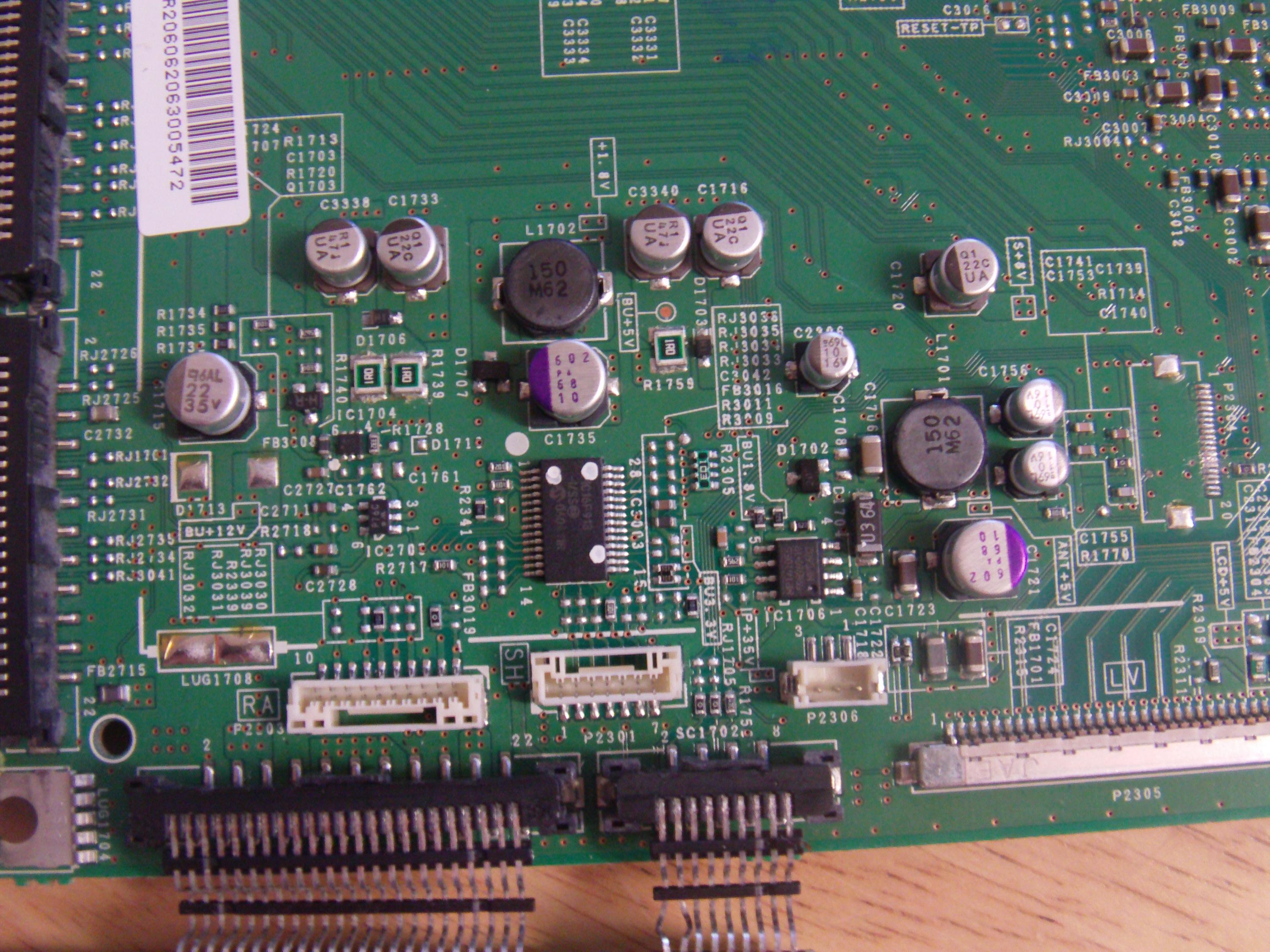

                        The 5 pin plus tab devices in this pic are all regulators.
                        https://www.badcaps.net/forum/attach...0&d=1354726268
                        I have never seen a bad Sharp regulator, but I would not rule it out.
                          How do i test them, one has 3.3v on the tab, but the other 2 have 0v
                          2 have 5.2v on pin 1 and the 3rd one has 15.6v on pin 1.

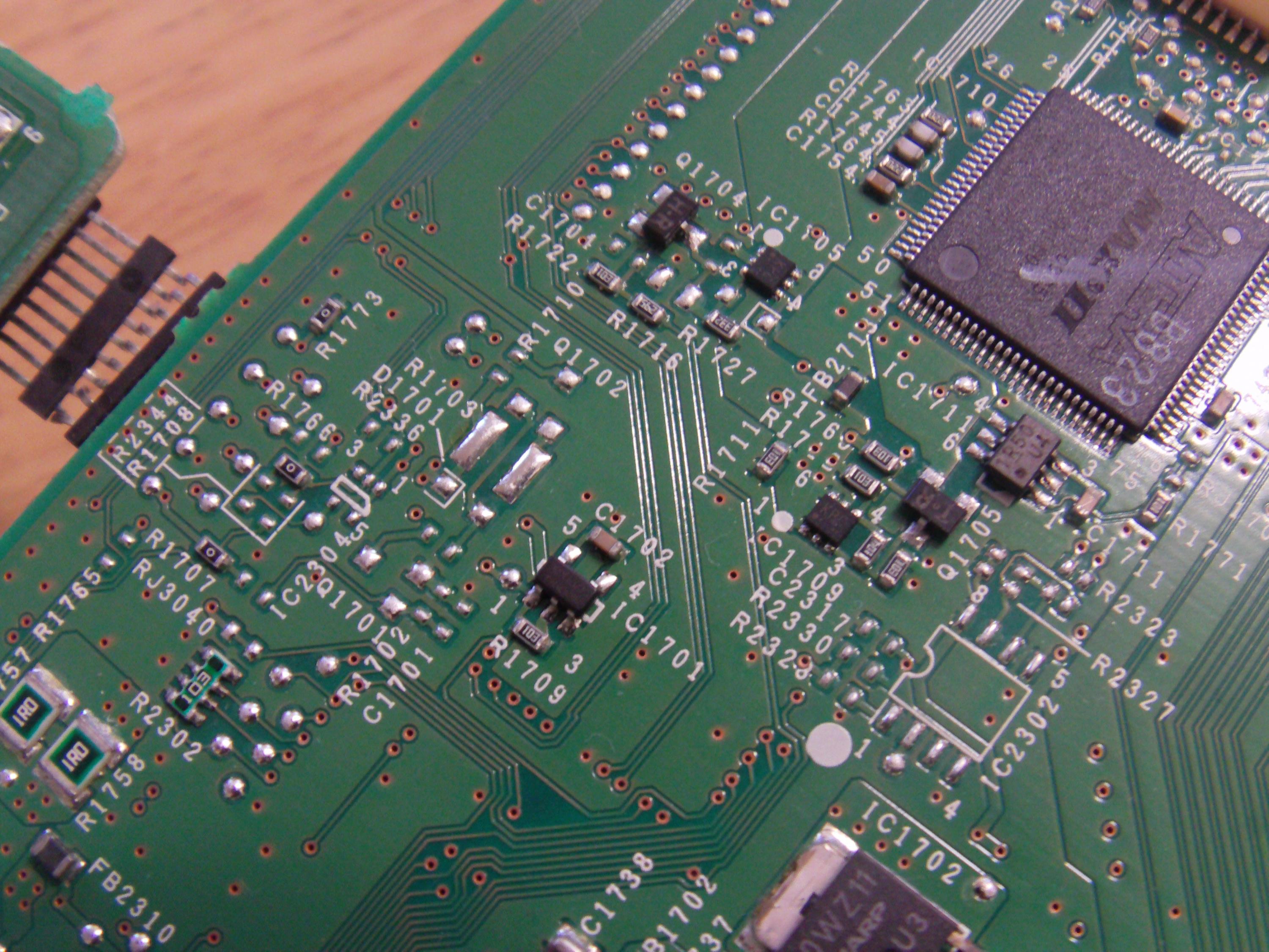

                              I cant use chassis ground as regs are on the underside of the mainboard, i used the screw hole on the hdmi instead.
                              Datasheet http://pdf1.alldatasheet.com/datashe...0WZ11J00H.html
                              Reg 1 (ic1702) Tab at top,
                              pin 1 = 5.14v
                              pin 2 = 3.71v
                              pin 3 = 3.29v
                              pin 4 = 2.62v
                              pin 5 = 0.00v
                              Reg 2 (ic1707) Tab at top,
                              pin 1 = 5.23v
                              pin 2 = 0.00v
                              pin 3 = 0.00v
                              pin 4 = 0.00v
                              pin 5 = 0.00v
                              reg 3 (ic1703) Tab at top,
                              pin 1 = 15.67v
                              pin 2 = 0.00v
                              pin 3 = 0.00v
                              pin 4 = 0.00v
                              pin 5 = 0.00v
                              Also there is a 5 pin smd too, it is marked with ZG6F35, google doesnt help with that one.
                              I will give readings anyway,
                              Location, ic1701
                              pin 1 = 3.73v
                              pin 2 = 5.19v
                              pin 3 = 0.00v
                              pin 4 = 0.00v
                              pin 5 = starts off at 1.70v ish then quickly drops to 0.46v, it does that every I i touch it with the probe, its like the probe is putting a drain on it?
                                OK, thanks for readings.
                                Pin #1 is input.
                                Pin #2 is enable control for output (>2V, output on)
                                Pin #3 is output.
                                Pin #4 is adjustment terminal (should be 2.64V, relative to GROUND)
                                Pin #5 is ground.
                                pin 1 = 5.14v
                                pin 2 = 3.71v
                                pin 3 = 3.29v
                                pin 4 = 2.62v
                                pin 5 = 0.00v
                                Working: Output is enabled, 3.3V out, with adjustment at ~2.64V.
                                pin 1 = 5.23v
                                pin 2 = 0.00v
                                pin 3 = 0.00v
                                pin 4 = 0.00v
                                pin 5 = 0.00v
                                Working: Output is disabled.
                                pin 1 = 15.67v
                                pin 2 = 0.00v
                                pin 3 = 0.00v
                                pin 4 = 0.00v
                                pin 5 = 0.00v
                                For other regulator, the readings seem odd. Picture?
                                  Ok, thank you.
                                  Here is pic. Not sure what it is so gave readings anyway.
                                  What is it that tells the regs to switch on?
                                  Can i switch them on by jumping or will that kill something.
                                    When i jump the blon/pcon 1 &2 the other regs start working. ic1707 gives 3.3v on the outpu, and ic1703 gives 8.00v on the output.
                                    Is there a way to reset the bios chip? (Not bios but you no what i mean).
                                    There is 2 solder points on the mainboard too that say "TP RESET" but this does nothing.
                                      Probably not a regulator.
                                      I think firmware may be corrupt, no reset will cure that. The "I2C" method may be necessary...
