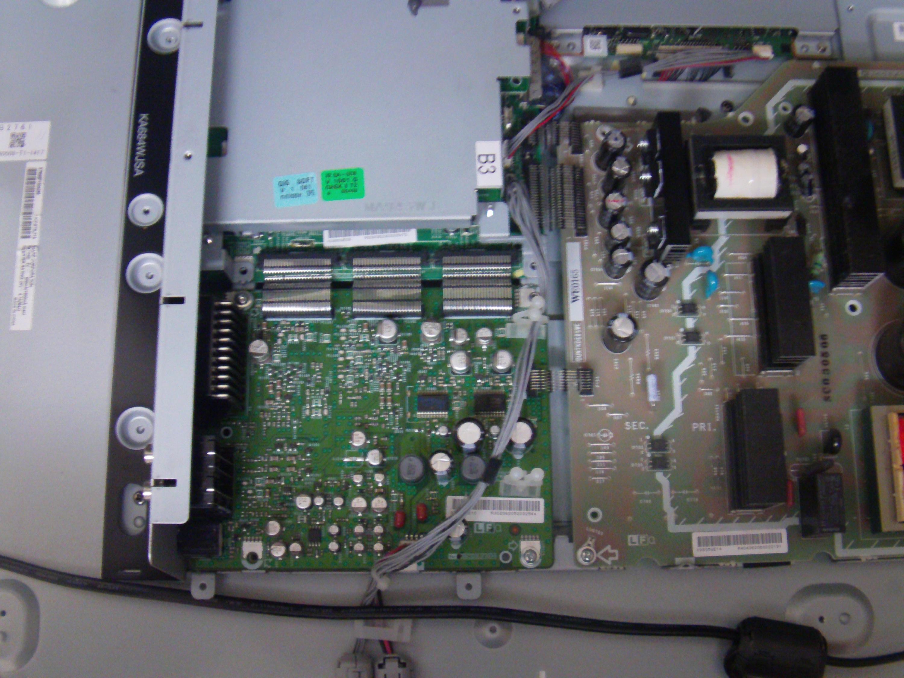

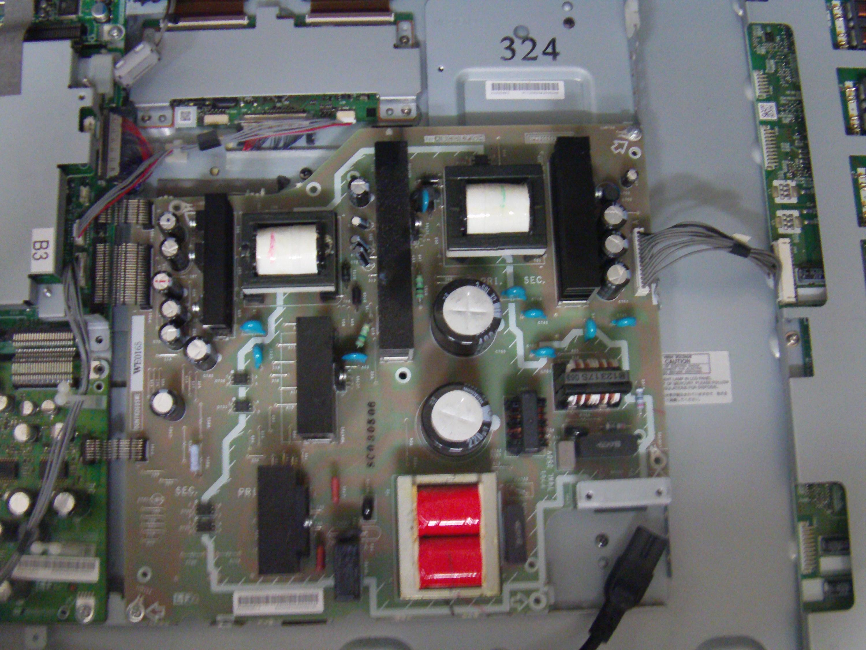

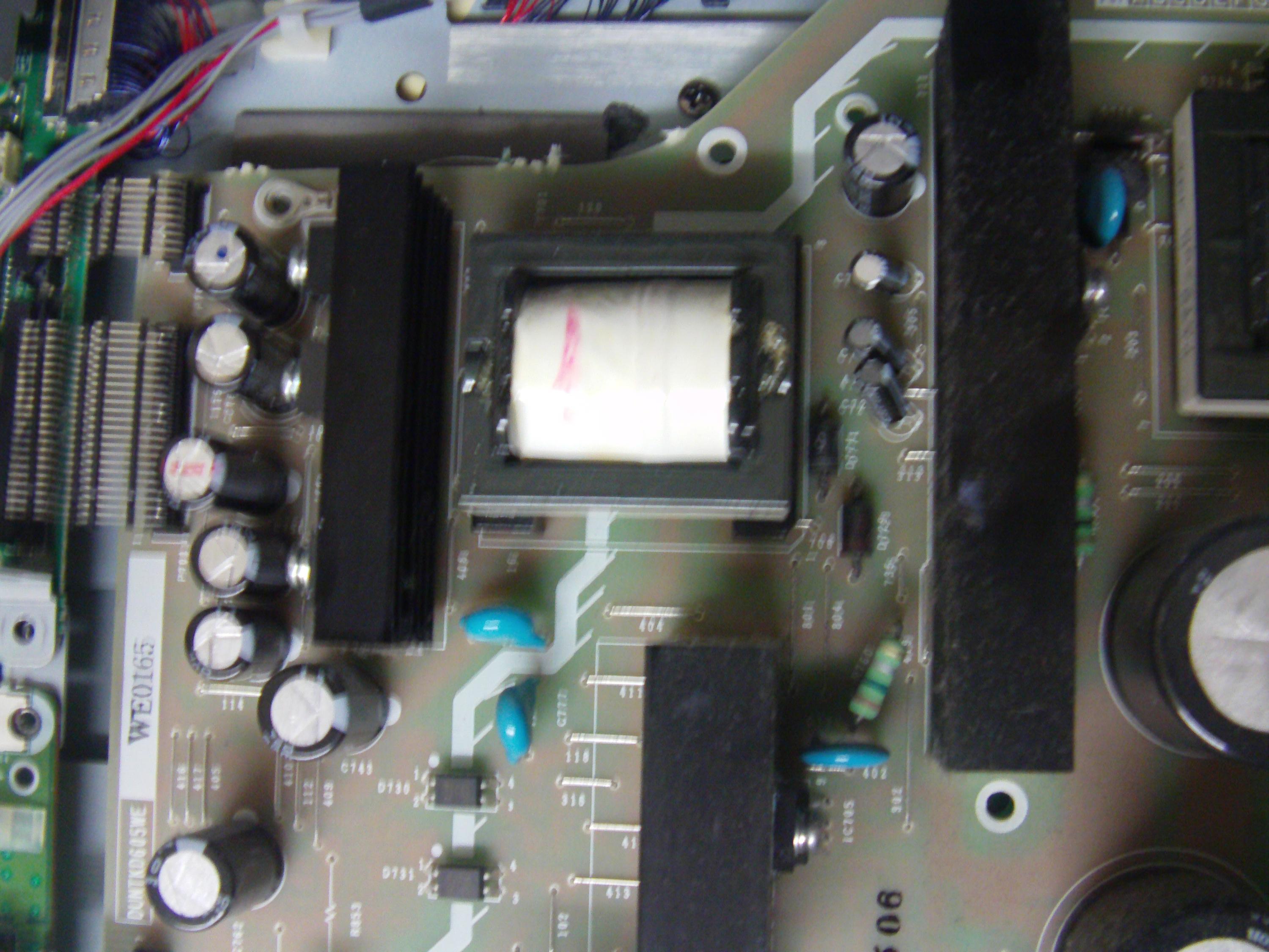

    Just bought this from ebay.
    Its a Sharp Aquos LC-32GD8E.
    Guy said it wont come on but has standby light, but there is no lights at all, when i plug it in 3 lights flicker on the front of the tv, they flicker once and very fast.

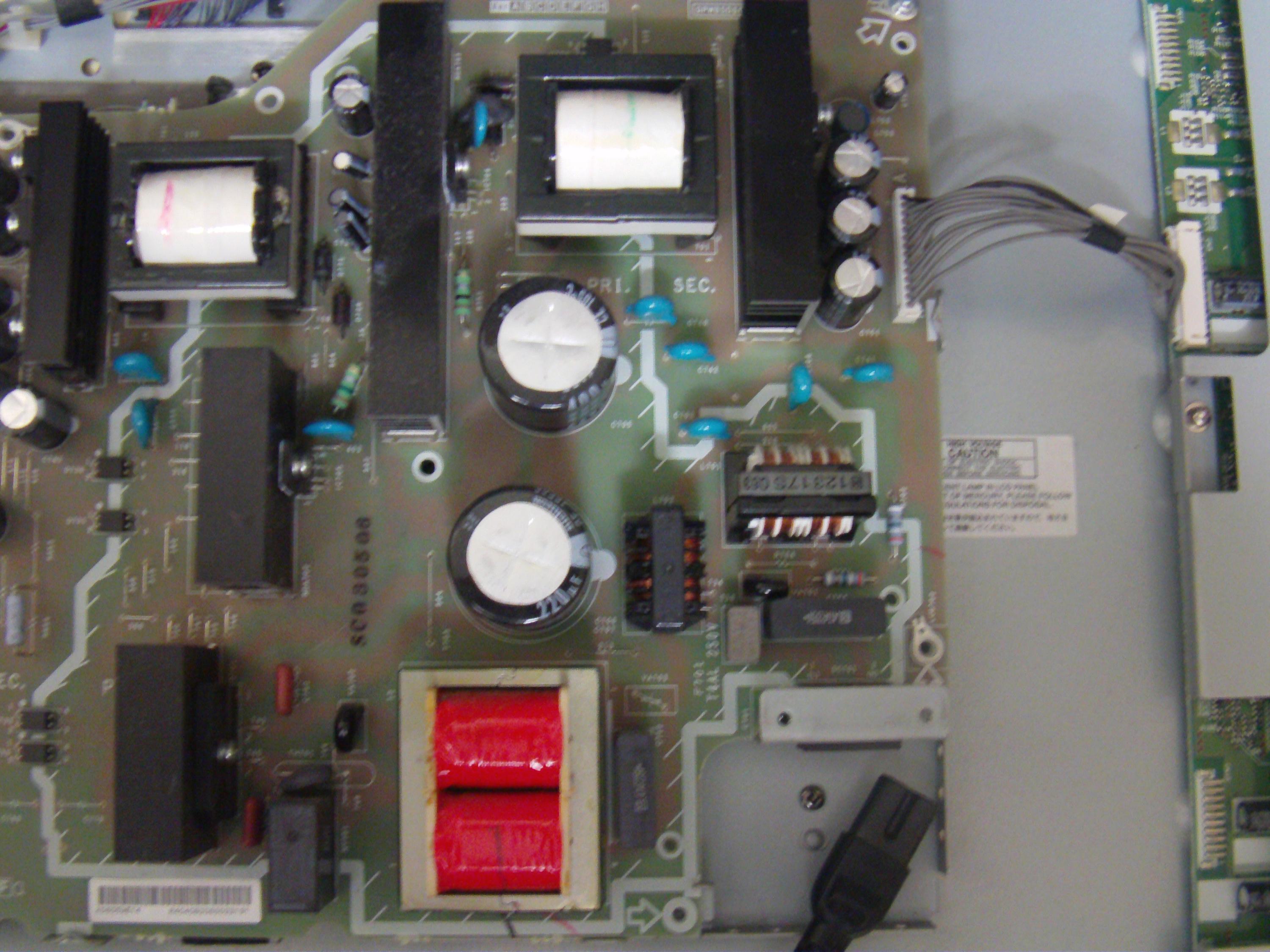

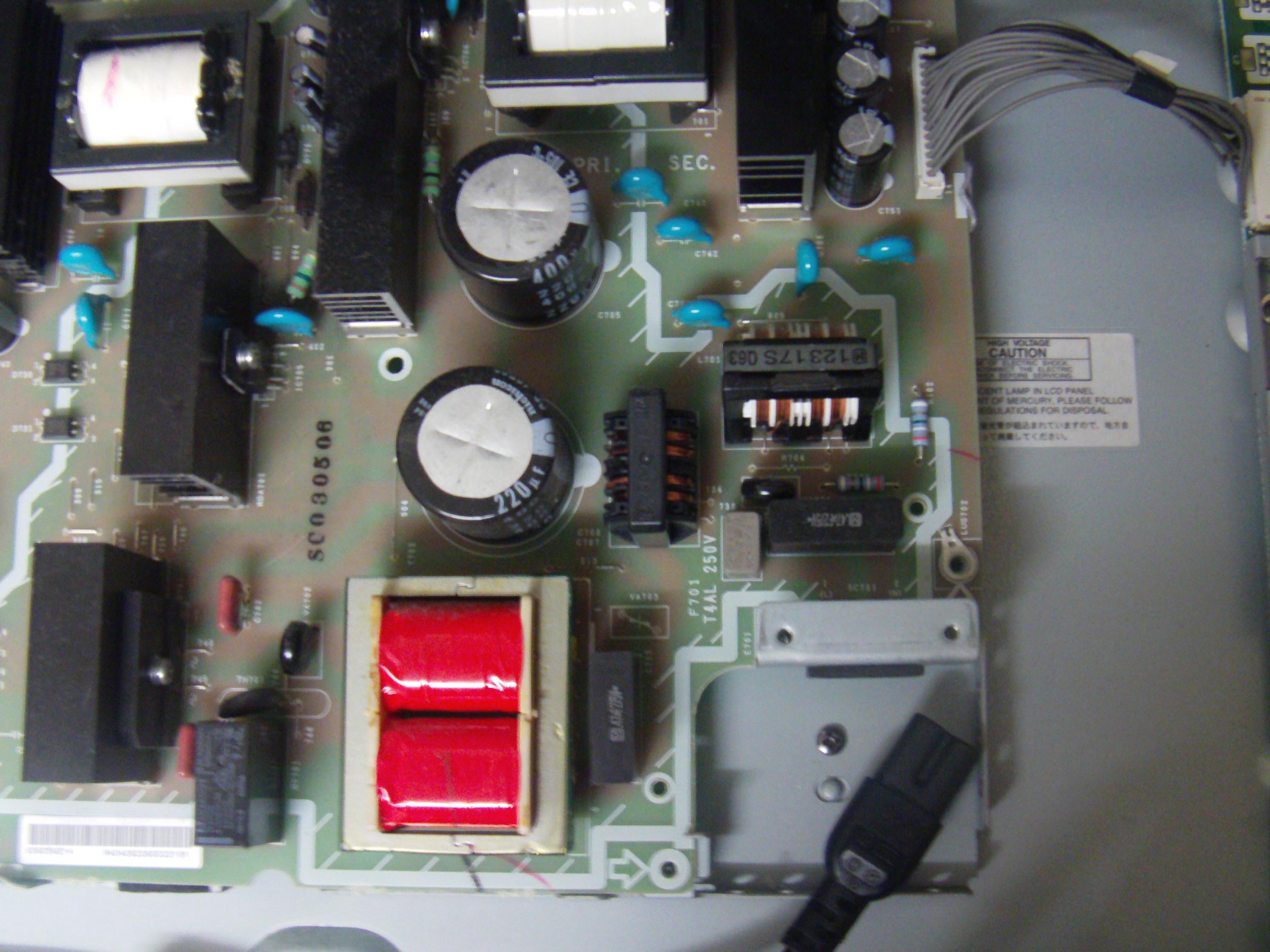

    The psu is a DUNTKD605FM14, all rubys apart from the 2 main filter caps which are Nichicons.
    I get all the correct voltages on the psu apart from the 24v inverter power.
    Attached is the schematics for the hole tv, page 5 is the psu.
    Any help would be great.
    PS, the way the boards are connected together is stupid.

          Is there anything i can check on the mainboard? The relay on the psu doesnt click either, but tested with a 9v battery and the relay works.
          Sugar, forgot to add pics to first post.

            Re: Sharp Aquos LC-32GD8E
            Yep I seen this PSU before.
            Count the blinks when the power is pressed. OPC will blink as will power. This gives you an error code. e.g. 2-5 might be backlight control.
                    It would appear it uses two signals, PCON1 and PCON2. I note it has a separate 24V power supply, so the PCON signals probably control the individual supplies. Check if they change when power button is pressed. PCONs are on the 2nd largest connector going to the main board assy.
                        Any change is good, if they are zero to 3V, or 3V to zero, but the PSU doesn't come up, suspect PSU.

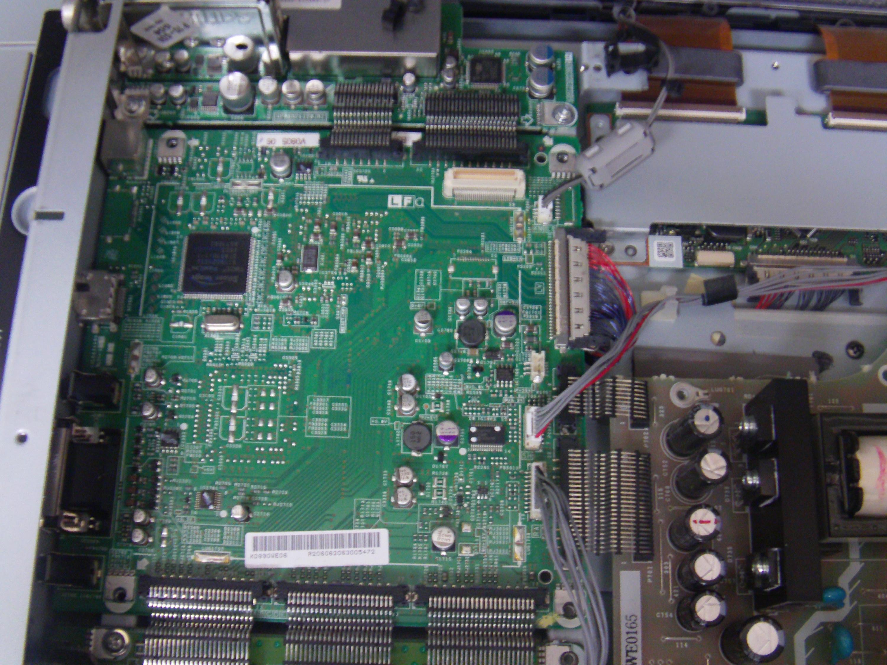

                            It tells us the main board is pulling them low... time to look at the main board.

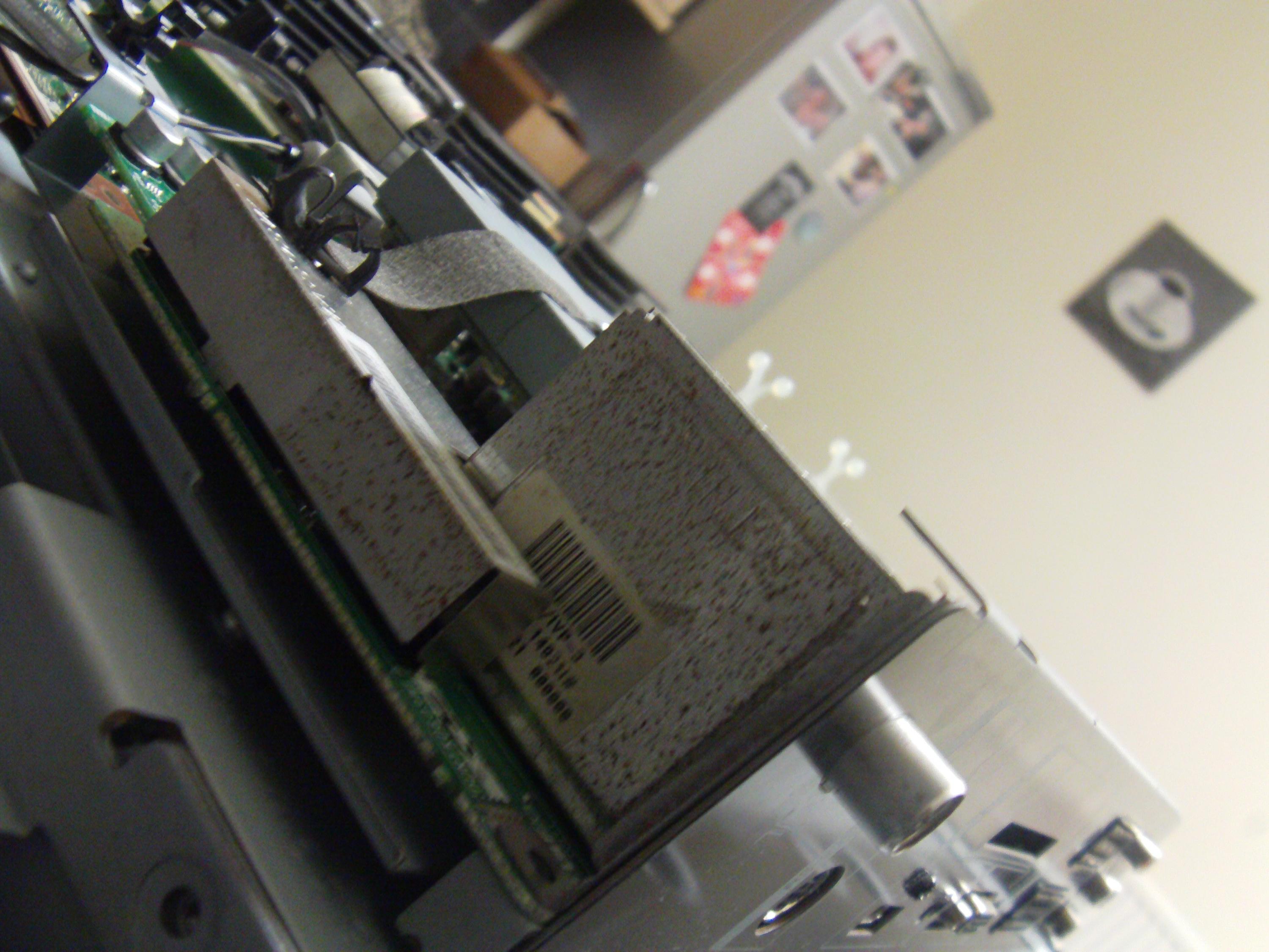

                            • gilly1984
                              • Jun 2012
                              • 751

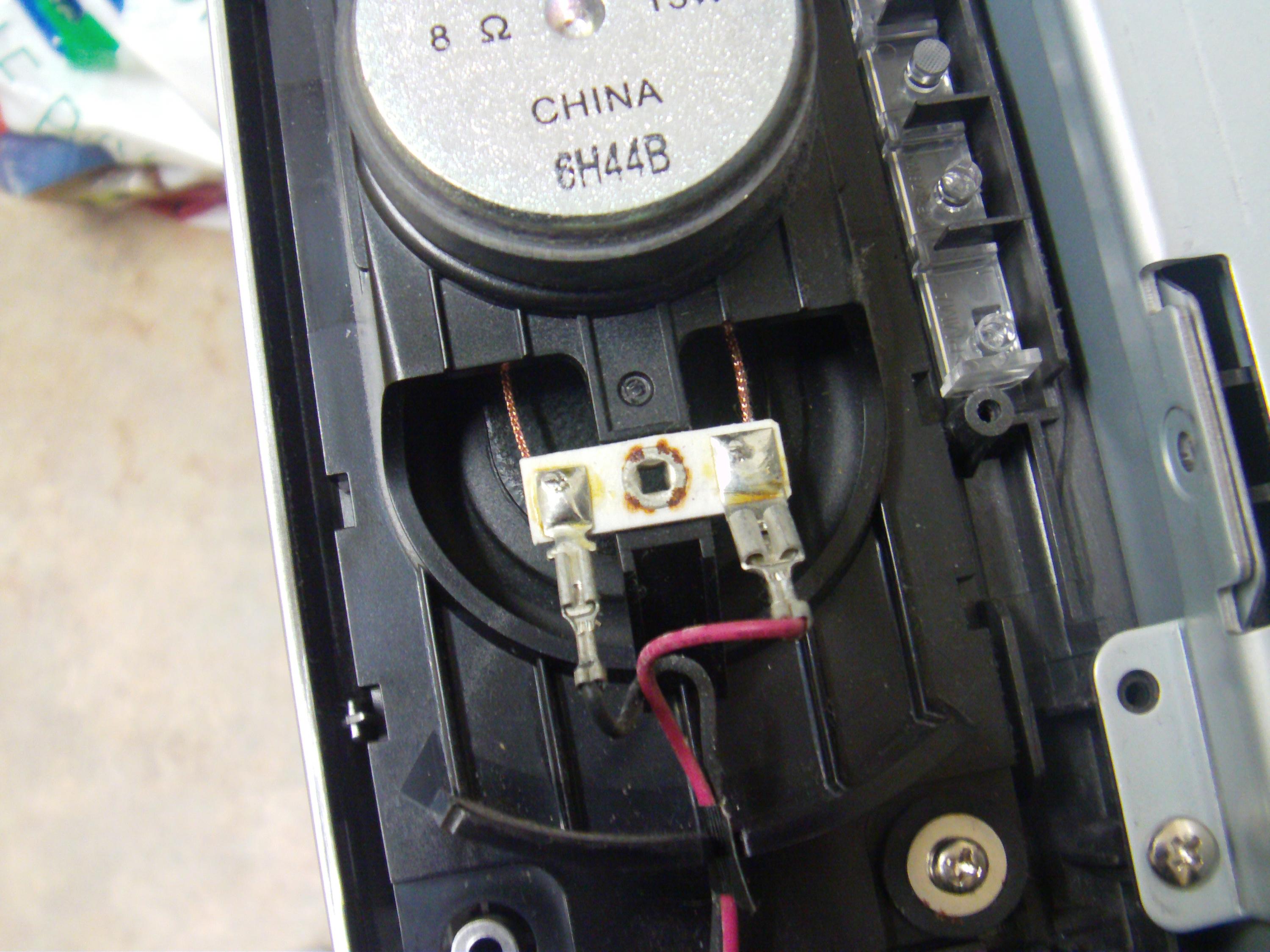

                              Is this a bad sign?
                              I see no corrosion anywhere on the boards.
                              Do NOT touch heatsinks when testing for voltages as they may be LIVE!
                              • gilly1984
                                • Jun 2012
                                • 751
                                Ok, what should i check first?
                                  1st is flux, normal.
                                  2nd is rust, probably been in someone's garage after it failed.
                                  Follow this guide, you will need to make/buy a cable:
