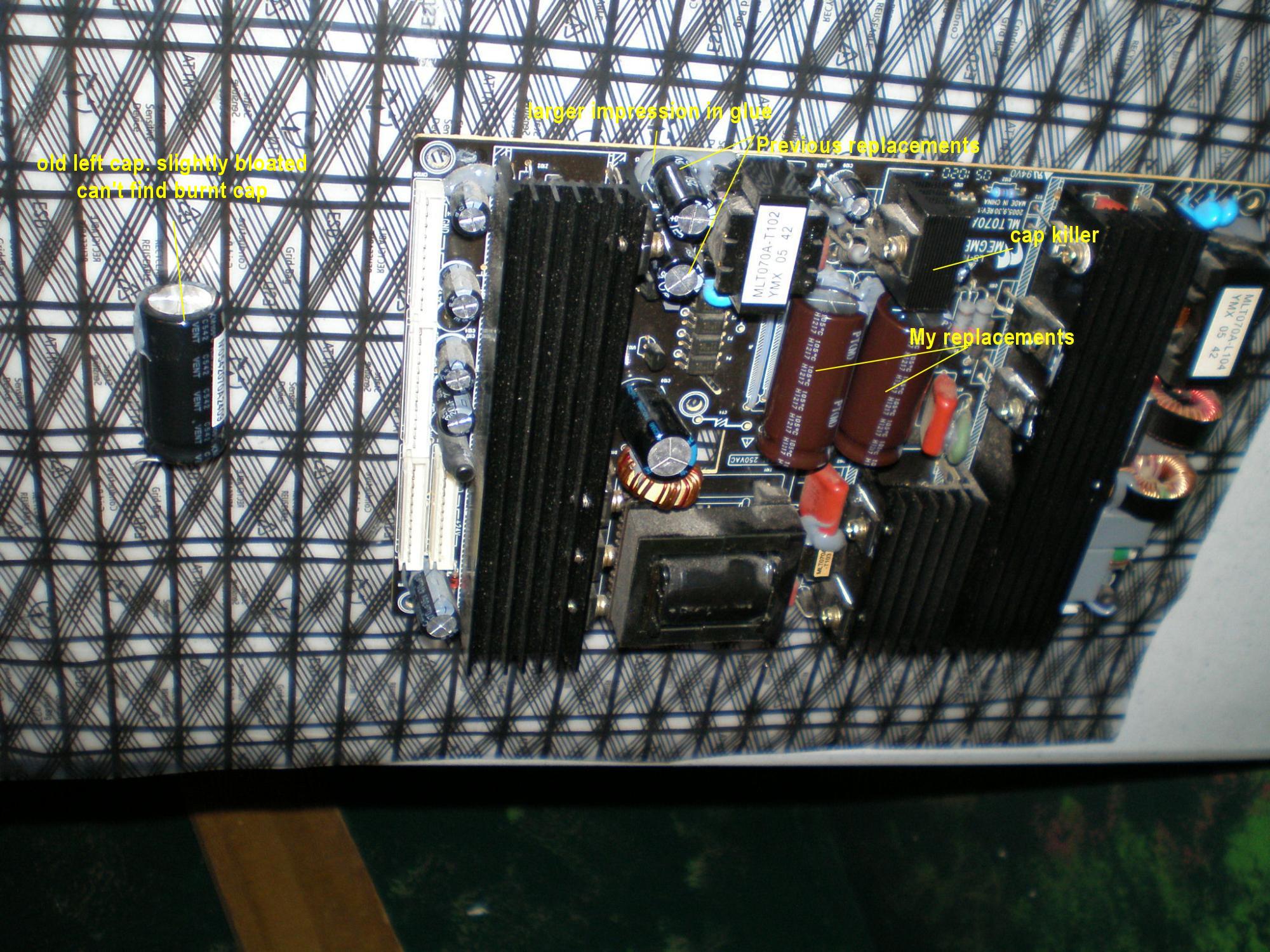

    had to get longer caps for a tv power board. possibly problematic.
    hey guys I got this ILO TV to recap. Already recapped once a year ago by someone else, but judging by the glue around two smaller caps, those two smaller ones were it, also I saw some flux near them.
    It had a barely bloated 450/100, and a second 450/100 that was actually kind of burned ontop. It was close to a mosfet heatsink, and when I started to get it unglued, one of the legs literally fell of without much pushing. I looked and the hole had brown dried up lytic shit that somehow, weakened the leg, or eroded the leg. Mouser was out of any 35mm replacements (unless i wanted to wait till 1/22/13) so I had to get a 40mm. Its still close. any idea of how I can help insulate the top?

      You can use some electrical tape as insulator, or HV insulating glue.
        Re: had to get longer caps for a tv power board. possibly problematic.
        What do you have around in your house? Any Silicone adhesive?

          I don't believe so. I have hot glue. Can I put a big dab of hot glue ontop of the cap? to help deflect heat? I'll search around next time i'm at frys
            Hot glue tends to break off, it is very brittle. You can try it, or you can deal with the fact that ~5mm requires approx 7kV to arc over in ~60% RH air, so it is unlikely to fail on a PSU dealing with 400V max.

              i'm not 100% on what you are talking about, but if you mean electric arc, thats not what i'm afraid of. I'm afraid of constant heat from the sink slowly heating up that cap, the cap top is literally about ~4-5mm from the sink, and when I say the old one was burnt, I mean from heat
                Then an insulator will make it worse.
                What kills caps is not so much external heat, but internal heat from ripple current. The original didn't fail due to the heat externally, but due to the excessive ripple from being undersized.
                A good cap will be fine.
                  Here is a technical document from Panasonic Industrial that gives useful information about ambient temperature effects on electrolytic caps. One important conclusion from this document is that ambient temperature and proximity to heat producing components are important considerations pertaining to the life expectancy of electrolytics. Use Techniques of Aluminum Electrolytic Capacitors
