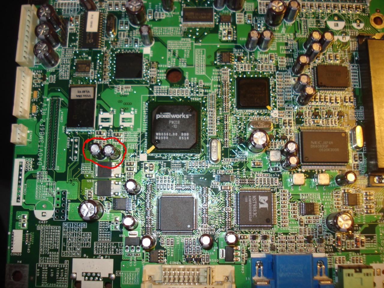

    Hello all i being searching every where to find info and this seems to be the place. Looking for a little help. I have recently aquired a Acer T.V. for free so i'm not out anything.It will, sometimes come out of standby and sometimes not. I have checked the power supply and the voltages seem to be in range and the backlight always turns on it just dosen't display anything. When it freezes the only way to reset is to use the switch on the back. I was wondering if there is any thing that i should be checking on the main board. I forgot to mention i check all caps in the power supply and seem to be in range with a meter out of circuit(rubycons). Look forward to your knowledgeful response.
    Re: Acer At3201w will power up sometimes
    The PSU uses Rubycons? Wow.
    Can you try re-seating the LVDS cable? This cable runs from the main board to the t-con board at the top of the screen.

      I have tried your suggestion but did not win. If you cycle it a couple of times the unit fires up and dosen't miss a beat. You can turn it off and on as much as you want and it always starts. It is once it sits for a while that it won't start up. It is so much easier to find things when there broke.

                        Did you try to change the two 100uf/16v "(in)famous" capacitors from the processor board?
                        Look at the picture.
                        P.S. I'm fighting with mine (it stays always in stand-by, orange LED on), i replaced and checked all parts according to forum tips. I can bring it up only with one resistor of 2K2 between 5V (std-by) and the power supply's stand-by controll pin.If i do that, LED come green, and TV works normal (with the resistor still connected) until i try to shut it down by remote or button panel.
                        Any ideea for me? I'l try to change the memory IC (24C32) to see what happen (first time empty and after with a dump from internet).
                        Thank you.

                          I came with news. I buyed a new control board (or that's i was told) from ebay and i get to another weird thing: when i power the TV from the power supply's switch for the first time it stays in the same status like before (orange led on, and the rest of the TV in stand-by, and with some audible whistle from the power supply like an lower frequency than normal). But, if i turn off and on again the power supply's switch, the TV work normally (no whistle from power supply and the TV can be turned on/off fine from remote) until i cut the power for longer time.
                          It is an improvement from previous state, but it is still frustrating that it isn't working good.
                          What do you think? It looks to me like an bad power-on-reset or something. Can i suspect the controll board again, or the power supply (i checked the voltages, changed the electrolythic capacitors, and resoldered in some parts on the board, and everything seems fine)?

                                    Cheers, that worked for me. Had the "often stuck in standby mode" problem before, replaced the caps and all good
