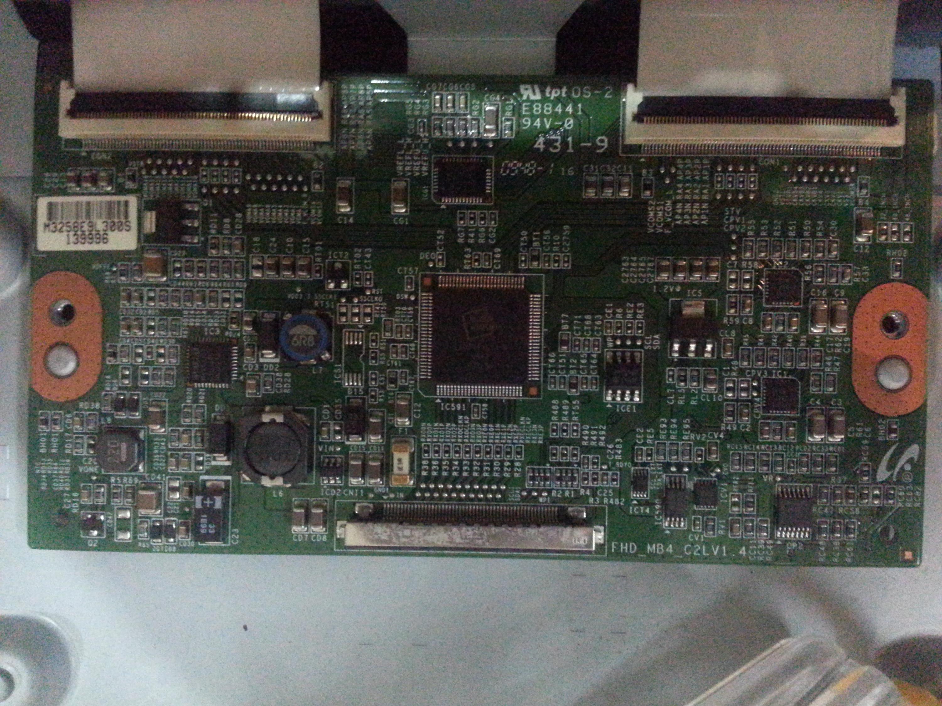

Replaced T-con board and now getting vertical lines
+ More Options
Latest Activity
  • shanusmarty
    replied
    Re: Replaced T-con board and now getting vertical lines
    havent played with bond tabs yet, n scared to try eveN!
    Leave a comment:
  • shanusmarty
    replied
    Re: Replaced T-con board and now getting vertical lines
    have checked the voltage on TCON, its good!
    idk what could be the fault ? :/
    Leave a comment:
  • shanusmarty
    replied
    Re: Replaced T-con board and now getting vertical lines
    Originally posted by tom66
    any one of the whole chassis?
    sure!
    Leave a comment:
    replied
    Re: Replaced T-con board and now getting vertical lines
    Any one of the whole chassis?
    Leave a comment:
  • shanusmarty
    replied
    Re: Replaced T-con board and now getting vertical lines
    all the pics! please some one help out!
    Leave a comment:
  • capkid
    replied
    Re: Replaced T-con board and now getting vertical lines
    Last edited by capkid; 06-14-2013, 04:40 PM.
    Leave a comment:
  • shanusmarty
    replied
    Re: Replaced T-con board and now getting vertical lines
    will post tommorow! the whole of TV!
    Thanks TOM66 for so much help! and BadCaps too!
    Leave a comment:
  • shanusmarty
    replied
    Re: Replaced T-con board and now getting vertical lines
    picture of old TCON attached!
    Leave a comment:
    replied
    Re: Replaced T-con board and now getting vertical lines
    What about one of the rest of the TV?
    Leave a comment:
  • shanusmarty
    replied
    Re: Replaced T-con board and now getting vertical lines
    thanks again!
    this is the picture of old TCON! LINKhttp://db.tt/RJGiVua1
    Leave a comment:
    replied
    Re: Replaced T-con board and now getting vertical lines
    Usually the tab bond faults get worse progressively, but there have been reports of sudden failures due to tab bonds. I recommend you try and eliminate it. Also, can you post pictures of inside your TV? Perhaps there is another board that can cause this. Unlikely, though.
    Leave a comment:
  • shanusmarty
    replied
    Re: Replaced T-con board and now getting vertical lines
    Originally posted by tom66
    Yes, it is quite possible you have a bad tab bond.
    Different fault, same possible cause + possible fix:
    https://www.youtube.com/watch?v=purk_SyiT44
    thanks for so much help, but for info i was WATCHING TV(using as a monitor connected to my laptop thru VGA port, it was running smooth) n suddenly withOUT any physical contact or any thing, black part appeared from right to half and then full black and boom it was gone forever.
    so the summary is it was working perfect and running smooth and next moment it was at fault!
    what could be the culprit?
    Last edited by shanusmarty; 06-14-2013, 03:00 PM.
    Leave a comment:
    replied
    Re: Replaced T-con board and now getting vertical lines
    Yes, it is quite possible you have a bad tab bond.
    Different fault, same possible cause + possible fix:
    https://www.youtube.com/watch?v=purk_SyiT44
    Leave a comment:
  • shanusmarty
    replied
    Re: Replaced T-con board and now getting vertical lines
    Originally posted by tom66
    You may have a main board or panel fault then.
    changed the main board and tested.. but same results!
    can lcd panel faulty with out physical damage?
    Leave a comment:
    replied
    Re: Replaced T-con board and now getting vertical lines
    You may have a main board or panel fault then.
    Leave a comment:
  • shanusmarty
    replied
    Re: Replaced T-con board and now getting vertical lines
    Originally posted by tom66
    Do you mean you originally had:
    - a blank screen (lit up)
    - vertical lines?
    hello,
    i originally had vertical lines with audio, but same results after replacing TCON!
    Please help!
    this was the original condition with out replacing TCON!
    http://www.youtube.com/watch?v=PKrUvpyHxUI
    Last edited by shanusmarty; 06-14-2013, 02:32 PM.
    Leave a comment:
  • tron
    replied
    Re: Replaced T-con board and now getting vertical lines
    http://www.youtube.com/watch?v=GcBwTums_mI
    Leave a comment:
    replied
    Re: Replaced T-con board and now getting vertical lines
    Originally posted by shanusmarty
    even i have the same problem, but i replaced TCON, but no solutions
    Do you mean you originally had:
    - a blank screen (lit up)
    - vertical lines?
    Leave a comment:
  • shanusmarty
    replied
    Re: Replaced T-con board and now getting vertical lines
    even i have the same problem, but i replaced TCON, but no solutions
    Leave a comment:
    replied
    Re: Replaced T-con board and now getting vertical lines
    I would suspect the T-con in this case.
    Leave a comment:
  • Stanley1843
    by Stanley1843
    Hello, I have a screen in where sometimes when I open it pop-up vertical multicolor lines (I would say the most of them are green). If I tun off and turn on the screen the lines dissapear or if I leave open the screen after approximately five minutes the lines gone. I measured the below voltages on the main PCB and on the T-CON board and the voltages are the same when it doesnโ€™t display the vertical lines and when it displays the vertical lines. Also, I cleaned all the connectors very good with IPA. I moved back and forth the connectors and the COF tabs but the vertical lines didn't displayed...
    06-29-2024, 11:54 AM
  • Daren87
    Sony 8K XBR-75Z8H White Screen Vertical Bars Tcon Code. Help Needed๐Ÿ™
    by Daren87
    I've recently been given a Sony 8k Z8H. It's got a white screen with two vertical black bars. At times it's given me the 5 blink Tcon code. Testing voltage on the Tcon I can see some low or missing voltage. I've done a basic visual check of cables and the COF. Not seeing anything obvious. The original Tcon seemed to have good caps until turning it over. On the bottom I found maybe 10 caps with both sides of the caps shorting to ground. I thought ok these caps and likely other components on the Tcon are shorted so let's try a replacement Tcon. I just received the...
    08-13-2023, 03:25 PM
  • gpo23
    Sony KDL-40V3000 - Vertical lines
    by gpo23
    i order a t-con because i had bad colors on my SONY KDL-40V3000 :
    With the new t-con the color are good but there are vertical lines on all the screen :
    I've tried the old t-con and it returned to the initial issue (bad colors but no vertical lines)
    Is there a way to fix the vertical lines on the new t-con ?
    Thank you for your help
    gpo23...
    10-04-2023, 09:11 AM
  • x_orange90_x
    by x_orange90_x
    03-29-2025, 11:02 PM
  • Hakuu
    by Hakuu
    Hi There,
    More Details
    TV Model - LG OLED77G1PUA
    07-12-2023, 02:37 PM
