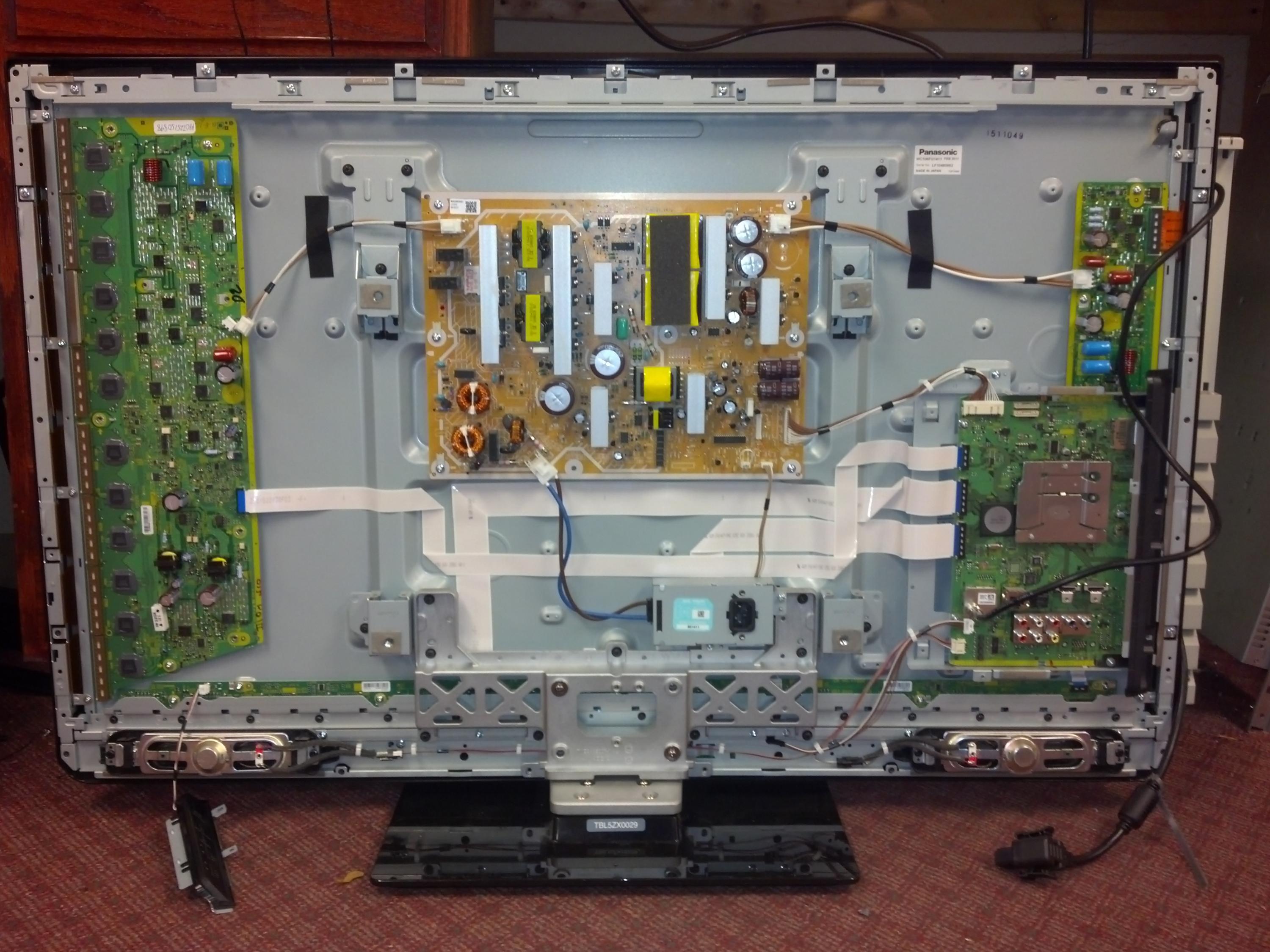

    I have a Panasonic plasma TC-P42S30 that I bought with 14 blinking lights. I know 14 is not listed in the service manual but I assure you it's 14. I bought a new SN board and installed it. It worked for a few minutes but with a few black lines across the screen. I wiggled one of the tab connectors and the TV shut off. I thought maybe this was my fault, so I ordered a new SN board. The TV came on again with the new board, but it still had a few black lines. This time I didn't touch ANYTHING, yet the TV still turned off after 30 seconds and has 14 blinks again.
    I'm digging myself a hole with TV. Help me get out please! The only connections to the SN board are the tabs to the panel, one ribbon cable to the main board, and the power cord that goes to psu. I assume the psu is doing something crazy.

    14 blinks is an odd error but is explained in a training manual
    http://tgohome.com/ServiceManuals/Pa...nd_extra_info_[TM].pdf
    (slide 56.)
    It is NOT an SN/SS board error (those can only be 4, 6, 7 or 8 blinks.) It is an audio PWM error, possibly bad audio amplifier or shorted output.

      Re: Panasonic plasma TC-P42S30. What is killing my SN boards?
      Strange. Audio works great as long as TV is on. And the only way the TV will come on is to put a new SN board in (this is my third one). The board had no short when I put it in, now it has a short. It is in these components and possible somewhere else too.
      Also, I read on another website (I think justanswers, I will try to dig it up) about a guy that had 14 blinks, and his problem was sorted out with a new SN board. Unfortunately it only sorts my problem out for less than a minute.

          So I can find any place on the power board labeled "+15vc" and test there?
            On the connector from SN to SS there is a 15V supply along same cable as Vs (200V.) The PSU also provides 15V standby power.

              There is no connection from SS to SN. SN only has a ribbon to the A board, and the VSUS connection to the PSU, and the tabs to the panel. I did check the 15v going to the SS board and it is within spec. Also checked the VSUS going to SN and it is 200ish.
                Oh, OK, this is a different design, it goes through P board, so check the voltage on the pins on the P board.

                  With the SN board plugged in the VSUS never shows voltage and neither does the 15v. With the SN board unplugged from PSU the TV gives 206v briefly before it shuts itself off and the 15v gives 15.6 very briefly.
                  When SN is unplugged TV comes on for a second with sound, and then turns off with 8 blinks. SN plugged in and I get no sound and 14 blinks.
                    8 blinks is SS error. Maybe a bad SS is killing SN. tw2007 and rayrod know a lot more than me about Panasonic plasmas.

                          Just a few more pieces of info. With the SS board unhooked and SN hooked up I get 14 blinks again. I guess it check SN before SS? If I unhook BOTH boards at the same time, the TV seems to operate normally (of course I have no picture or sound) but I don't get blinks, and the TV turns off and on with each press of the power button which it would not do before.
                          EDIT: With both boards out it operates normally, with no blink, as long as I don't leave it for more than a minute. After about a minute it shuts off and gives 6 blinks... Before it would read 215v VSUS for only a second, now it reads 215v for the full minute until it shuts off. Within this minute window I can power on and off normally.

                            I just took a second look at the service manual and at the troubleshooting flow chart. It turns out there is a status LED on both the SS and SN board... It says to check both boards for the LED and if not lit replace both boards... I should have paid more attention the first time around... I have never seen the LED light up on the SS and it lights up on the SN the first time I hook it up, but only until SN shorts out...
                            I am pretty confident that replacing both boards at the same time should fix it (fingers crossed).

                              Got the tv working. It was a bad SS board that caused the SN boards to fail.
