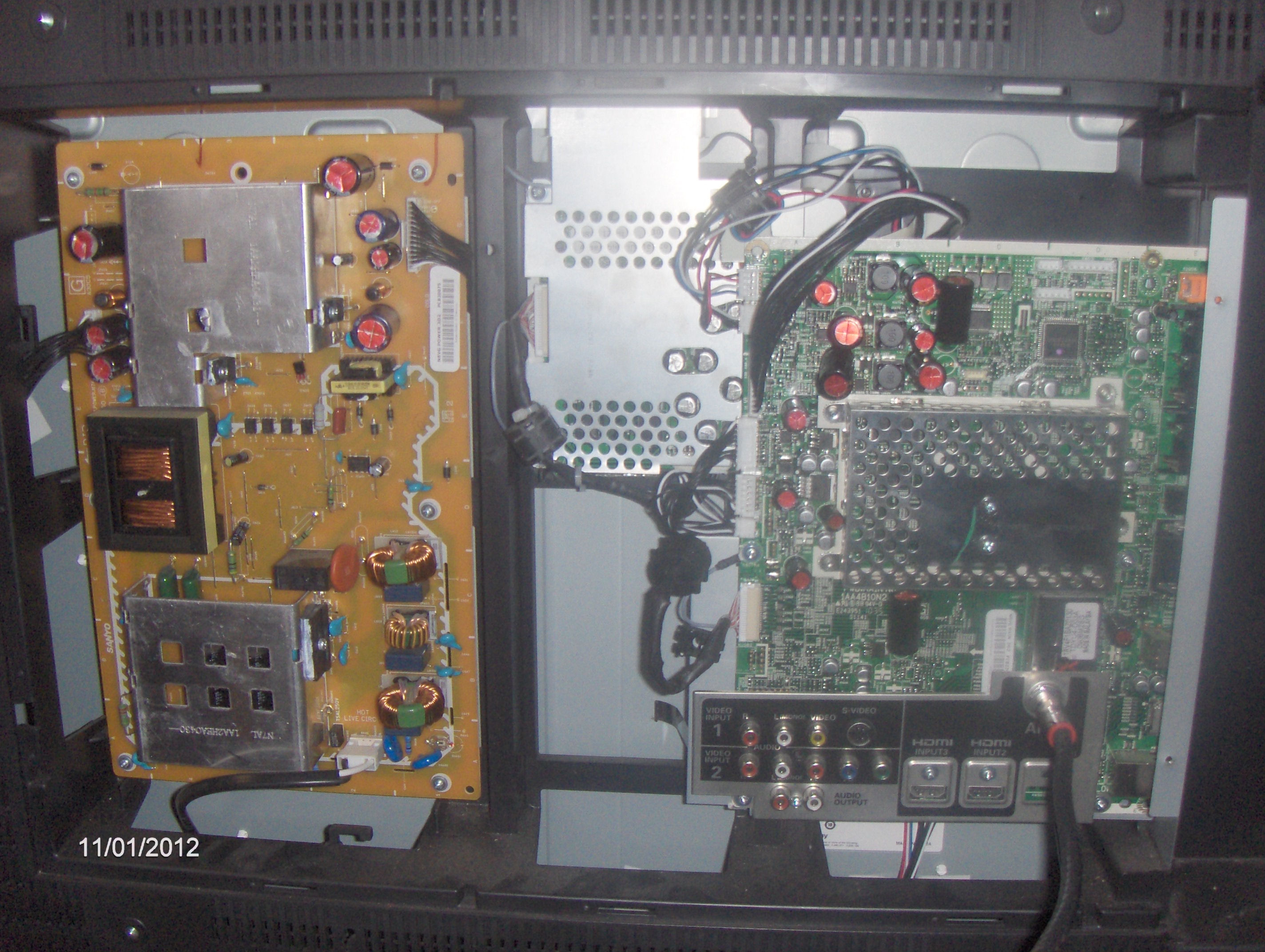

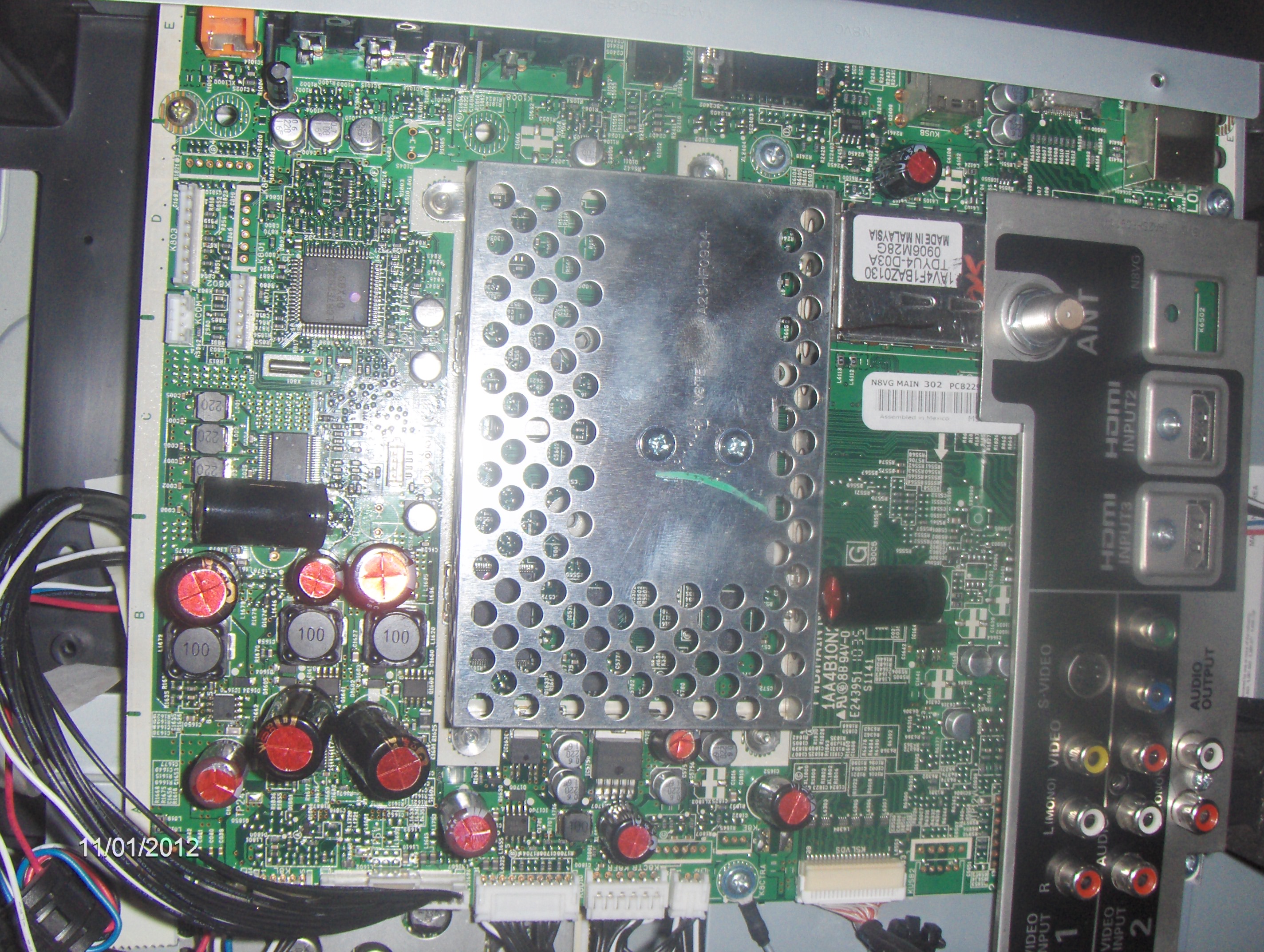

    Sanyo Model DP47460 wors great and will play non-stop if you do not turn the sound up past 38. I have replace pretty much all the caps on the power and main board. (The caps with the red tops are the new ones) Does not matter which input you use the magic number is still 38. The tv will turn back on but if you don't switch inputs to a no signal and lower the volume it will turn back off. After about three shut downs the set has to be unpluged for awhile before it willl turn back on. I am stumped I did check the resistors on the power supply too, no problem found.
    Power board # 1LG4B10Y04800
    MainBoard # 1AA4B10N24700

    Since it looks like you can reproduce this quite easily, I suggest taking before and after voltage measurements of all your connectors and voltage regulators on the main board.
    For example, set volume to 1, record all your voltage measurements. Do the same for 10, 20, 30, and 37.
    See if there are any significant changes between those 5 settings. You may spot something abnormal?

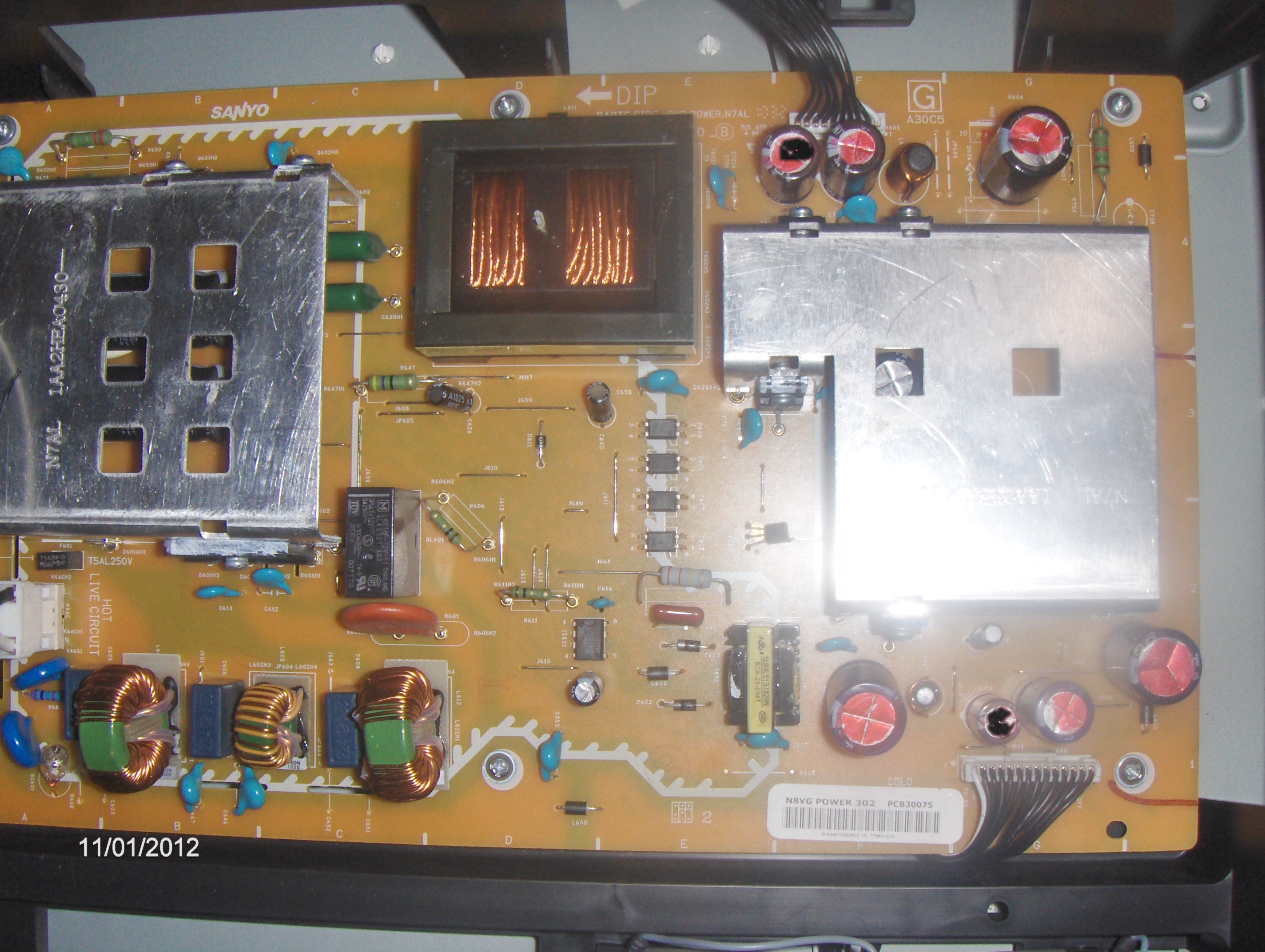

      My bet would be the green caps - C630H1 and one I can't see, under the heatsink. I have seen this problem on Vestel TVs (different PSU but similar topology), and it is usually those two caps.
      Oh, and if the sound is quiet, does it still cut out at 38?

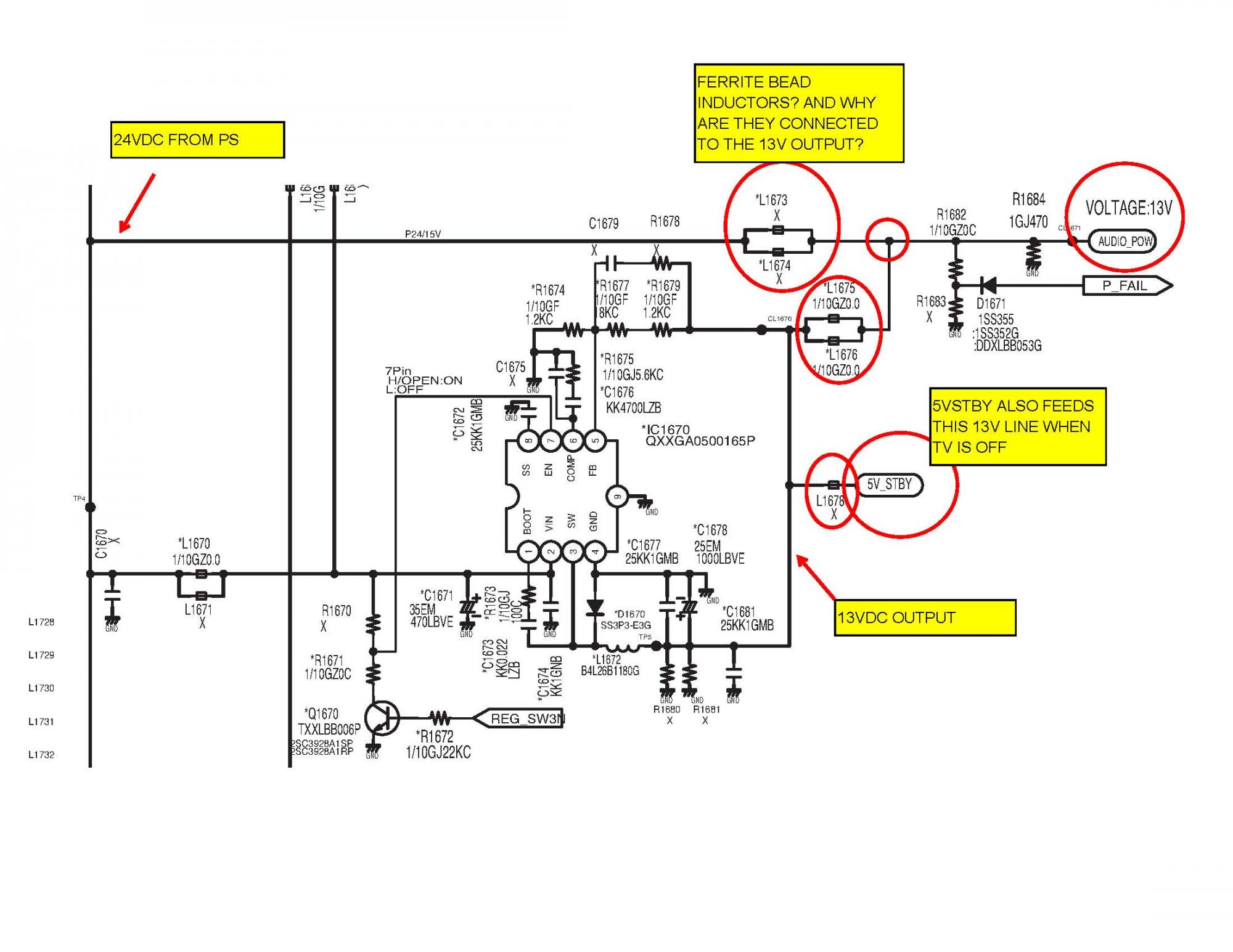

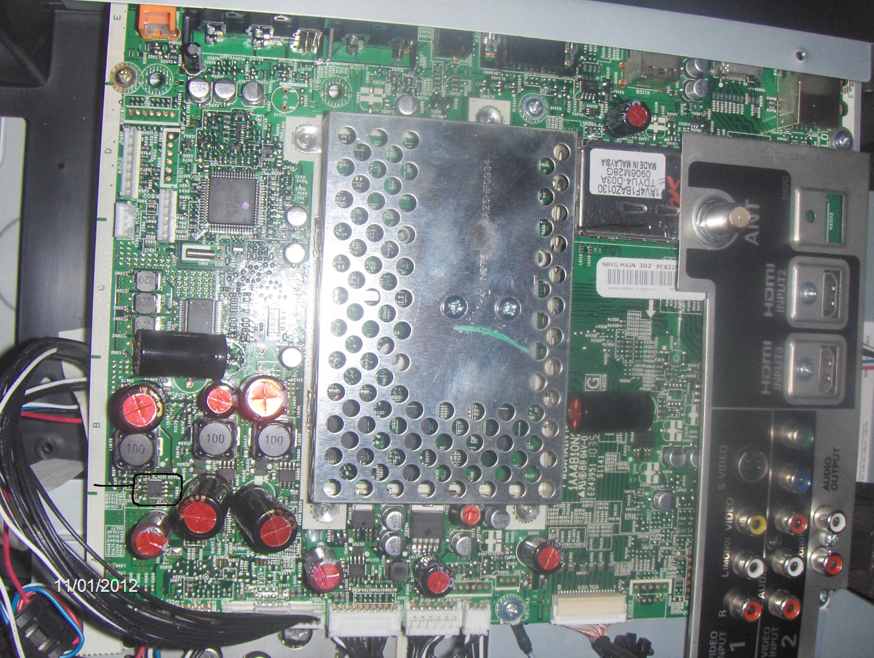

        It's most likely IC1670. This is an 8 pin surface mount ic. It has a ground pad underneath the body of the ic that is also soldered to the board.
        It drops 24 volts down to 13 volts to run the audio output circuit.
        It's located on the top side of the board about an inch to the right from the speaker connector. The sanyo part number is QXXGA0500165P.

          I took your photo of the main board and drew a black outline around the ic.
          The ground pad below the ic makes it tough to remove from the board without
          hot air.

                There may also be an IC001 audio amp that could be the problem.. You'll have to check the 13v line and see if it drops off...
                  Re: Sanyo Turns off when sound turned up
                  I remember that now when I was helping you on that Sanyo DP42840 where I posted my notes as shown in post 4.

                      I think you will have to get it from Sanyo themselves.
                      I have a number to try: Sanyo parts phone #: 18008775036 ext1485
                      The number on the part is LV5806MX-TLM-H but you will have to use the Sanyo part #QXXGA0500165P
                      Sanyo is the original manufacturer of the part. It's a step-down switching regulator...pdf here
